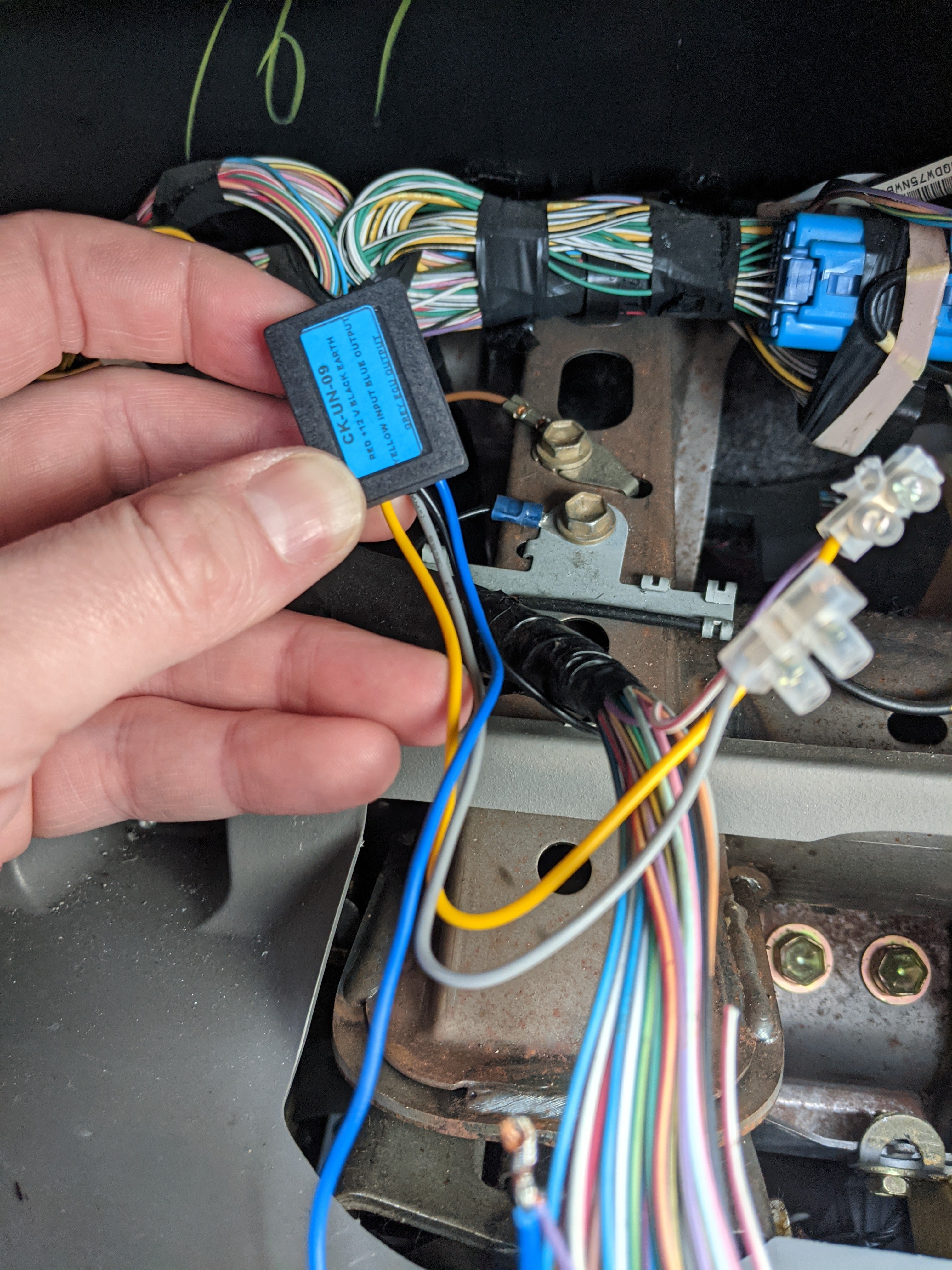

It's the speedo chip behind the clock this is fitted by the dealer to convert kph to mph the chip used is called a ckun09 I would say the chip not at fault but the installation of it they are supposed to be soldered in but lots of fitters use wire connections which is no good .

I had this problem while test driving.
Apparently it was caused by the loose chip earth wire.

Hi, if it’s any help I removed my block connectors and soldered mine behind the dash after engine light came on and the Speedo needle was acting erratically. Easy to get to behind dash and alter.
yet to test speedo but engine light is out.
We’ll after having thought I’d fixed my erratic speedo needle (wouldn’t go past 20kmh and jumping) and the engine light coming on - I was wrong.
Had soldered all joints to the converter unit including the earth connector but in the end went with the advice to remove the converter and all now working as it should.
Will probably go for the mph dial face instead.
So I hope this tale adds to helping anyone in the future.🤨
