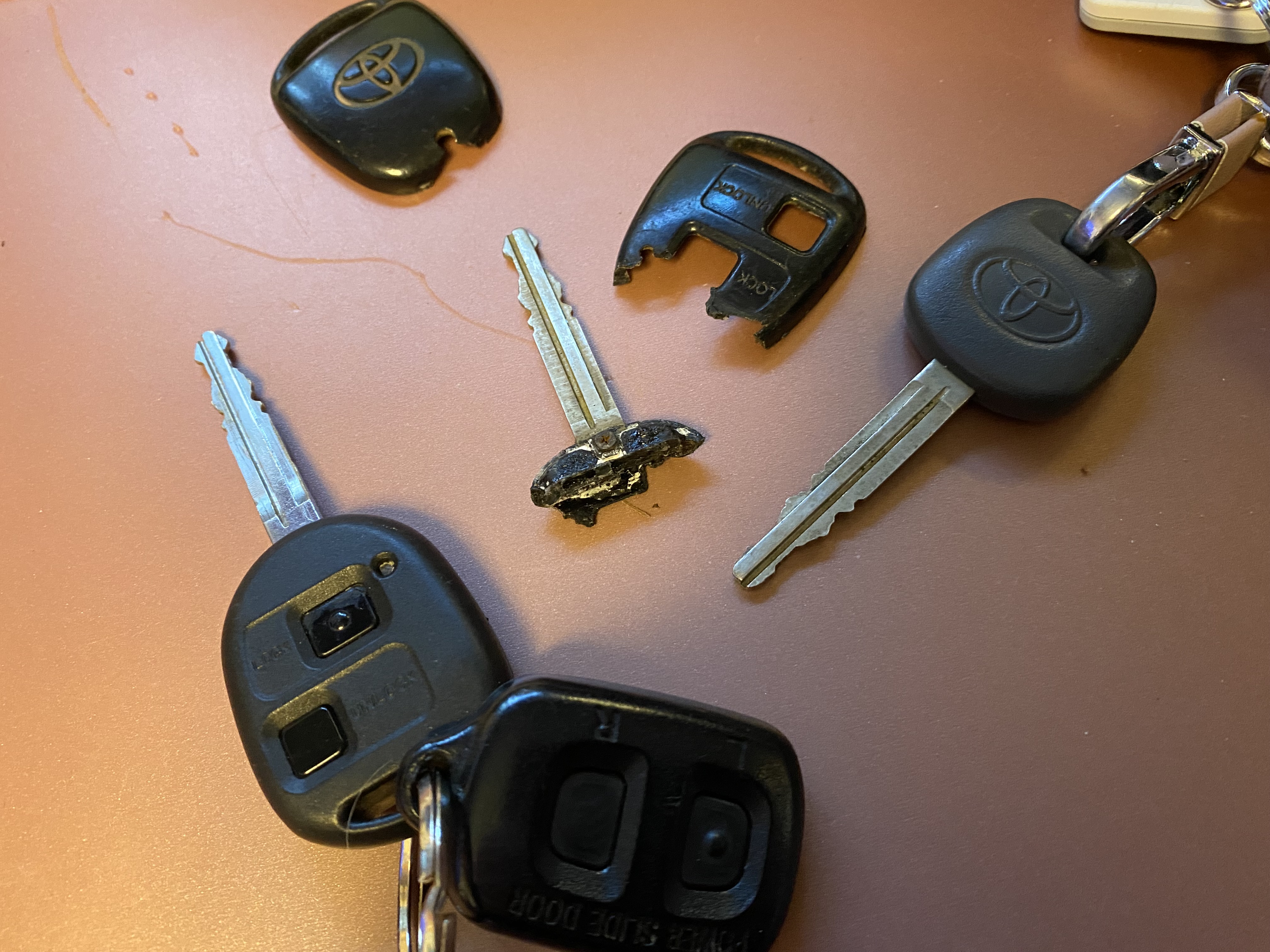

Links are now out of date is there any more up to date information on the subject of programming extra keys 2004 3 ltre Alphard.  Local dealer and Toyota dealership unable to help as are local master locksmiths.  Was assumed at purchase this would not be a problem as I am disabled and lack of remote is a major problem
6 hours ago, Amicipat said:
Links are now out of date is there any more up to date information on the subject of programming extra keys 2004 3 litre Alphard.  Local dealer and Toyota dealership unable to help as are local master locksmiths.  Was assumed at purchase this would not be a problem as I am disabled and lack of remote is a major problem
Can you post a photo of your key. There are more than one type.
I suggest you need a specialist auto locksmith.
You could try RomaHome in Ryde (or is it Cowes).
They may know a suitable local auto locksmith/supplier. It won't be cheap.
80 to 120 pounds, or so.
The auto locksmith I used, a local (to me) guy, made all my keys to masters; but you must have a master to start with !
The blank keys are available on ebay and include the immobiliser chip.
Not sure about the Gen 1 which you have; but the Gen 1 facelift needs the 4D67 chip in the key blank.
Blanks are usually less than 20 pounds.
Hi, thanks for your reply, these are my keys:IMG_1100.thumb.jpg.6b29fe33028dc4ab61cb7870a2d098b4.jpg
Hi Patricia,
Unfortunately, not the same as mine.
A trip to Romahome (North Star at Cowes) be be helpful.
They must have encountered these issues.
