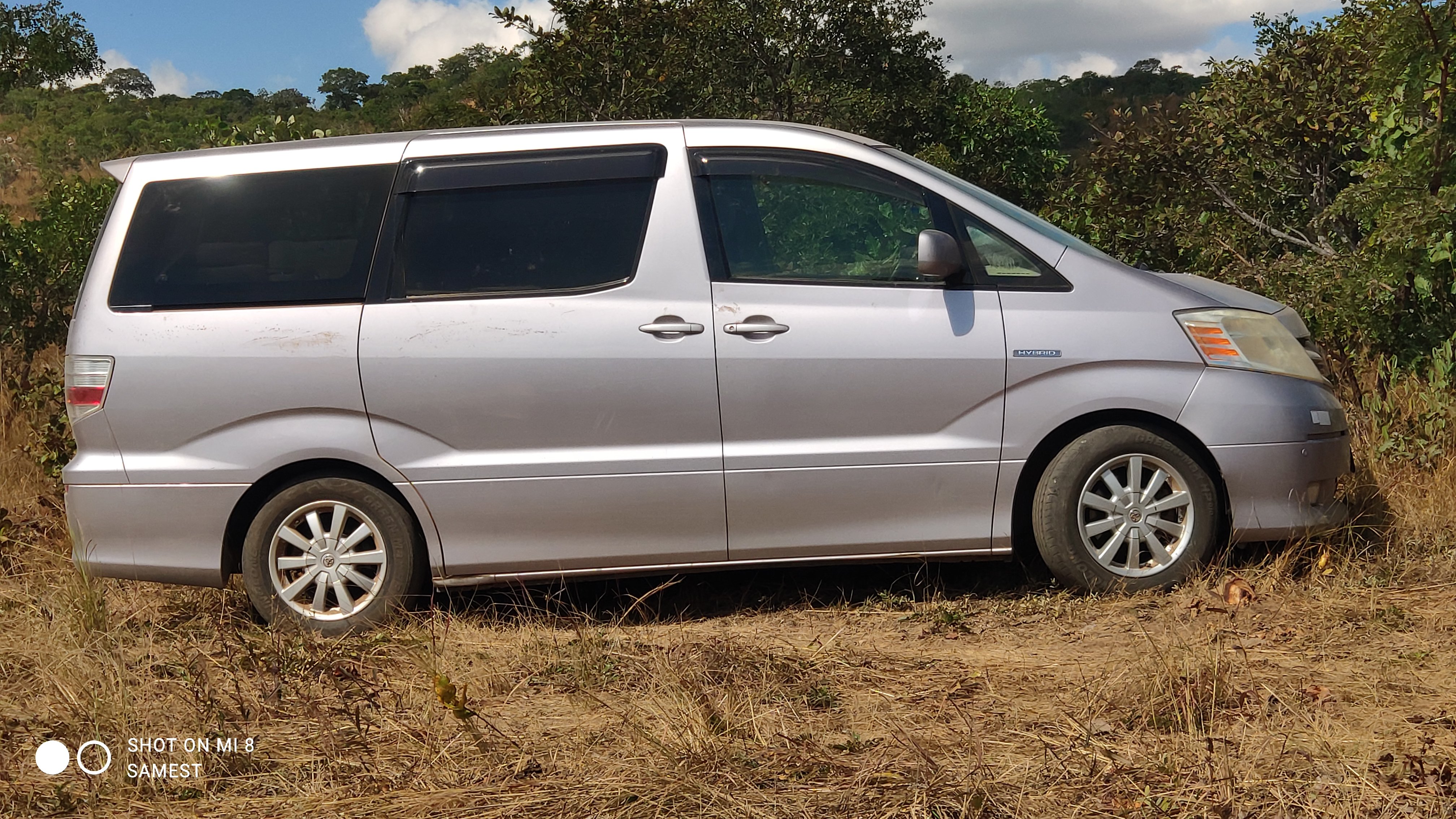

I have this Alphard hybrid E-four. It's giving me warning lights for VSC and at the same time the hybrid light. After some time it's giving me a engine oil light and immediately cutting off.
Any advice from anyone with such issues and how it was sorted out
