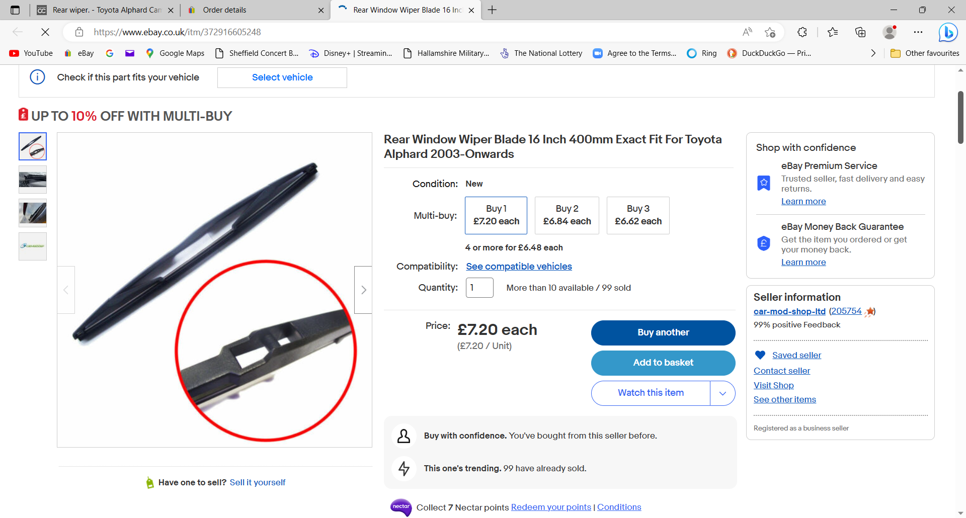

Hi all,
Just to add, we replaced our rear wiper blade with a Bosch, No. 3 397 013 431 (400mm/16") - also known as an SP16
