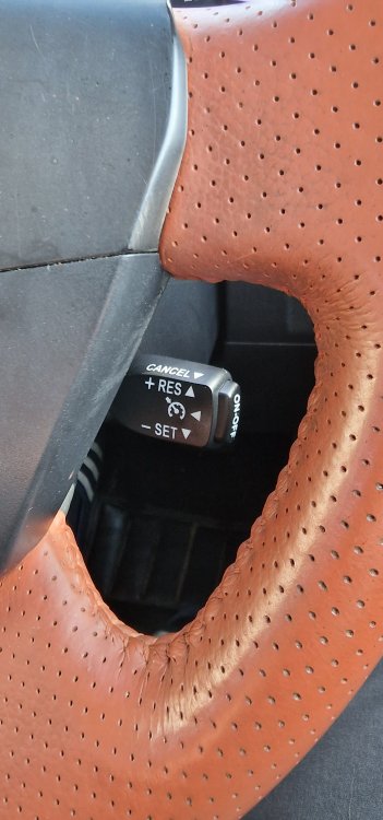

I’ve had cruise control fitted retrospectively to my 2007 AWD 3.0 Alphard by Calder Campers based in East Calder, Scotland.  I believe that another company based in Warrington has also done a retro fit to a 3.0 using Toyota parts so it’s something that can be done - depends on what you’re  prepared to pay and whether you want to diy.
From what I do understand, facelift model gen1 onwards have the wiring and ability to upgrade by just fitting the control stalk - seems like a silly way for toyota to charge more as an option, if everything exists in the ecu already! I think if you have a pre facelift, you need an aftermarket kit as the throttle control is different, I may be wrong, so hopefully some other owners can confirm.
short vid - it really is this easy.

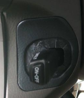

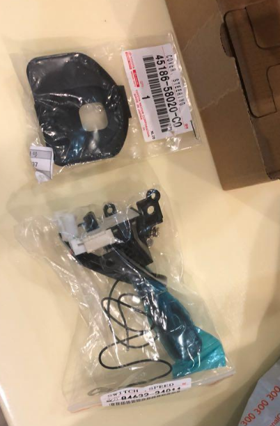

2007 is facelift model gen 1 (or 10series)
part number for switch is 84632-34011
You can find these for under £15 on ebay, its a generic switch used on many toyota models, if you want a new blanking plate that it pokes through, just widen your search term to include alphard, or you can just cut a hole in the blanking plate yourself if not too bothered, the part number for the cover (again its common to several toyota) is 45186-58020-C0

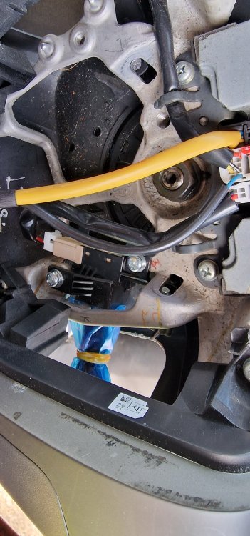

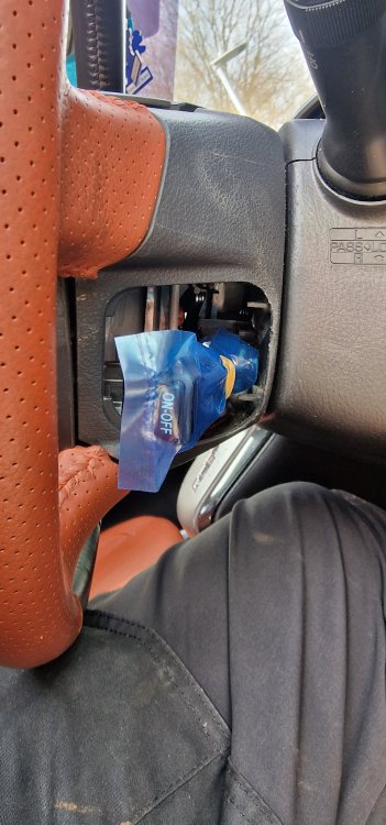

i didn't disconnect the battery when i fitted an upgraded stalk, that involved complete removal of steering wheel, oops, probably should have though.
When I reconnected everything, i had to reset the 'spring' that the wiring loom for the switches is attached to, that involved full lock from left to right and back, that was it.
and clearing the error in the DTC, which would not have happened had i disconnected battery.
