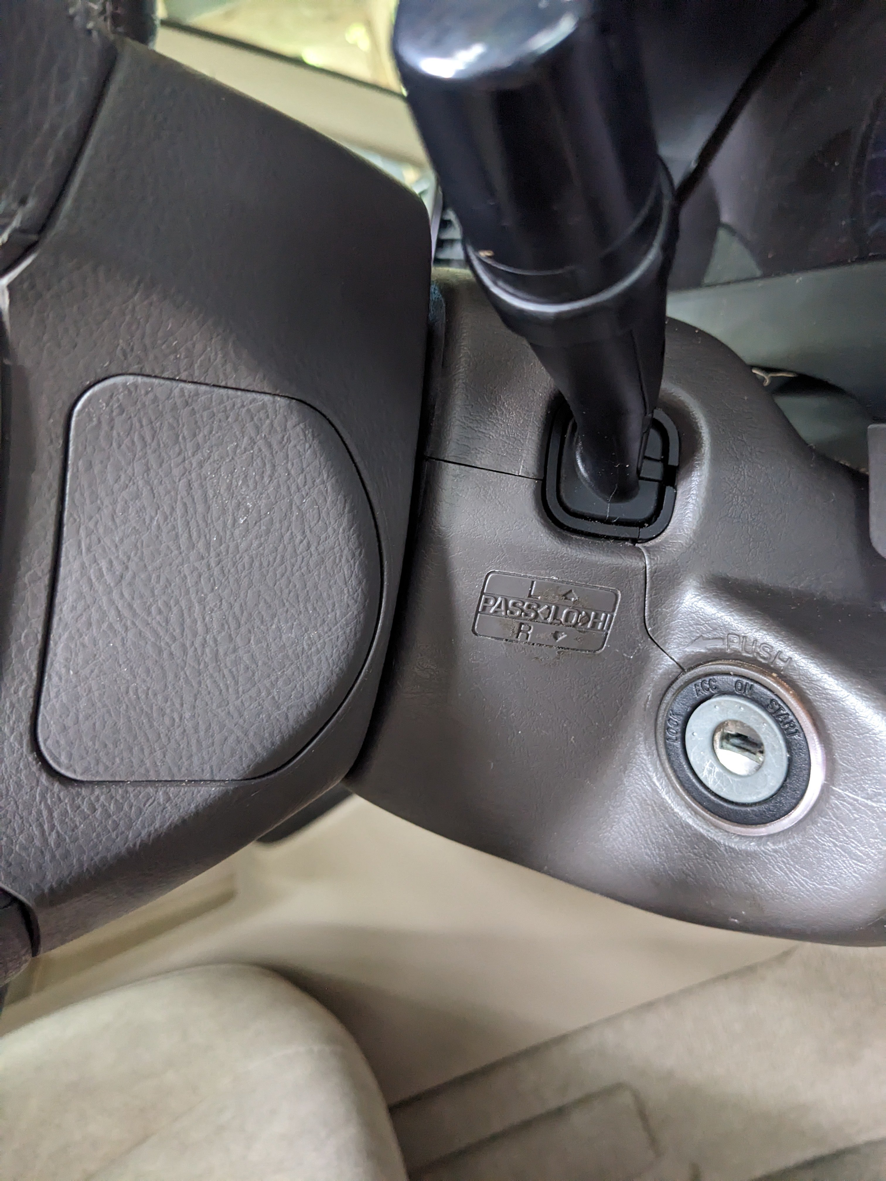

Cruise Control
Great news, a little hassle, but considerably cheaper than an aftermarket kit fitted by an installer!
I do wonder why Toyota thought this simple control stalk was a worthy cost cutting/optional extra!

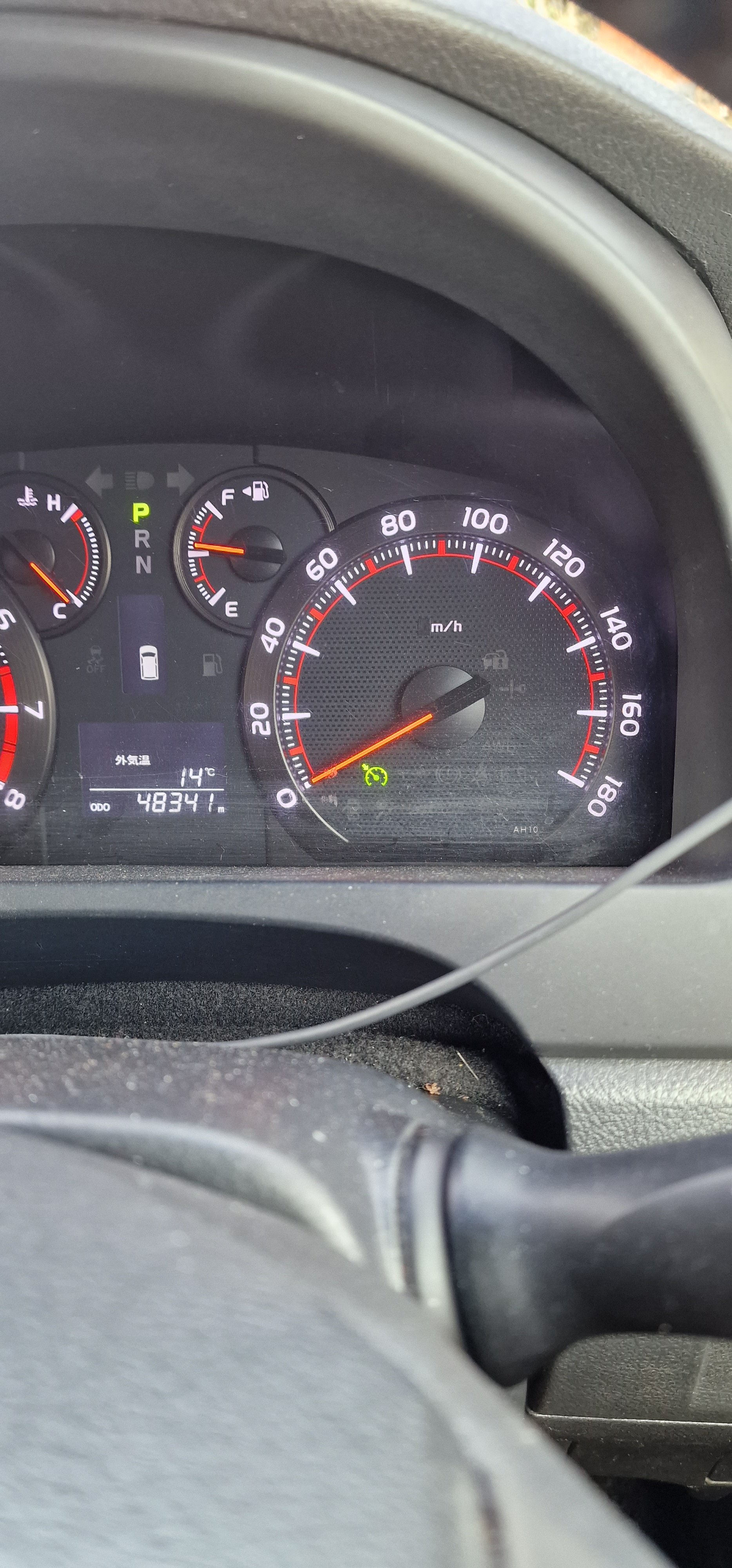

Quite pleased how it went. Perhaps the Japanese road system isn't big enough to warrant or allow much cruising??

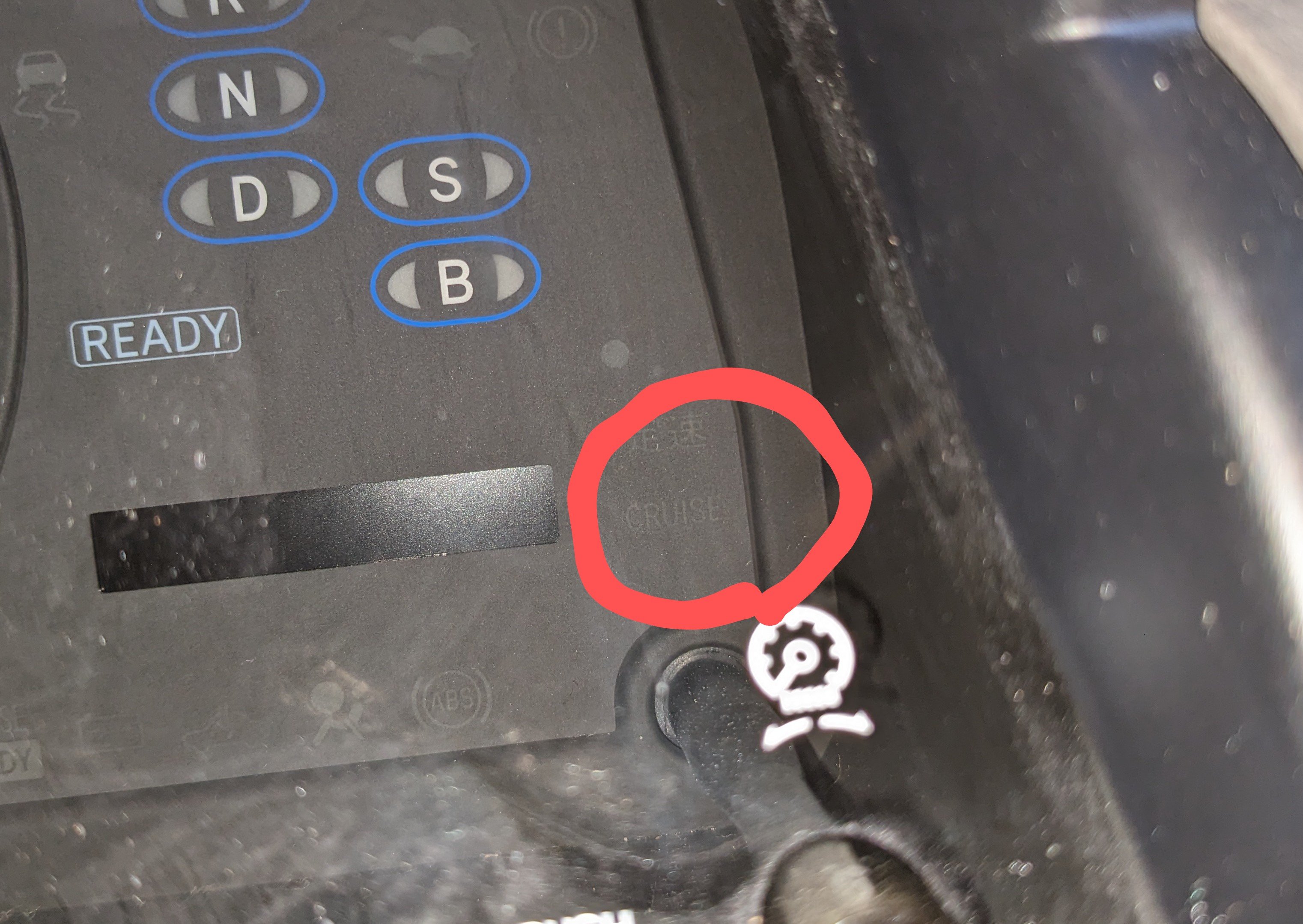

On the dash I can see "cruise" so I believe I can somehow install it.
A person from AliExpress told me this will work but I'm not sure..
https://a.aliexpress.com/_EJtftC1
What do you guys reckon? Cheers

If you haven't already, read what Chris.ac has to say in this thread.
It depends on whether you have a mechanical throttle, or not; if you need the upgrade to be easy and inexpensive.
Is this model mechanical throttle or not?

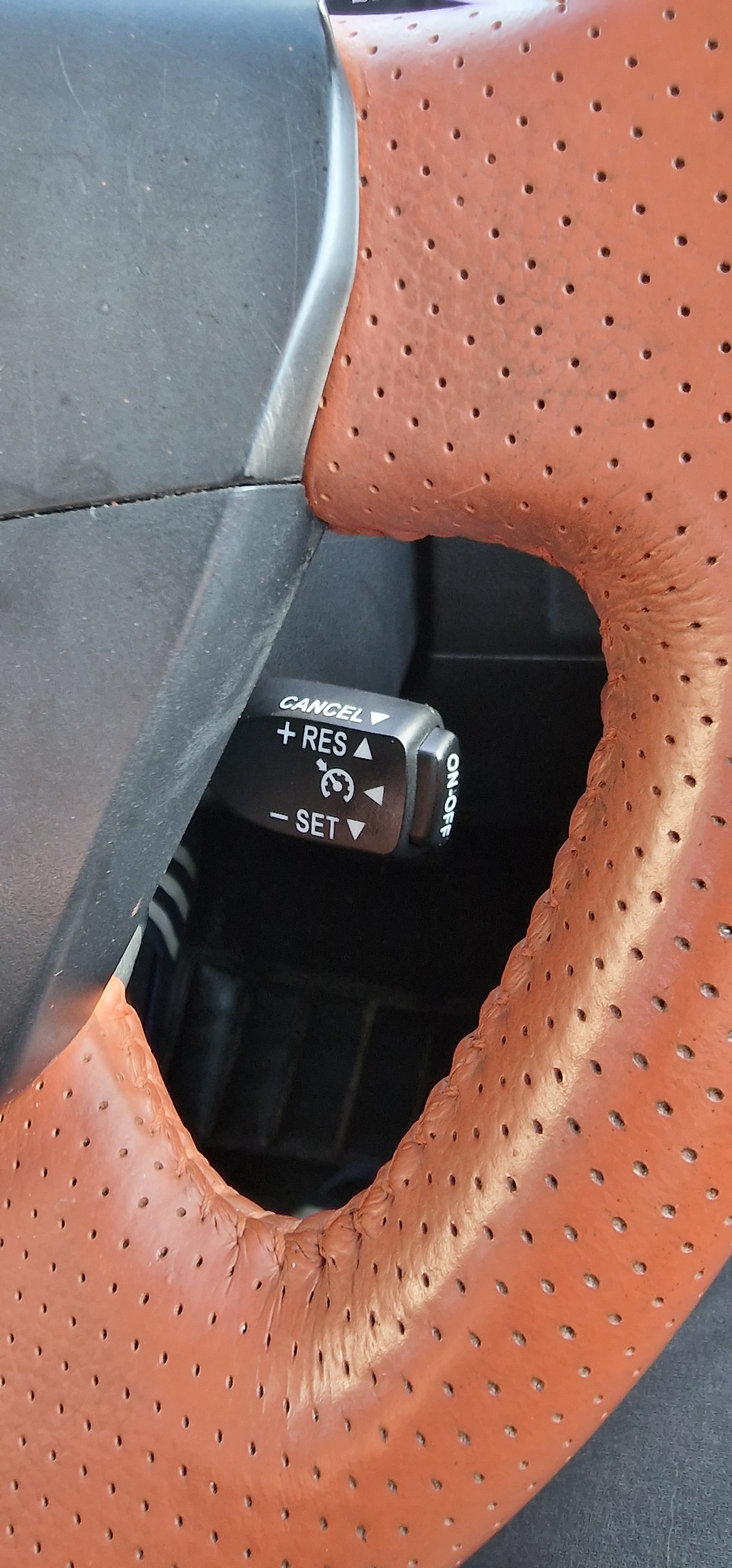

I posted in a other forum but thought I'd just share here that I bought the £10 stalk off eBay for my 2008 Vellfire and it fitted super easy and cruise control works. (No light on dash to confirm it's on but soon get used to that).
So a success thanks to this forum.

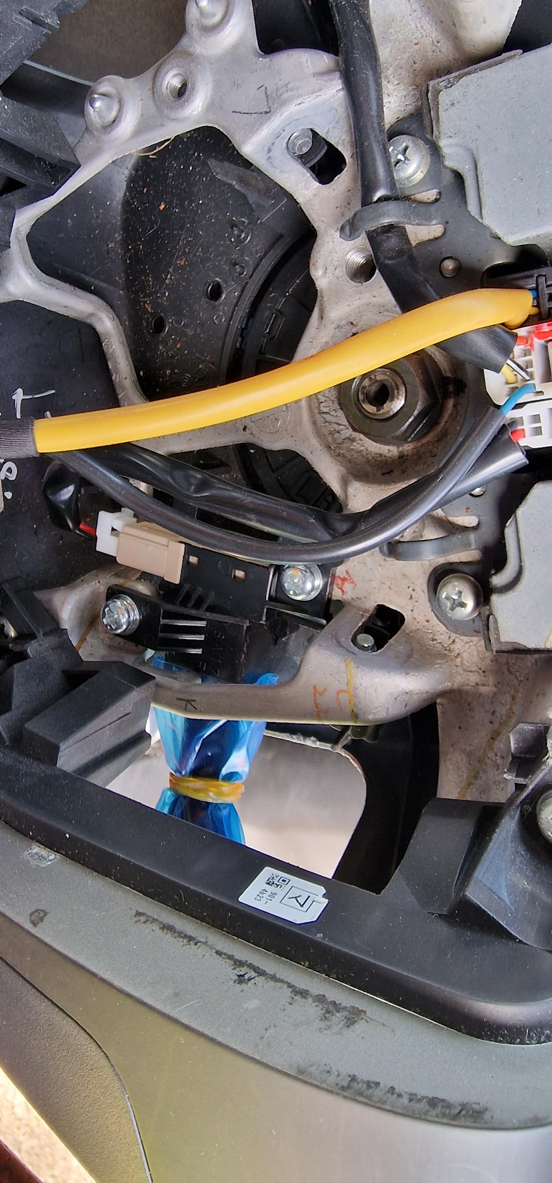

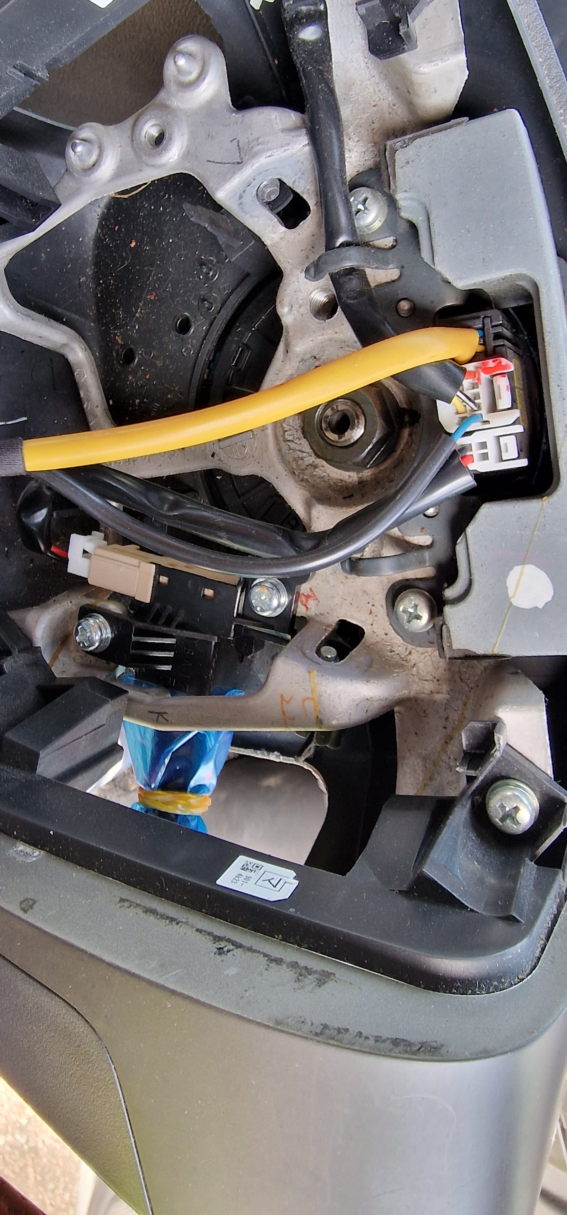

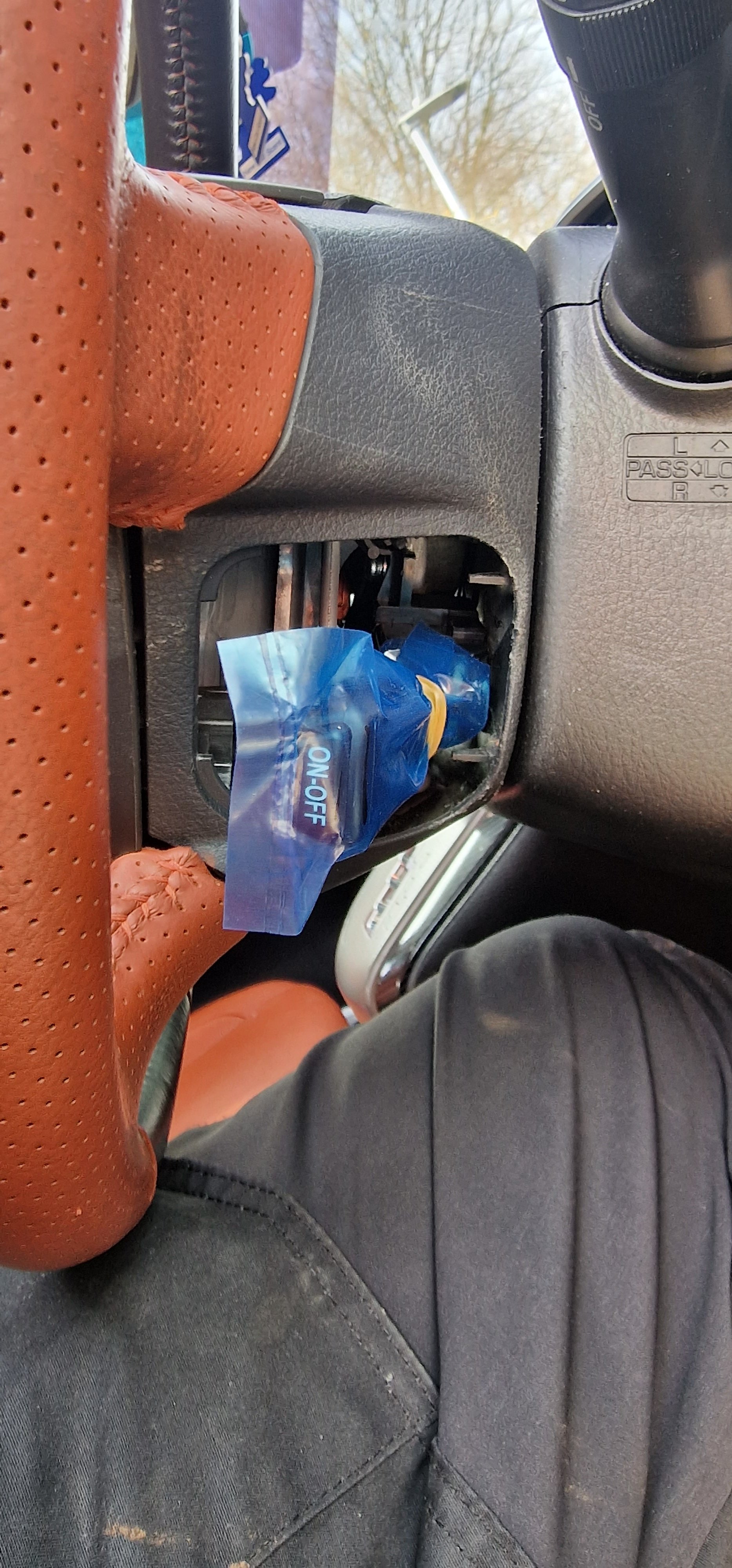

Today I had my cruise control stalk delivered, the instalation took me 15 min. Once I removed the airbag I noticed that I already have the connector for the cruise control there, was just a matter of plug and play.  Test it and all works great. All is left is to cutout the cover. This is the stalk I bought: https://www.ebay.co.uk/itm/114705087244?mkcid=16&mkevt=1&mkrid=711-127632-2357-0&ssspo=ToA0FS2lTH2&sssrc=4429486&ssuid=4VUOd8_gQG6&var=&widget_ver=artemis&media=COPY
Edited by Sorin
