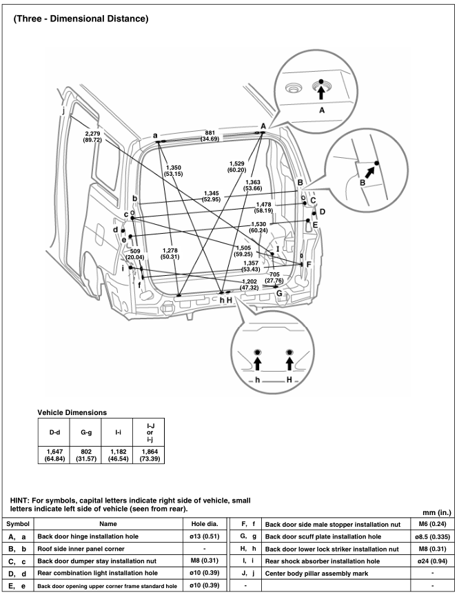

New member thinking about a version 2 - 2013(ish) model perhaps the hybrid.
Anyway was looking to also load bicycles and was wandering if anyone knows or can measure the max height for the boot opening, which is never on any spec sheet, I get there is plenty of height once you're in, but reduced to what at the the opening?
Any other suggestions or recommendations for newbies or Alphards/Velfires in the Llandysul area I could view would also be welcome.
