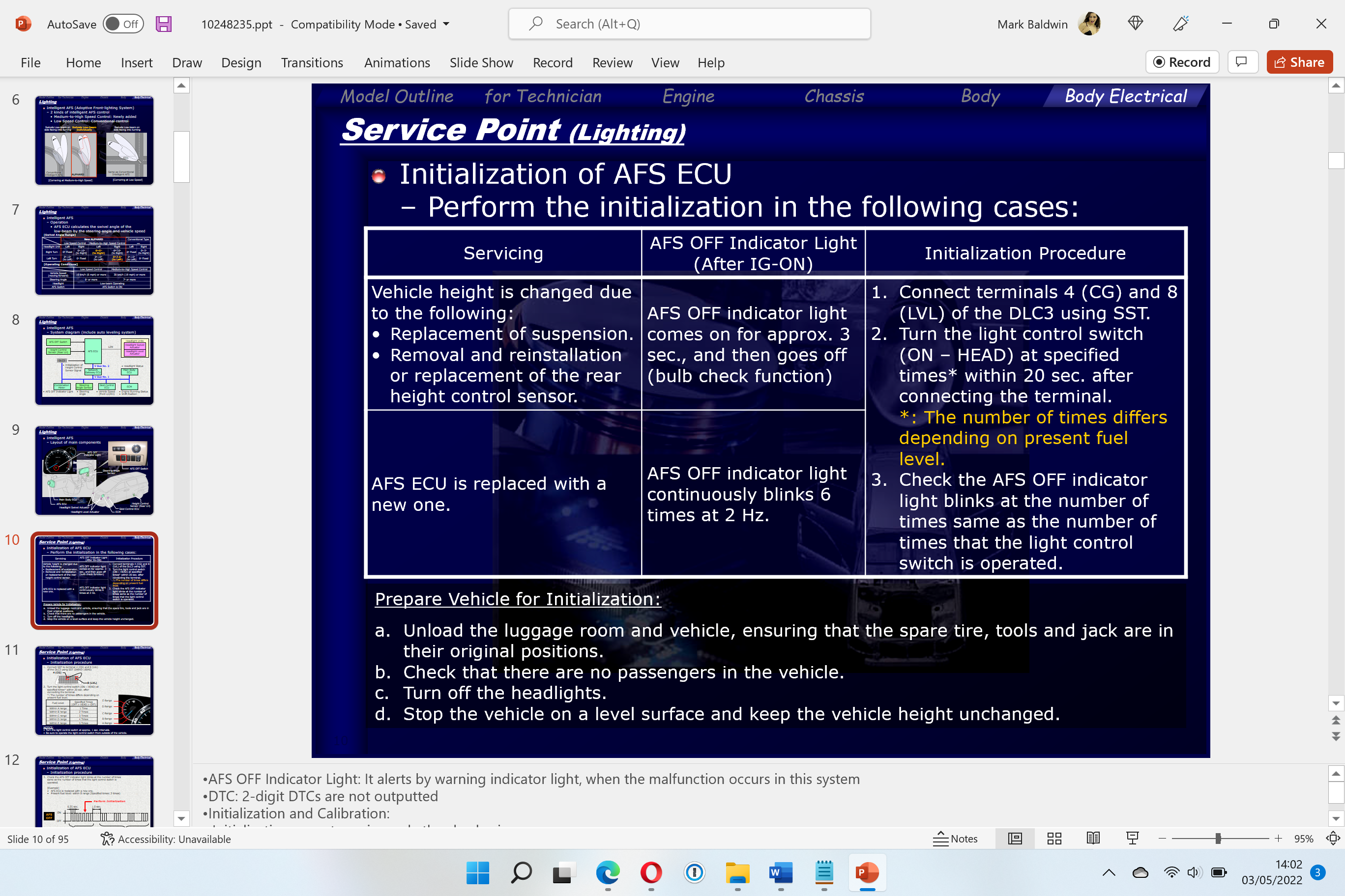

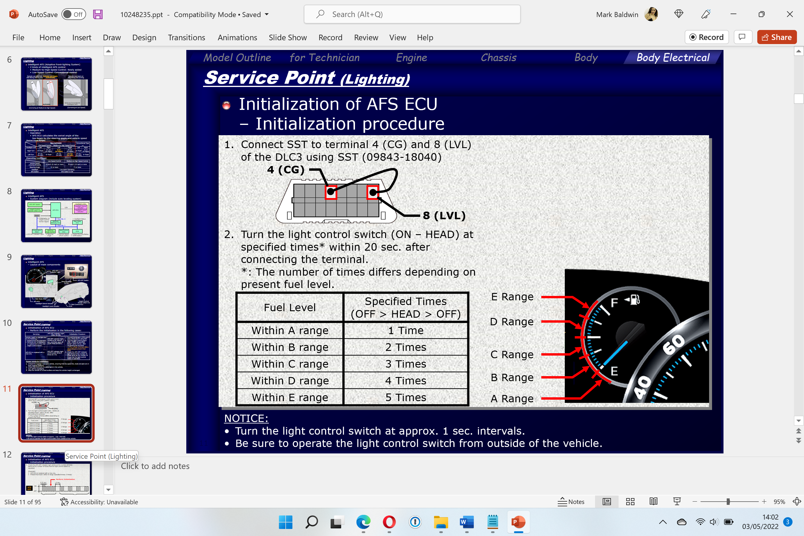

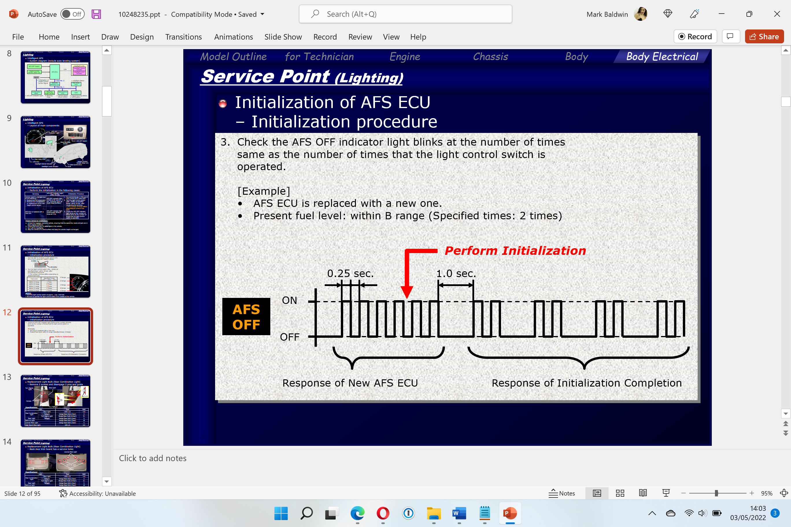

drahpla Posted July 19, 2022 Author Report Share Posted July 19, 2022 (edited) Hi, See the attached, but note the following: The diagram showing the OBD connector is upside down, showing pins 8 and 4 on the opposite side of the connector to what they actually are in real life. The engine must be running. The light stalk must in the high beam on position (i.e. the pushed forward position). Edited July 19, 2022 by drahpla Quote Link to comment Share on other sites More sharing options...
drahpla Posted July 19, 2022 Author Report Share Posted July 19, 2022 You can just stick a bit of wire in the pins of the OBD connector, but I bought a plug off of ebay for a fiver and soldered pins 4 and 8 together. Quote Link to comment Share on other sites More sharing options...
