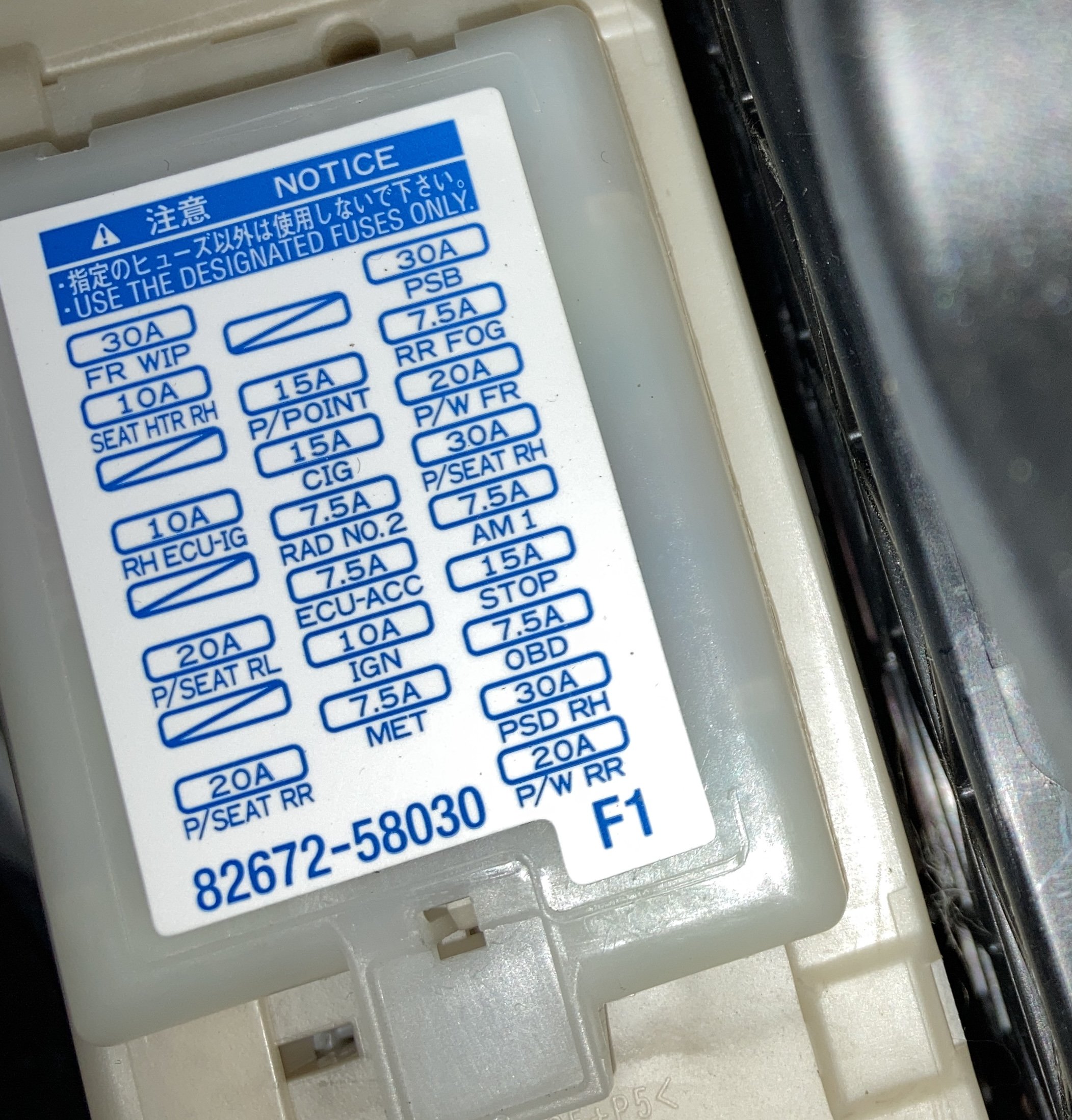

In case it helps anyone this is the left side fuse box.

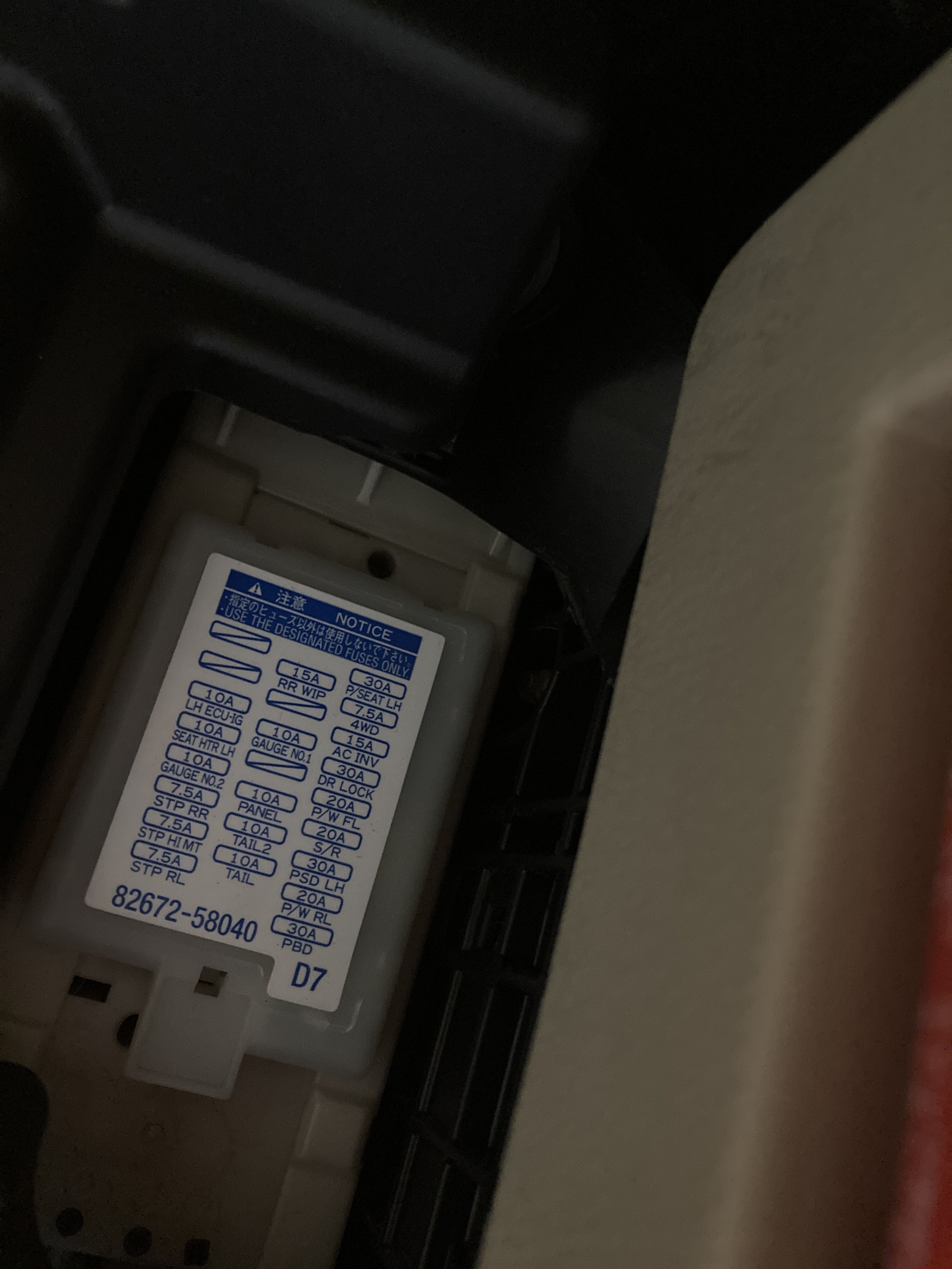

and the right side fuse box.
So mine is a 2009 Vellfire and mine is different. No forget that. I did not know there was a fuse box on the right side aswell lol
