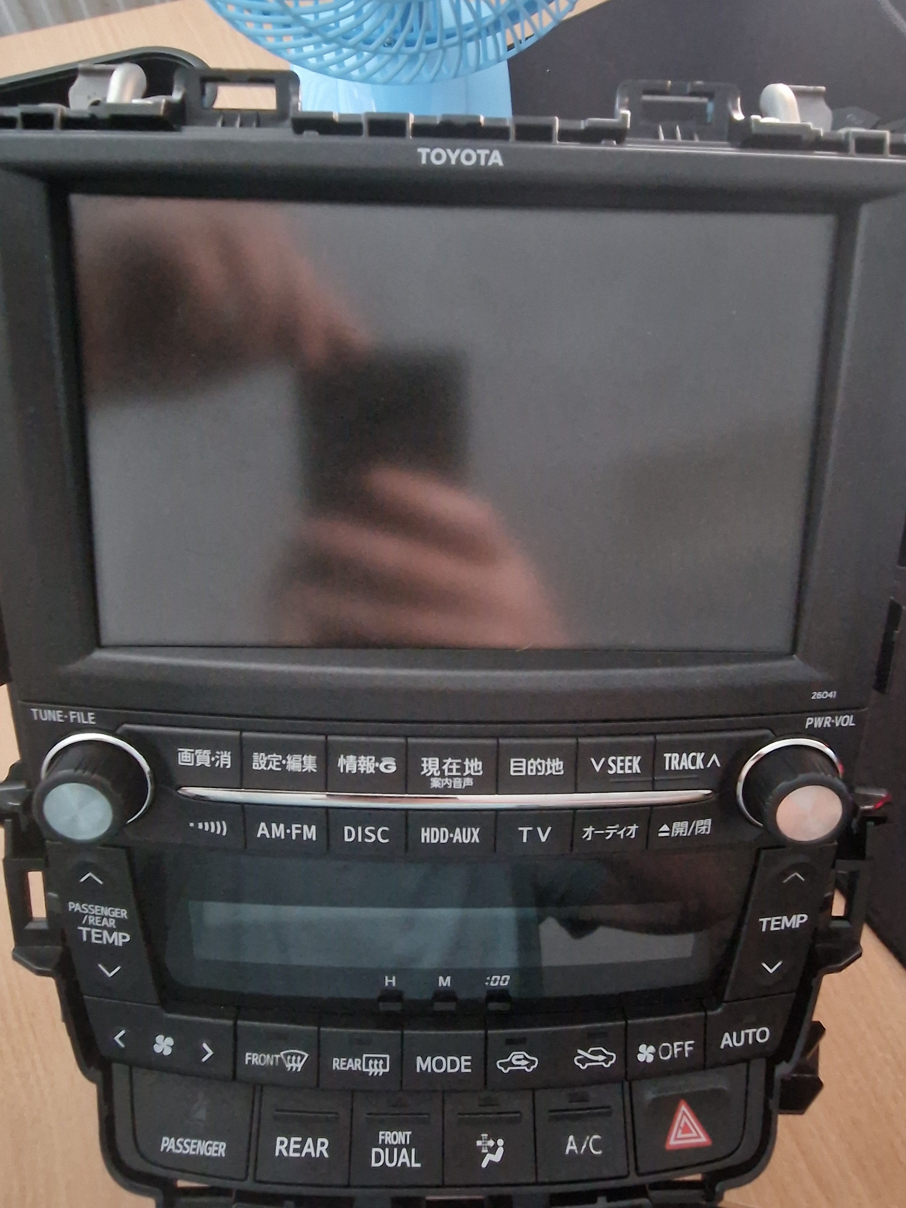

this is the front of the unit by the way.

So does anyone know what third party head unit I can get to replace mine? 26041 replacement I guess?
Edited by Blaman
10 hours ago, Blaman said:
Thanks all for help

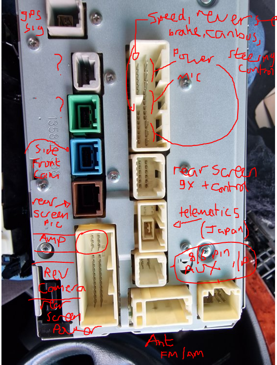

Any double din unit will fit with a surround you can buy, then you need a cable to adapt the plugs to the new head unit. Or you can get an Android system with a bigger screen and a new silver surround. These are a bit more work to fit because you have to change over some parts.
Is it possible you can send me some links? Not really sure what I am looking at.
Did you very get a new head unit that fitted easily?
My 08 Vellfire has had a crap android unit put in so no reversing camera, no DAB, no android auto (it really is cheap junk they've put in).
Looking to get a new head unit that fits, but like you the mess of cables behind these units is staggering!
