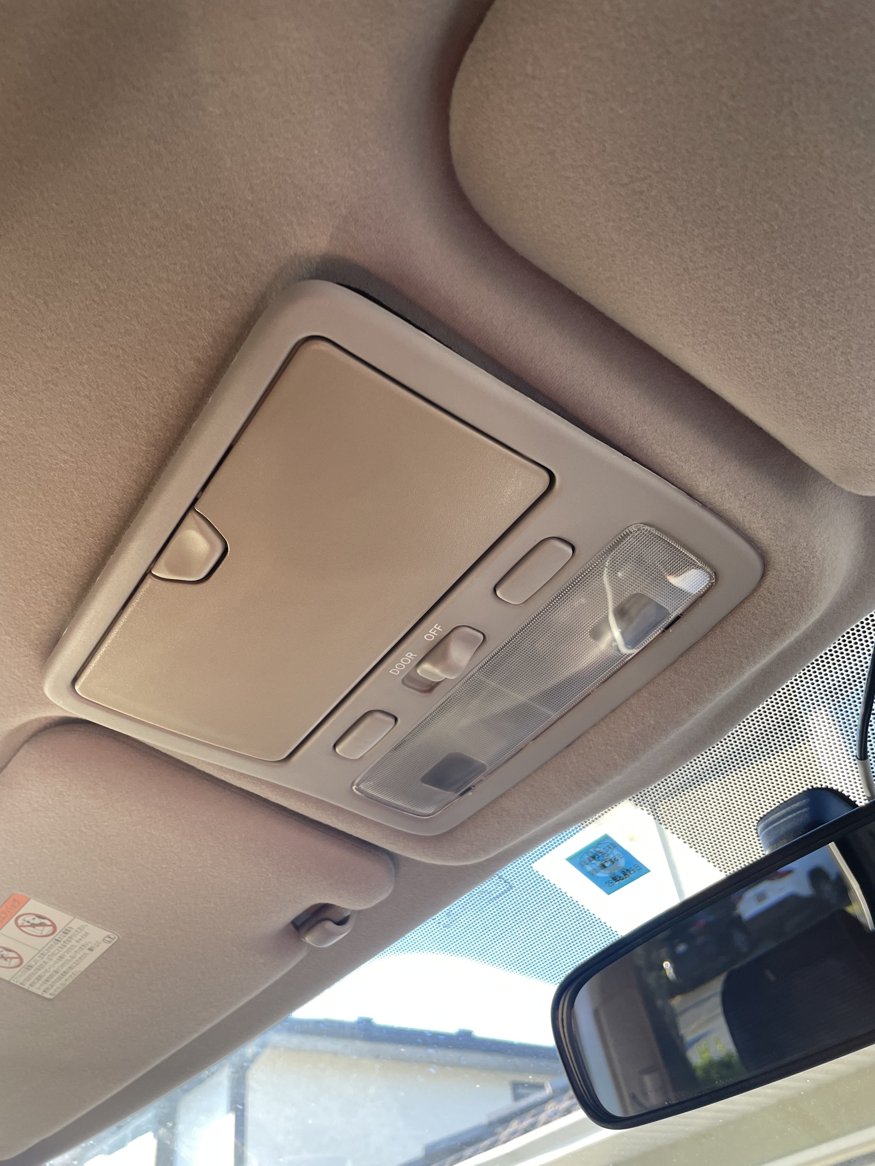

Could anyone point me or provide tips to remove the front overhead console?  I pulled the back side (glasses holder) end and it came loose. The windshield side is very tight. Should I be pulling harder down or slide it to one side?  What is holding it? Clips or screw somewhere?

I don't think you need to remove the entire console to get to the bulbs, just the plastic lens.
It should prise out using a guitar pick or plastic tool or similar.
Chris is right, you need to take the transparent cover off. Don't try to pull full thing out, there are screws under that cover holding it.

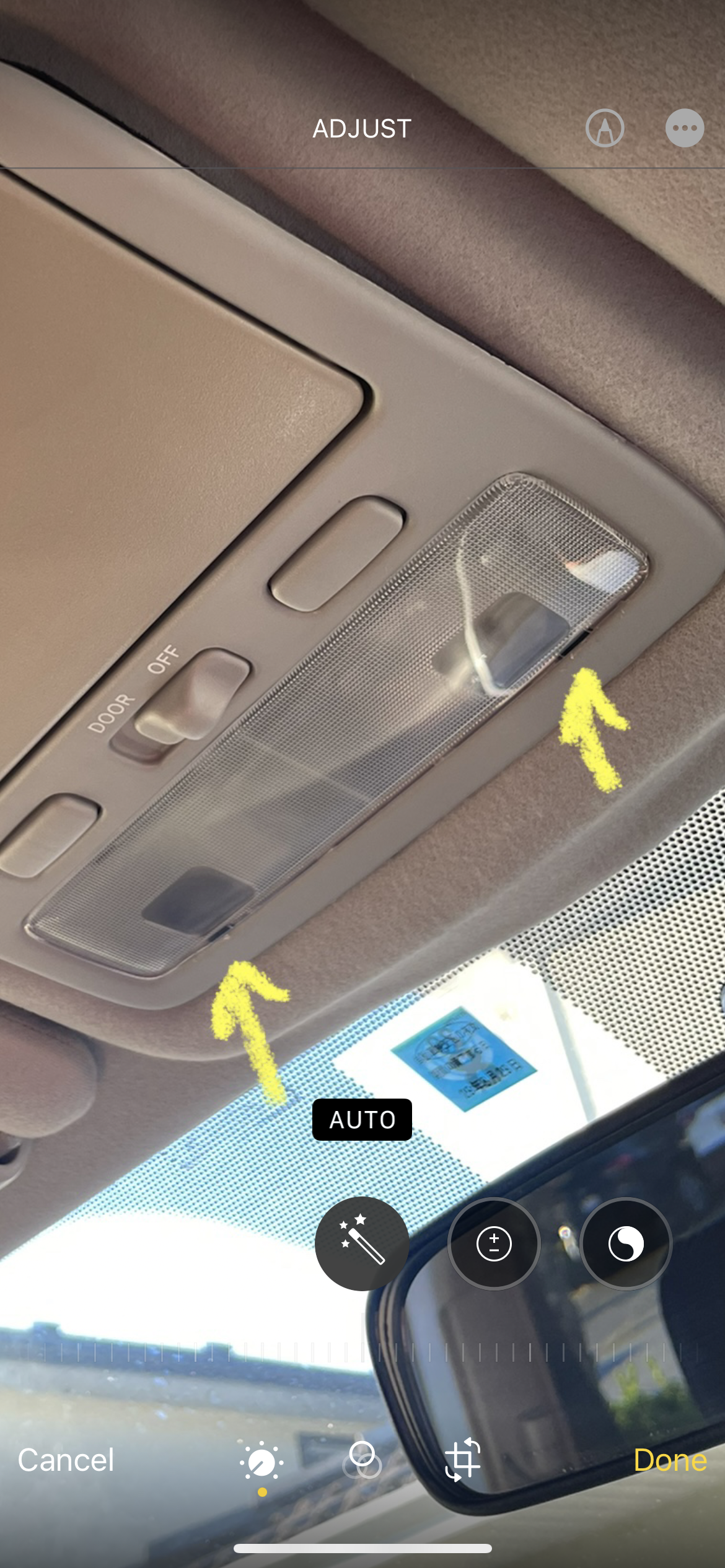

Ok. So work on removing these two cover from these point.

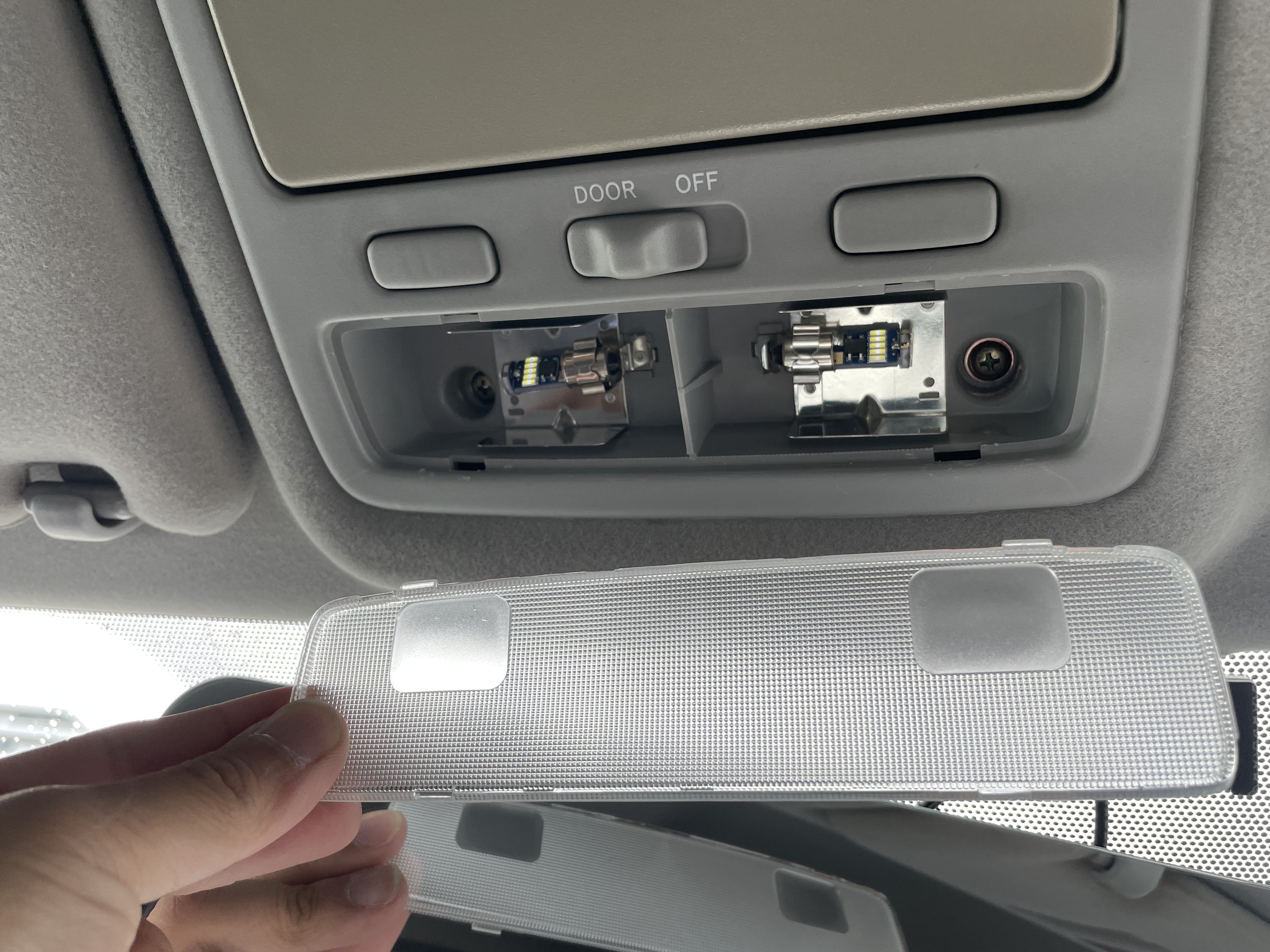

That is the correct part to pull off but you may require a small pick ,once removed you might find it's not bulbs as you are expecting as mine are led strips but that  could just be on different models, if you do require to remove the whole console the hidden screws are under the light strips and I think there is one in the glasses department.

Ok. So work on removing the cover from these point.  Not easy but got it with two tools together to pop it out. See the tabs in my photo.
and yes. There are two screw next to the bulbs.

I think your 'bulbs' have already been replaced if they are LEDs.
I needed to replace one of mine, and is was definitely not a LED.
I know that LED replacements are available, and probably brighter and more reliable.
So you would probably need to replace all of them to achieve an even brightness !
