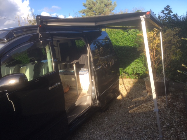

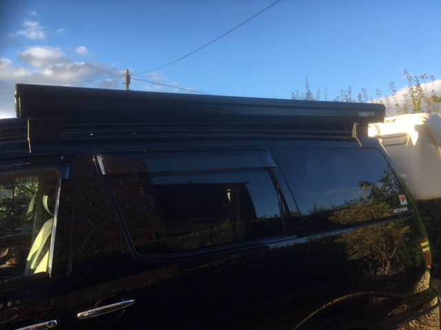

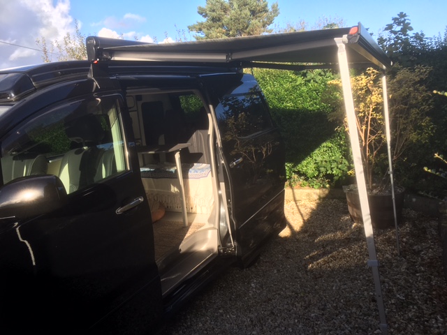

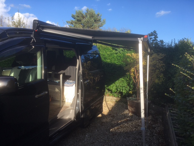

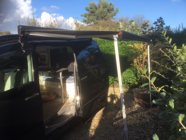

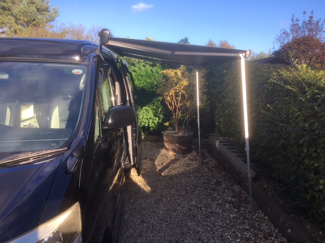

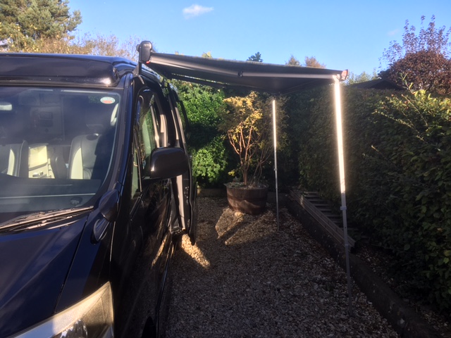

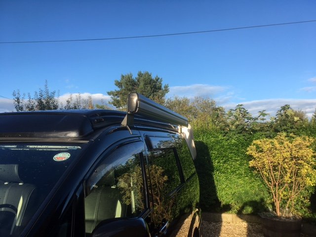

Hi,
We have a F45s windout awning fitted
Brackets £109 delivered from www.jshfabrications.co.uk
We went with the 2300mm awning think the 2600mm one looked too bulky on camper
Local caravan place fitted

Hi, as requested Chris, pics of awning in setup

That looks great.  Did you have a drawing.that you sent to the fabricators or did you buy the awning and take it too them with the van and ask them to make something up?  I have a local fabricator who could almost certainly do the same but.wondering how best to proceed!
Also, how is it attached to the car?  Bolted through?

Hi,
We got brackets from JSH Fabrications ( he makes for a campervan firm HL Campers )
The newer modified brackets are 30mm shorter than we had fitted also holed for rivnuts on the front and rear of bracket and fitted along with sikaflex
Thanks for the response Ronnie, I'll get in touch with JSH direct then.
