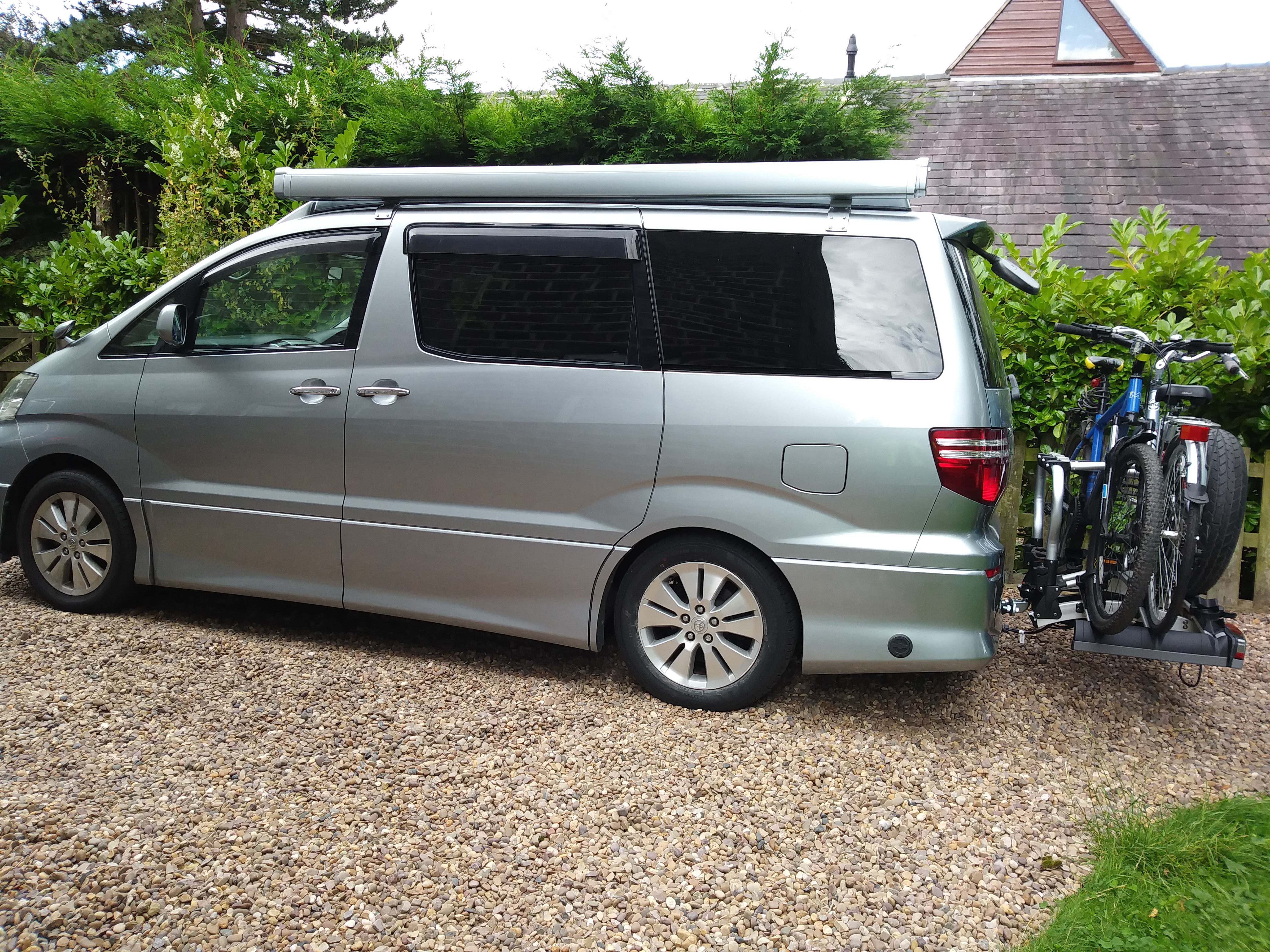

Hi Dick,
We also have LPG and use 2 options for the spare. When not pushed for space (e.g. shorter trips) the spare goes under the R&R bed; but we have a side conversion, so it's out of the way generally - which I guess wouldn't be so easy with a rear conversion. Alternatively we can put the spare on the (towbar-mounted) bike rack - 2 bikes & spare wheel on a 3-bike rack. We had to fabricate a steel clamp which has a bar on one side (to mimic a bike bar) and wheel bolts on t'other side (to mimic a hub). The spare then takes its place as the third bike; also rachet-strapped to eye-bolts (in place of the bike wheel wedges) as an extra precaution (not shown in photo...). Good for long trips - the only downside is that the spare has to be last on the rack, so not so easy to get the bikes on/off quickly.
Incidentally, I'd recommend the Atera Strada Evo or DL bike racks - they have a roller pull-out system so, when unlatched, the rack can be pulled away from the rear with the bikes still on to allow enough room to lift the tailgate. T'was a great find!
