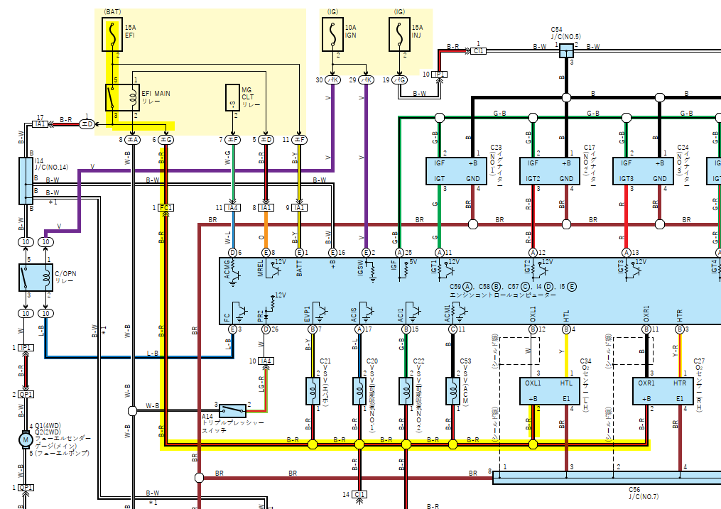

Geralt Posted January 29, 2023 Share Posted January 29, 2023 17 hours ago, AlphaMZ said: where's the oxygen sensor fuse located? There may not be a fuse just for the oxygen sensors but there's more than one Engine Computer fuse in the list here: Having read the list, there doesn't seem to be a fuse for each sensor so it's unlikely that is the cause is a fuse otherwise you would get two P-codes. Quote Link to comment Share on other sites More sharing options...
Geralt Posted January 29, 2023 Share Posted January 29, 2023 18 hours ago, AlphaMZ said: where's the oxygen sensor fuse located? It's definitely fuse 8 in main engine compartment....but it's definitely not a fuse problem. You can see in the attached diagram that the sensor heaters share a fuse with a bunch of other stuff including the fuel pump. If the fuse had gone you wouldn't be able to start the engine. Quote Link to comment Share on other sites More sharing options...
MonsterS Posted January 29, 2023 Share Posted January 29, 2023 The oxygen sensors are connected directly to the ecu so more than likely it's the sensor itself or a fault in the wire or plug. Quote Link to comment Share on other sites More sharing options...
