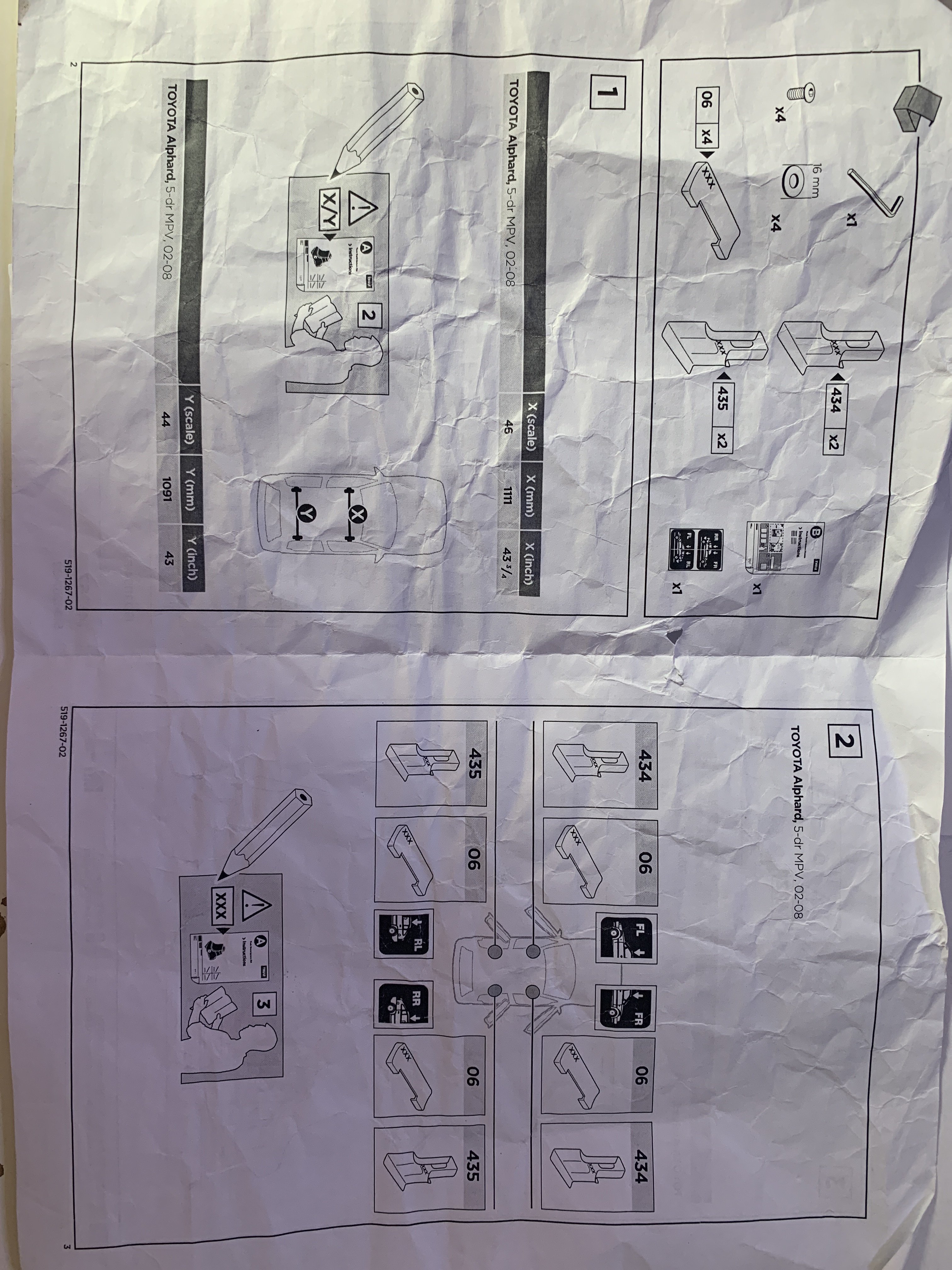

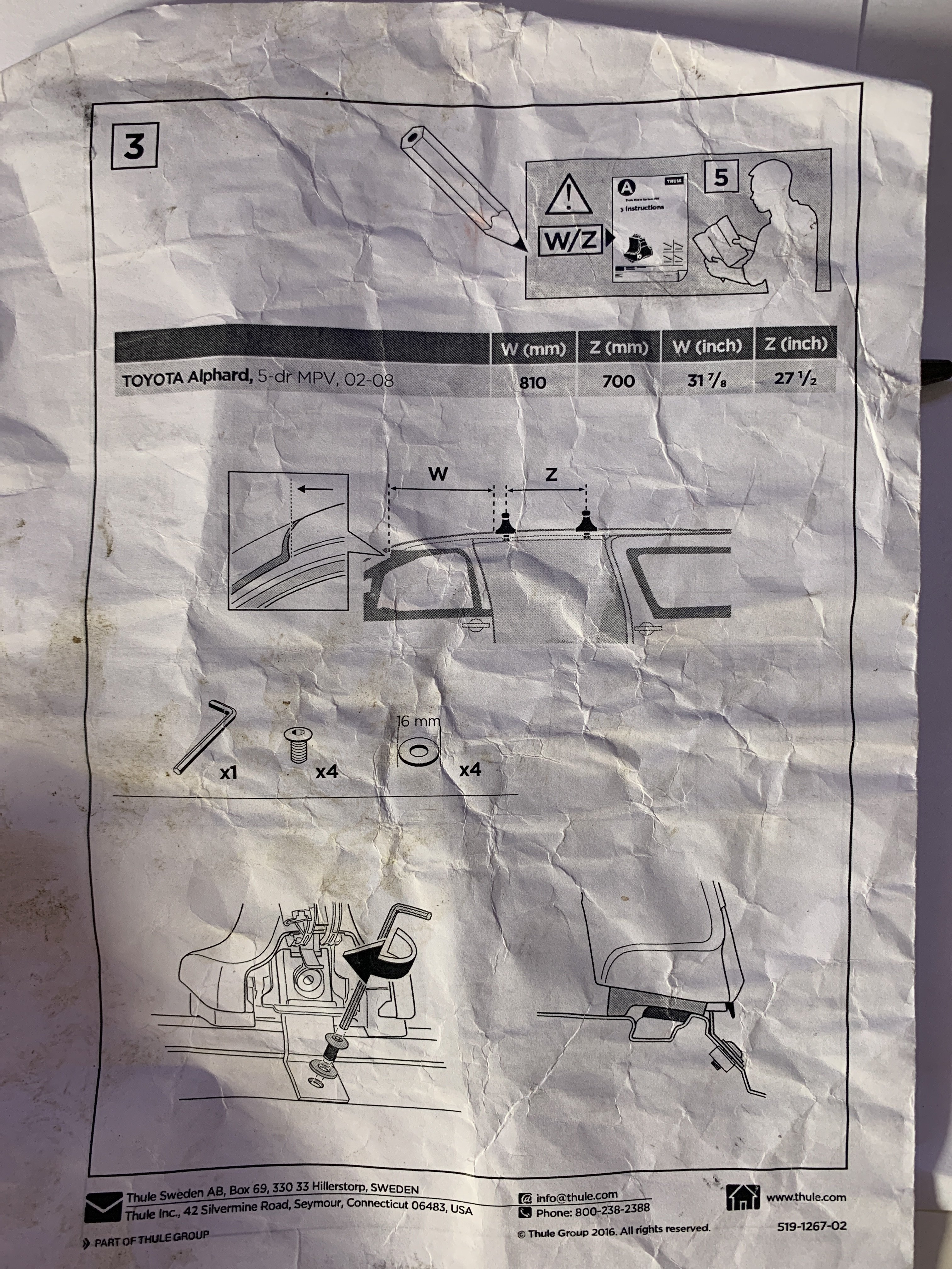

For a Thule kit it’s the bits which bolt onto the roof which are very difficult to get in the UK. There’s a chap called Ben Hau who imports them, I think he’s a bit of an Alphard expert, find him on Facebook and see if he has any in stock. The kit number is Thule Rapid System 1267, for 2003-08 models. You can then fit any of the Thule rapid system feet (loads on eBay, cheap) and any number of Thule standard or Evo bars but need to be at least 135cm width. Good luck.
