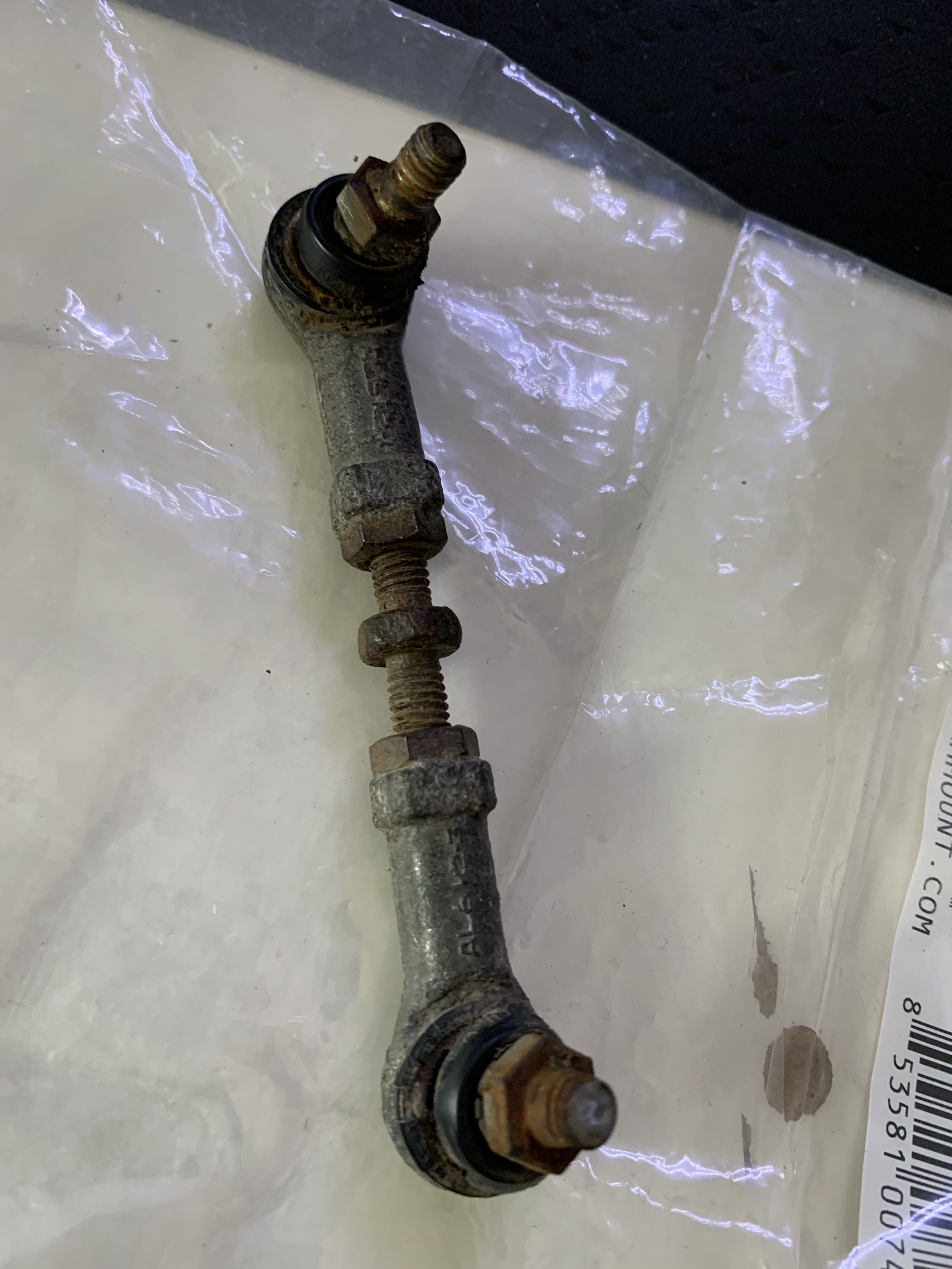

On my 2005 v6 it’s attached to the rear drivers side wheel. Same on my mates 2003 v6. I would guess same for all Alphard’s. It’s very prone to seizing in British weather (wet, dirt, salt kills the rubber and metal).
I’ve just had to replace the ball-joint levelling arm, see pic of original which has clearly had too much British road salt and not enough cleaning. It has completely seized and was the source of a loud squeak from the R rear; I’m just relieved it wasn’t something more expensive.

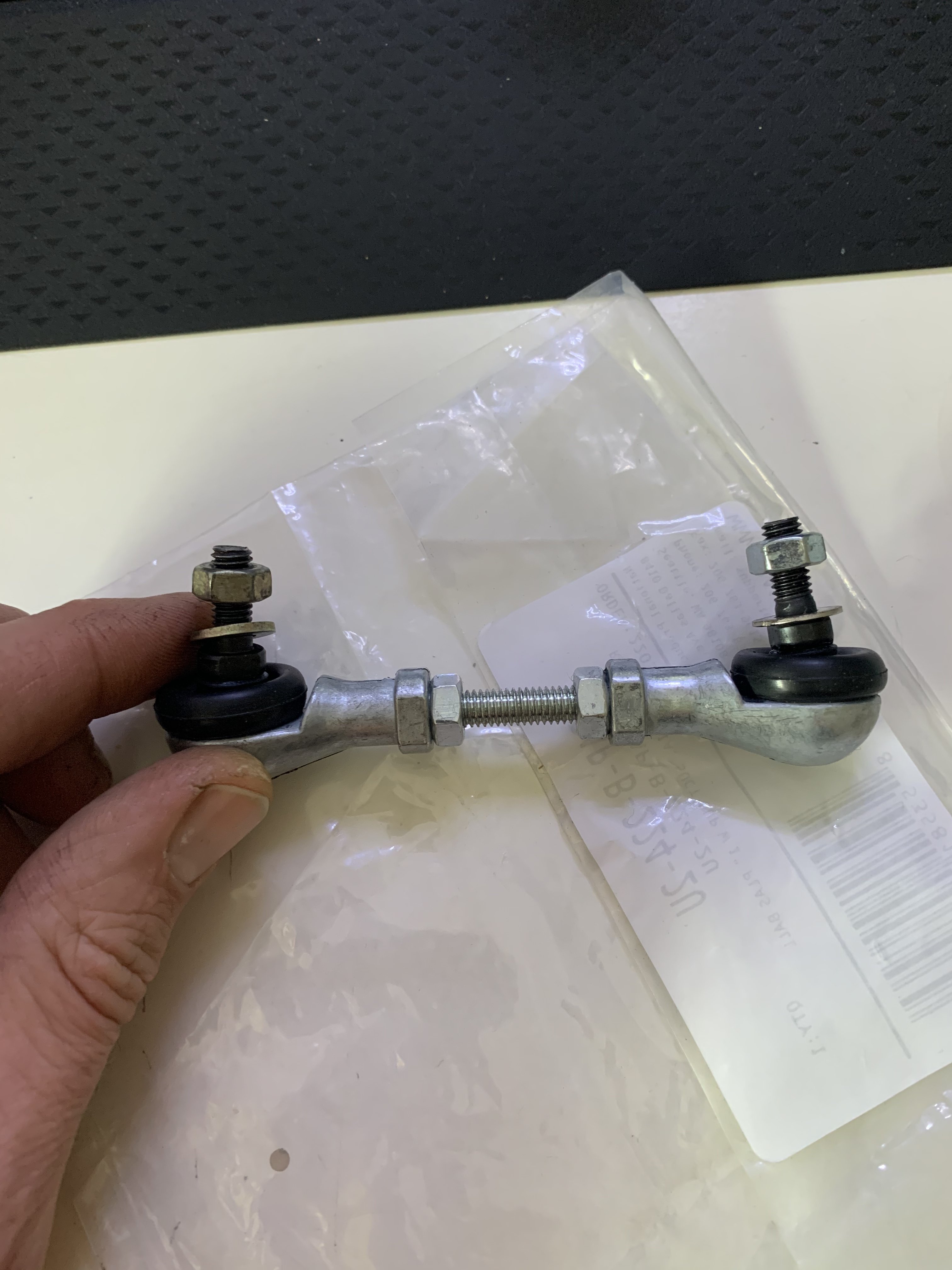

I replaced with this rather nice item I bought on eBay for £14 delivered. I did have to cut a longer connecting bar (M6 threaded bar, cut to 50mm; it came with a 40mm bar which would only just have done it). I also added the washers and the nuts to secure the connecting bar length. Total time to replace was 10 mins; quick clean up down there and some liberal application of ACF50 and all looks good.
