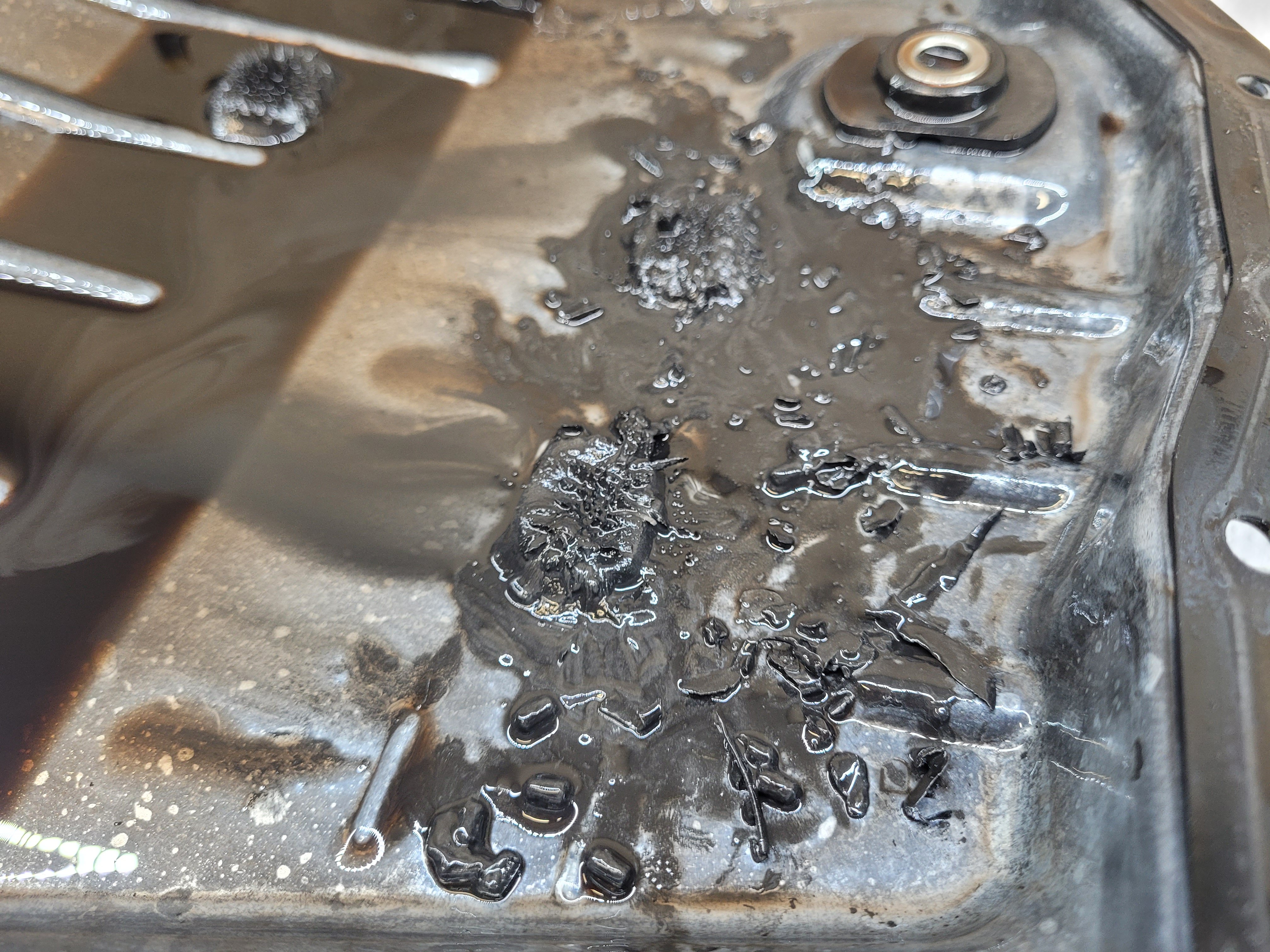

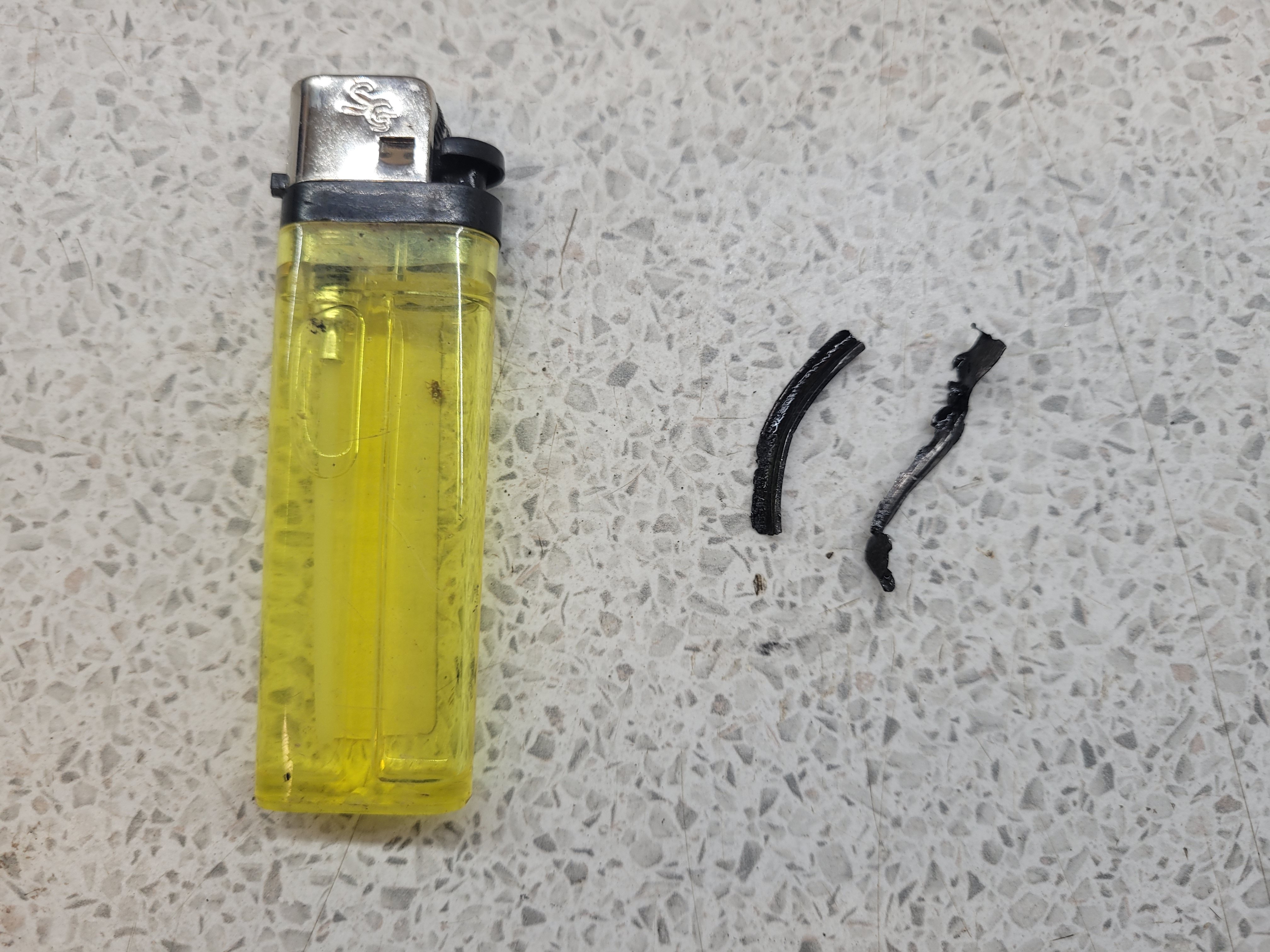

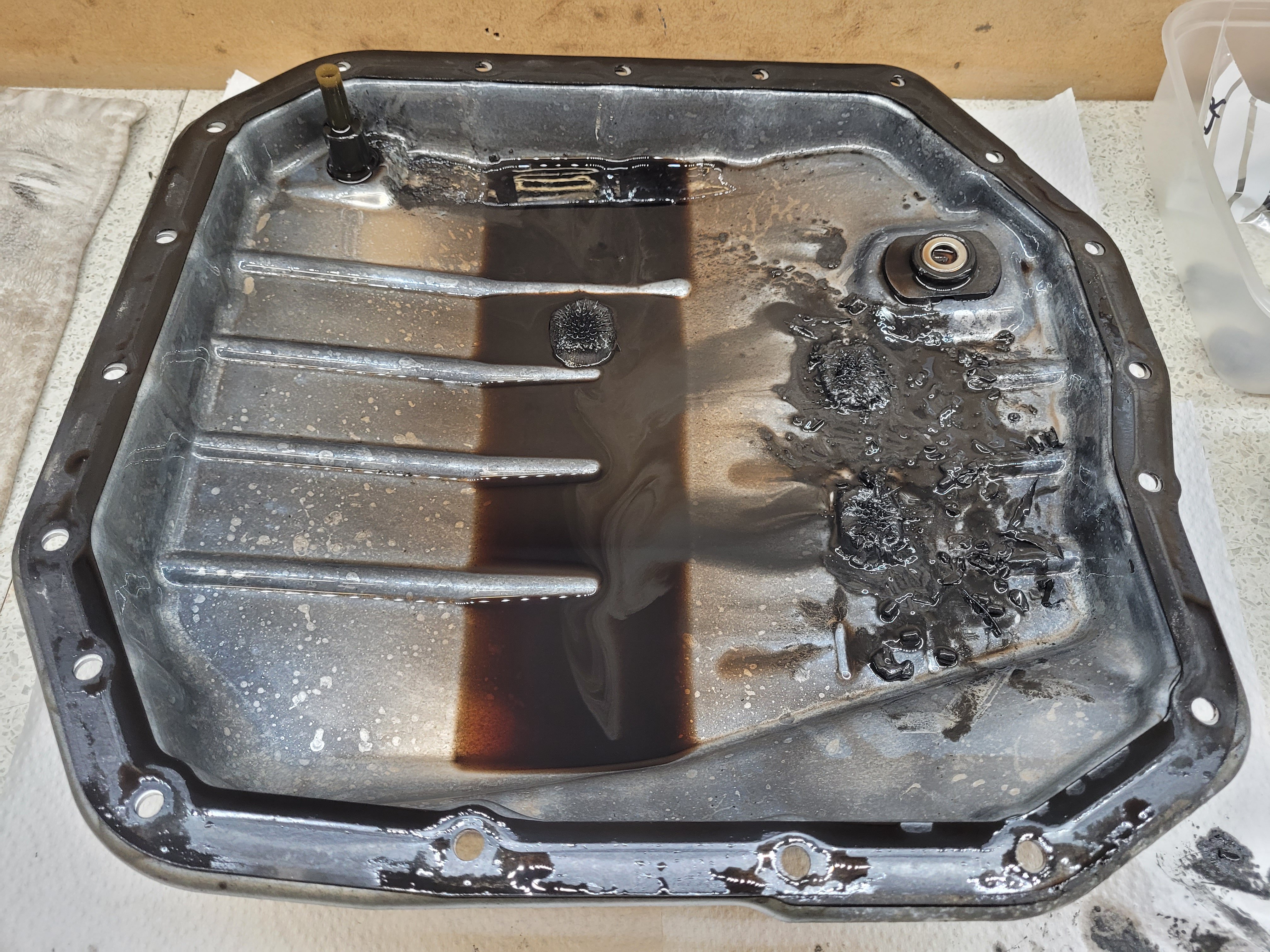

Hi. We finally got round to draining oil and removing sump (there was just over 5 ltrs of oil ) and dropped the sump. The sump was full of metal as per attached photos. The 2 biggest bits of metal are shown against a lighter for scale.
Assuming something is seriously wrong with the gear box. Any advice would be appreciated.
Those little metal cylinders in your sump are evidence of a roller bearing failure - sorry. It’s very likely that bits of hardened steel escaping a bearing will have done further damage elsewhere. Did you also drop the strainer? A full inspection and rebuild likely more expensive than sourcing a replacement (used, possibly refurbished) gearbox.
Edited by anotherdom
Yes I did remove the stainer. Going to source another gearbox. Thanks for your reply.
