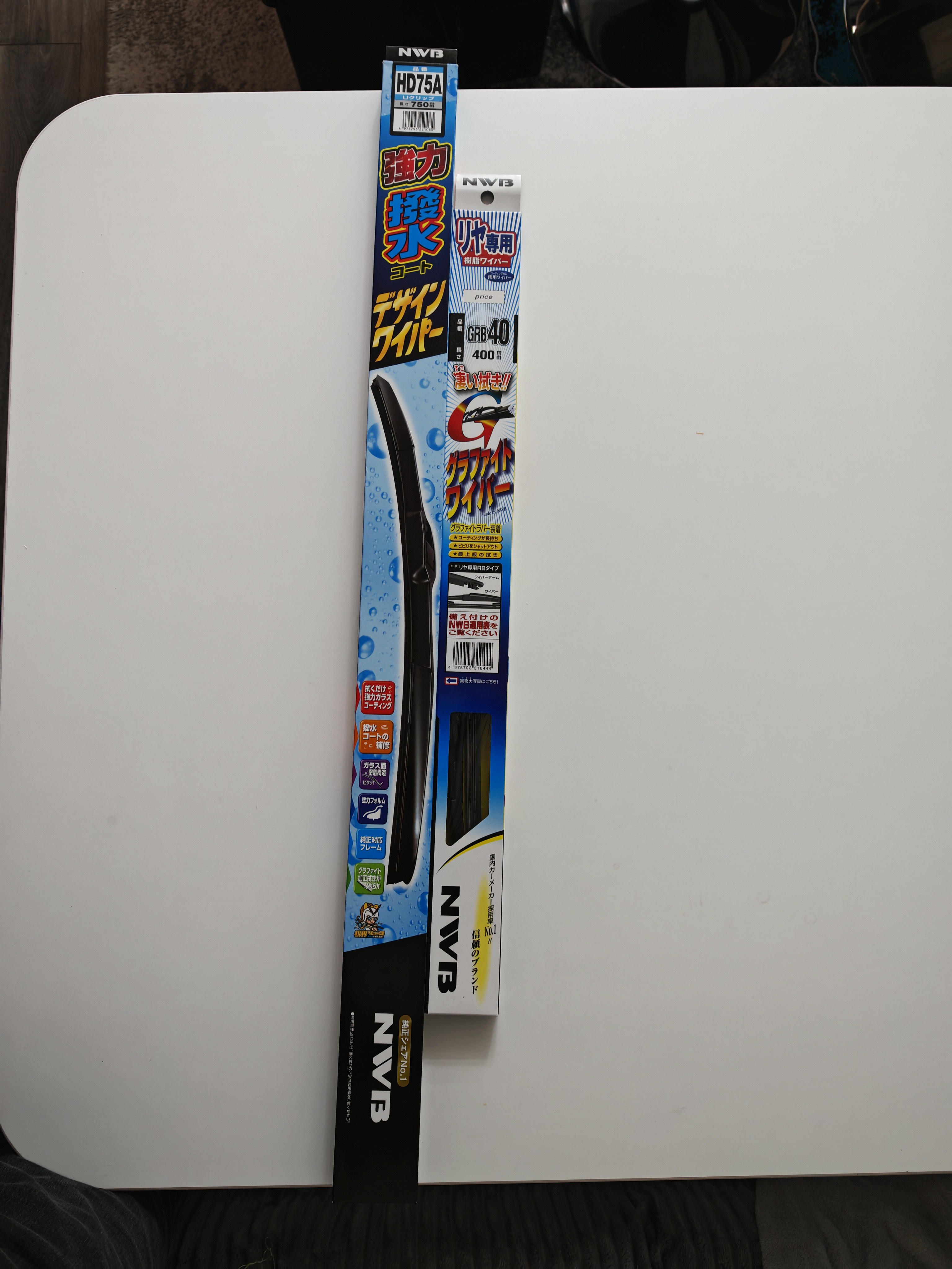

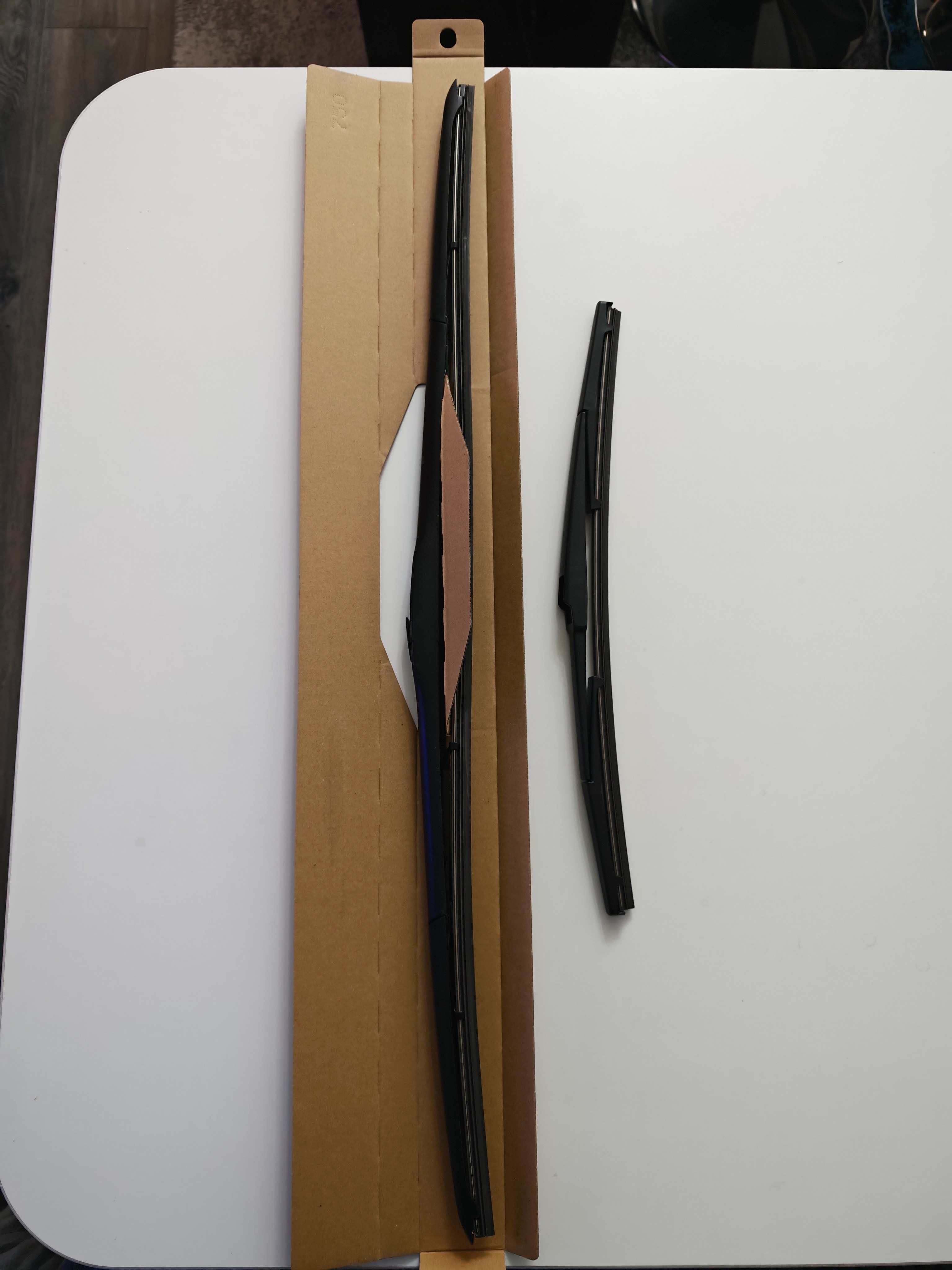

About two weeks ago I've ordered the wiper blades from Amazon.co.jp
The rear one and front driver side just arrived today. Stil waiting for the passenger side, should arrive by Monday next week. About £52 (£25 for shipping only) so I think it's not bad. 2 weeks awaiting time is also acceptable. Will replace them when the passenger side wiper arrive.

For the front ones:
https://amzn.asia/d/1X8kPAj
Just select the length (HD35A - passenger side, HD75A - driver side)
For the rear one:
https://amzn.asia/d/3cxwHA9
And select GRB40
Before ordering you need to make an account on Japanese Amazon ( very easy to do so, you can do it in English).
Hope it helps

It's a full blade assembly.
I will replace them all together when the passenger side wiper arrive and I will share my opinion.

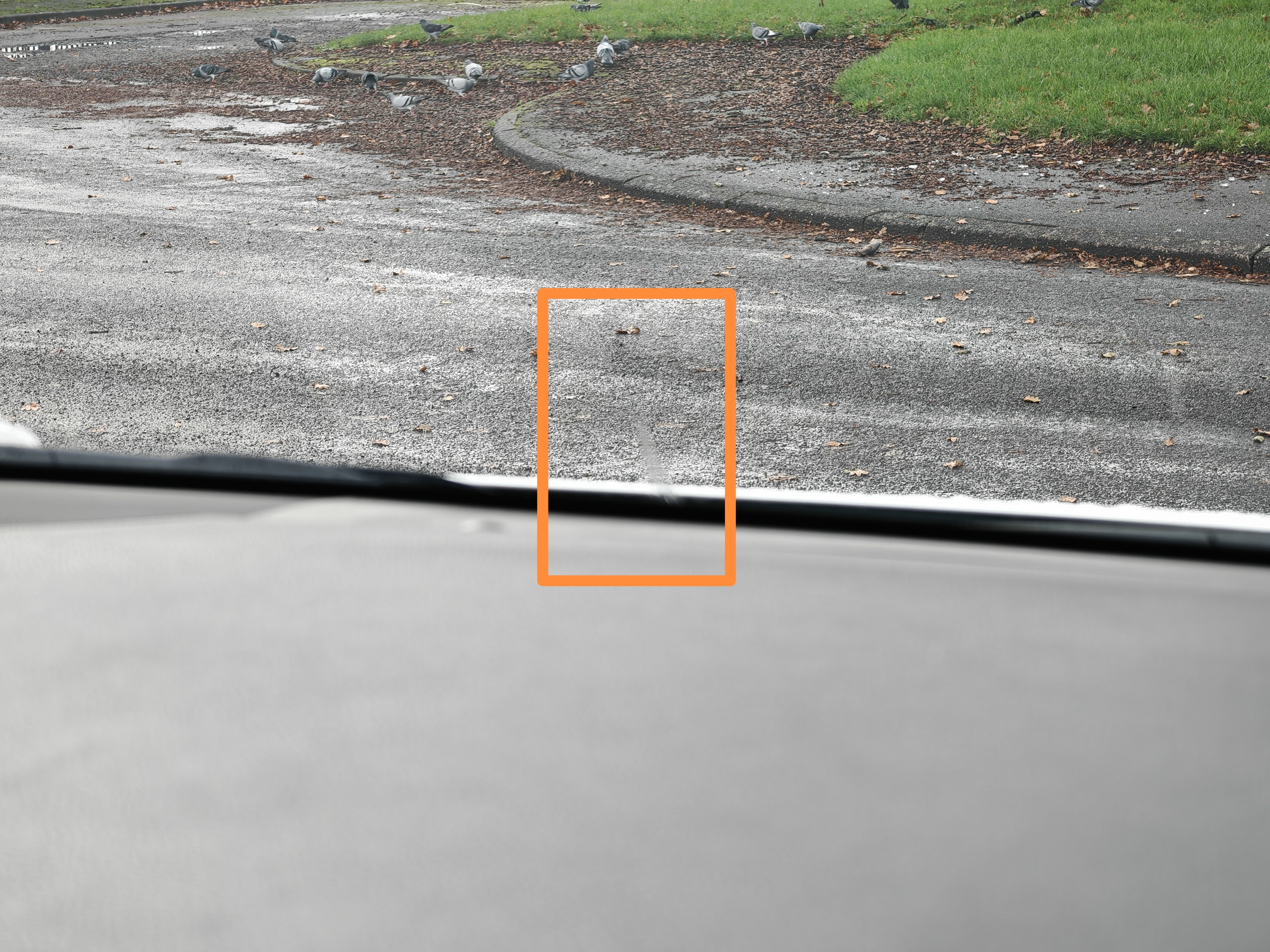

So, the wipers are replaced (passenger side wiper arrived today morning) I tried them and everything seems ok for me. There's a small section left unwiped at the bottom of screen on passenger side (see picture) but it's not really affecting visibility. Will test them properly when some rain arrives (don't need to wait very long for it I bet 😜)
I'm too OCD to buy something that will leave a tiny mark on my windscreen. I tried replacing mine with the Bosch ones but they were too small. I am now due to get a replacement for the back so will commence my research. Will check out what bodekUK suggested.
