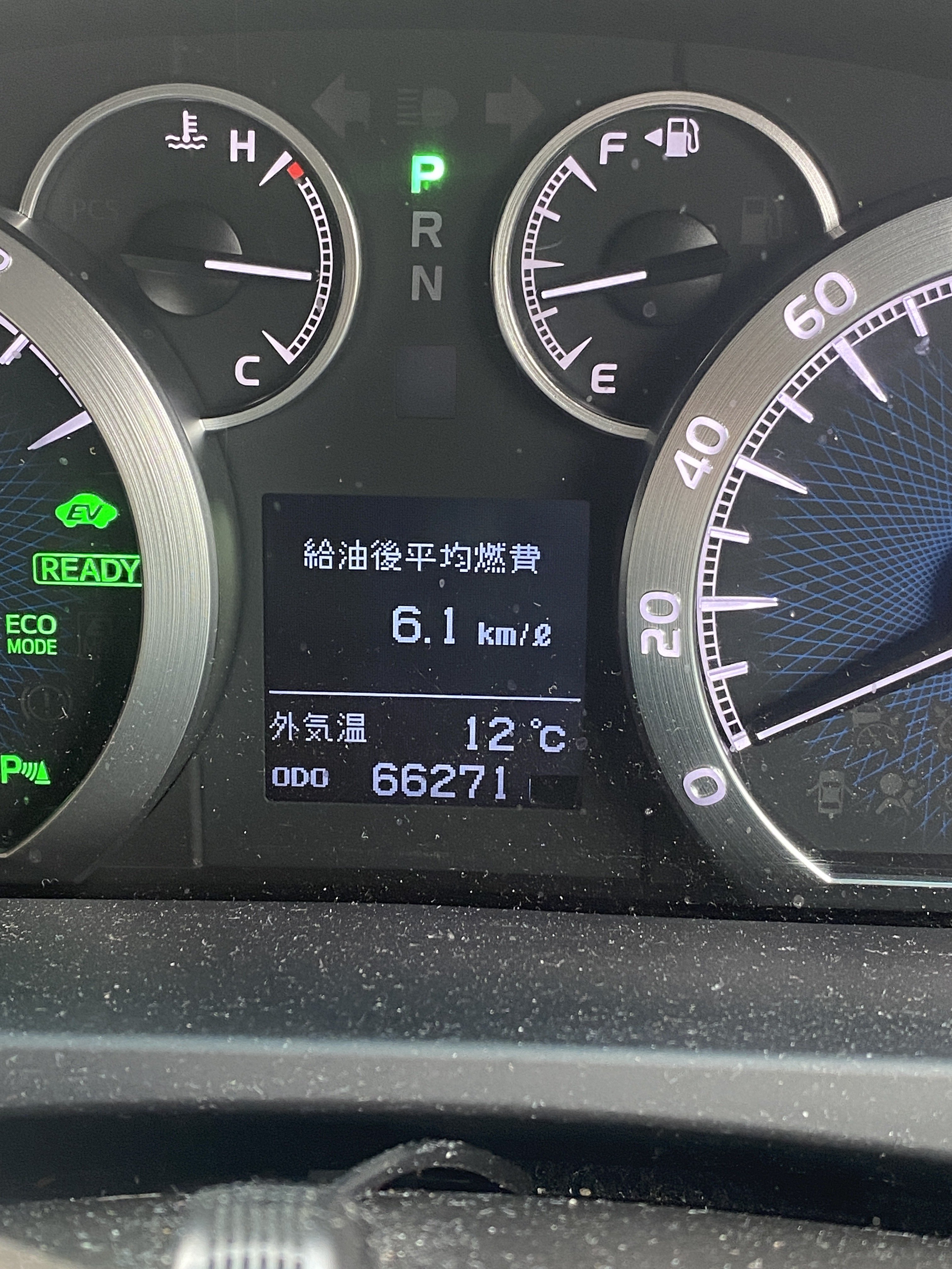

On 4/24/2023 at 11:52 AM, Jorge Velasco said:
Just got a 2012 2.4l hybrid and am averaging only 6 km/l on ECO mode. What could be wrong?

On 4/24/2023 at 2:47 PM, Jorge Velasco said:
Based on the photo? Unless this is very inaccurate?
My dash odo and Speedo are converted to miles and it has done the consumption also, so mine is saying 6km/l but I'm getting 28mpg calculated fill to fill.....that's 6m/l, so if yours is the same then you are getting the same as me.....although mines an na 2.4 not a hybrid.

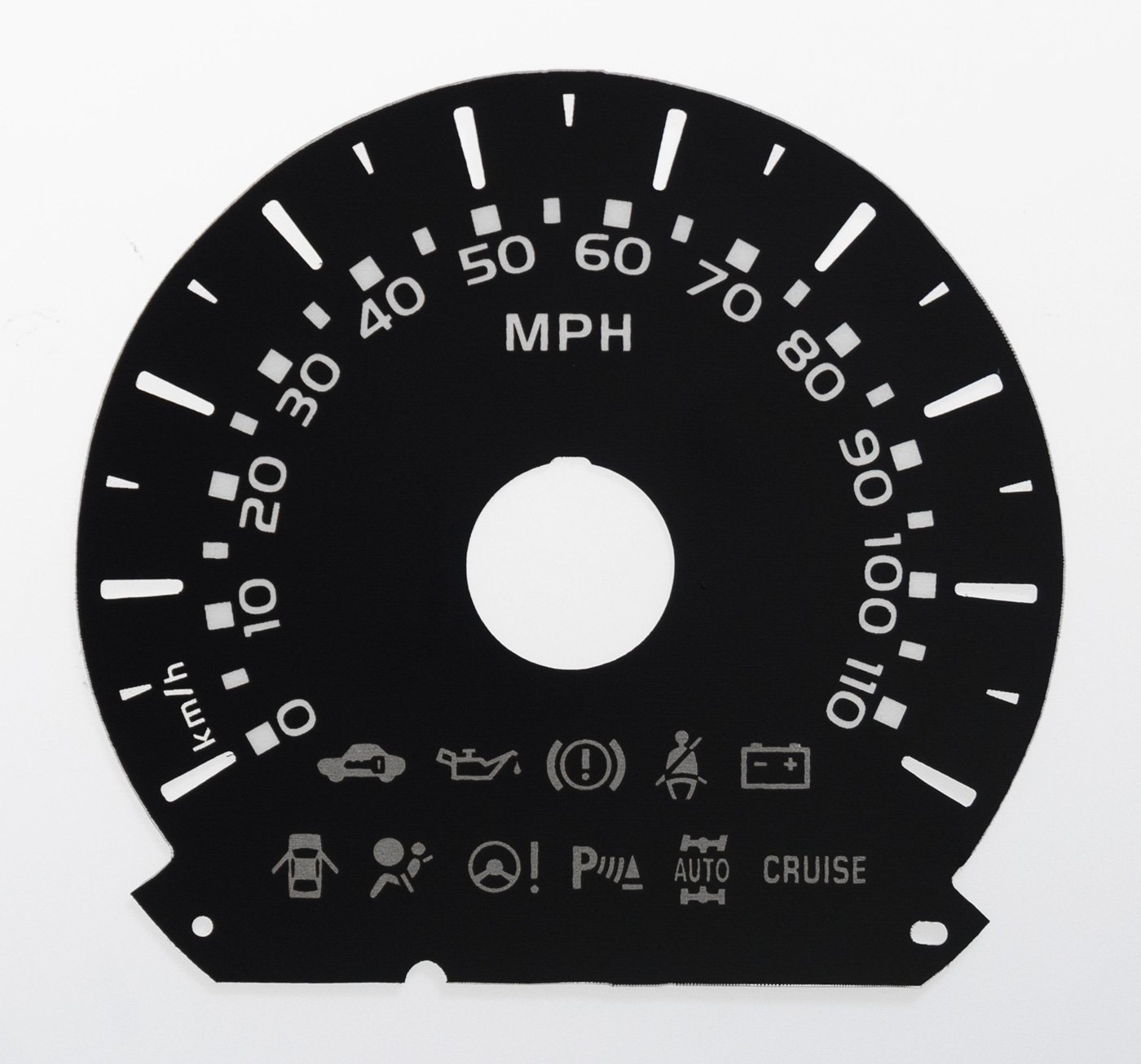

There is a lot of confusion with the dash display in this post.
If your cluster has a speed fascia like mine like this one below... then your fuel computer still works in KM/L, along with the odometer. Nothing has been modified other than a new scale is printed on the fascia.
C1833-Toyota-Alphard-Vellfire-B-MPH-Speedo-Dial.thumb.jpg.6a7cd518360214c0b4e7f1e49c75f85c.jpg

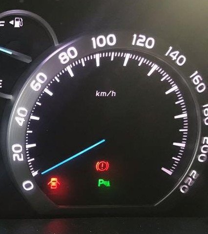

But if you have an original fascia like this one below, then you have an inline KM's to Miles converter wired into the harness to the cluster, so all the values displayed are really miles, including the fuel computer, the odometer etc etc. The display still has the units as KM/L and KM's, as the display is original but the display is really showing miles as the converter box is manipulating the speed values sent from the ABS module which measures the wheel speeds/rotations.
134a5819-22da.jpg.dfd614d7138441819290019ed95cbf40.jpg.72e1b771d7daf539da3e491df15ac300.jpg
So make sure you are doing your calculations appropriately to the odometer conversion that has been carried out. Many of you are really getting a reading of miles per litre.

I think it has been a fairly common practice to 'black out' the k in the km/h legend.
I was more referring to if they are using the original outer ring of numbers then its on a pulse converter,  it was the only picture I could easily find.
And yes, most people who fit a pulse converter just put a little square of black tape over the "K".
