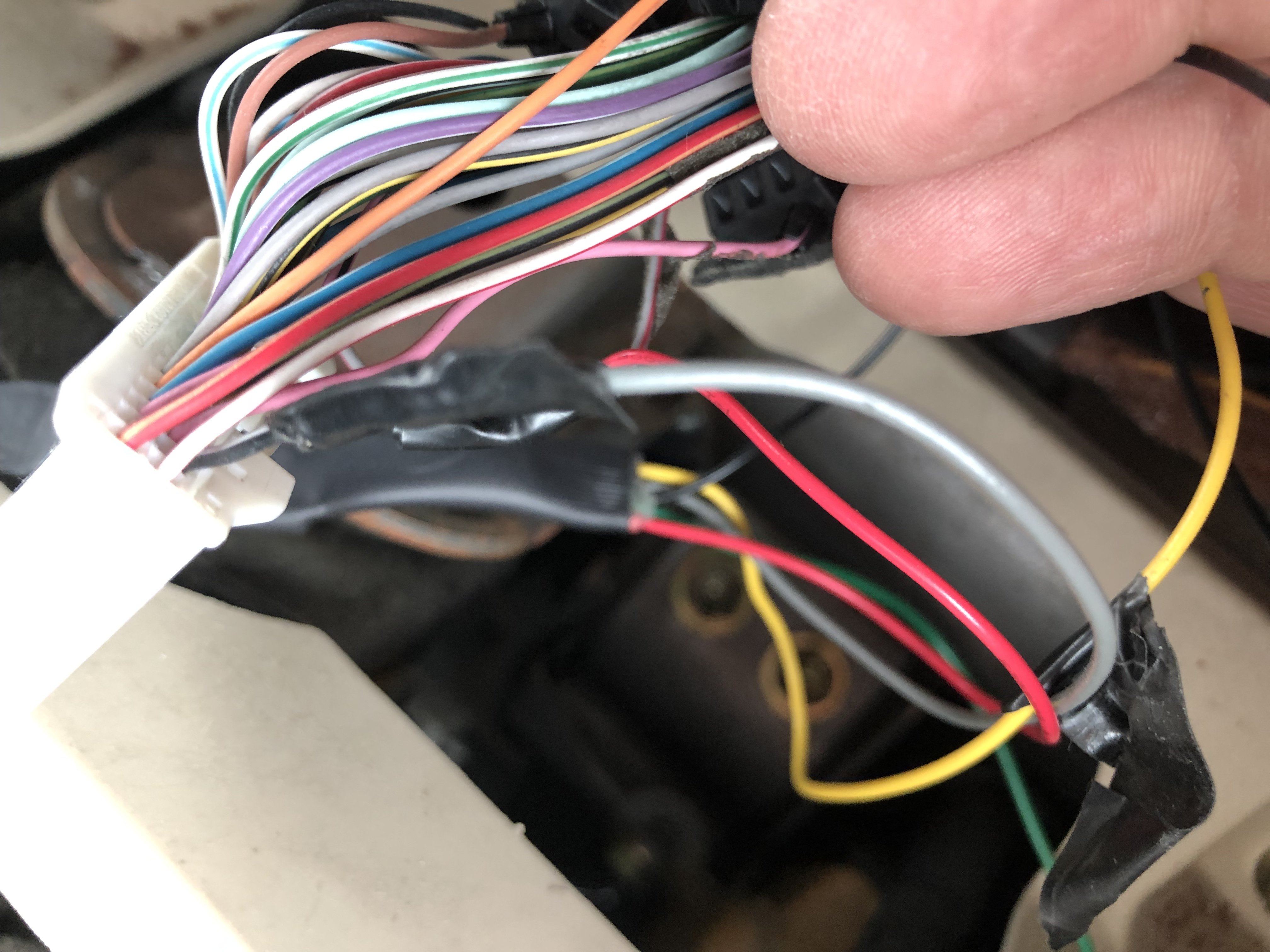

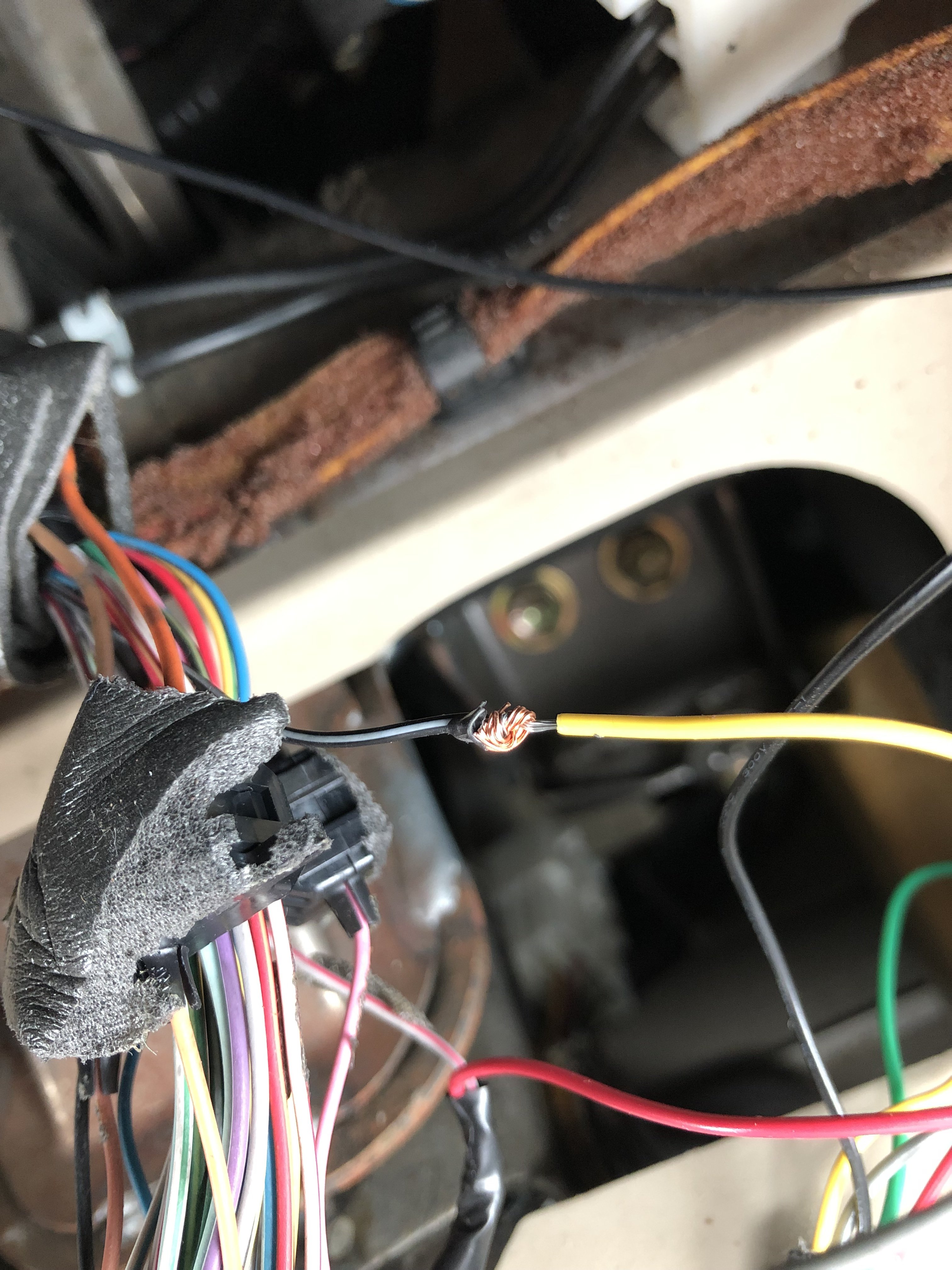

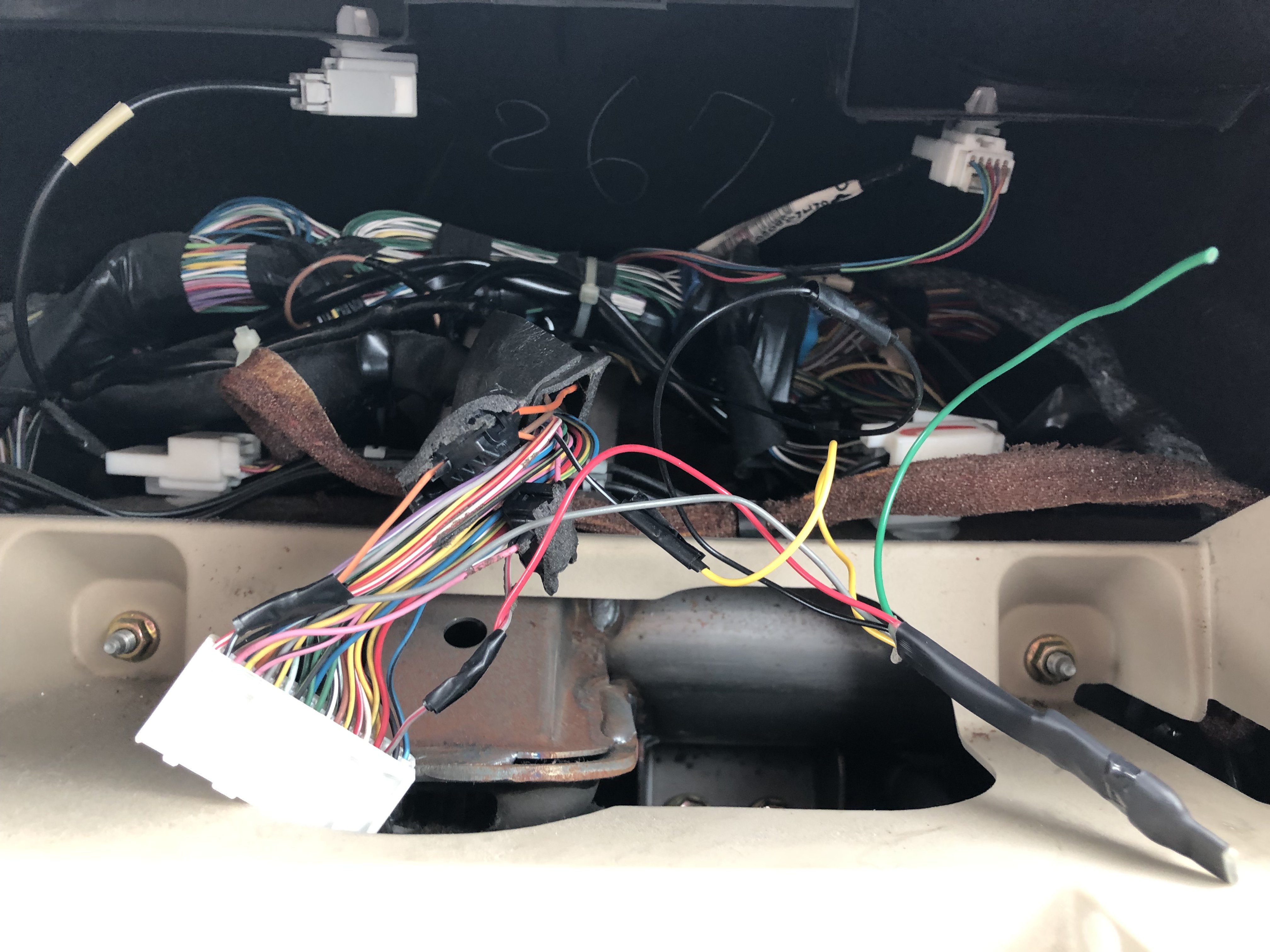

Pulled the instrument cluster out to have a look. Found a km to miles adapter thing. Not soldered in.... wires wound around each other and taped.... removed that, to see if putting it back to standard helped. Result was speedo now reads in kms not miles (to be expected) but odometer still not working.
Tried to identify if there was some kind of other device there... a 'mileage blocker' that I've seen advertised... don't think there is. Any idea how to address the non-working odometer. Anything to look for on the board of the speedo itself? haven't opened that up yet.

attached are a couple of photos of what was back there. Not that pretty.

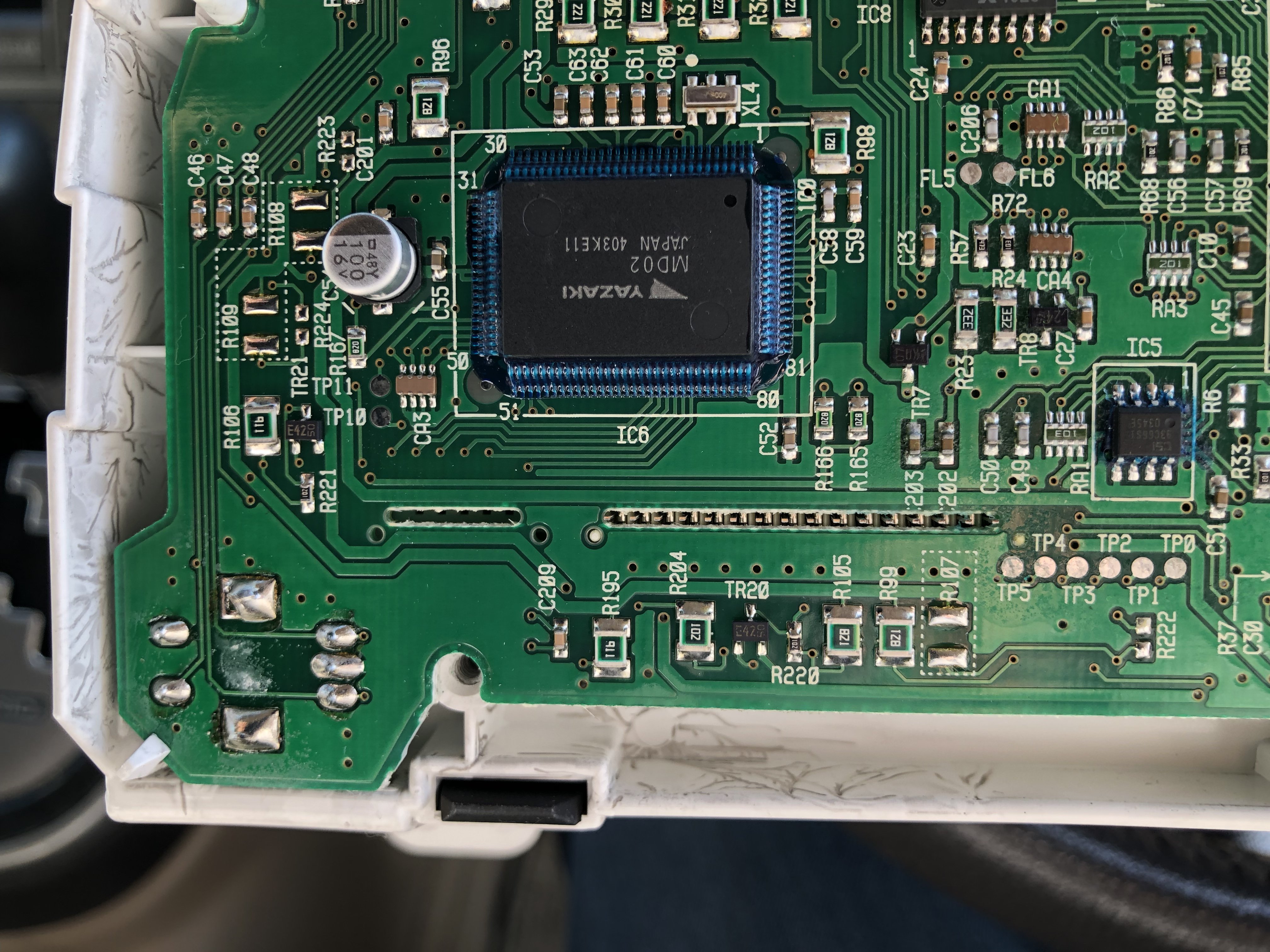

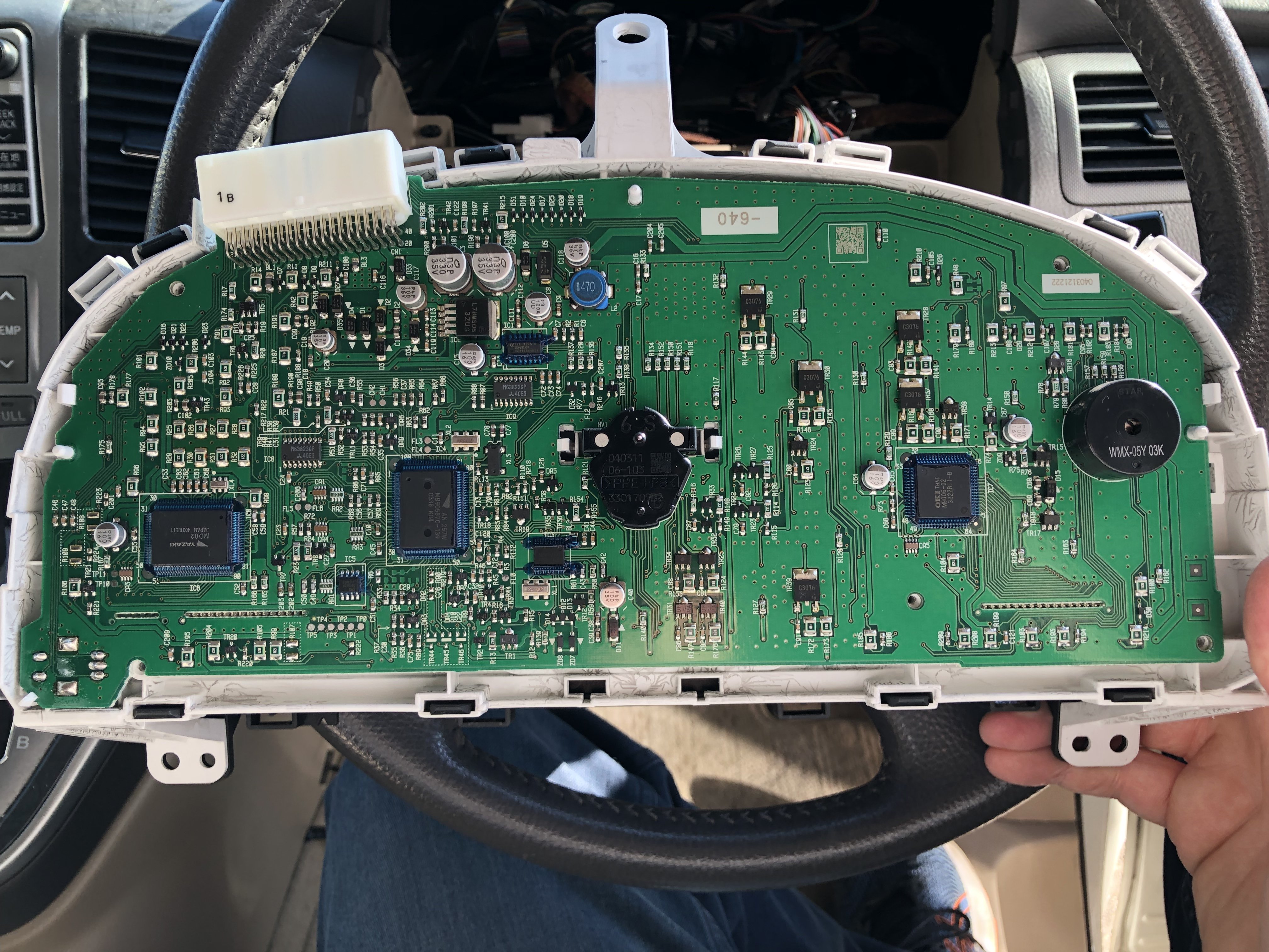

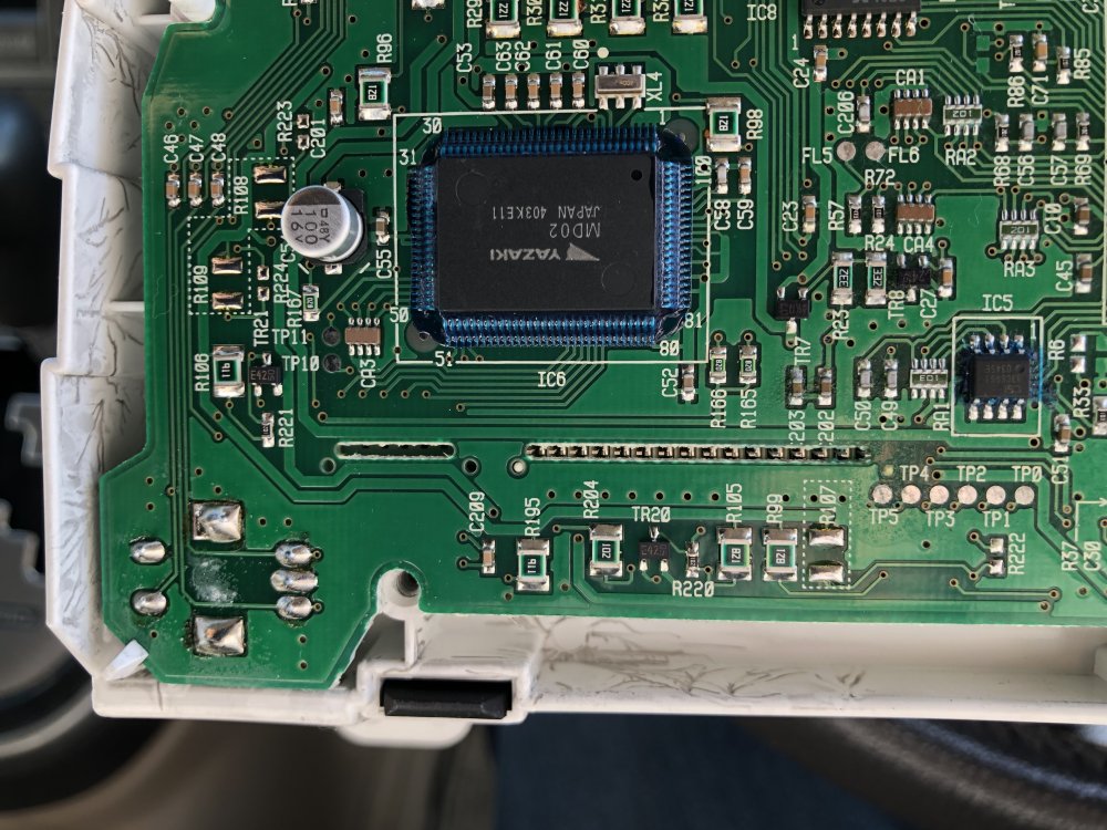

I decide to take the back off the speedo cluster to have a look at the circuit board. I felt sure someone had been in here before because there was a screw missing and various screwdriver type scrape marks. And my odometer is showing 5 figures eg 61,223 miles or Kim’s ( not sure) whereas I expected it to show 061,223 ?? I don’t know if this is a fair assumption as I don’t have anything else to compare it with.
Anyhow, I attach a pic of the back of the board … if anyone else has a similar pic it would be useful to see to compare. My attention was drawn to the bottom left corner which is where the odometer display is…  resistor R107 and resistor R222 might be missing on mounted on the other side of the board?
again, any suggestions gratefully received. I want to get to the bottom of this and get the odometer working again.
