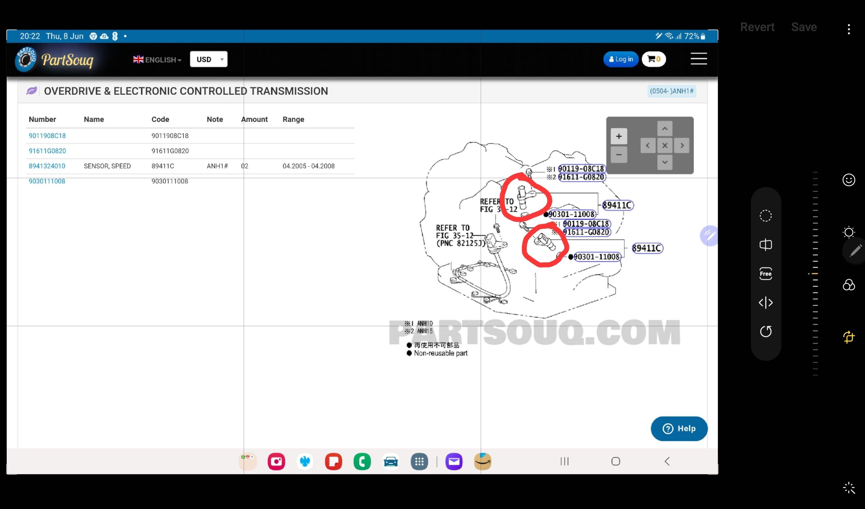

You have 2 speed sensors on the gear box both the same part no. If you give me a reg no. I will attach a drawing for you
Ah, ok, it’s LU02 ZEN, thanks!
Thank you Lee, I'll get a couple ordered.

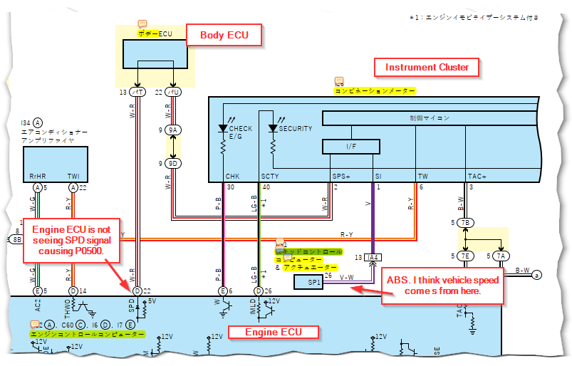

If the former then it's like mine. I can see in the wiring diagram that the ABS unit sends a speed signal (SI) to instrument pack. The instrument pack then processes and sends out a modified speed signal (SPS+) to other ECUs like Engine Management, Body Control, sat nav etc. It's the engine management ECU that's reporting P0500 probably hence the MIL on.
I still don't think the issue is gearbox sensors. It's more likely that it's ABS but then  I don't know why you're not seeing a brake fault light on the dash in that case.

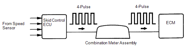

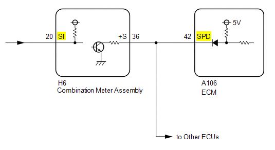

I did a bit more digging. Further to my previous post, I think this confirms the signal route for vehicle speed in the Alphard too:
https://www.toyaris4.com/toyota_yaris_vehicle_speed_sensor_a_no_signal_p050031_-1132.html
There are four pulses per rotation of a wheel on the SPS+ signal.
The circuit detail broadly matches the Alphard Gen 1 wiring diagram too:
The only contradictory evidence is the fact your odo keeps incrementing. I'm baffled as to how!

Changed both speed sensors
You mean the transmission shaft speed sensors?
I guess so, both located below the battery tray, part number 8941324010.
Sorry to hear you're still having trouble but I think changing those sensors was never going to solve the issue. As previously mentioned, I'm fairly sure vehicle speed comes from ABS ECU via instrument cluster.
