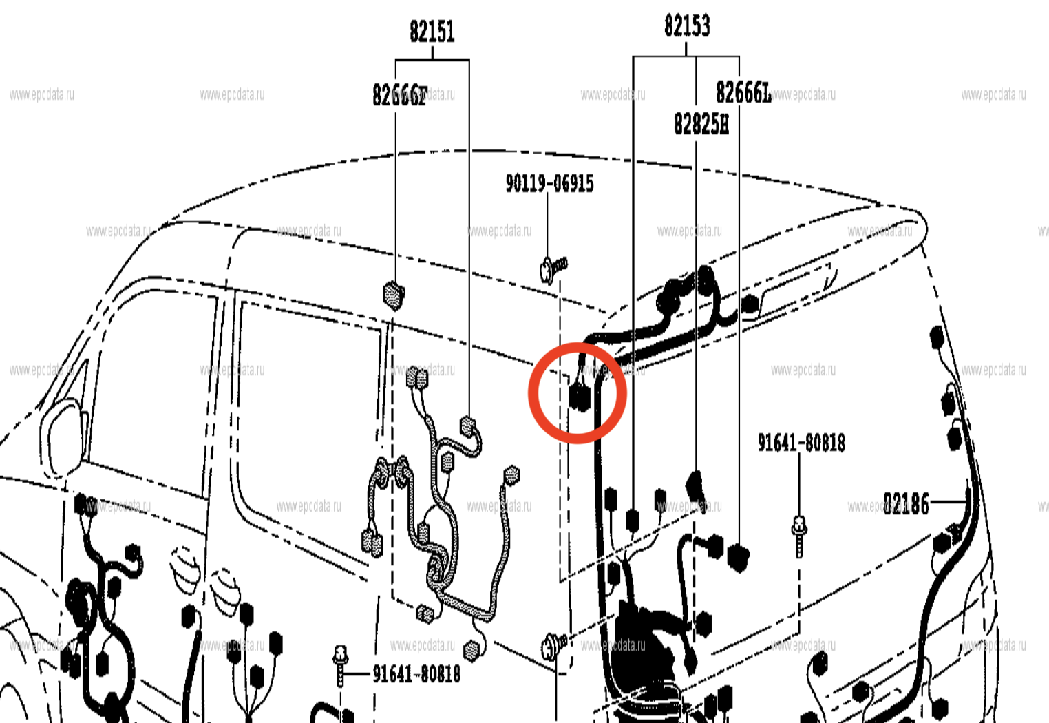

I'm trying to find the reversing (backup) light wire so I can splice into it for towbar wiring.
Before I battle with removing all of the trim pieces from the tailgate, does anyone have the pinout for the two connectors that carry all of the tailgate electrics.
There's a blue and a white connector behind the rear, nearside upper trim panel (circled in red on attached diagram).
I've got the Gen2 wiring details but I'm not convinced it's the same for Gen1 - can anyone help.

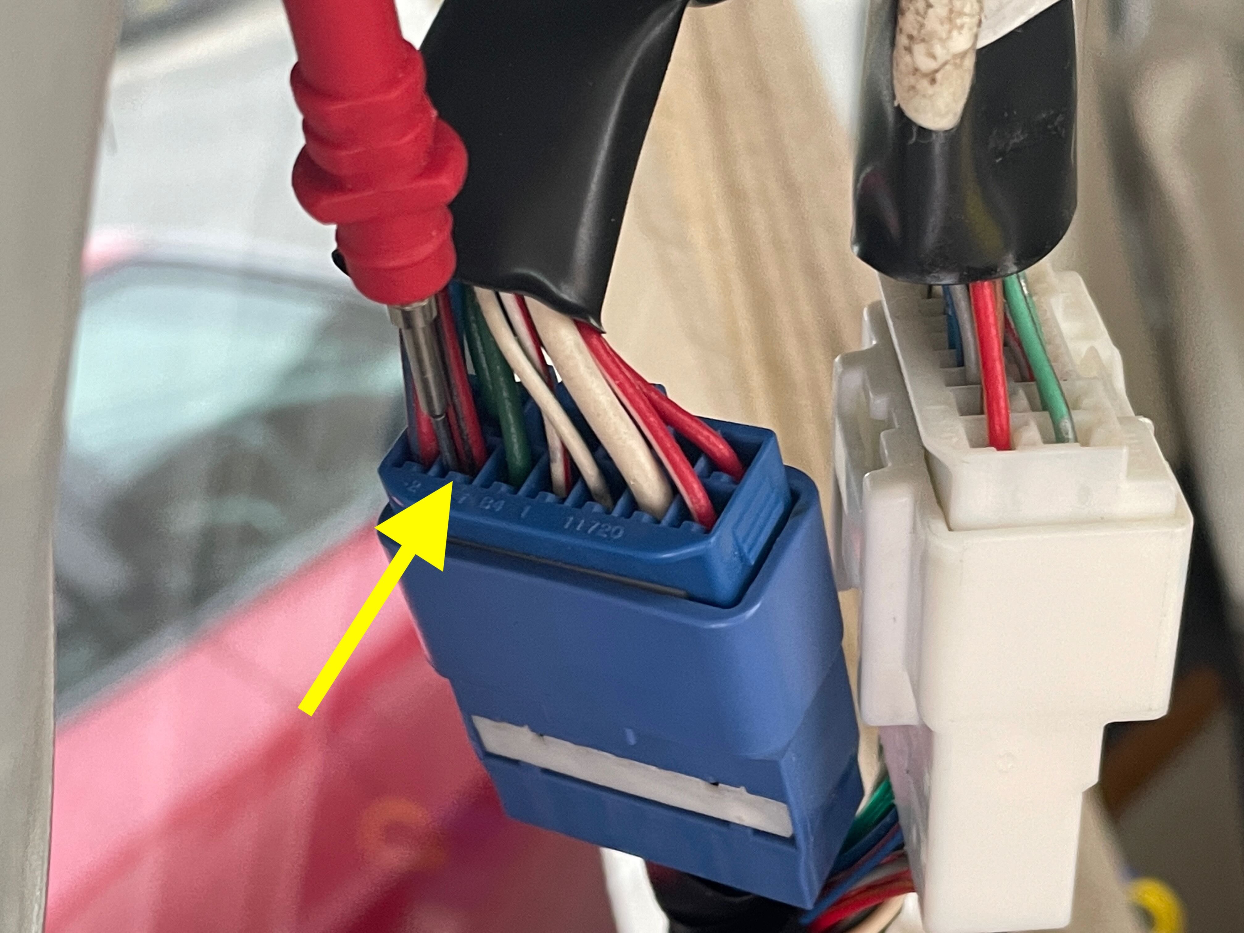

Your lucky I still have the panel off on my Gen1, the reversing light wire colours are; + red/black line, - white/black line
Thanks dezufo, I traced the wire back to the blue connector and confirmed with a probe.....
