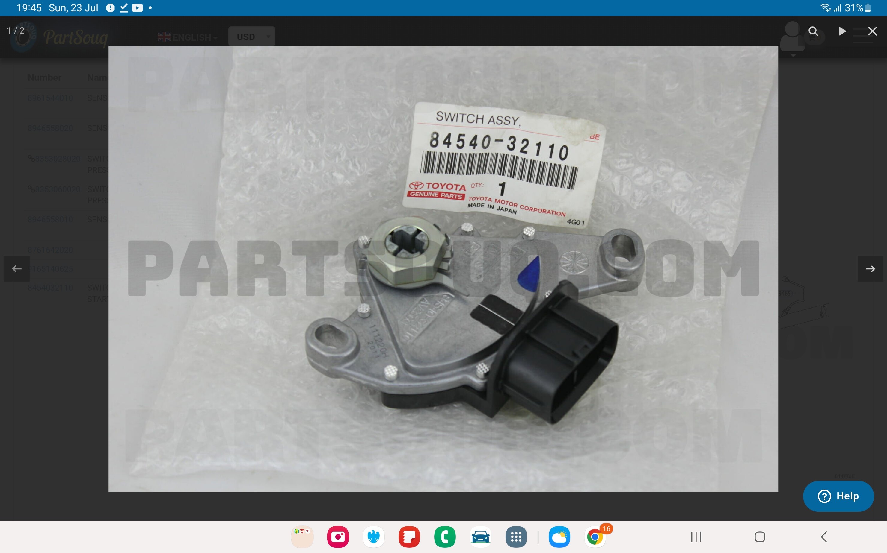

If so then I would have said the neutral start switch is at fault. Unfortunately this looks like it's part of a larger (expensive) assembly.
https://www.ebay.co.uk/itm/284380915797

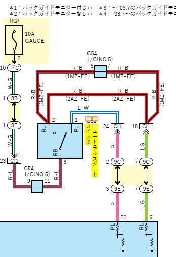

I would attempt to check the output of the switch before ordering parts though. Pin 1 is Park output and Pin 2 is Reverse. Looks like you just need to check for 12V. The following is for sonar connections so it only shows pins 1, 2 and 3 in the diagram:
