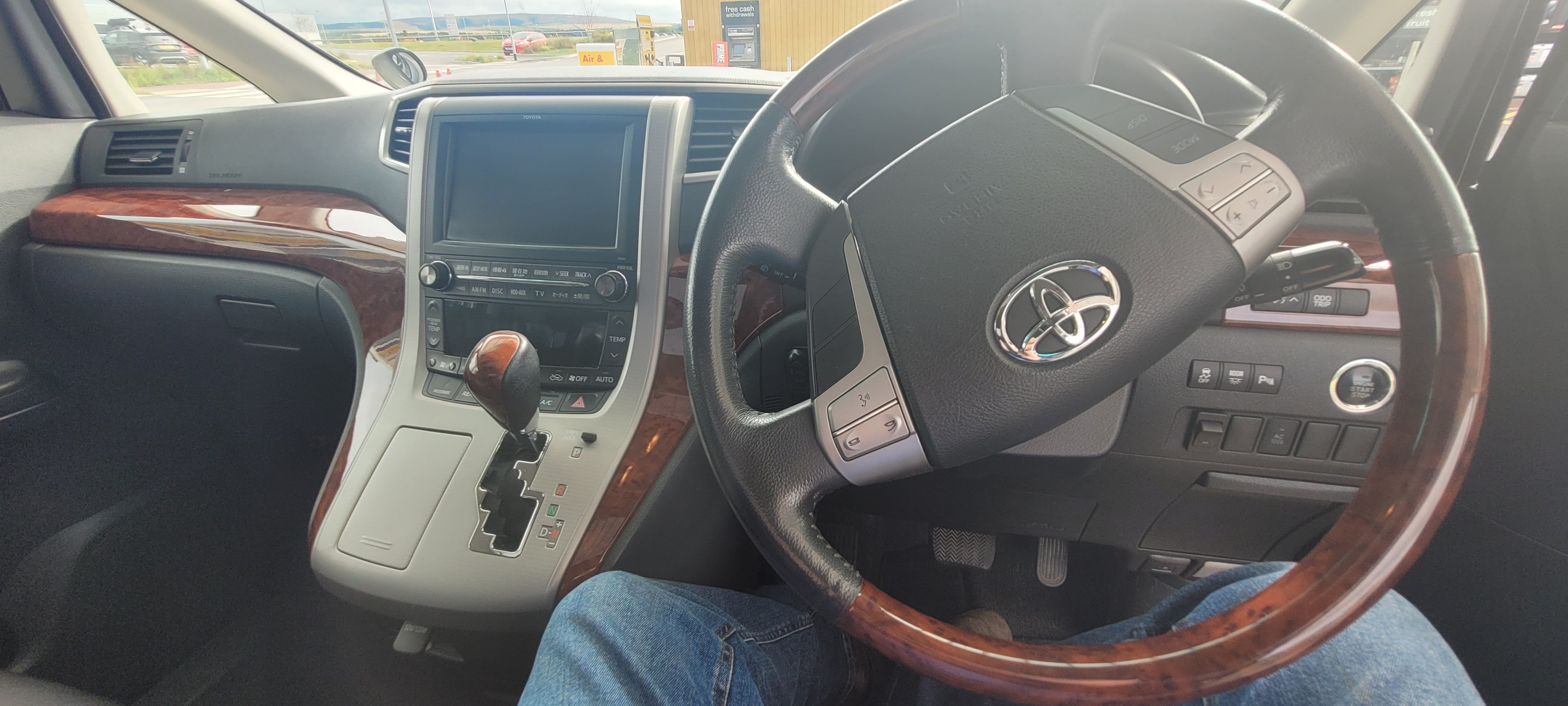

Hi,
I've just purchased a 2010 2.4 Vellfire tonight and I'm wondering about the radio. It only gets Radio 2. I want to replace it with a unit that will pick up local station as well as the other normal ones and would like the reversing camera, Bluetooth for phone calls, steering controls and sat nav in UK to work. Any advice would be appreciated.  Thanks!
P.s. this is the 1st import car I've owned
