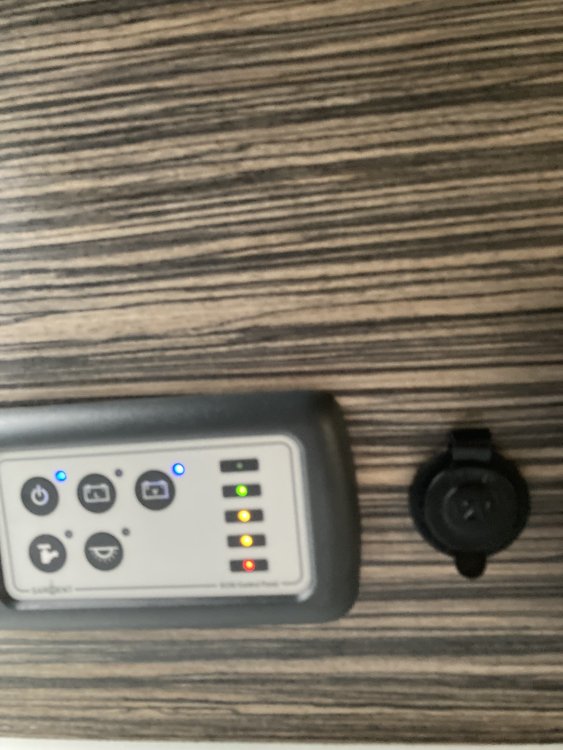

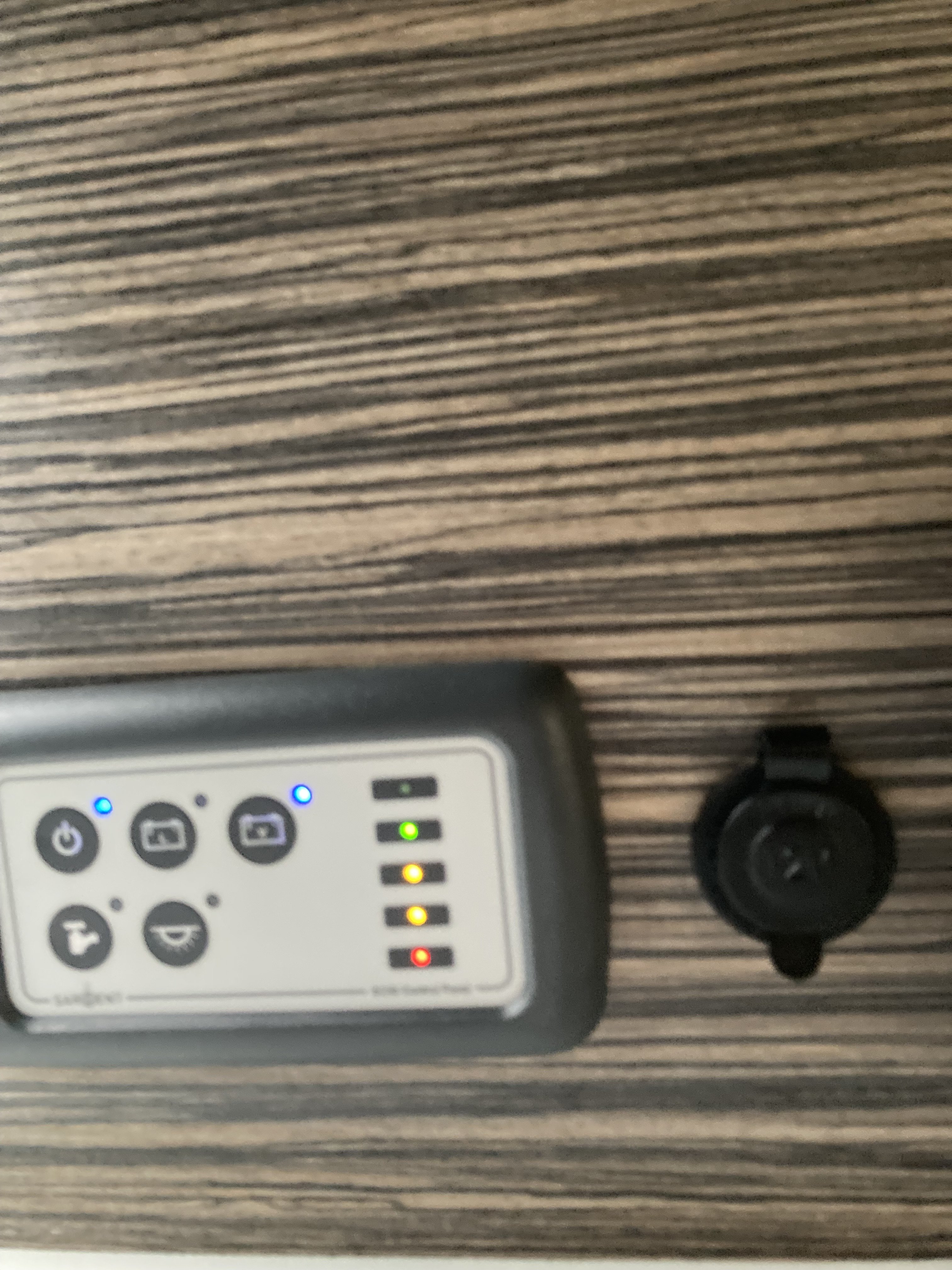

Update!
Long story short, it lives!
Under the bonnet hunting for fuses, gave battery cables a tweek, +ve one had slight movement on eyelet connector, clamp was tight on batt. post.
Quick tighten up and viola, she runs.
Batt. charging levels in pics attached.
Things are looking up!

Cheapest fix I can think of !
