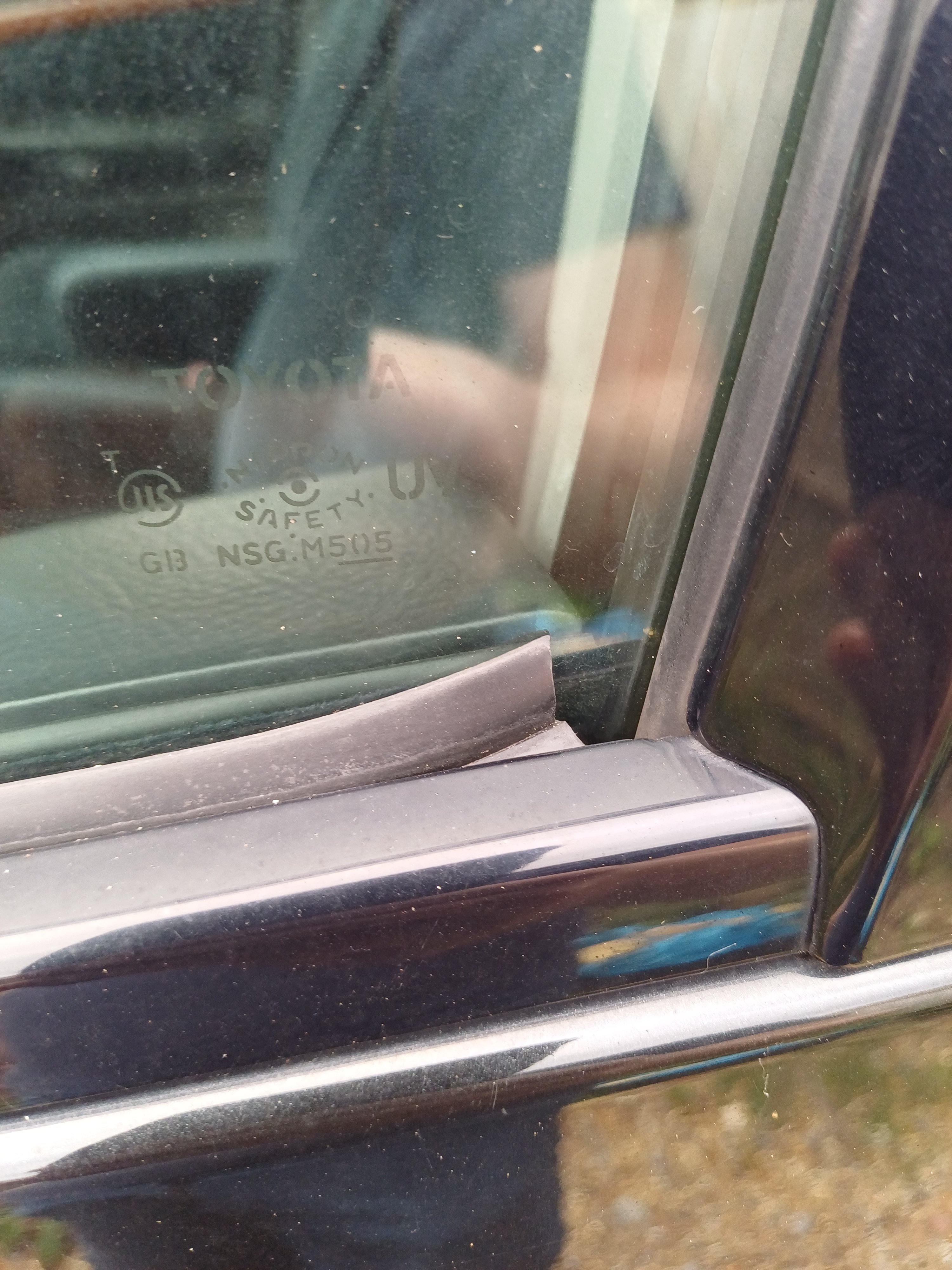

Hi guys,
Does anyone in the know, know what the part no's are for the front door outer window rubbers are (both sides)?
Mine have gone rock hard and curly at the ends and cause the windows to judder most of the time when opened or closed so want to replace them (assuming they are still available).
Thanks in advance!20231222_120309.thumb.jpg.58325cca4d1ce1711bdd8abb2ffaa35b.jpg

Try toyota/alphard/epc.com to find the part numbers

Thanks Rojie, I looked but it's hard to tell from the diagrams what's what
LH: 6817258010
https://toyota.epc-data.com/alphard/anh10w/24294/body/6751/68172A/
RH: 6817158010
https://toyota.epc-data.com/alphard/anh10w/24294/body/6751/68171B/
I wonder if they've just become dislodged and need snapping back in?

Those are the trims on the inside of the windows
Thanks all, just the weatherstrip that sits on the window has gone quite hard and curled up at the ends......probably beyond saving.  The rear ones aren't actually much better 😔
My mate looks after it and tends to have no trouble getting parts for it through the main dealer he uses so might be something I look at in the New Year.
