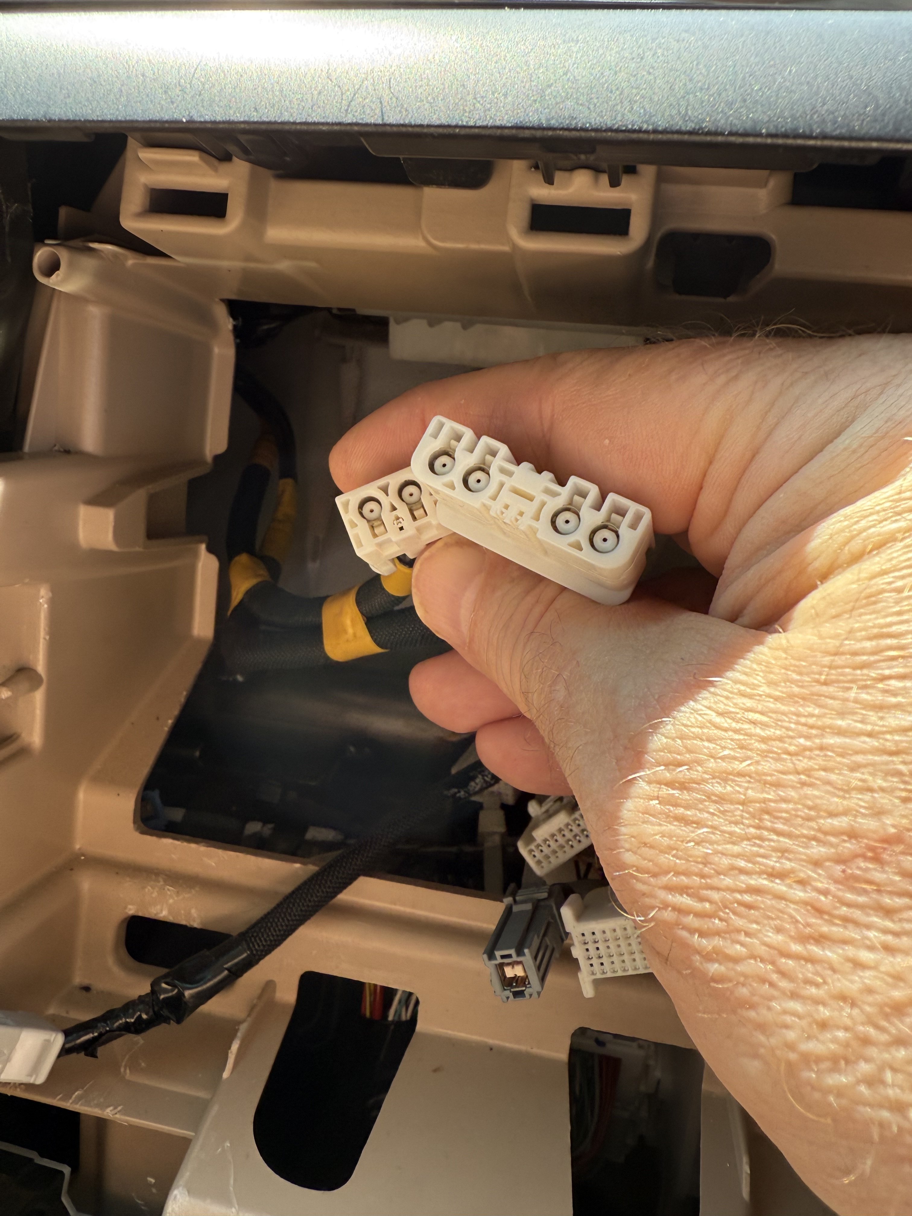

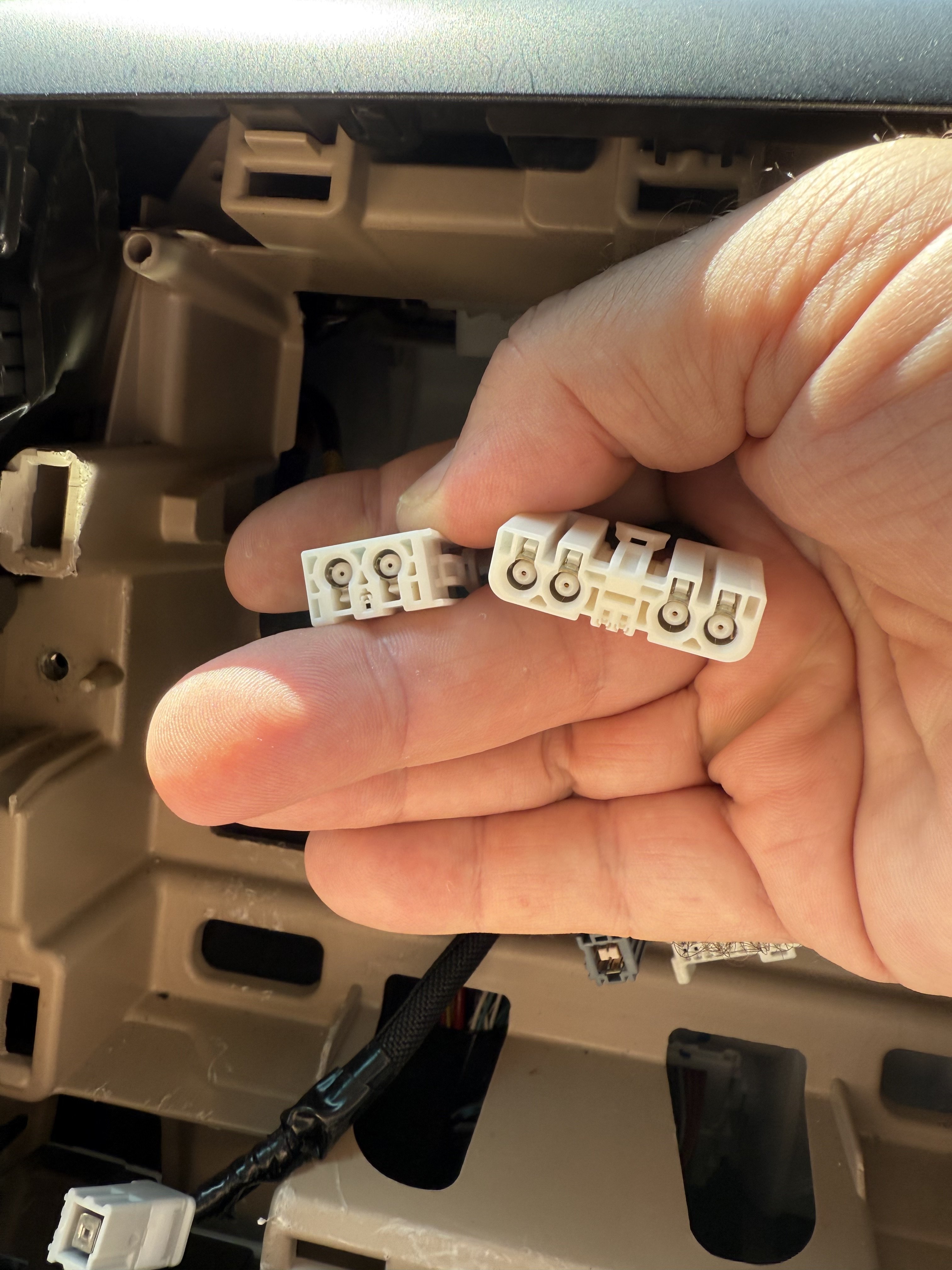

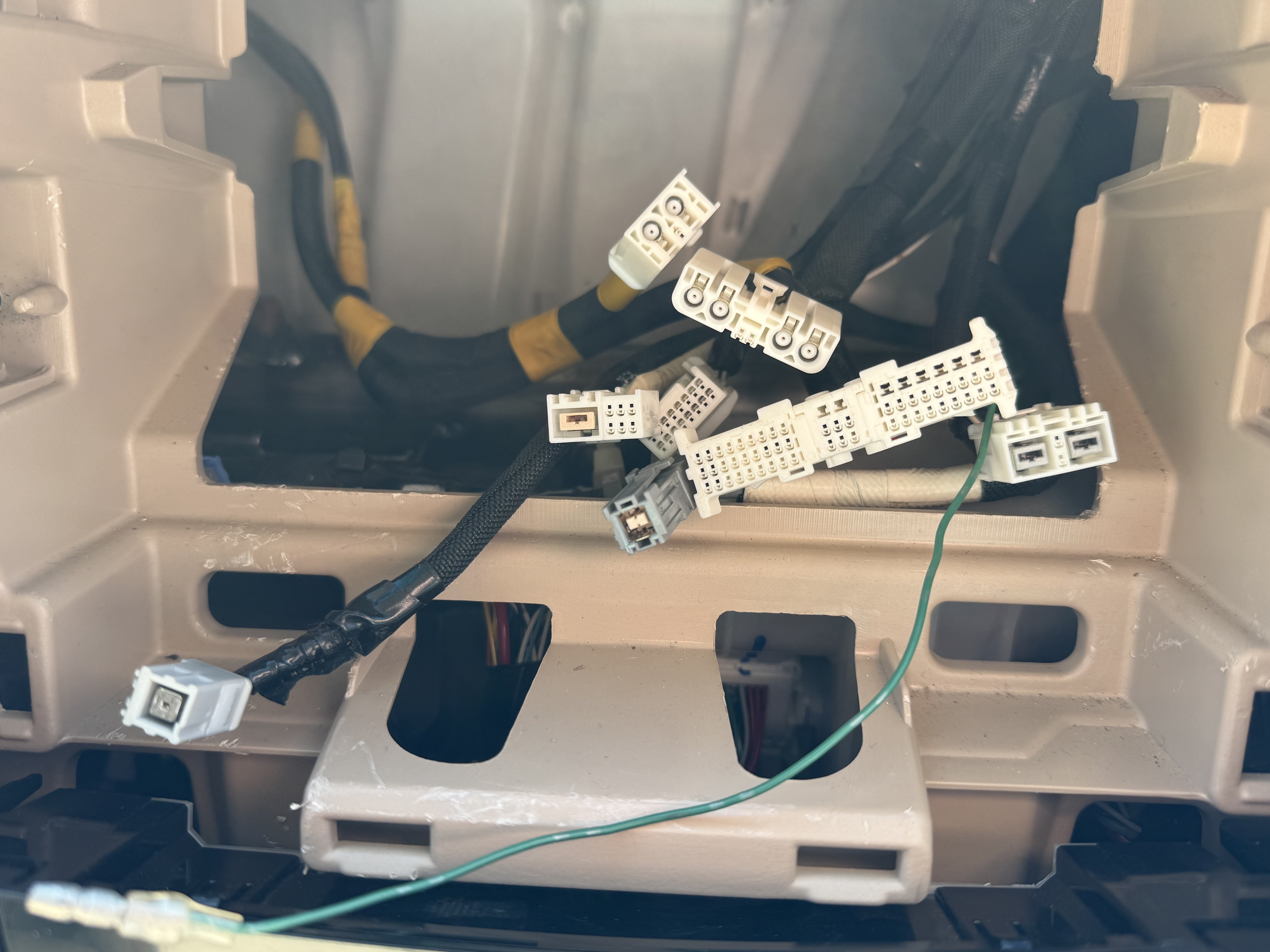

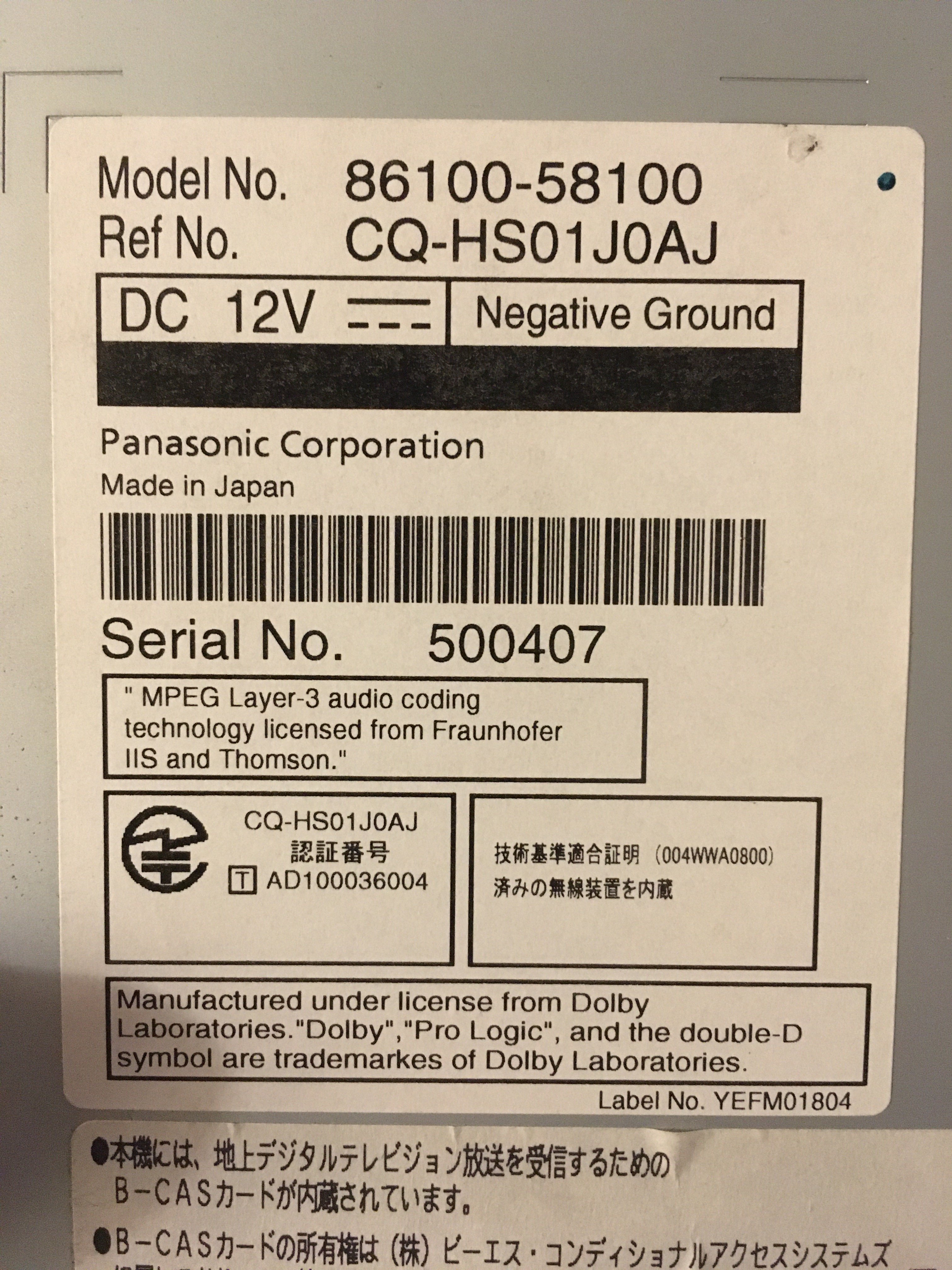

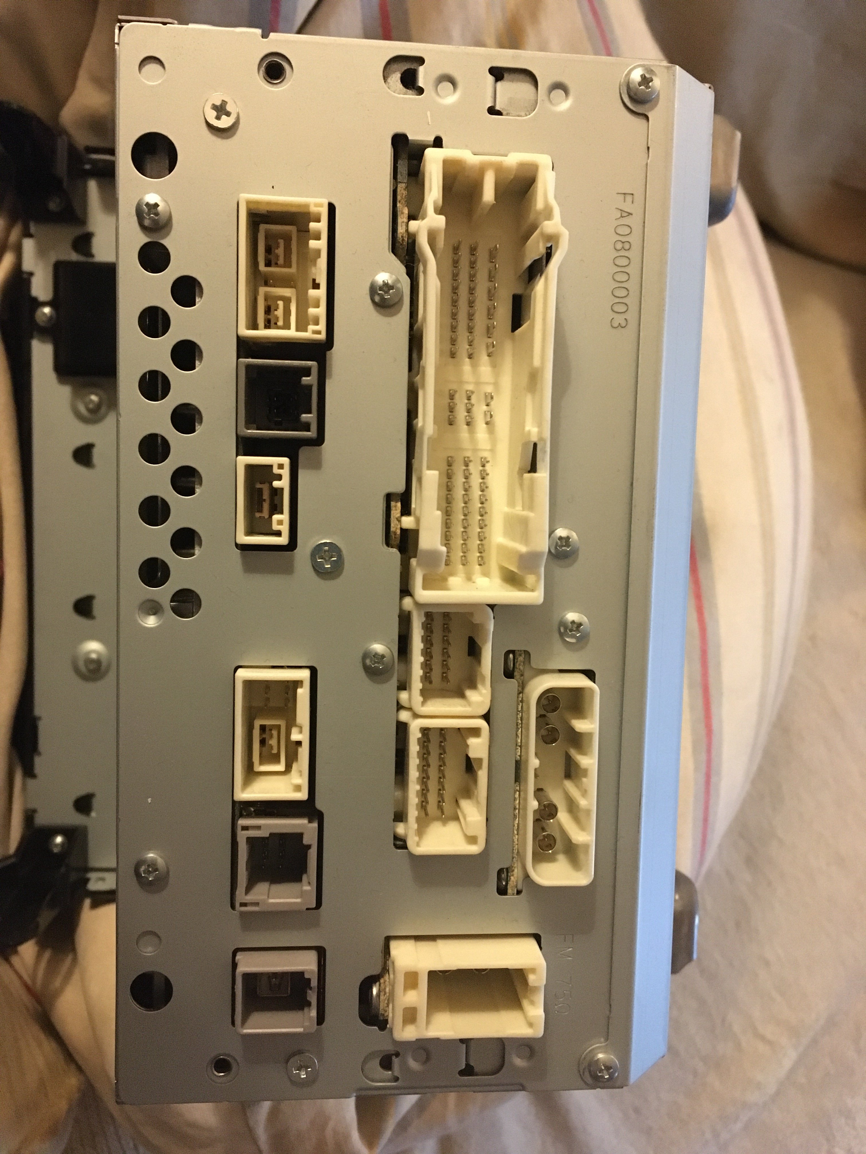

I have removed the origional head unit and found that the wiring connections are unique and not labled.
I'm happy to sacrifice the additional cameras and steering wheel controls. I just want uk sat nav and DAB radio. This is the origional Panasonic head unit.IMG_3702.thumb.JPG.5d81b21e09d8aa6009ae894bf54c4c1d.JPGIMG_3703.thumb.JPG.81cdfded1f91a4398c091ce2ec0b92d6.JPG
Are there any experts out there who can advise me what the pin out connections are. I think I just need to connect in an ISO connector whilst keeping everything backwards compatable, unless adaptor cables are available. The additional antennas and even a replacement reversing camera can be connected directly to the new Pioneer head unit.
So far I have not been able to find and reference to this particular head unit anywhere online.
Also, I assume Alphards are not fitted with OBD sockets as I've not been able to find one anywhere.
Any help or advice would be greatly appreciated.

Hello Laurence,
It's entirely possible (through converter cables) to retain rear camera and steering controls.
I have a Pioneer Android Auto/Carplay system in mine and the factory camera and steering controls all work as you'd expect.
The wiring on these is relatively complicated because of all the AV features these cars tend to come with (particularly if you have one of the factory upgraded speaker systems) but it's all entirely doable with the right cabling and knowhow.
Worst case take it to a decent audio installer and get them to sort for you, might be worth the spend for all the hassle it might present otherwise.
Private message me an email address, I'll give you a link to the pdf for wiring .
You can buy wiring kits for around £100 on AliExpress for that unit, that will enable you to retain the factory cameras/reversing sensors/heater controls/amplifier and add obd/canbus data too.
It's not insurmountable.

The two looms have different connectors based on the original headunit.
2008-2010 had minidisc players and external TV decoder boxes. 2010 onwards removed the minidisc and used the space to integrate the TV decoder.
This is why the connectors changed.
Do you still have the original Toyota unit? Check the connectors on the back.
The next thing is, how many speakers do you have?
If you have the 8 speaker setup, you don't need the 'optical' most decoder box.
If you have more than this, you do need the decoder.

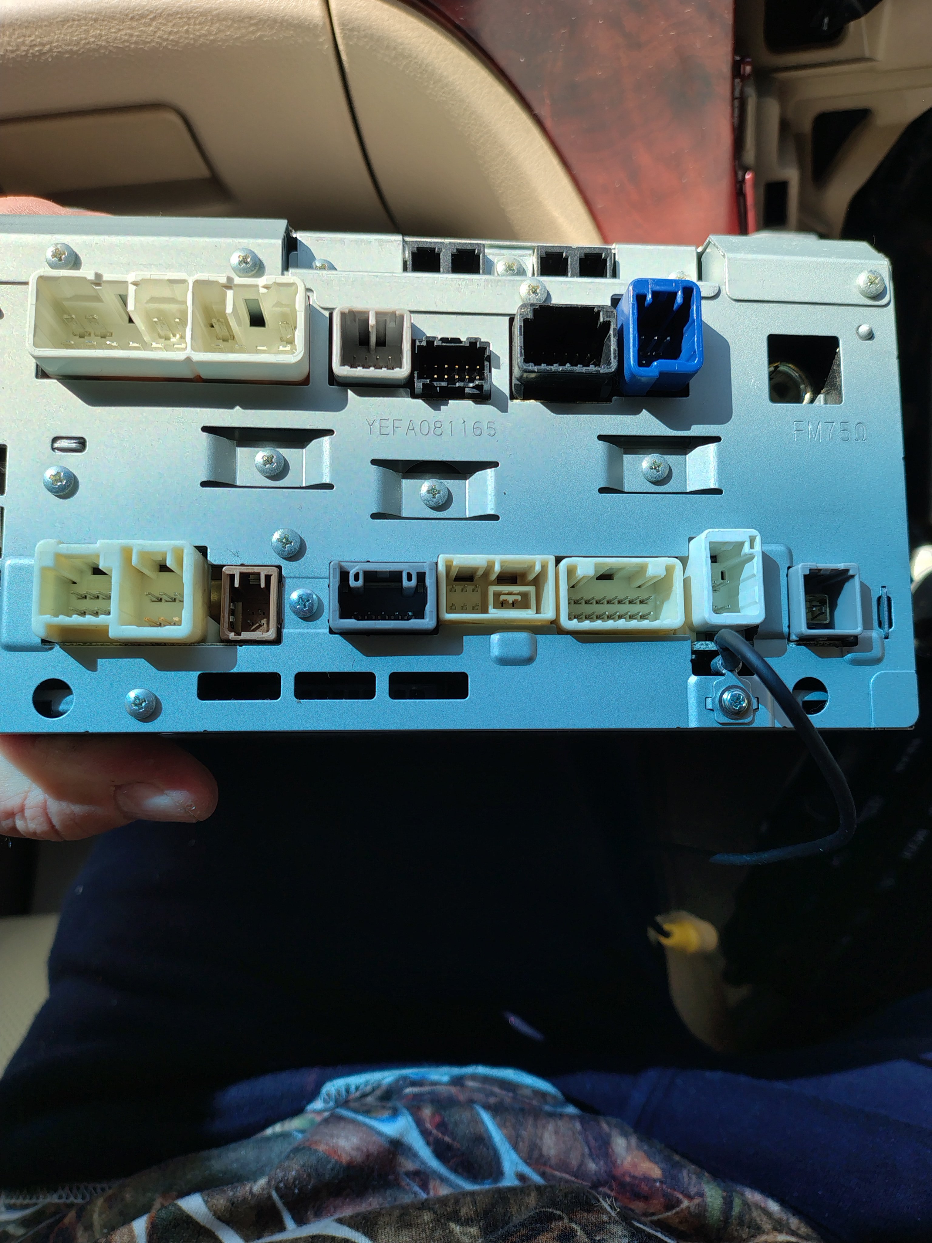

Sorry for resurrecting an old post, but I’m in a similar situation to the OP now. For my head unit 56107 18 speakers (most of which are no longer needed as I have a full length side conversion) I understand there are two options:
a) MOST decoder box that still uses the amp
b) Amplifier bypass cables that still connect to the amp but doesn’t use it
However, is it possible to completely remove the amp and everything else under the passenger seat, and use the speakers direct to the android head unit?

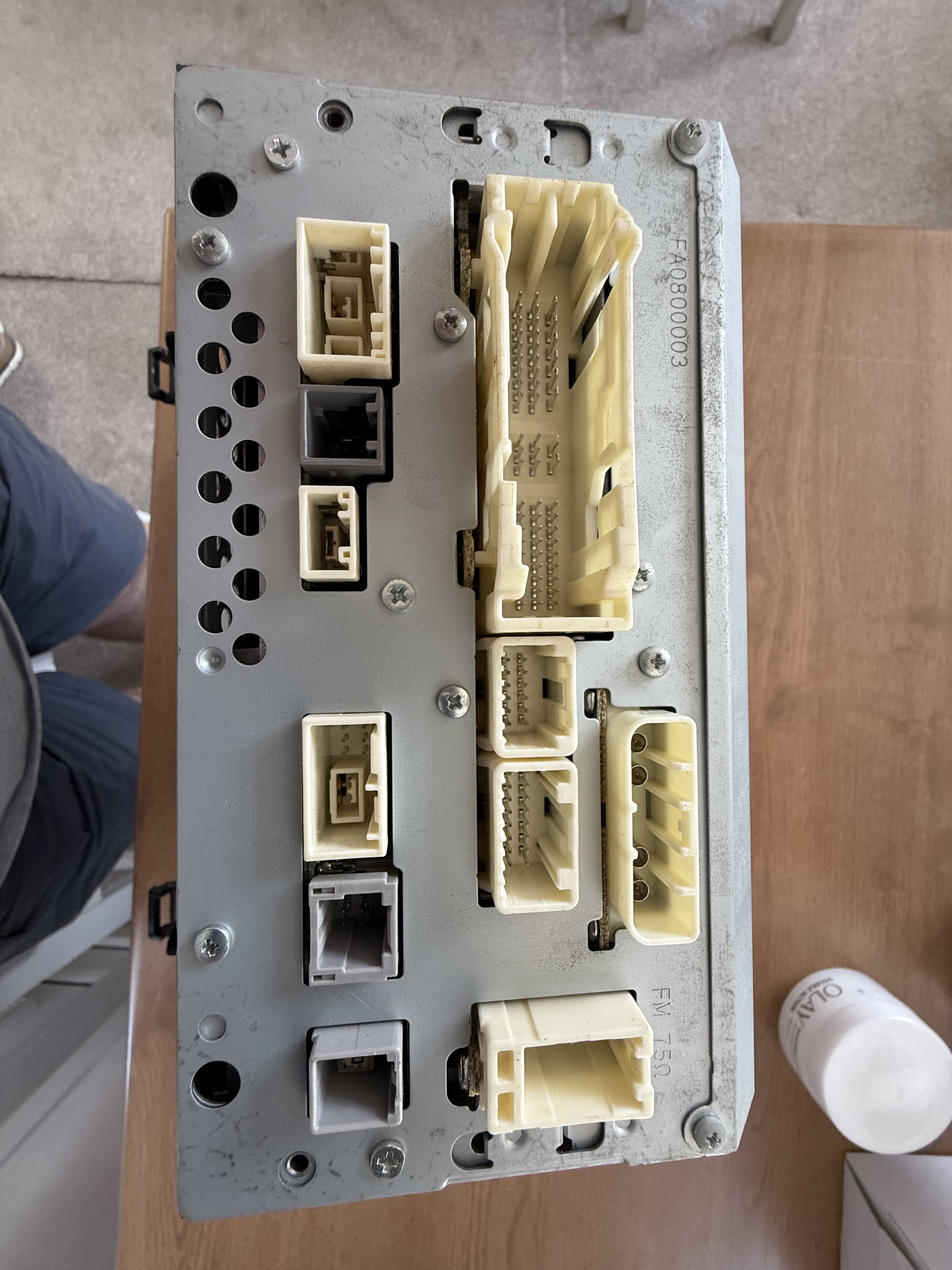

Chris.ac, would you know what plugs these are for? I am thinking they go to the amp but I’m not sure.
thanks.
FYI, these are the cables I have, and the rear of the unit
thanks.
Antennas.
The 2 port is am/fm.
The 4 port will be for TV
Great, thank you. 🙏
@Laurence - the adapter cable you need is the one for series 30 model as this has the long socket not on the earlier models. This caries most of the signals. You will need a MOST adapter as well, oh and you Android HU must include CANBUS support
Adapter cable - FXZJ-00-00182
MOST adapter is labelled "For Alphard / IS250 ES/GS"
Noting that this setup as it stands doesn't make the rear monitor work, and doesn't use the in-built microphone (if fitted)
I've opted for top spec DUDUAUTO model 7 and am in the process of working out what I need to do to make the above work before I start ripping out the factory unit.
