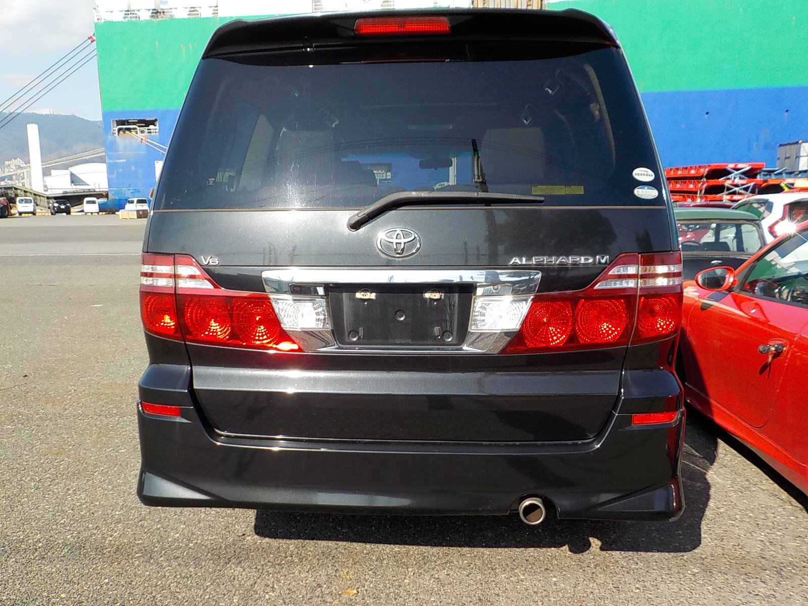

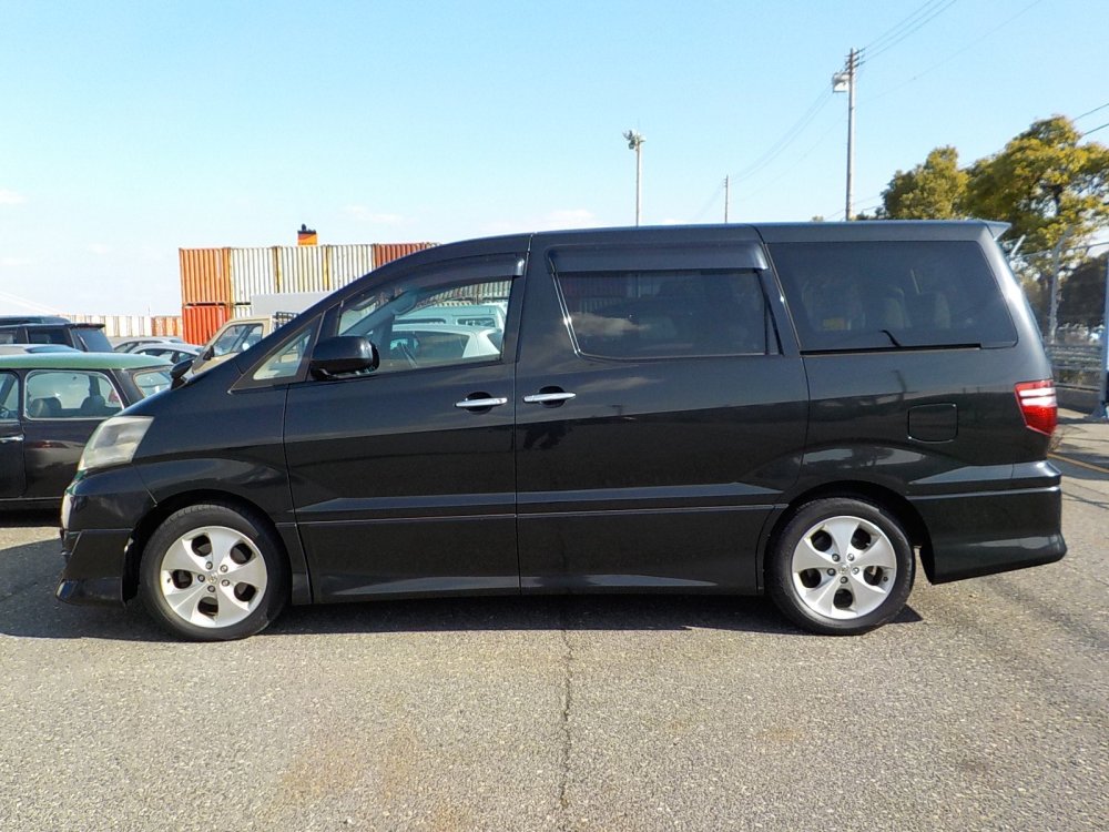

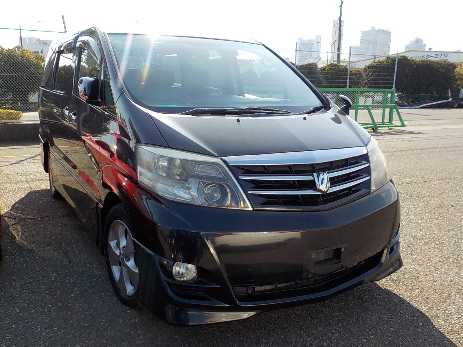

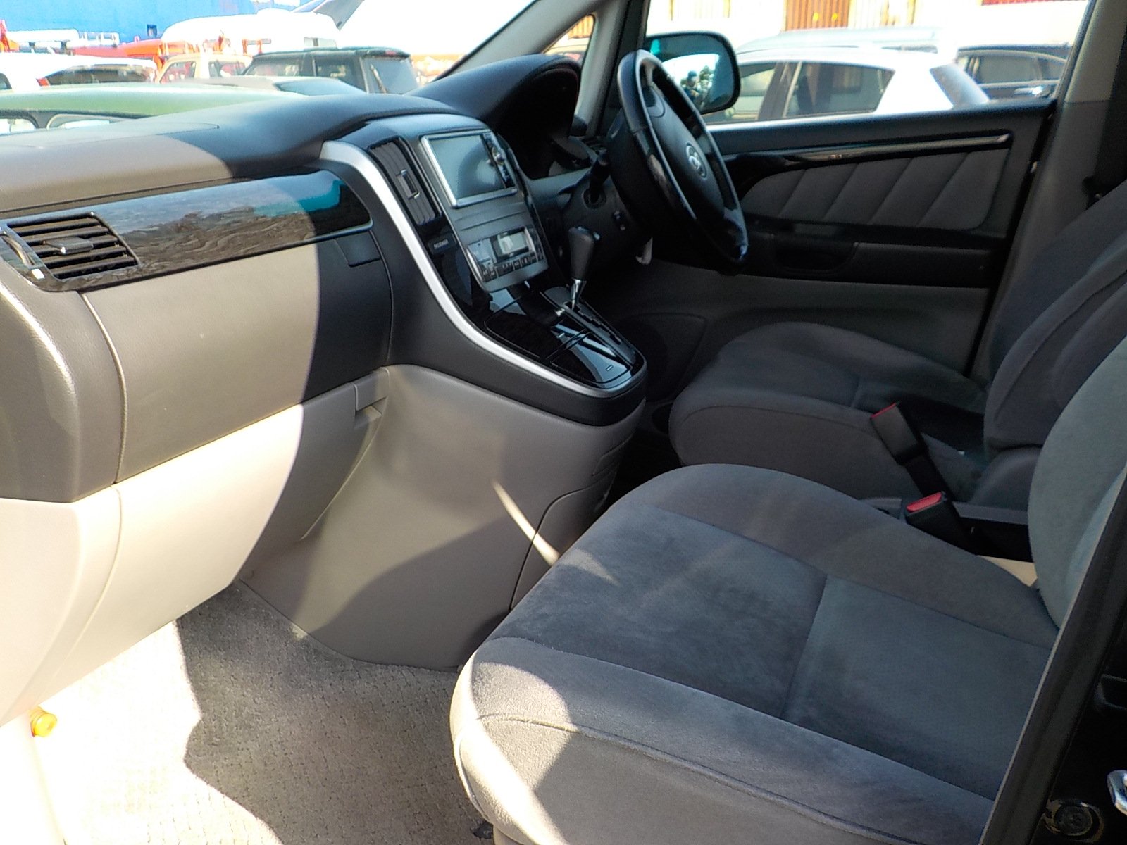

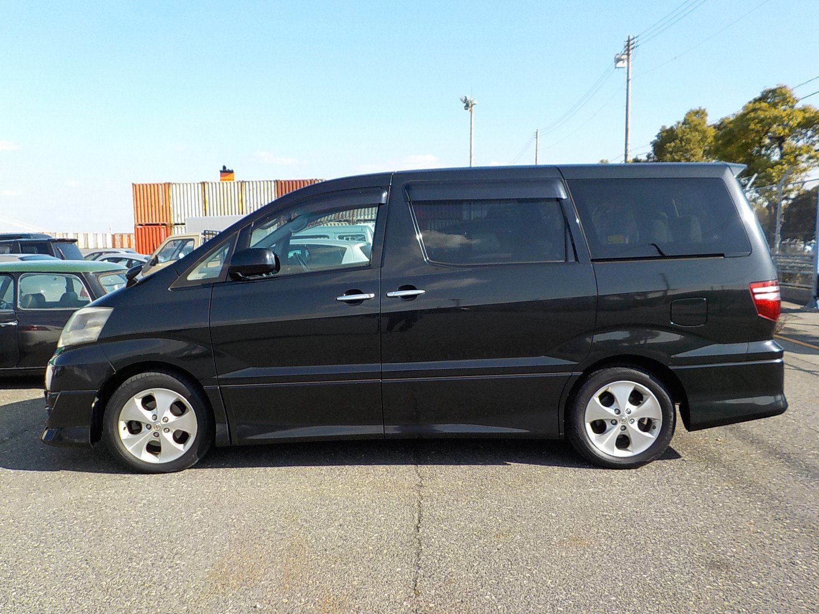

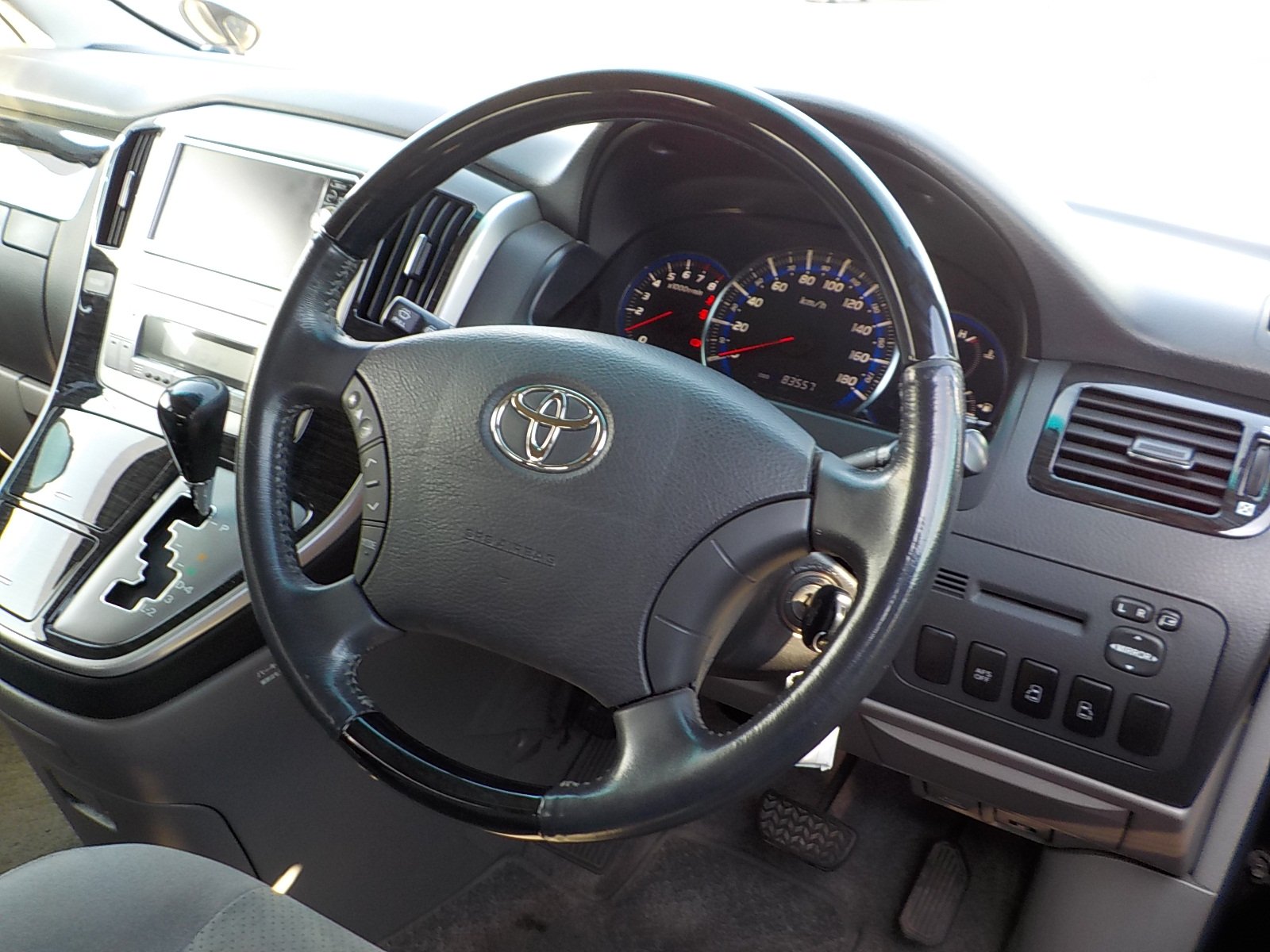

Hi,
I'm a new member and looking forward to Alphard ownership - very relieved that my Alphard has finally landed. I bid on it in in January and have been waiting to collect it since then! Its a 2007 MS platinum selection? 3.0 V6 84,000kms 4B. I have imported a car before and took it for both an IVA and MOT so I've some experience, but it was much newer and German so more familiar to me to work on I guess.
now I've the challenge of preparing the car, with all sorts of ideas running through my head and with this can I just ask, what is a best practice to do list on a fresh import Alphard prior to making it roadworthy? i.e. if this was on your drive what would you start with and finish at prior to making it roadworthy?, and where best to buy bits from (service, fog lights, how to tackle the fog light etc). I've fitted towbars on 3 cars so not shy of the wiring element if that is necessary.
initially I want to get it driveable, with future plans to hopefully convert to a camper. but there's no rush on that part.
any advice welcomed thanks. I suppose I need to order some bits first but wondering what is necessary.
thanks,
Neil

Fog light; Option 1, replace the reflectors in the bumper with led lights and wire them up as fogs, you can get them on amazon
Option 2, convert the offside reversing light to a rear fog with a red lamp, just make sure that the lens next to it is not a brake light
Fog switch; you can get one off ebay that will fit into the switch openings in the dash and pick up the power from the loom behind or use a piggy back fuse off the fuse box in the drivers footwell, make sure its a switch for a Series 10, 2002-2008
Check the wiring loom behind the bumper as you might find that there is spare connector that could be used for a fog light, the cars used on the north island of japan had fogs fitted and there was also an option of a winter pack, toyota have a standard loom that just means connecting up items when specified

Speedo/Odometer: Option 1: You can get replacement dials from Lockwood International that read MPH but leave the odometer clocking up in Kilometers, they are fairly easy to change and there are guides on the Lockwood web site on which dial for your model and how to change them, if you do fit a dial just leave a note for the mot tester that says the odometer reads in kilometers other wise he is likely to put it down as miles, it does not have to be entered as miles on the paperwork
Option 2; Have an electronic chip fitted that converts the input signals into miles but get written proof of the initial km reading then the reading after the chip is connected as the reading can be clocked, what should happen is the initial km reading stays as is and then miles are added as and when used, so the reading is a mix of km & miles
Option 3; Leave the dials as standard and use a GPS device for the speed

You might want to disconnect the toll reader system it's either the slot on the dash or fitted elsewhere e.g. centre storage cubby, you can use the power to it for usb sockets, the aerials for it, top of windscreen, can be done away with and the wires used to pull other wires in if needed
