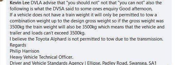

there are no weights stamped on the vin plate, what you will find is that you are limited to a maximum total of 3500kg

From an answer to the question of towing that was in a different forum see pic
