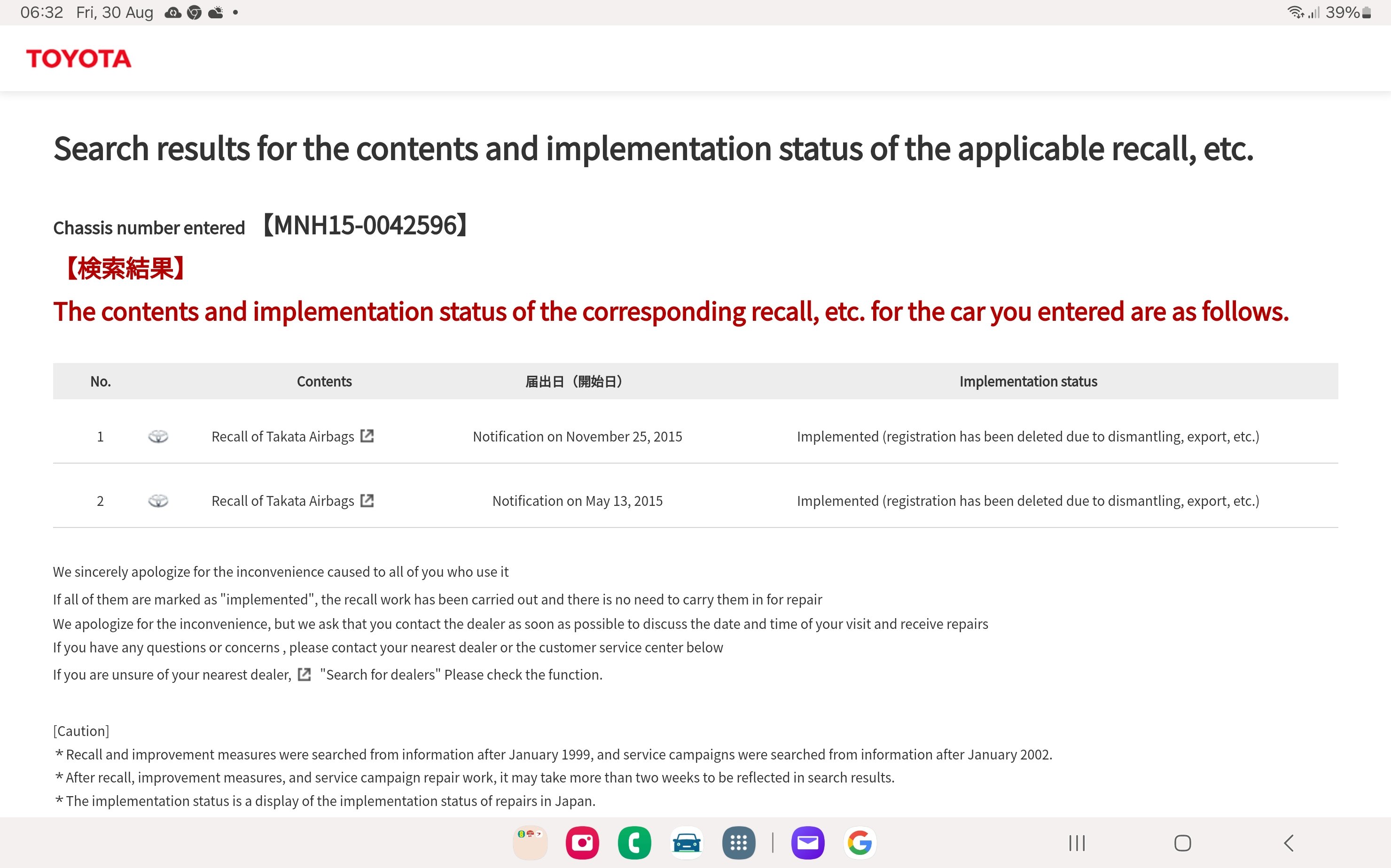

There was a recall in Japan on the brake servo issues there is a link on here somewhere where you put your vin in and it tells you what recalls have been done

Just found the link could you pm me your reg no. And I will attach a screen shot of the report
That's very kind of you, thank you. I just sent you a DM. 👍

8 hours ago, Picasso said:
So that tells me there was no issue with brake servo
Should I mention this to the garage when I take the car in to them, do you think? Is the brake servo something they can check?
