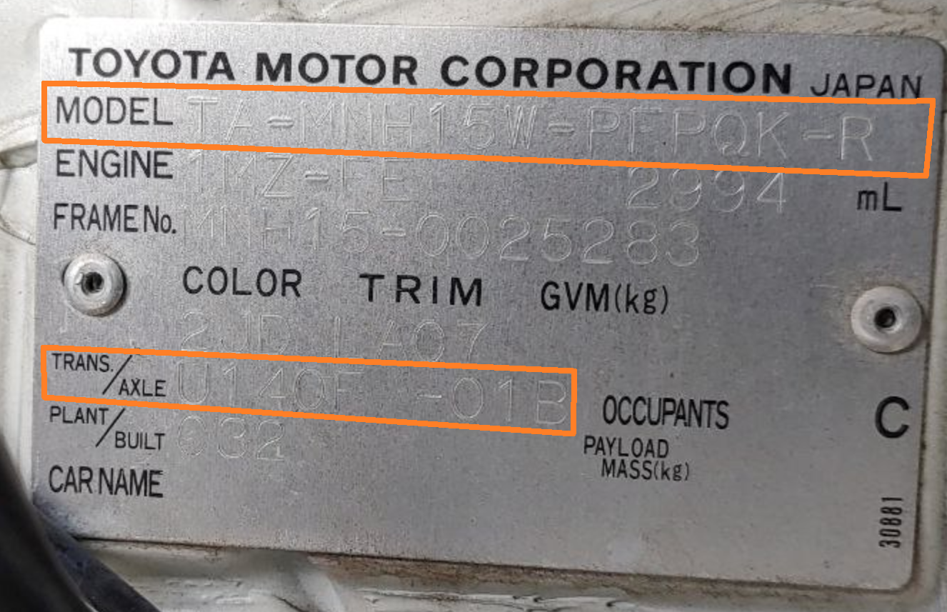

I did more research. Generic Translated Alphard manual page 256 states that Torsen LSD is a grade option.  The optinal LSD is manufactored by "ZEXEL TORSEN INK". While unlikely, I will need to ensure that I do not have an LSD, otherwise use gear oil option 4 which states its compatible with every use case but supports LSD.
@Picasso Can you please tell me if my vehicle has LSD from the following information?  Otherwise Can I look by looking at the differential itself?
Hi, Several of us are aware that the Torsen LSD is an option.
What we are not so sure of is that you have one fitted in your vehicle.
Enquiries ongoing !
Hopefully, you'll get a definitive answer soon.
