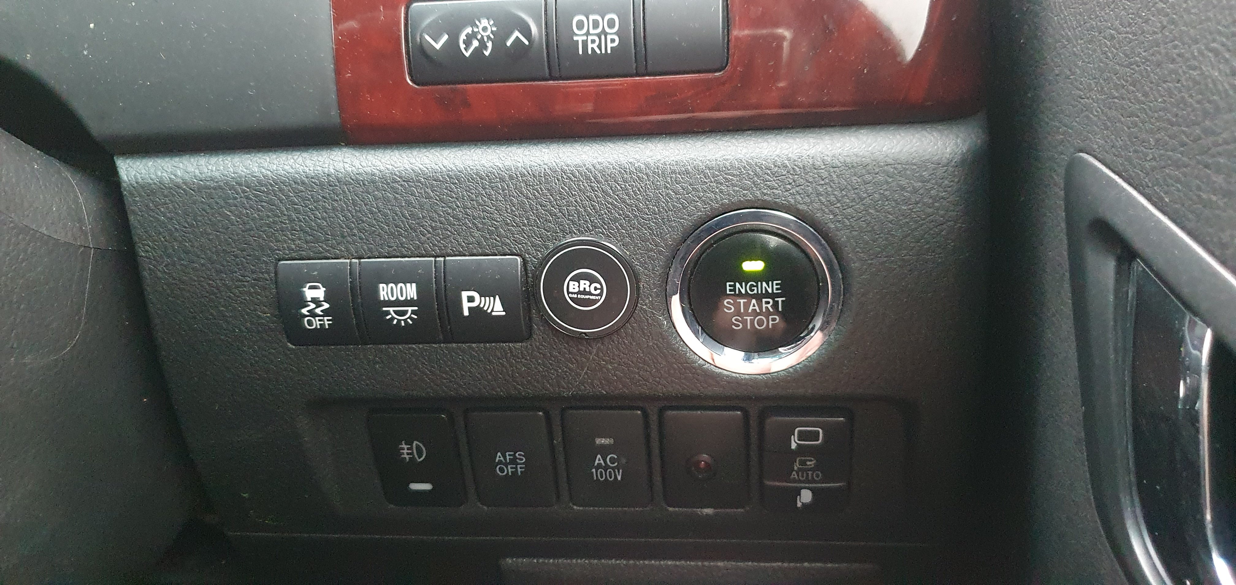

On the push button start, I also figured out that if I don't press hard enough to make the light on the button go green from amber, there's nowt down for starting. Not sure if you knew that bit, I didn't!
It made the noise to - I think - release the steering lock, but not engage the starter.

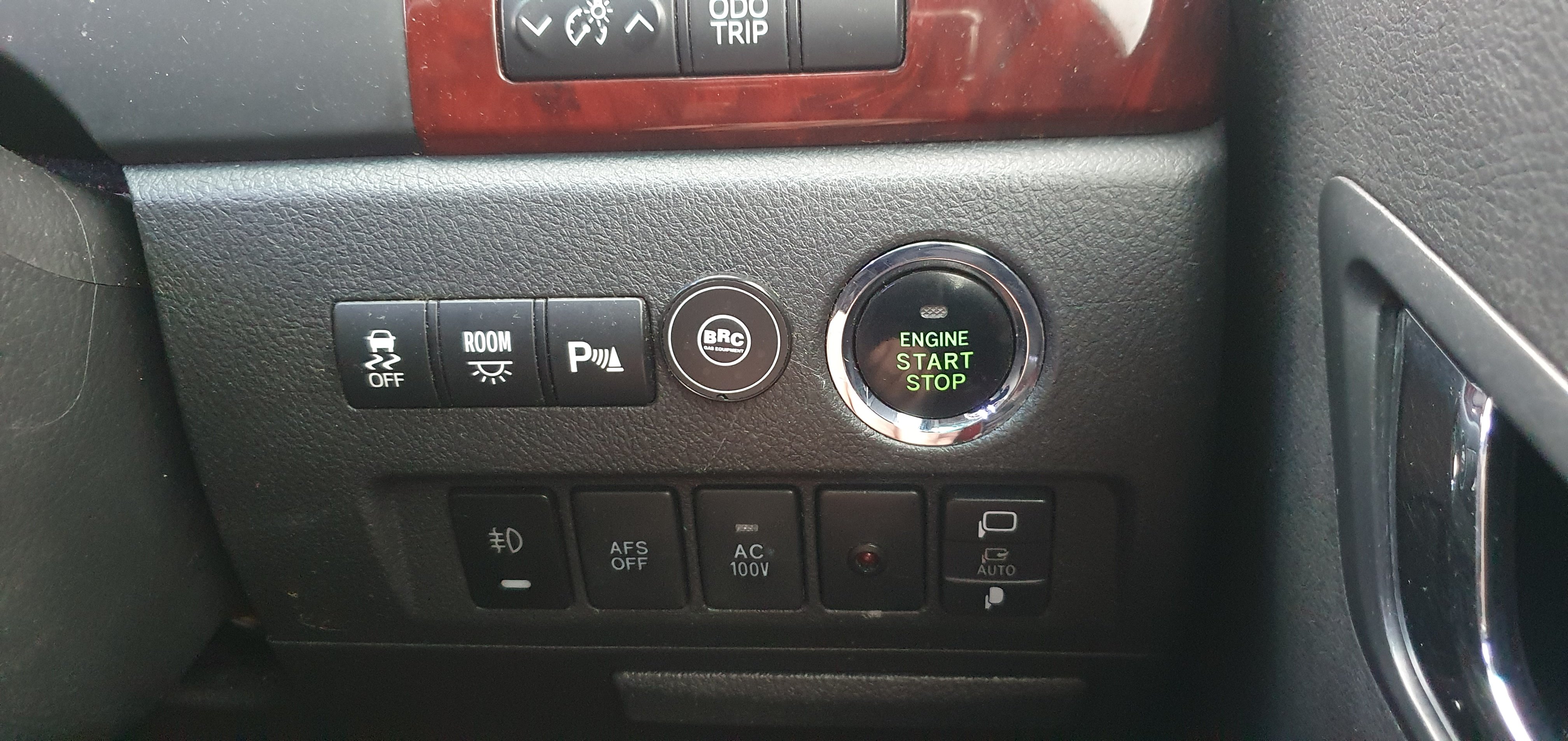

The push button is blank, no amber !! should it be amber ? I repeatedly press the start to no avail then out pof the blue it goes green after 20+ plus attempts

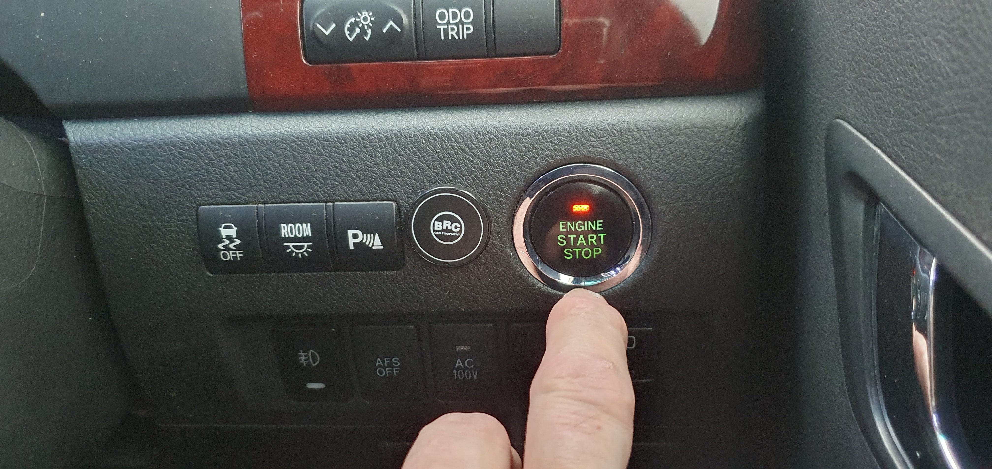

I'll have to double check this, but on getting in the car, without foot on tbe brake, my first press brings it to accessory position and a small rectangular light within the top portion of the START button goes amber, then if I press on the brake pedal hard enough (I didn't at first) that light goes to green, then press it and it starts.

Sat in car, faint light at back of starter.
One press gave orange light.
Foot on brake - till changes to green light.
Then press it to start up.

No matter what i do the push button does not light up however, after 2 hours out of the blue the green light came on and i started the engine, when i turned it off i  could not turn it back on. The batteries were replaced by the shop in 5 seconds,  thererfore I  can only assume its the immobiliser causing this issue as it needs a working fob

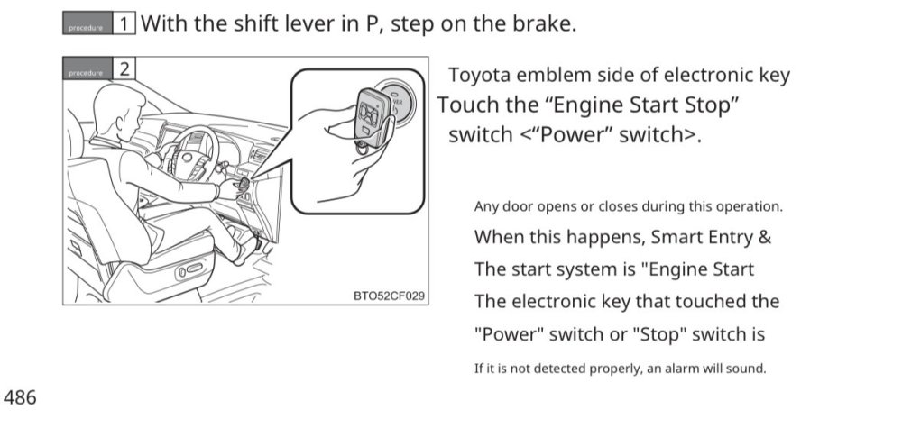

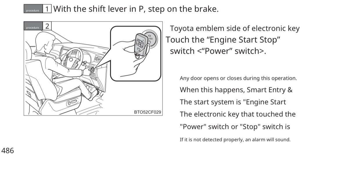

I know this is a bit late but hopefully will help someone in the future.
The fob should still be able to start the car without batteries in it. You need to hold the physical fob with Toyota badge side against the ignition button with your foot on the brake as usual.
Not the best translation but gets the idea across.
