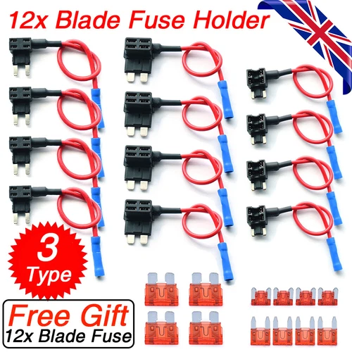

I have also found these: https://www.ebay.co.uk/itm/364658290292?_skw=Micro+Blade+Fuse+Adapter&itmmeta=01JGTP24G53WV6KM9H2VQ0BK6H&hash=item54e753ee74:g:oSMAAOSwV5BllNCw&itmprp=enc%3AAQAJAAAA8HoV3kP08IDx%2BKZ9MfhVJKmxdoLQ0oMo4WJzuUWlOzgoK9fSfS4Y5b%2BwFfUl%2BTKKkulMP6XMTBwnupb8yHtMPz1Kn05MmsGsMMon%2BZZeTCAIVnP4sI4Kk8JELrKe6xi9fW33D%2BZNgK%2Bk%2FpSktSA4hsrkO4zRIAMNBz6UpWqahNU0cTv4uqgFMyWWQTUml1PbsATksCfTQn2N60RlWtnv4Bt%2FxK9TY36WxgJtiFeMJKYDY4t0Iq5nOmJUPXNpYvIy5FmB19XUpN%2FyRfL6mxfessj4%2FB3hW643uhwpTKbsr6%2BlCODV%2F42cleZ33BD3bMJC%2Bg%3D%3D|tkp%3ABFBMmMiI1oZl 12X 12V 10Amp Car Add-a-circuit Fuse Tap Adapter Holder Kit ATM APM Blade Fuse - Picture 1 of 7
which looks to be a good way of getting a fused 10A feed from any of the fuse boxes to whatever toys you want to fit.
As my current setup is a rats-nest of extra cables clipped / spliced onto existing cables this would be a better way of doing things. The only downside (aside from a lot of work) is that you can't easily fit them back-to-back, though flipping one through 180 degrees would work you can only do that for two feeds next to each other.
It would make extracting a fuse simpler though.
The only thing lacking is a way of labelling the feeds.
