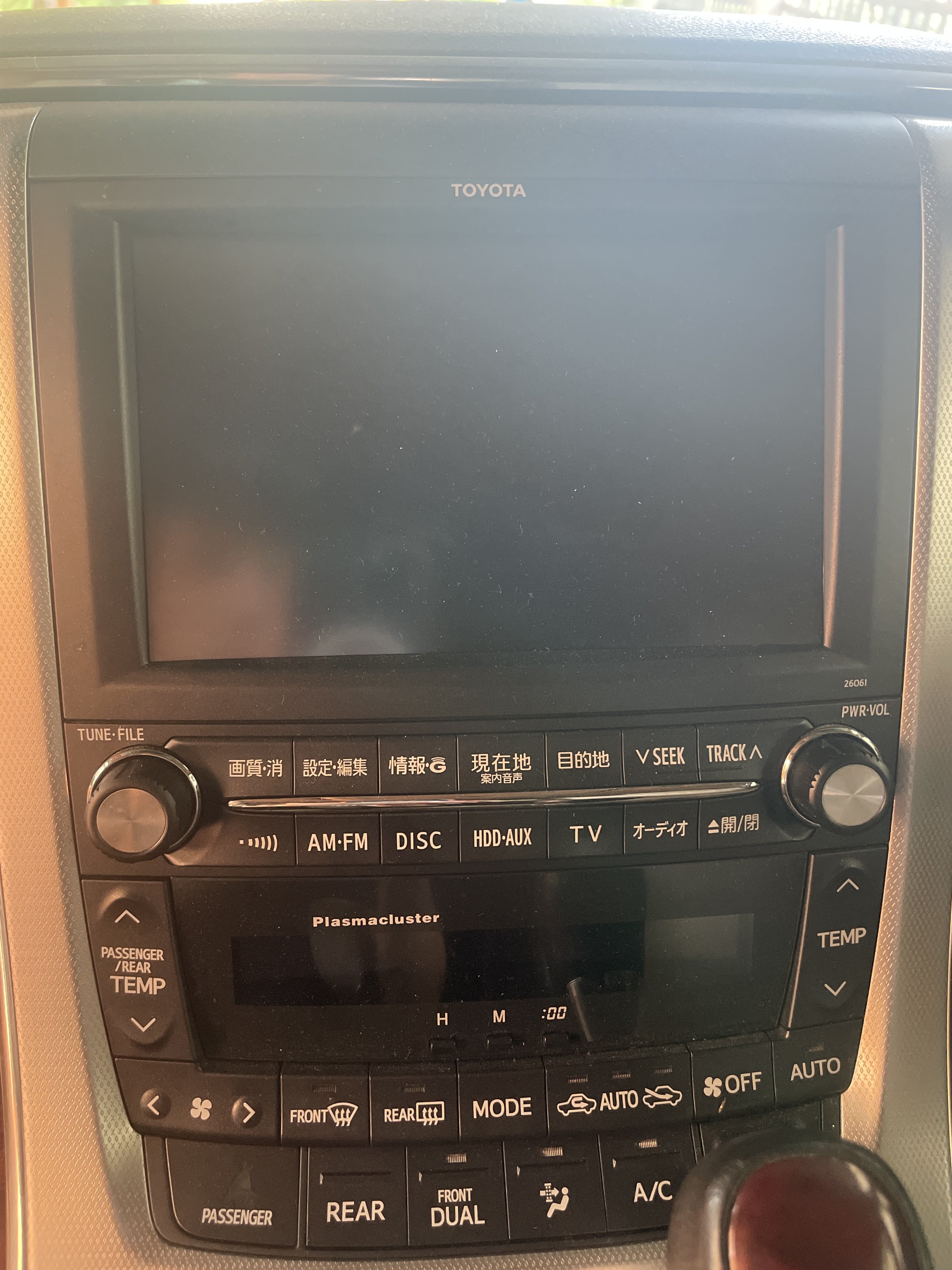

NicolasEly Posted January 12 Posted January 12 Good day, We own a 2011 AH20 Toyota Alphard which was imported from Japan to Australia. As it’s imported the head unit is all in japanese. We are looking for a new head unit that is in english so we can use navigation etc. However we would also want to try and keep some of the existing features (ceiling TV, steering wheel controls etc.). If anyone can help us out with finding a replacement unit, that would be greatly appreciated. 1

NicolasEly Posted January 13 Author Posted January 13 Hey Rojie, thank you for your answer. When you say our head unit is settable to English, do you mean the head unit that is standard with our vehicle (HU-no. is 26061) or do you mean any replacement head unit? Thanks for your help.
Rojie Posted January 13 Posted January 13 6 hours ago, NicolasEly said: Hey Rojie, thank you for your answer. When you say our head unit is settable to English, do you mean the head unit that is standard with our vehicle (HU-no. is 26061) or do you mean any replacement head unit? Thanks for your help. Thanks for the photo. I don't have a model as recent as yours, so cannot be specific. However, many of the later head units can be set to English. Until you get a more helpful answer, you may care to use the search box on your home page, top right. Try head unit, set to English, or similar. There have been many requests for this task so you may get lucky. Hope so.
Quimbasher Posted January 29 Posted January 29 I believe the standard headunit in the facelift 20 series models can change language, which is 2012 onwards. Otherwise I have seen people fit a module behind the standard headunit which enables android auto/car play. This is the route I would choose over buying an aftermarket headunit which would probably require a new camera and drop screen. check out the alphard groups on the socials for this, ben hau is the man that does the modules. iv used google translate to work out the few menus/ buttons I regularly use. 1

Chris.ac Posted February 4 Posted February 4 That head unit is stuck in Japanese. It's a JDM model number. Some later 2014 versions had English, as well as the export models (hong kong, Malaysia) That 3rd button with a G is a giveaway, as it means it is configured to connect to the Japanese data network, the export models do not have that button. That said, it has Bluetooth media and Bluetooth calling, and you can add a carplay box, and a small mod to the touchscreen that allows you to use it use your phone to display satnav etc. 1

Chris.ac Posted Saturday at 10:05 PM Posted Saturday at 10:05 PM On 9/5/2025 at 9:30 PM, glarhzilla said: Hi. I know this was written a while ago. However do you have any more information or guidance regarding installing the mod to enable carplay/android auto? Thanks You need to purchase a generic/Toyota compatible box from somewhere like AliExpress. You will need one that has an rca output. The box will usually come with either an external controller or a touchscreen interface board. I opened the screen and used a ribbon cable to connect to the touchscreen that has a switch to select of the touchscreen settings signal to the carplay box, or the official headunit. I interrupted the parking brake signal to the headunit so that the aux video remains on when car is in motion. 1
