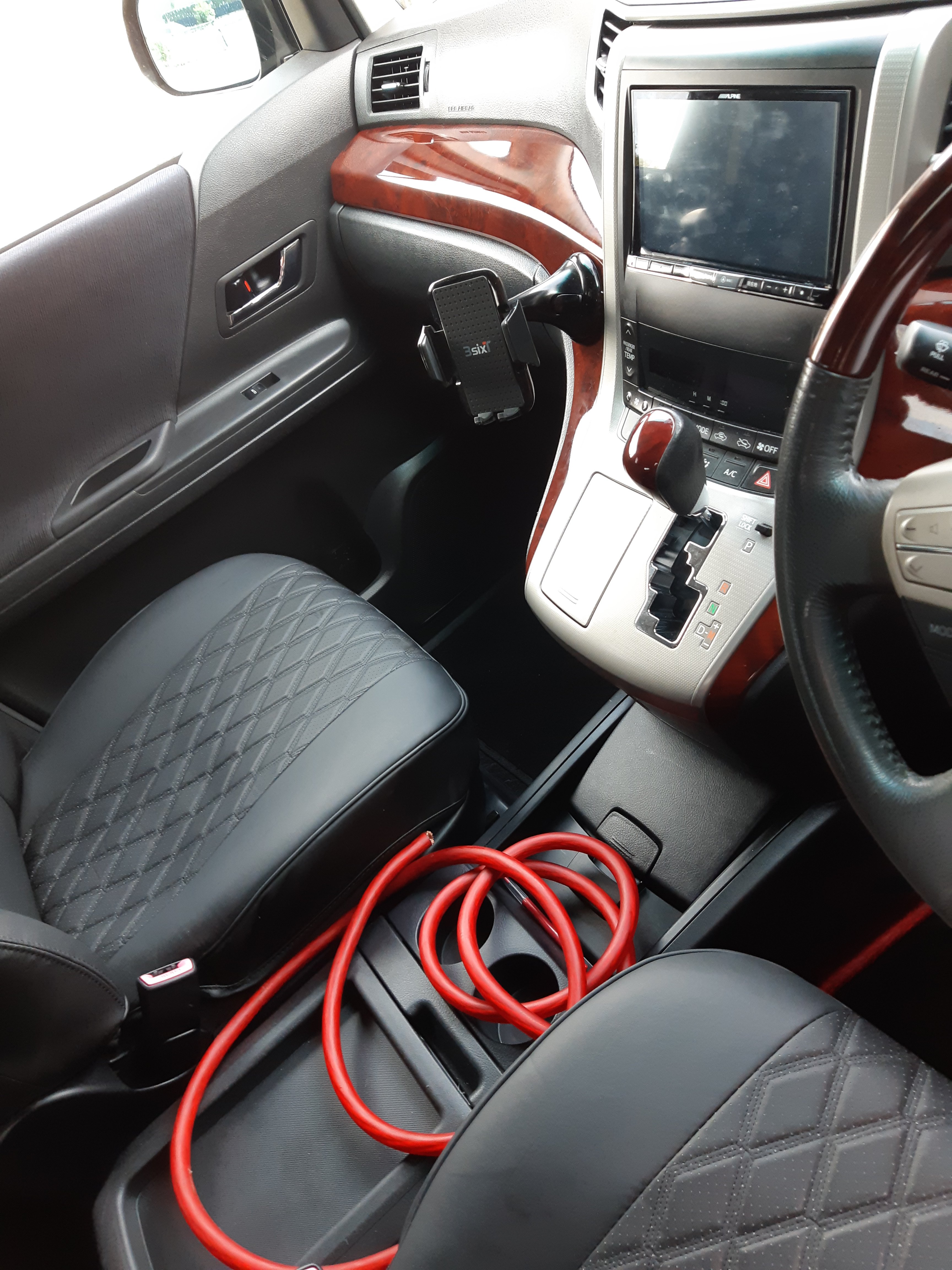

How do gang, anyone know how to get the wood bits off the dash, primarily the element Infront of the passenger and the panel to the right if the instrument cluster?
The centre sections look easy enough to get out with the middle of the dash removed, I don't want to snap the other bits.
I want to wrap them and have my steering wheel re done to delete the wood which I think looks a bit dated.

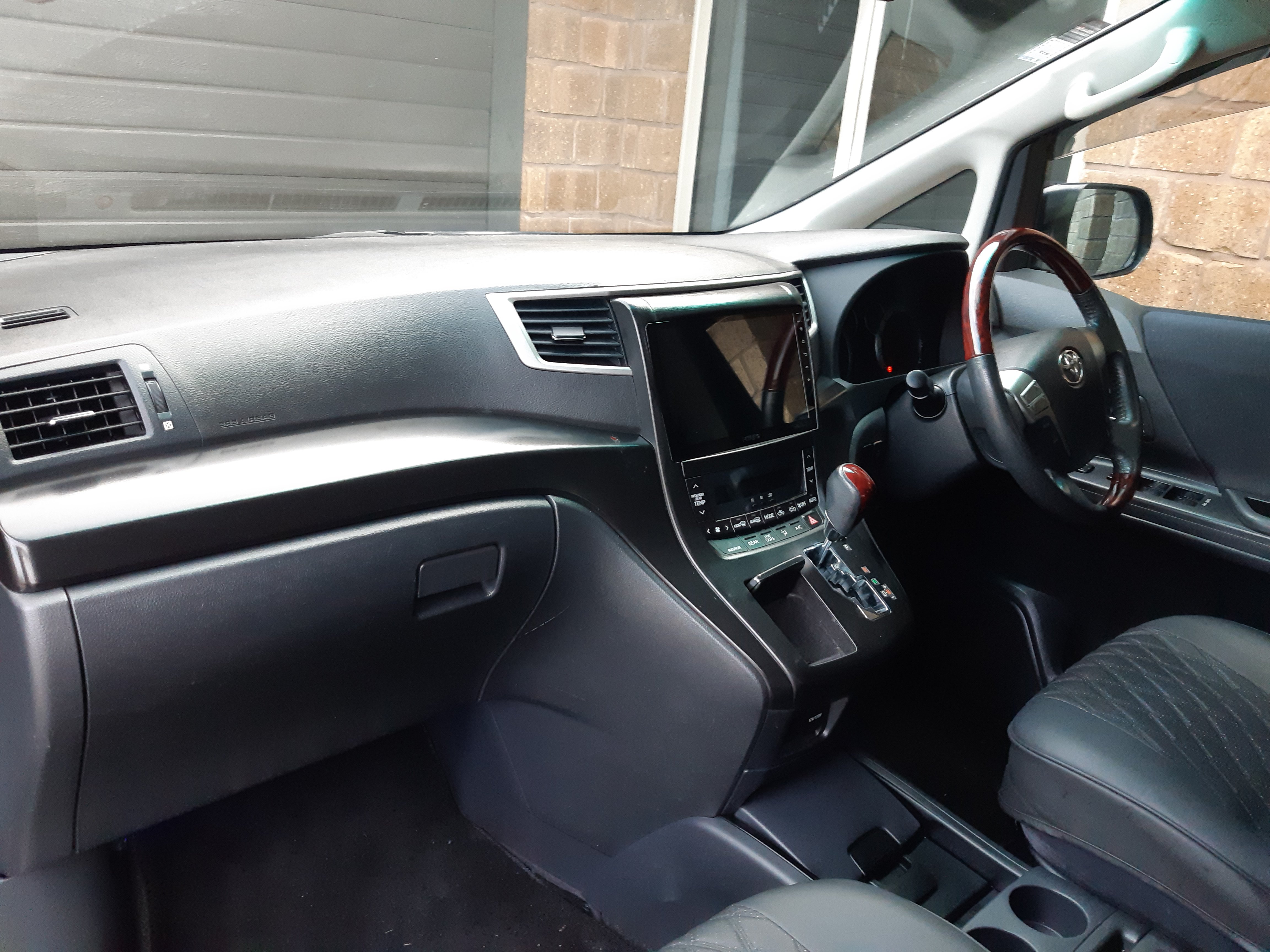

It's glued on normally, as for the steering wheel, if you change anything on it, it might invalidate your insurance policy. as for the others, you can heat it up and some of the panels are screwed in from the back.

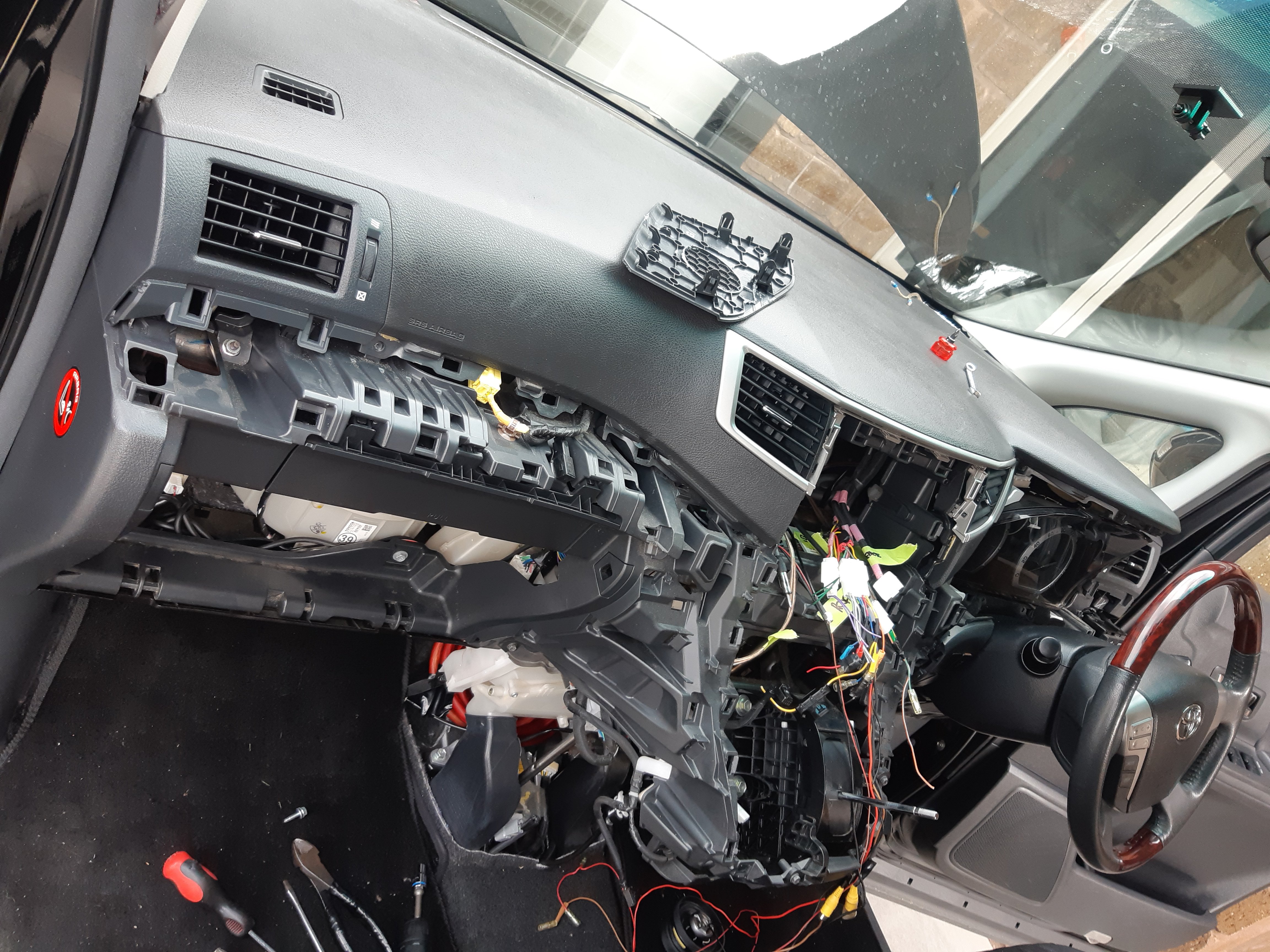

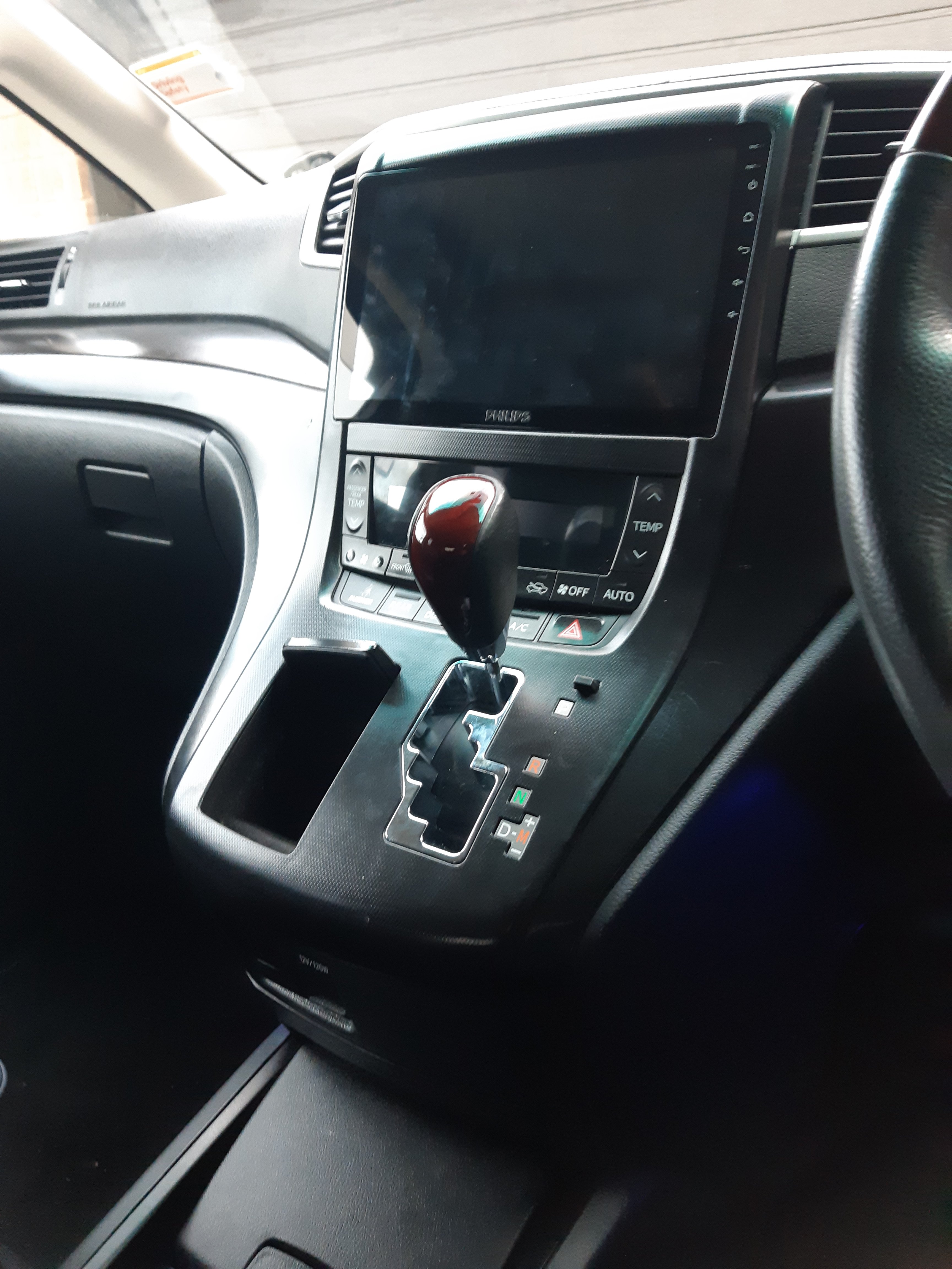

Hi mate the Centre stereo facia has to come out and the two panels need to be very gently up clipped, ive attached a photo of the clip holes.. I did the same thing but i painted mine all black.
