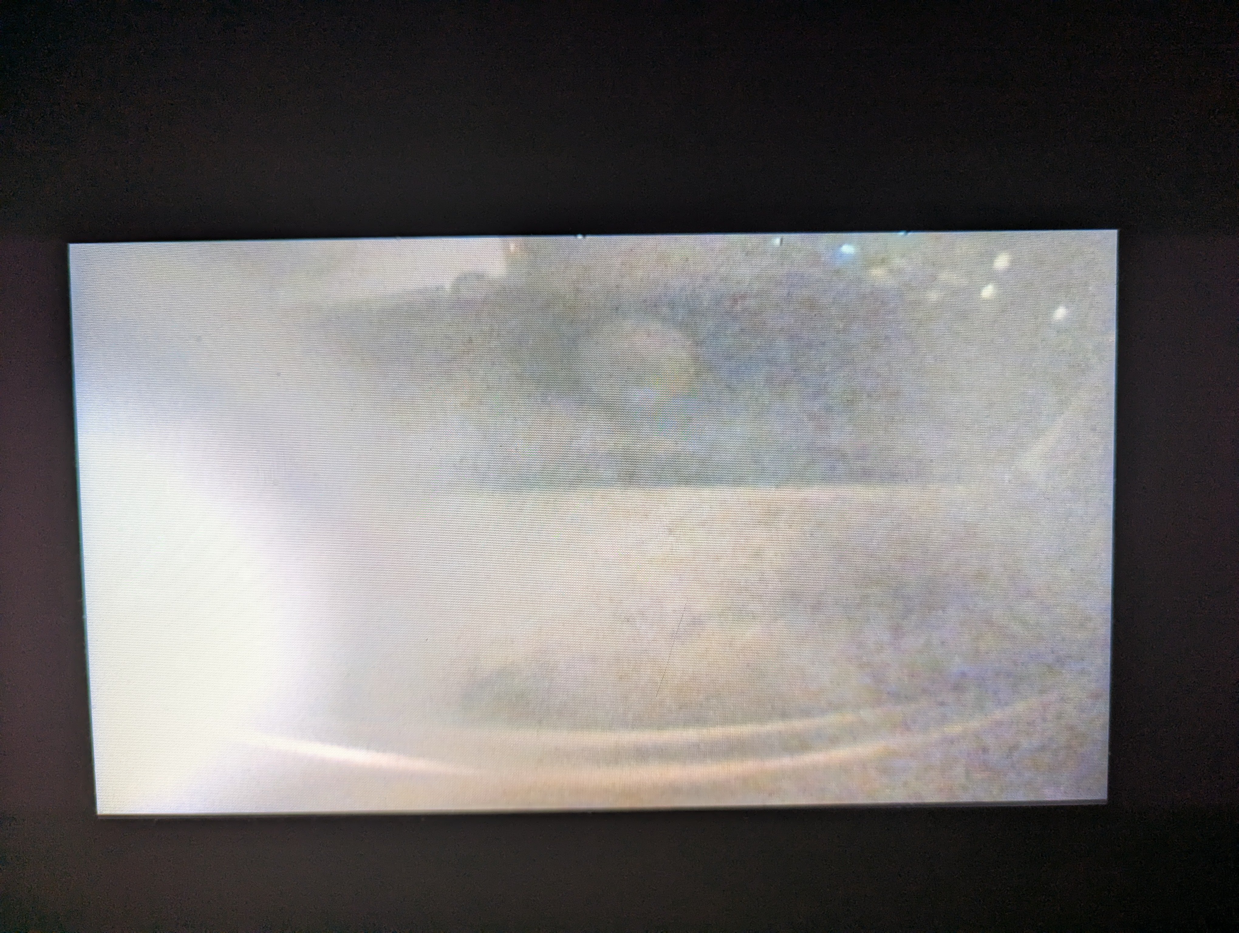

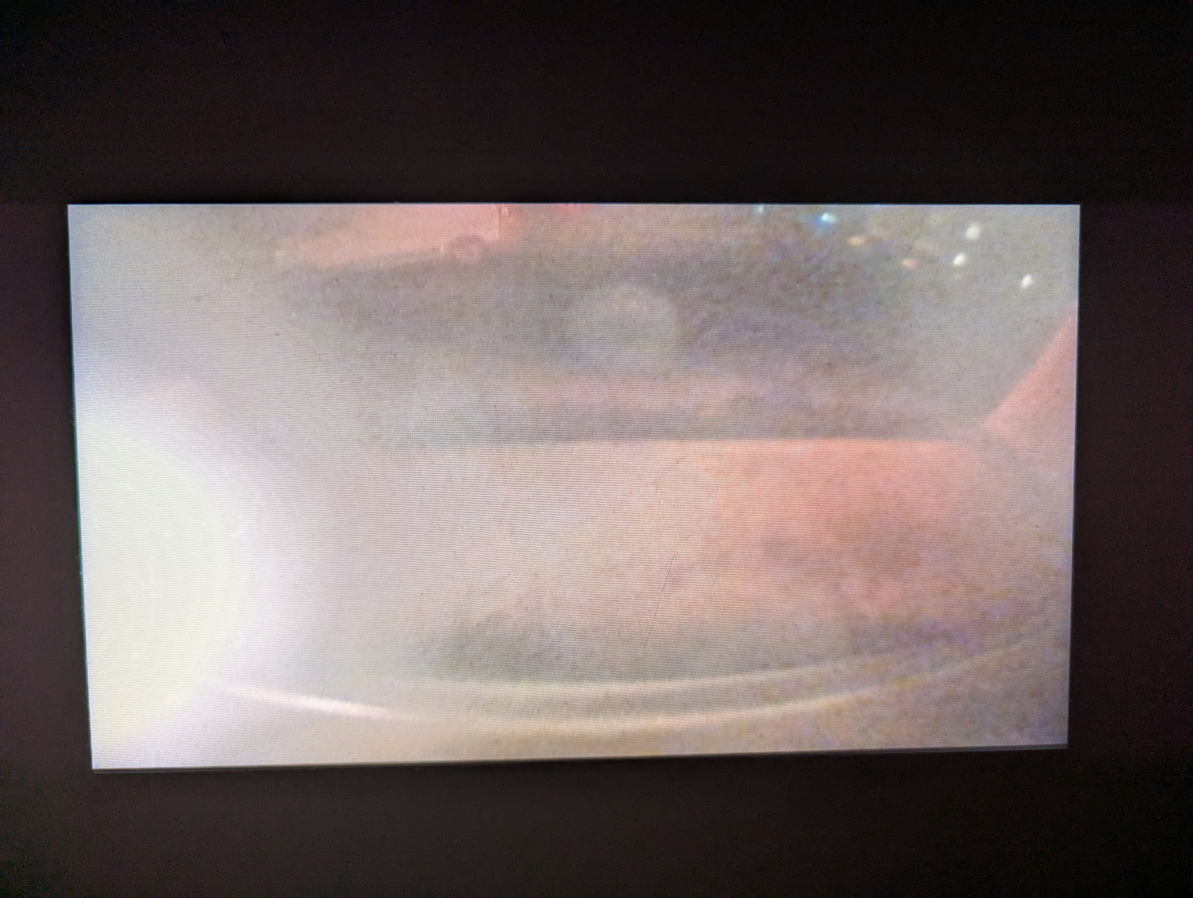

My gripe with the camera is that at night it becomes useless, because the light from the number plate lights affects it. Its even worse in the rain and as the original importer took one of the reversing lights to make a fog light, its limited anyway

The one with the red is when the brake light is on. the other is the normal view when I reverse

You are right, that does not look good, it's like it doesn't have a low light setting.
