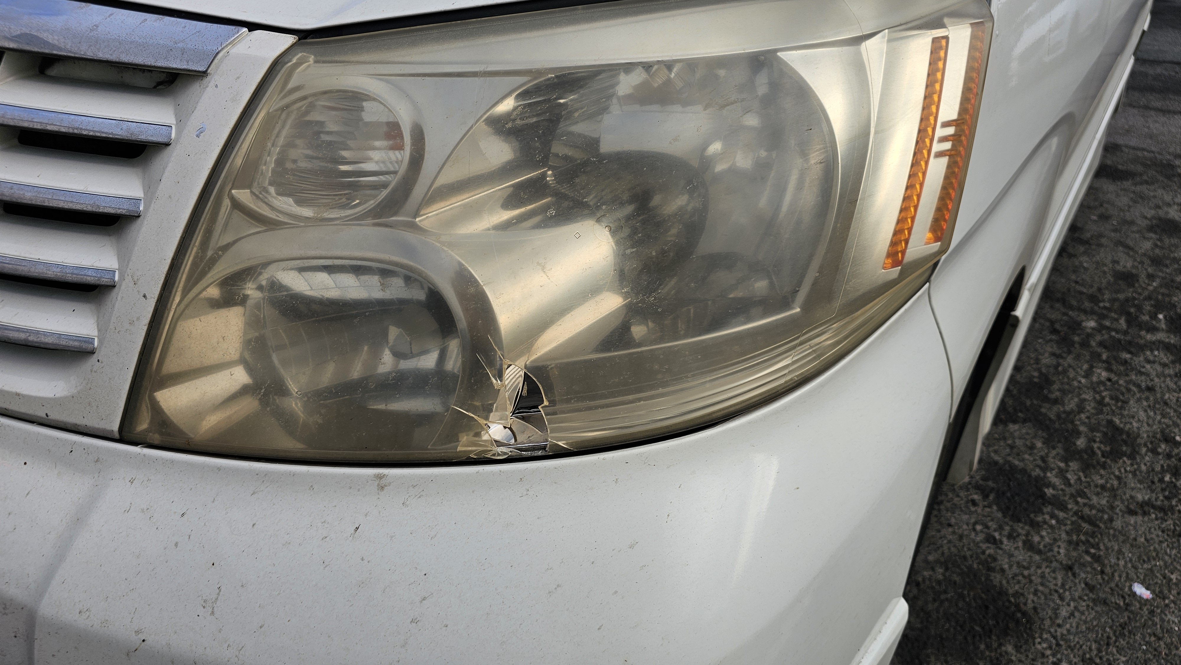

Hi folks, looking for some advice.
A couple of days ago my headlight was struck by some debris on the motorway kindly thrown up by the car in front of me and the headlight cover has broken as you can see in the image. I was wondering if it was possible to just replace the cover, as the headlight itself is working fine and I don't want to have to replace the whole unit given some of the prices I saw with my quick google search! If it is replaceable and someone could point me towards a good source of a new cover, I'd greatly appreciate it.

Hello Jacj,
They are expensive new, but you might find a cheaper one by asking one of the Jap Importers?
Failing that, there are several Japanese/TOYOTA spares companies, other than using main dealers.
Jbhtrams
And you could also do a search for breakers, though my sole experience was someone who wanted to charge the same price for a second hand bit as a new part from Japan.

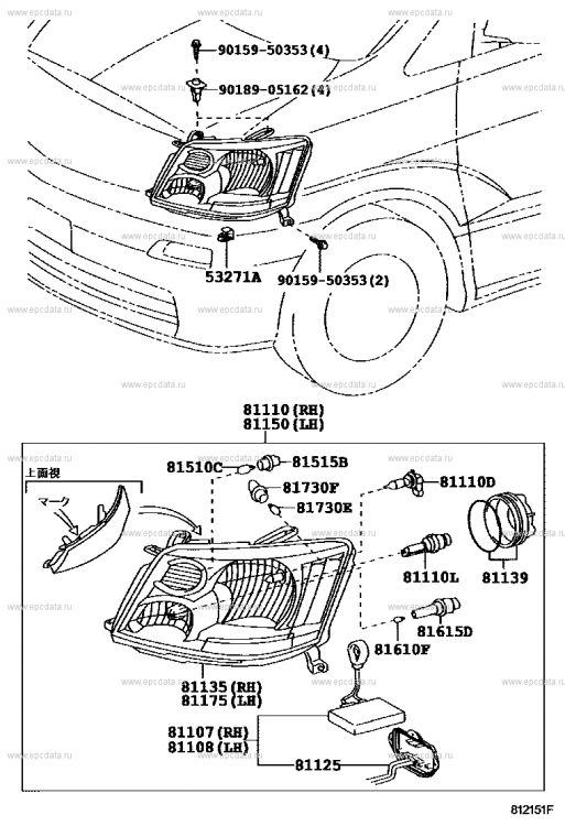

Has anyone removed the headlight unit.
I’m trying to get the headlight units out, I’ve removed the top 2 screws, it won’t move but can’t see anymore fixings.
I’m assuming that there must be fixing behind the bumper .
thanks

How did you get the headlight out? Did you have to remove the bumper.i want to get mine out so I can change the clear lens on both.
Hi Mark,
There's a screw at the bottom rear of the unit, which is covered by the bumper, so you need to remove it for access. It's also held by a slot on the bottom front so once all three screws are out, it'll need a bit of wiggling but should come free.
Edited by Cornish Moose
1 hour ago, Cornish Moose said:
Hi Mark,
