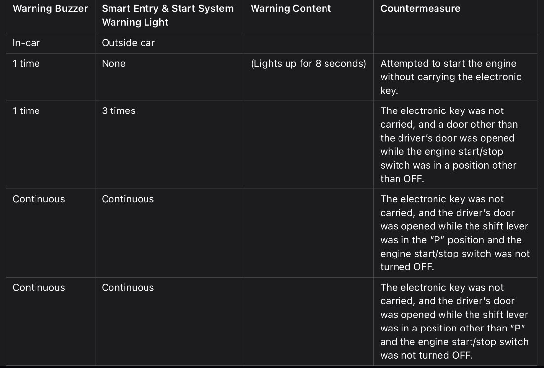

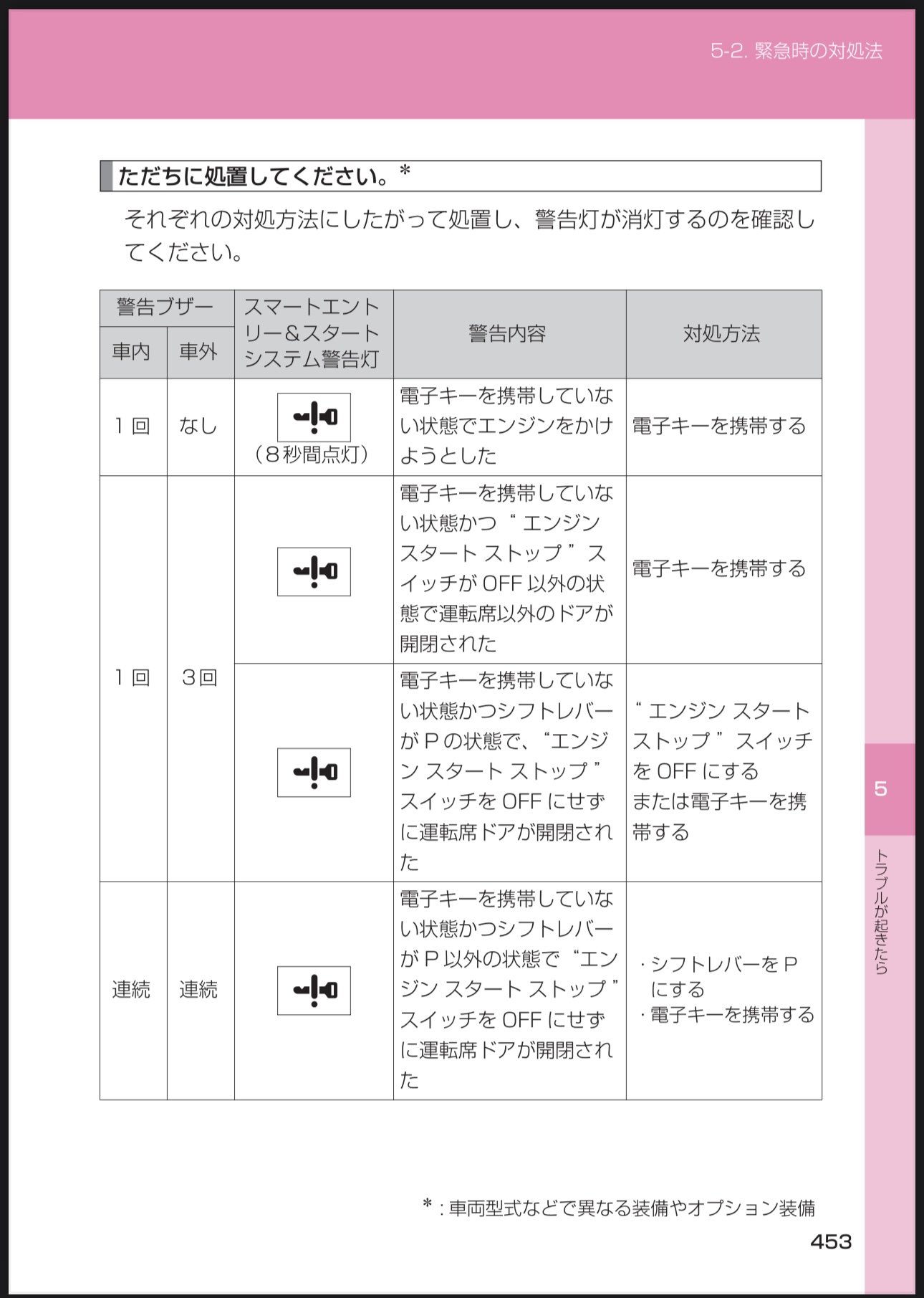

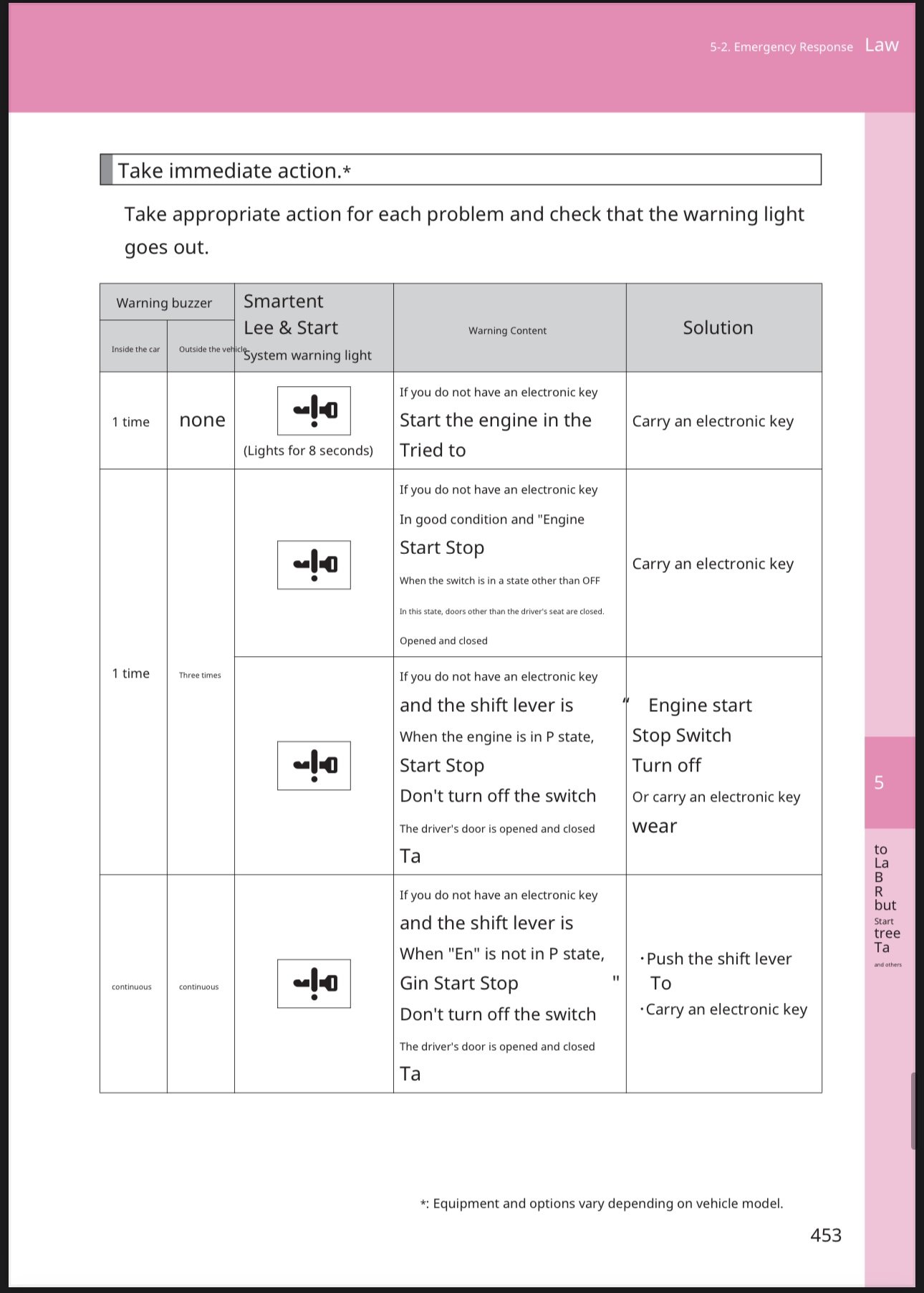

From the manual. Rough translation and what ChatGPT says.
Hello Jimmy,
thank you for your reply, the light was on for a while when it happened. There was no buzzer either. I think the van is not seeing the key at times, just not really sure why though.
thank you

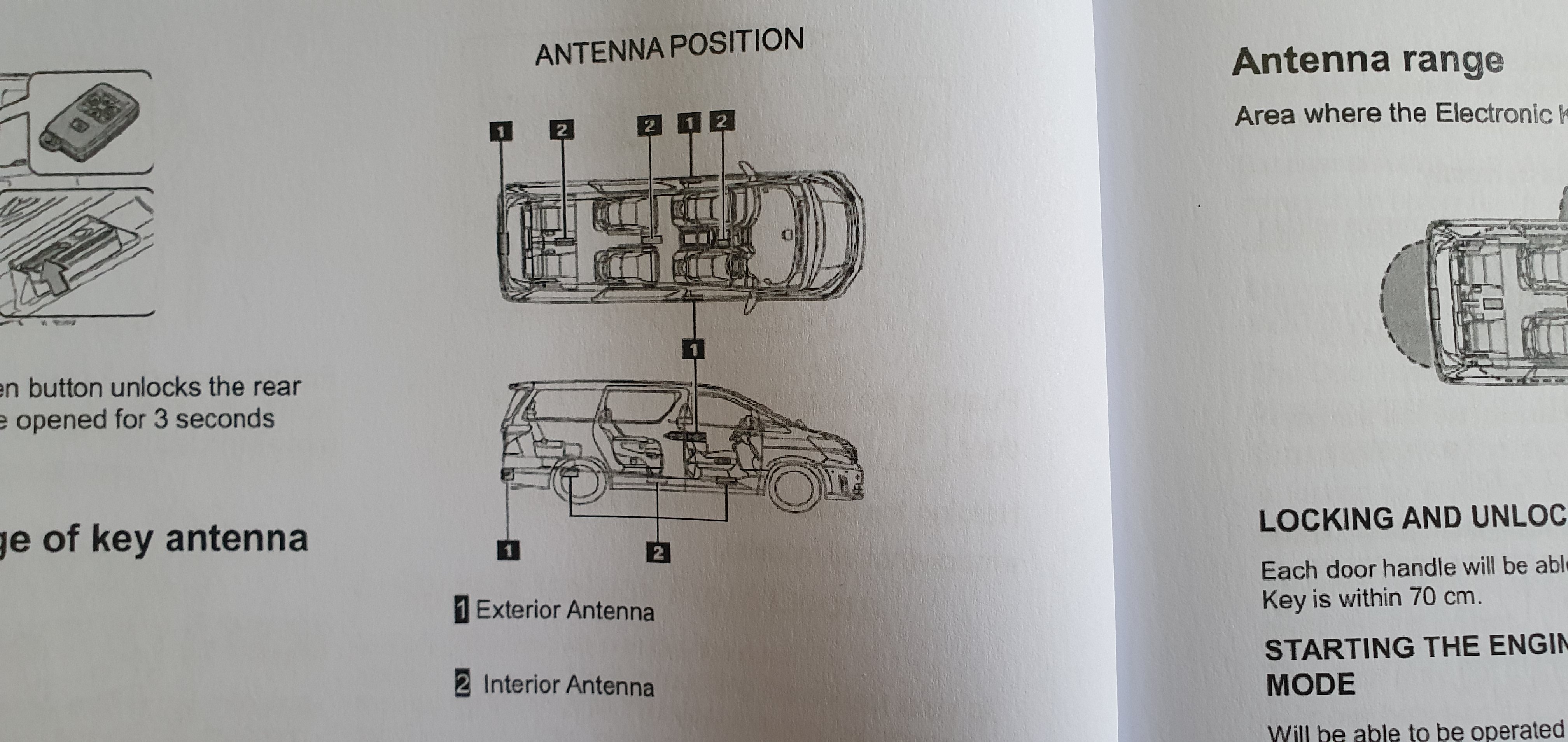

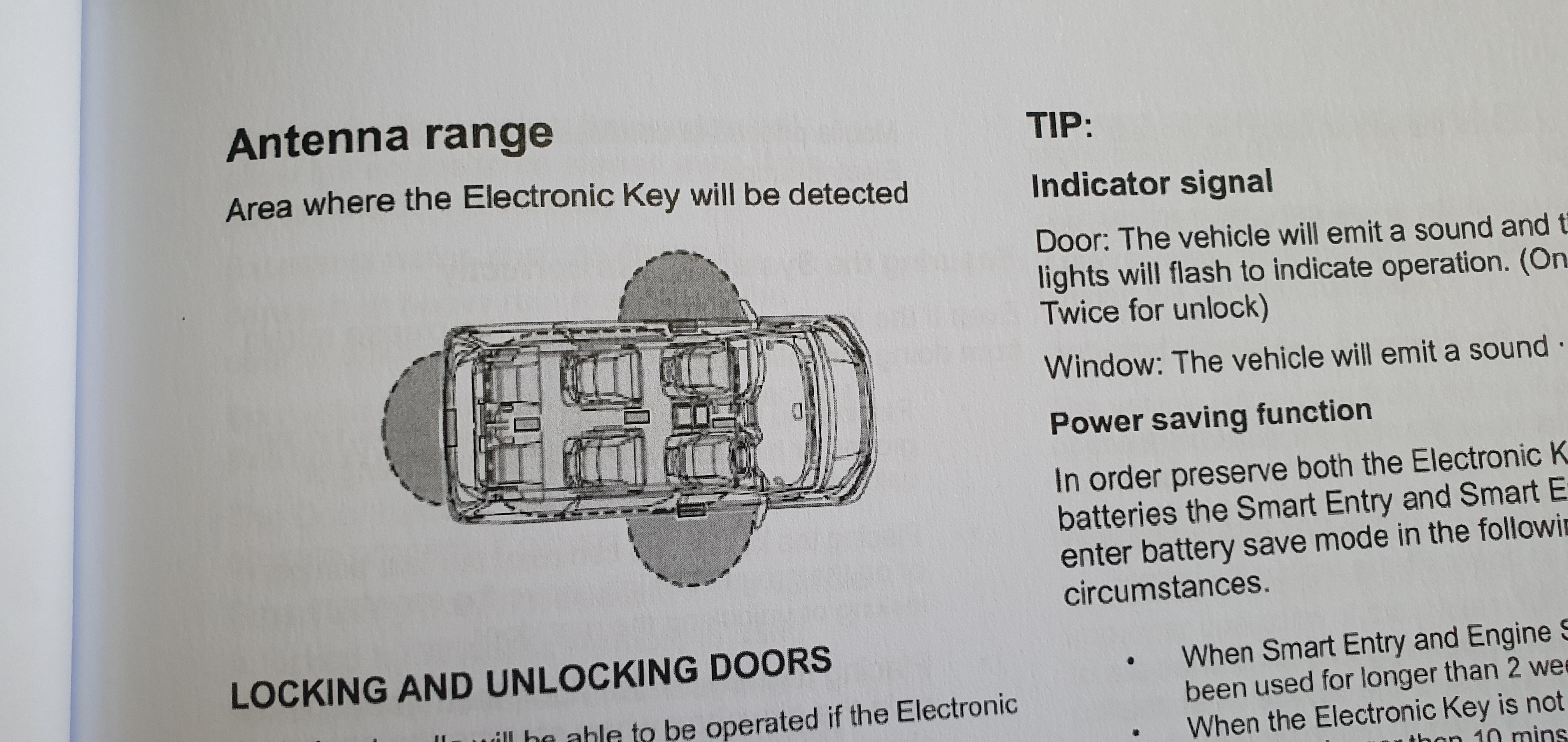

Is there any chance whatever the key is in could be reducing its signal strength at all?
There are 3 zones within the Alphard, i believe by default, the fib has to be within 100cm of the start button to work effectively.
You can expand this so that the key can be further away via the obd2 port using the right software.
