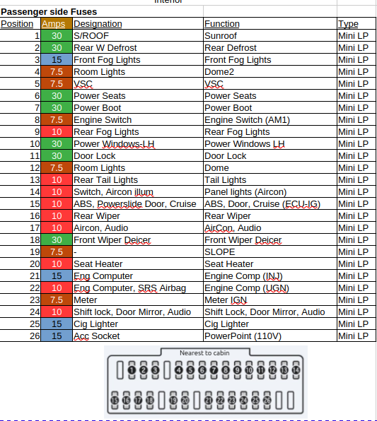

What about the fuses on the passenger side behind the glovebox?
I see fuses 17 and 24 are marked as 'audio' for my 2005.
There may be fuses in the head unit itself, so taking that out to check is an idea.
