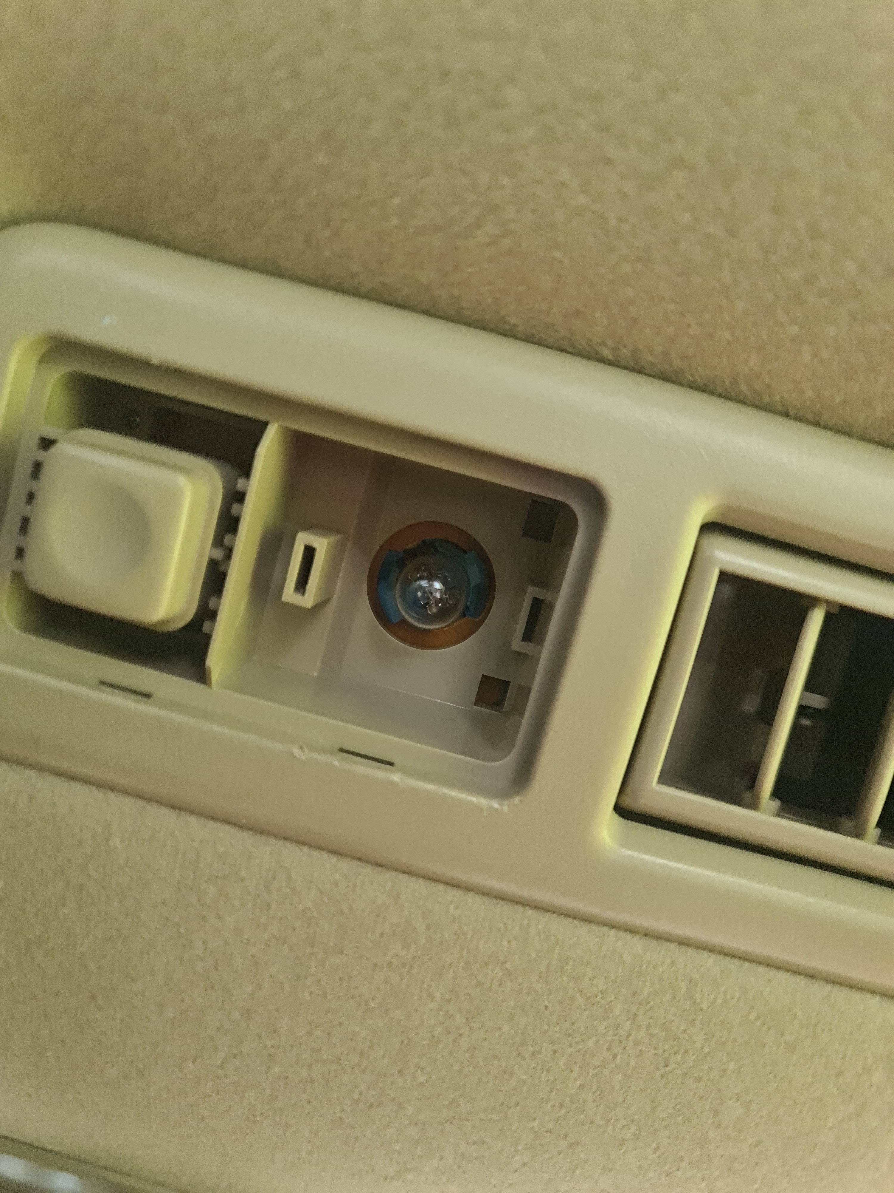

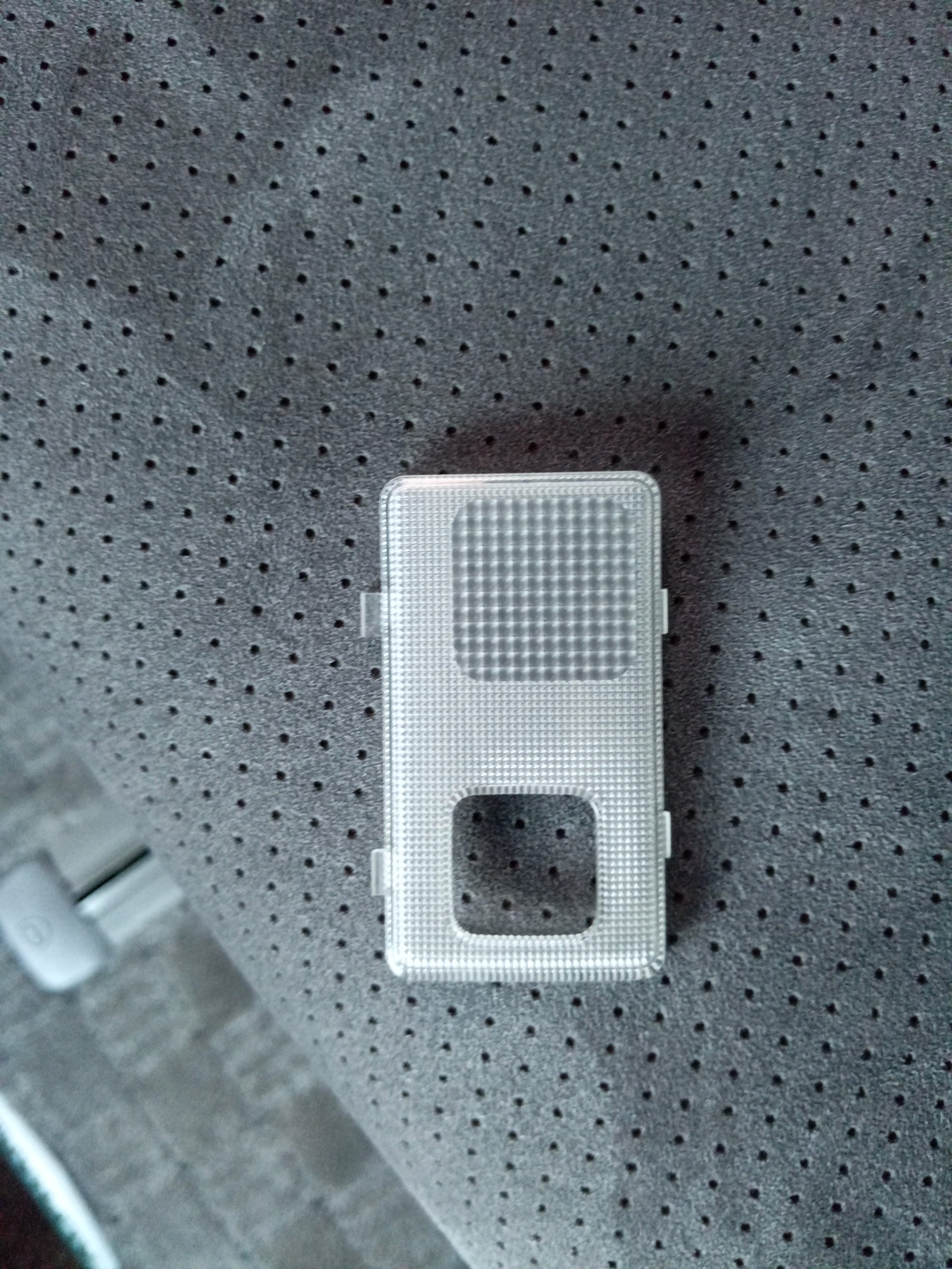

Has anyone succesfully replaced the rear interior lights (the ones in the air vent outlets) with LED's? I understood they are W5W bulbs, and although I have (eventually) removed the lens cover I cannot get the bulbs out. They are surrounded by a metal shield which makes it impossible to grip the bulb, and only one side of the shield seems to detach - again not providing sufficient space to pull the bulb. I dont want to apply too much force for fear of breaking something. What am I doing wrong? 😬

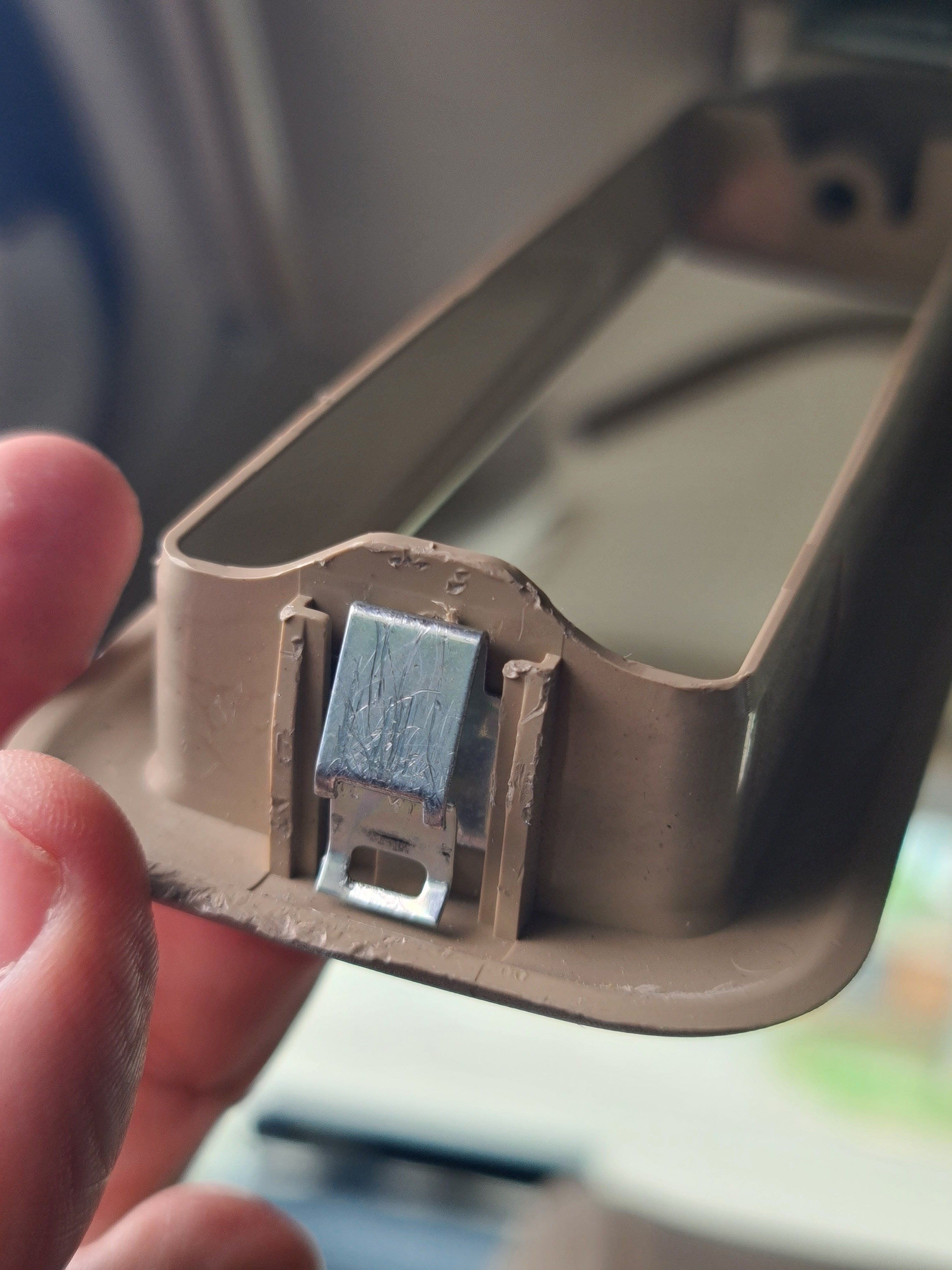

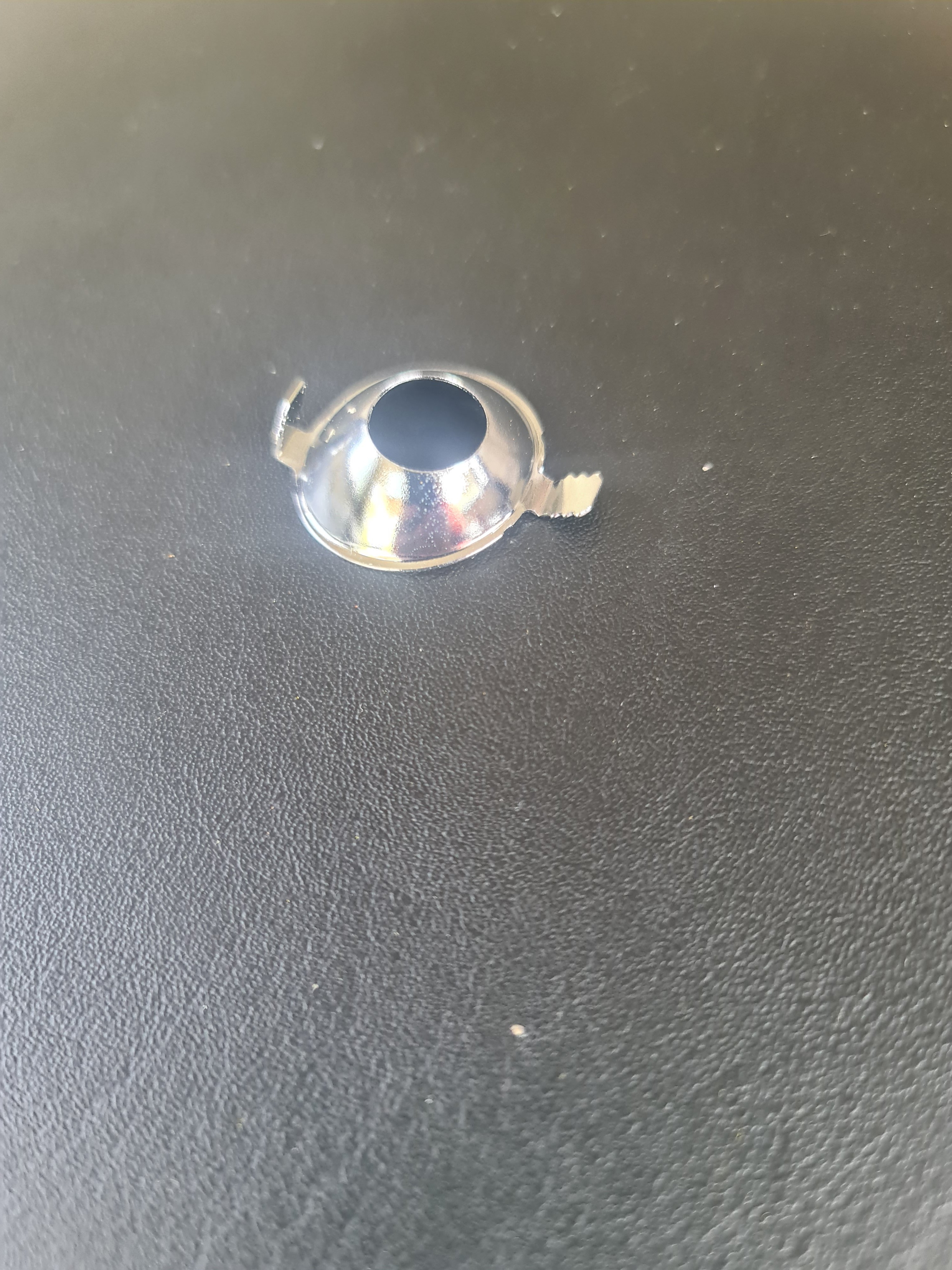

I replaced mine, I levered out the side with the R on it then bent the whole reflector up and pulled the other hand side straight out, I then filed down the serrated bits on one side of that tab, then bent it back in to shape, then pushed the whole thing back into the slots

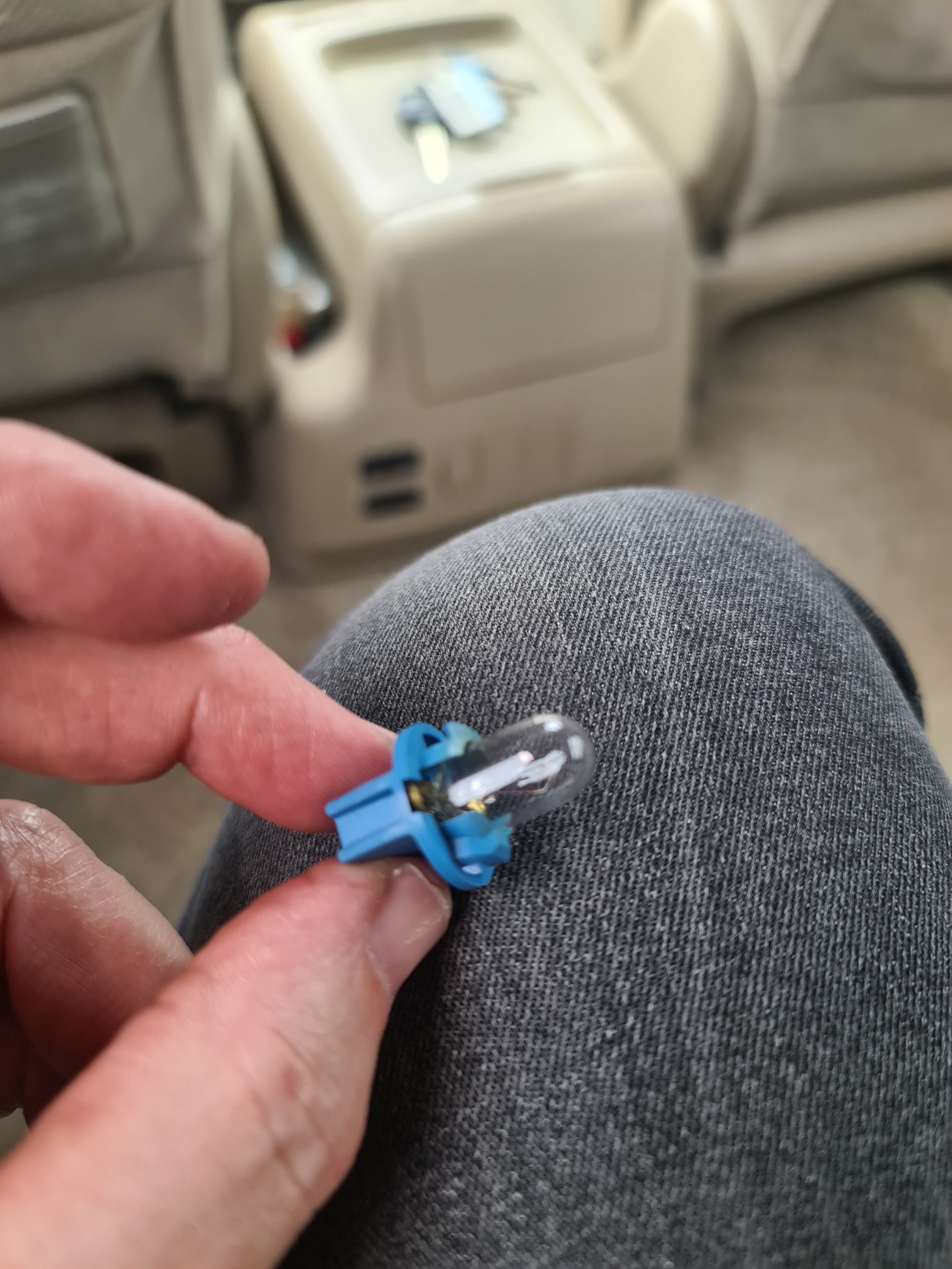

If it *is* a W5W type bulb then they should pull out relatively easily (like a sidelight bulb). There looks to be a blue 'collar' at the base of the bulb which makes me think it could be a different type of socket. I've not had chance to retry removing the reflector yet.

Yes just pulls out, do not twist as the holder will fall out behind, 5W capless or led equivalent
Thanks @daiwil @dezufo for your help - I just wasn't pulling hard enough! 🙄

Once you have removed the reflector they do just pull out - but requires rather more force than you expect and it is quite difficult to get a good grip on the bulb.

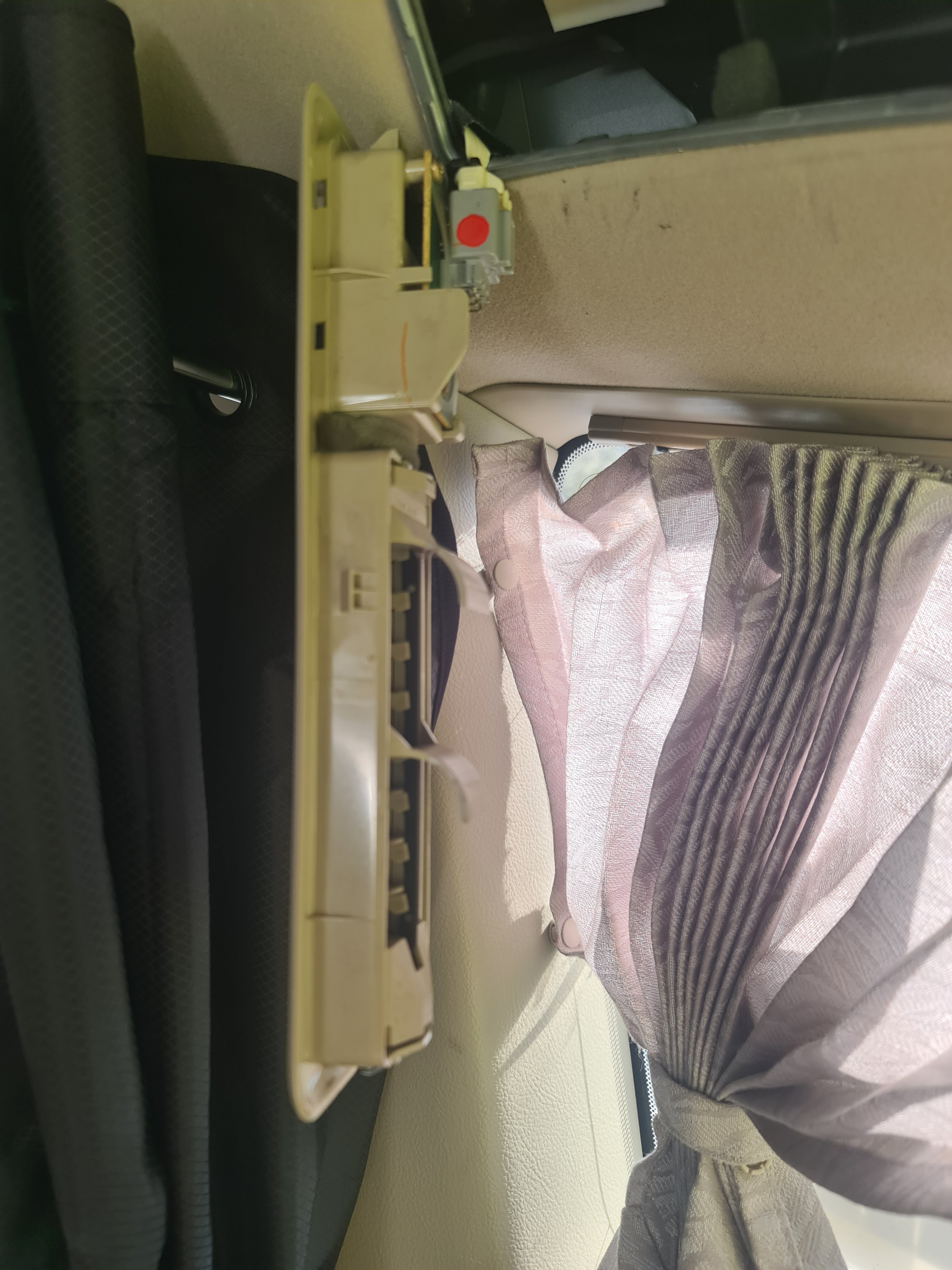

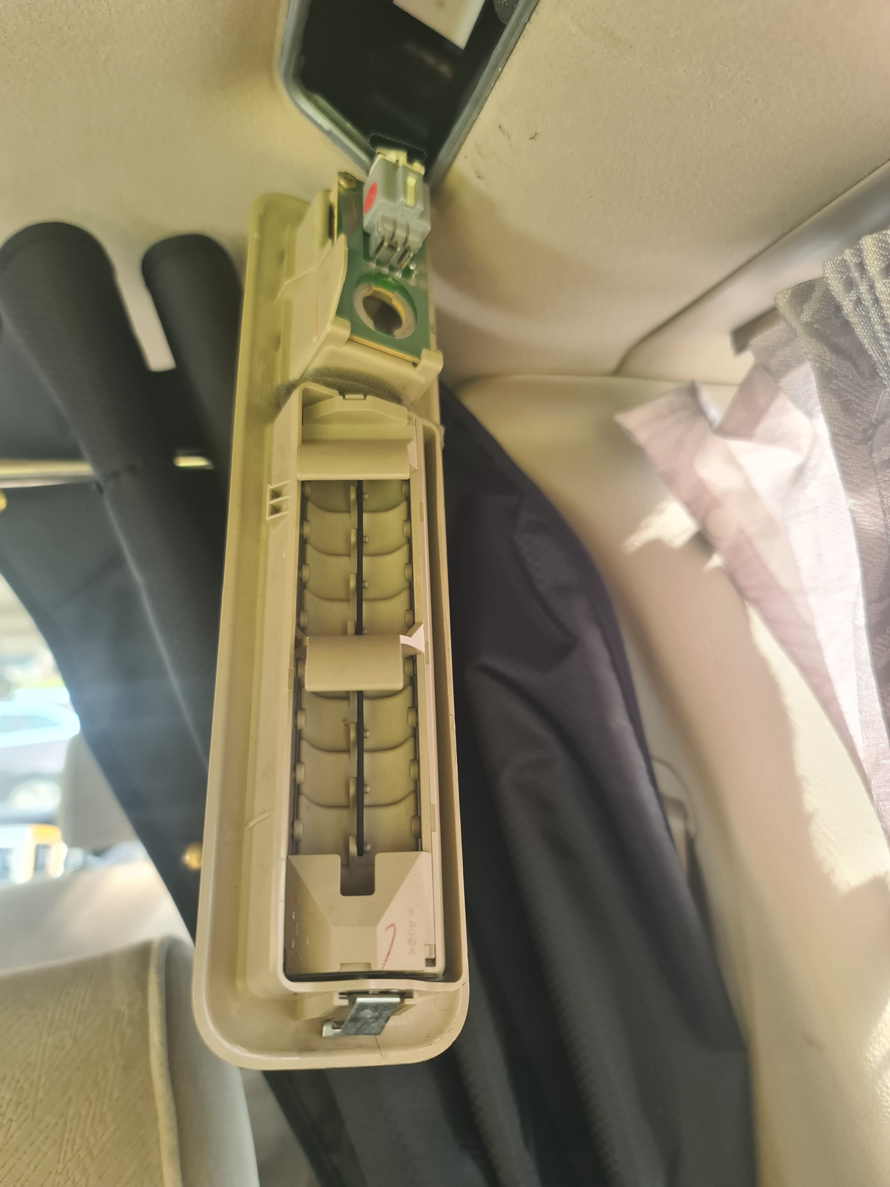

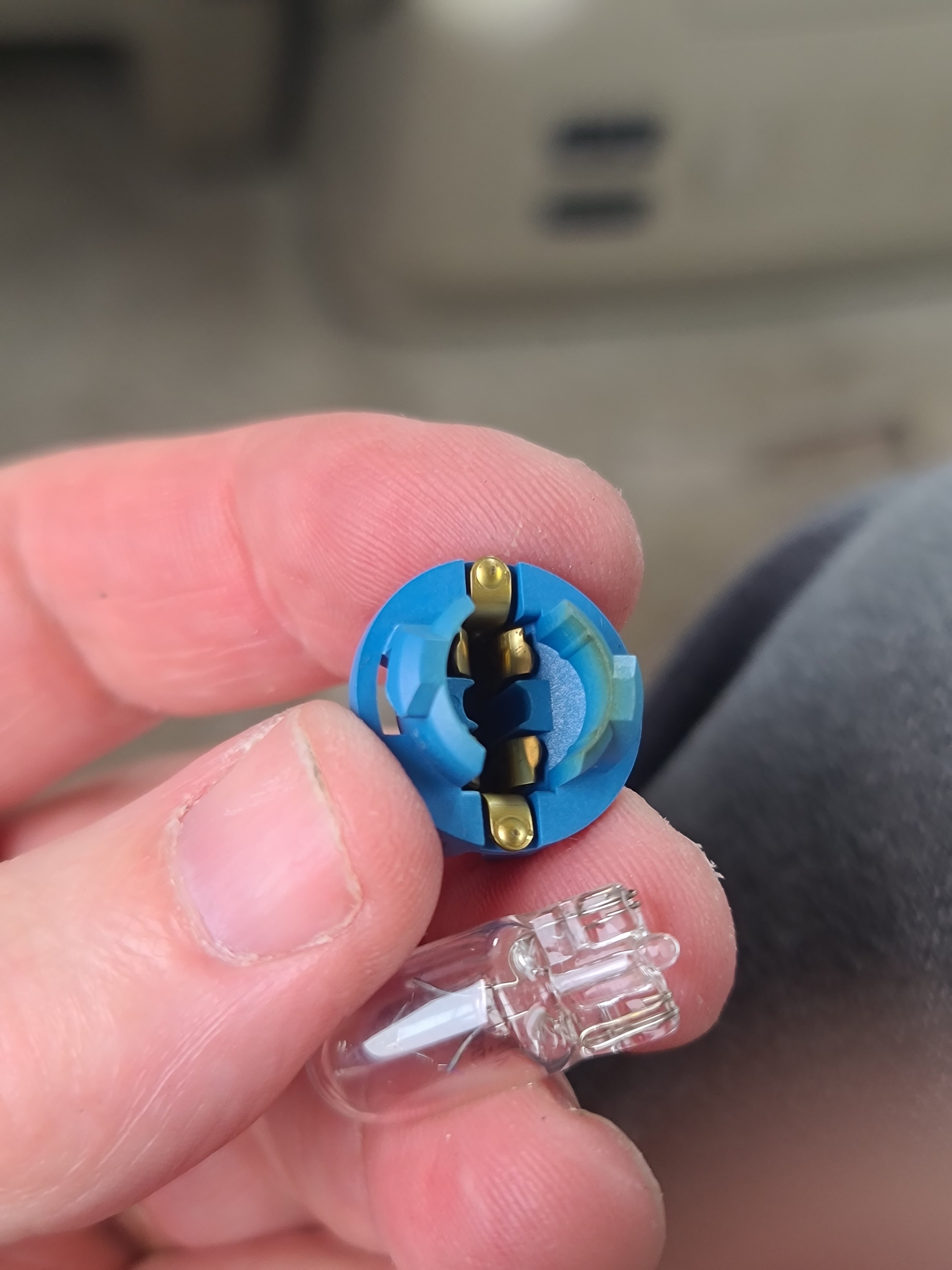

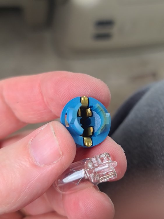

I have tried this and came a cropper - I now have a missing bulb and holder inside the side panel somewhere.
I was able to get the cover off but I was trying to release the bulb and managed to unclip it - when it then disappeared into the depths.
I then undid the mounting to understand how it goes together - which is what I should have done first.
So now I need to find a twist mount for the bulb I was going to put in.
It seems the best / only approach is to unhook the surround from the interior panel by levering at the end that doesn't have the hook (which can be seen at the top in 'Extracted-Bulb-holder.jpg') and then removing the twist holder and replacing the bulb that way.
I hope the pictures help someone.

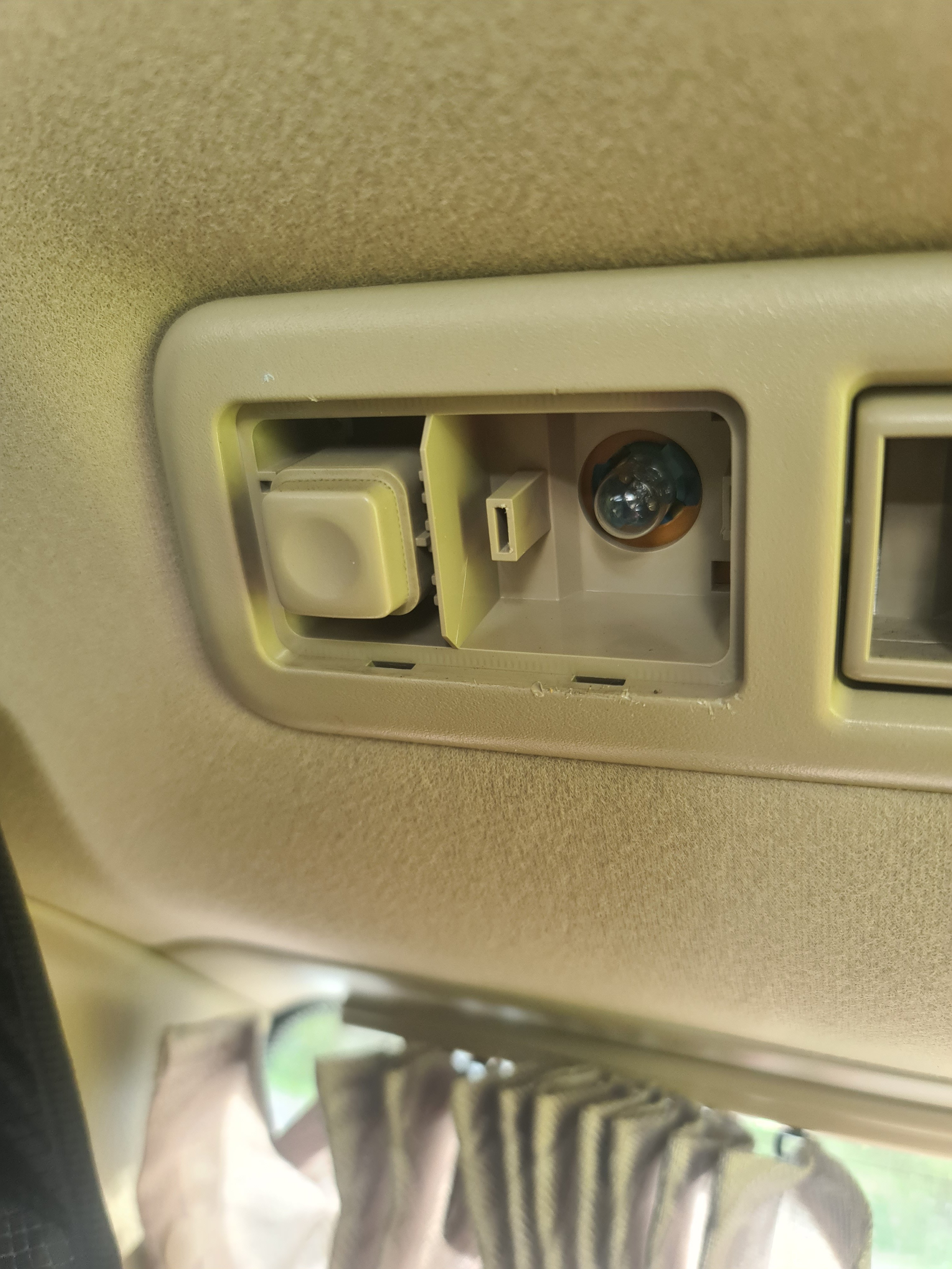

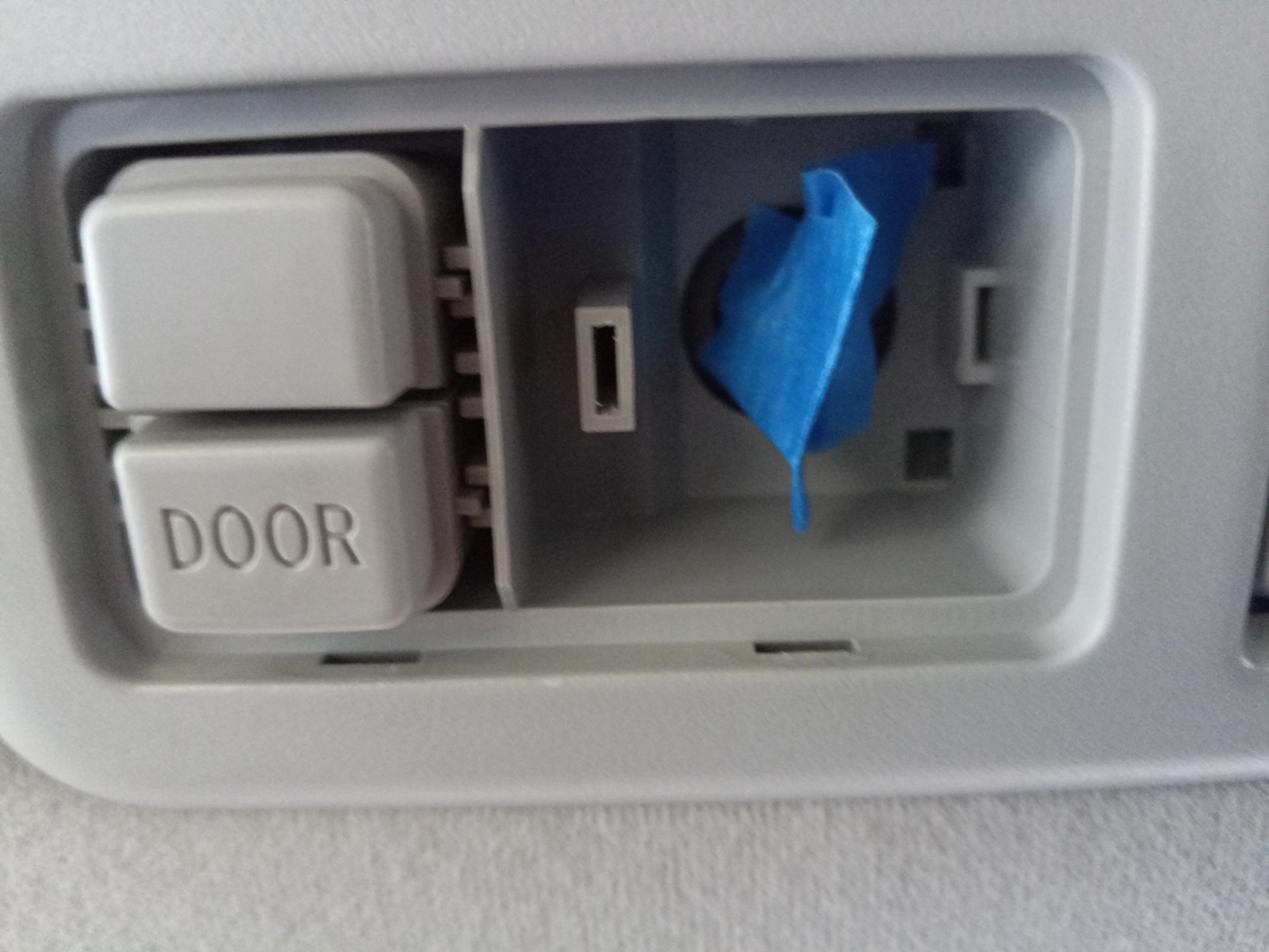

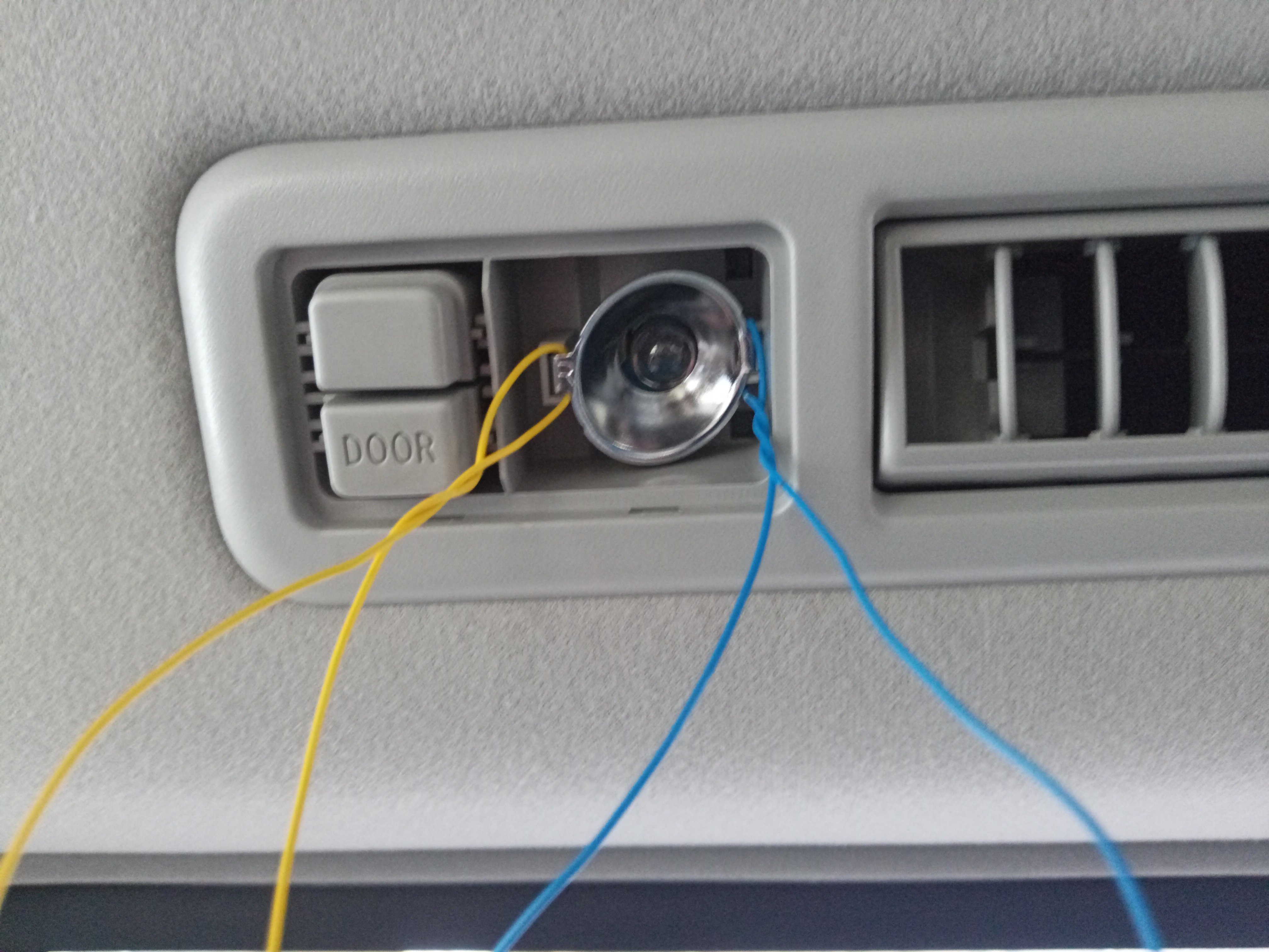

I tried and failed to unclip the whole light unit so I replaced the bulbs by doing the following:
Pry off the cover with a flat bladed tool. I made one by grinding down a hacksaw blade but I think you could use a jewellers type screwdriver or similar
Next loop some wire around the ends of the bulb reflector and carefully pull it out evenly

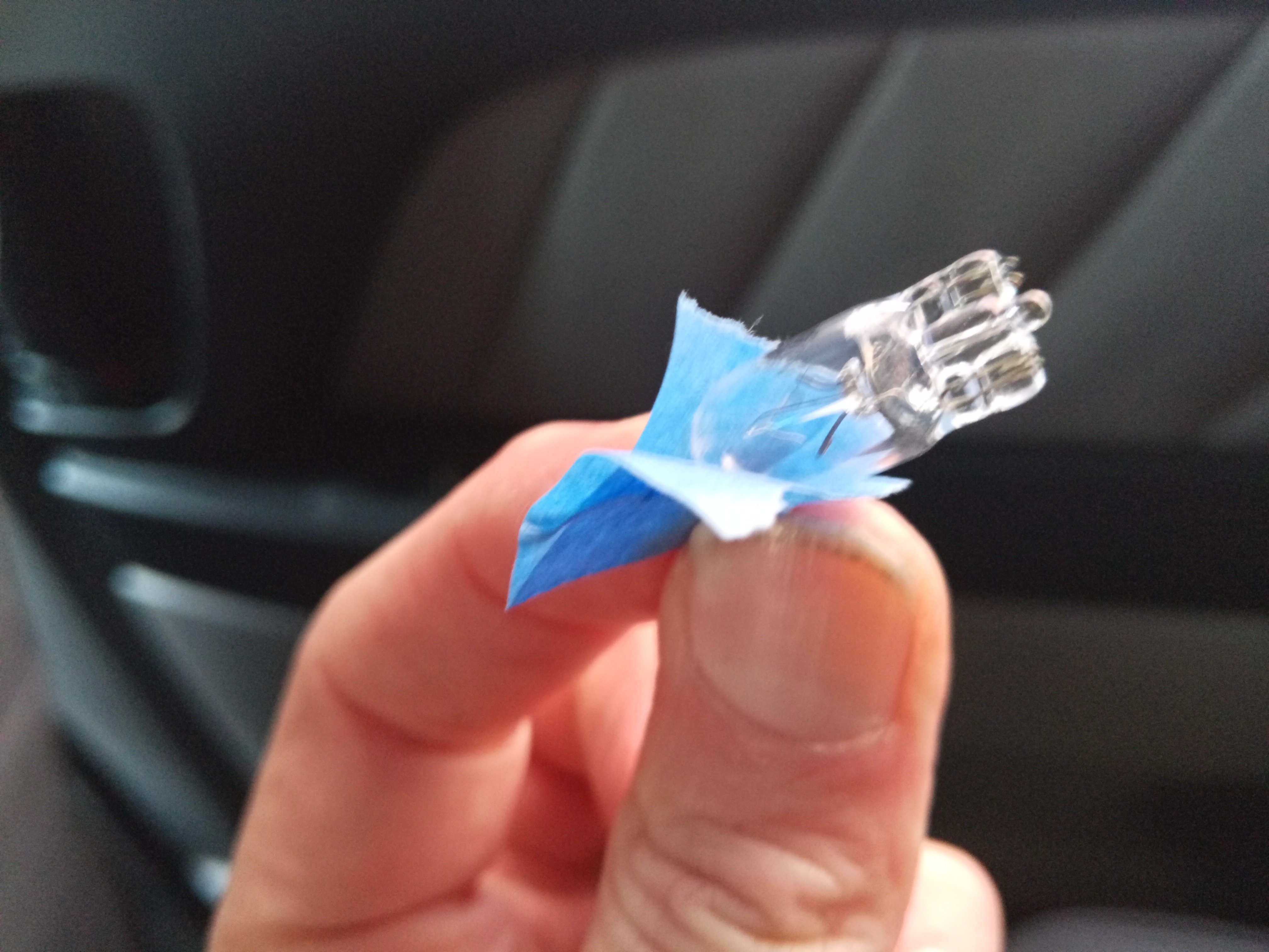

To aid pulling the bulb out, add some sticky tape to it (I used paper masking tape)
Pull the bulb out!
