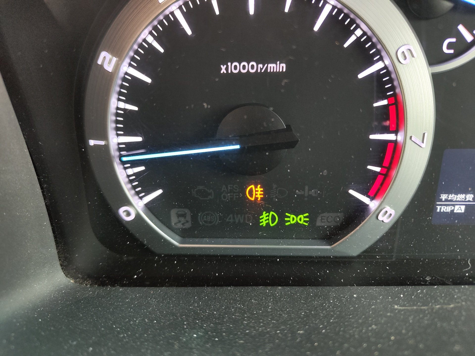

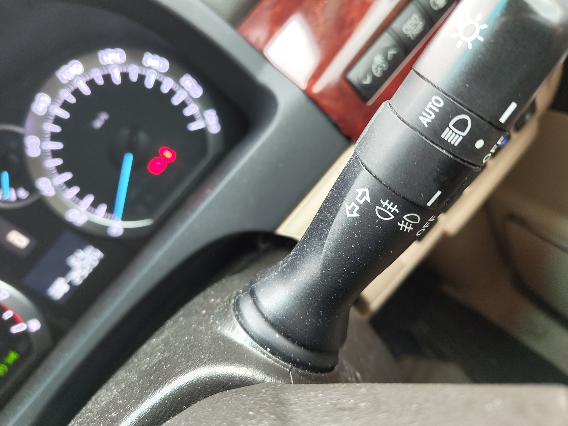

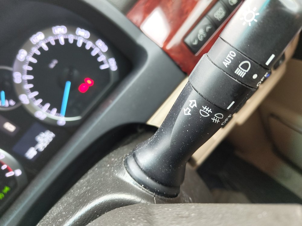

It depends on your budget, and how legal you want it.
If you do it the way a few of us have, you'll fit a new indicator stalk, and replace the reflectors with a e marked retro reflector with leds
I am invested in keeping my alphard on the road until I am no longer able to drive, so doing the job properly is in order, I think as you have the stalk with both fogs is in order and have found the part on amaya. Going to be ordering it soon.
