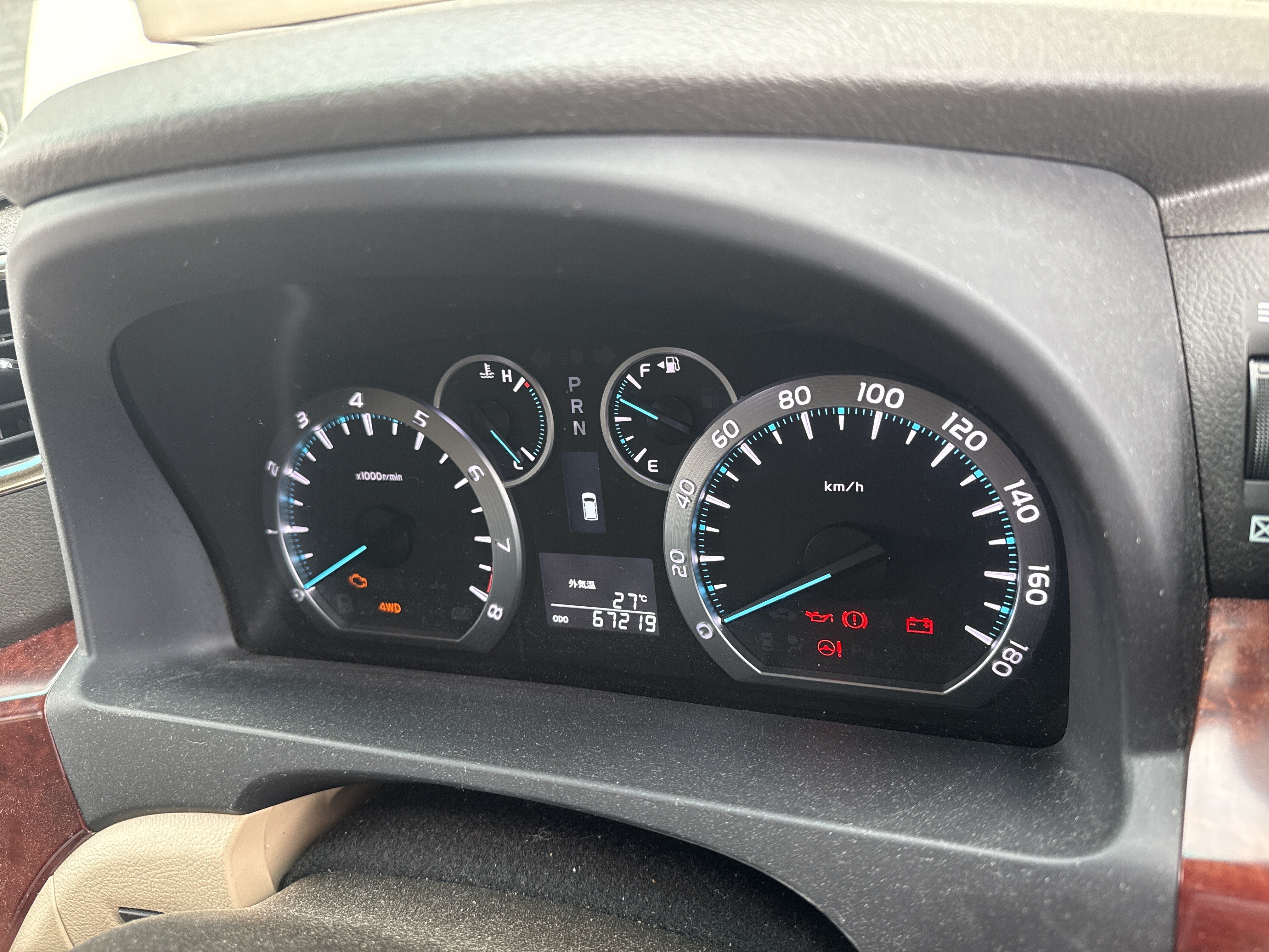

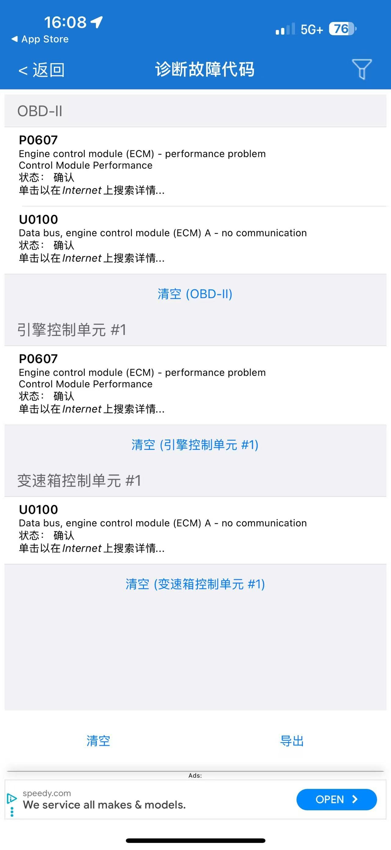

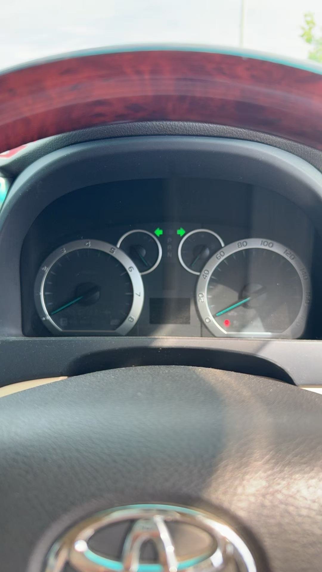

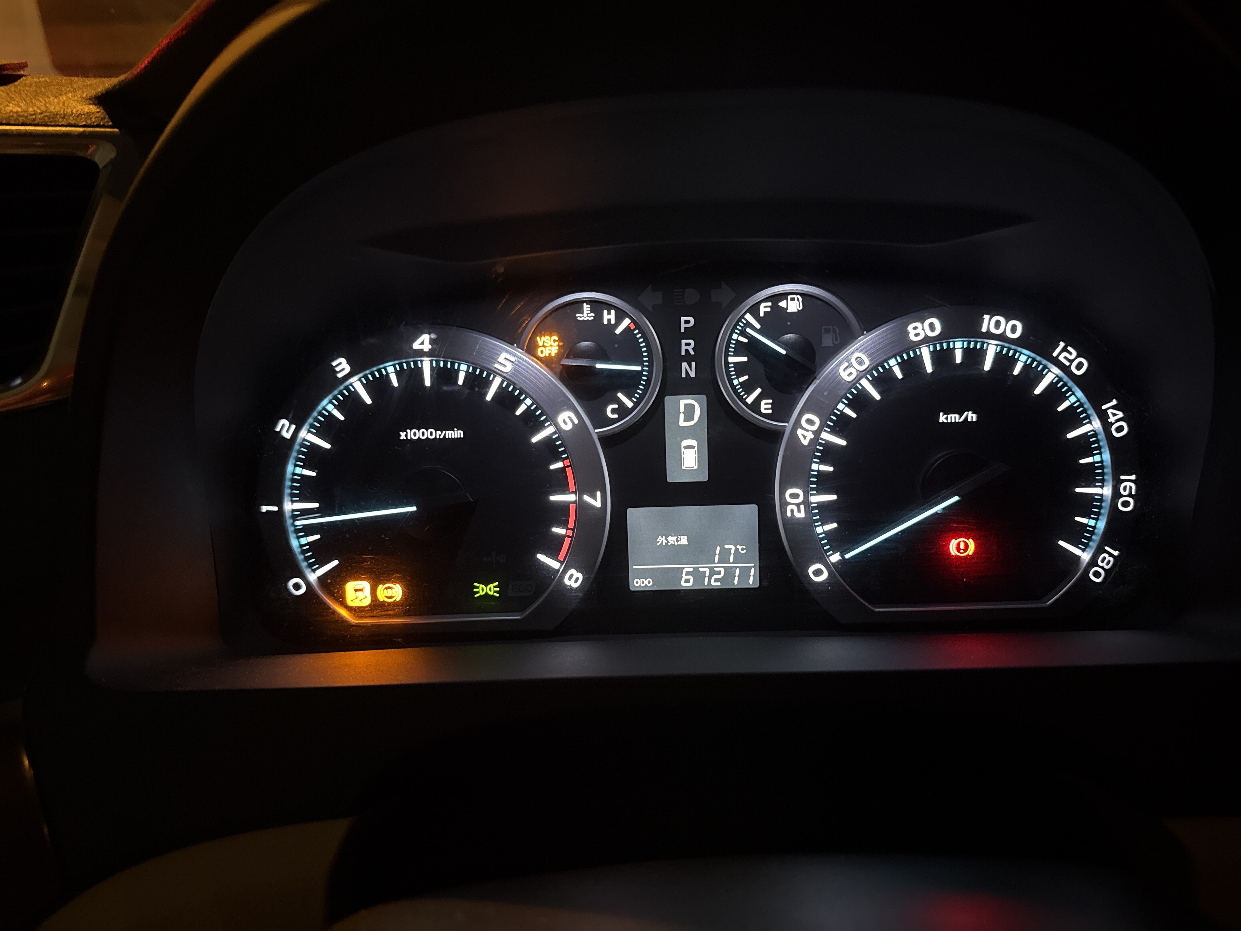

Today I replaced the new costco kirkland 24F battery and the fault codes changed from engine fault codes + 4wd fault codes + vsf off fault codes to the following fault codes (ABS, anti-roll and vsf off fault codes + handbrake fault codes (even though I had released the brake, the light stayed on so I considered it a fault code)). I also polished and cleaned the battery connector and it seems that the engine stalling problem no longer occurs.image.thumb.jpeg.7701f56e71d80b86206891737587cd7a.jpegimage.thumb.jpeg.f28d496a6cee56ed1dc6248ed85dd55a.jpeg

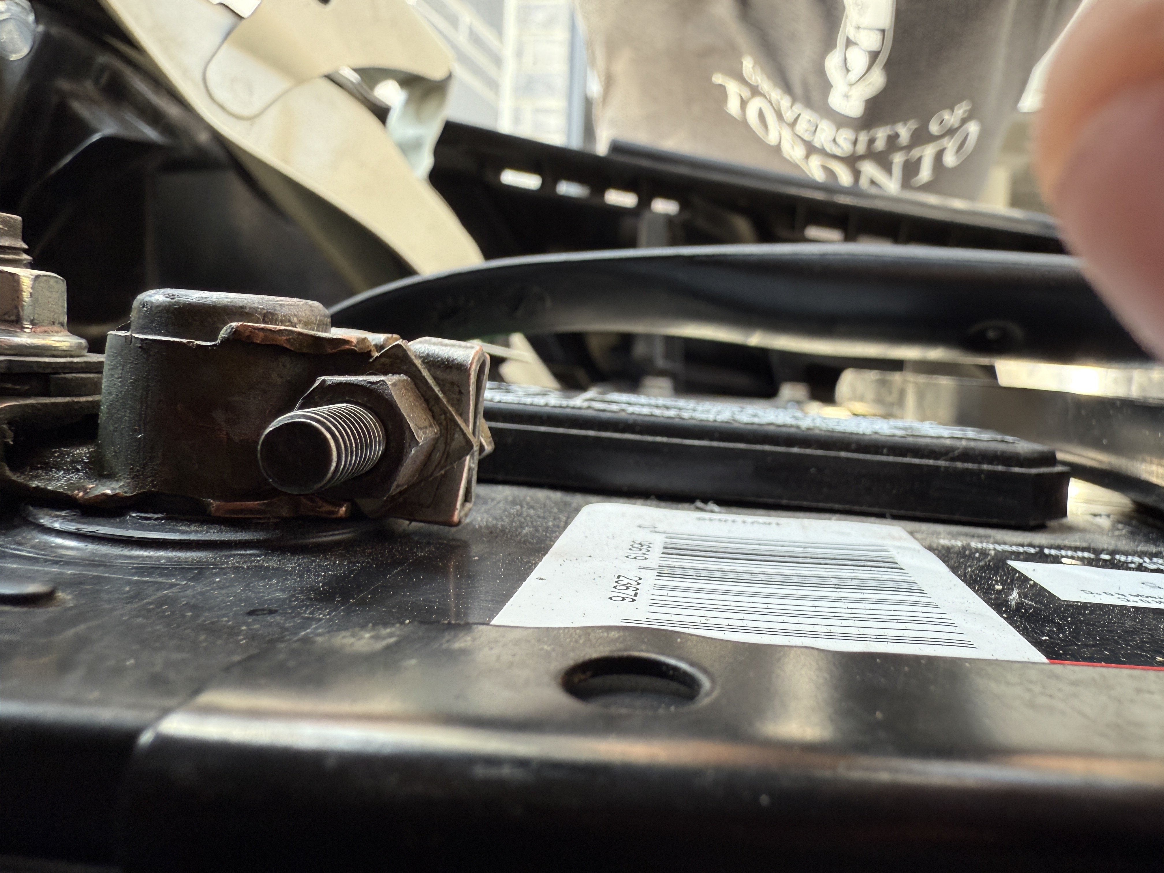

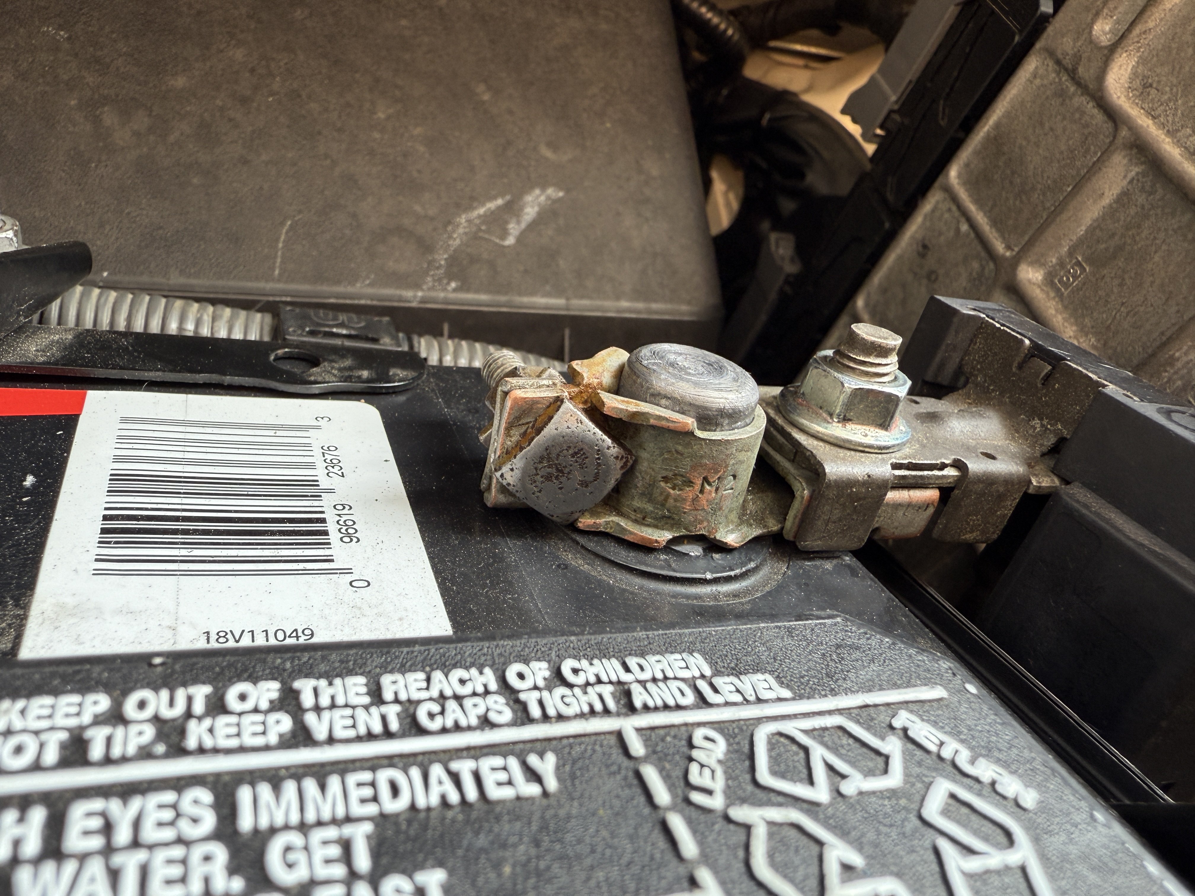

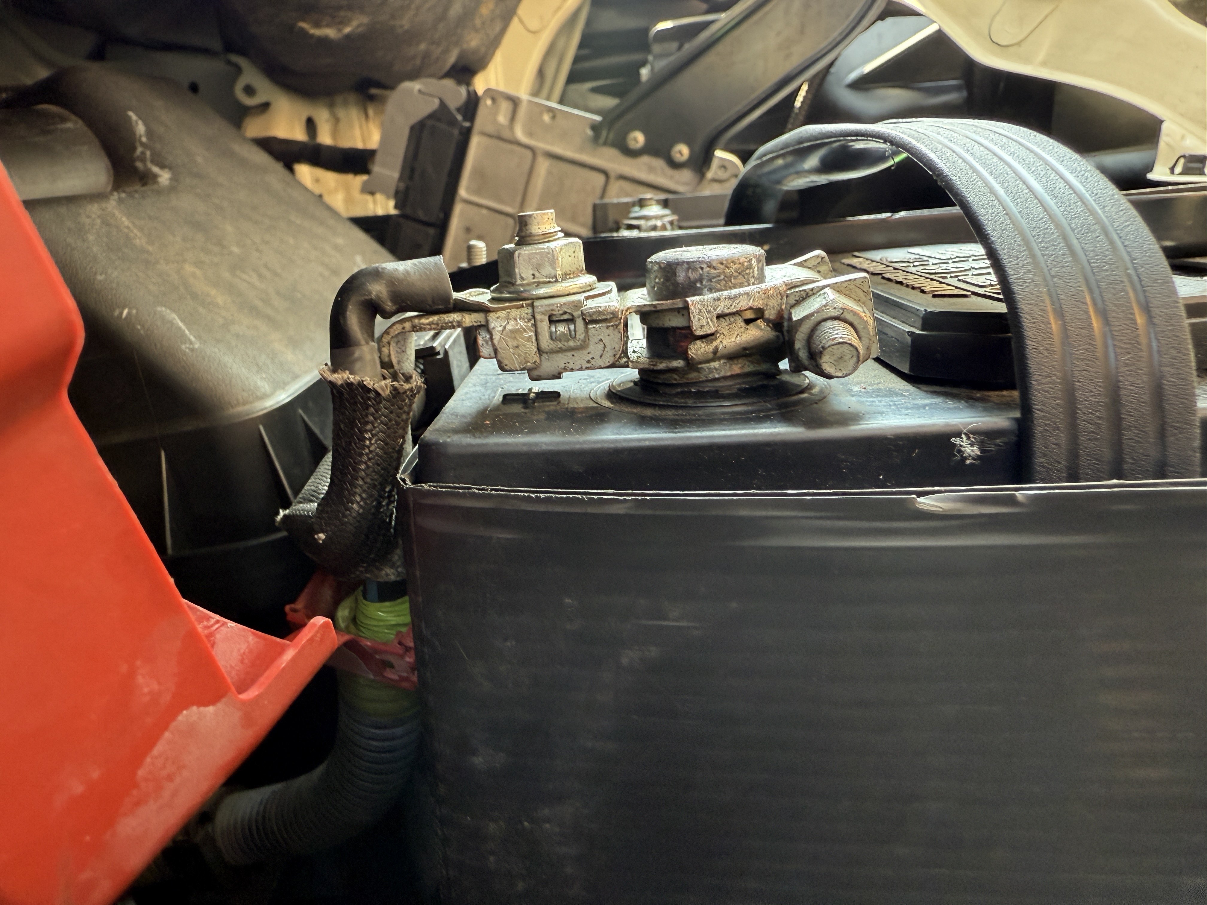

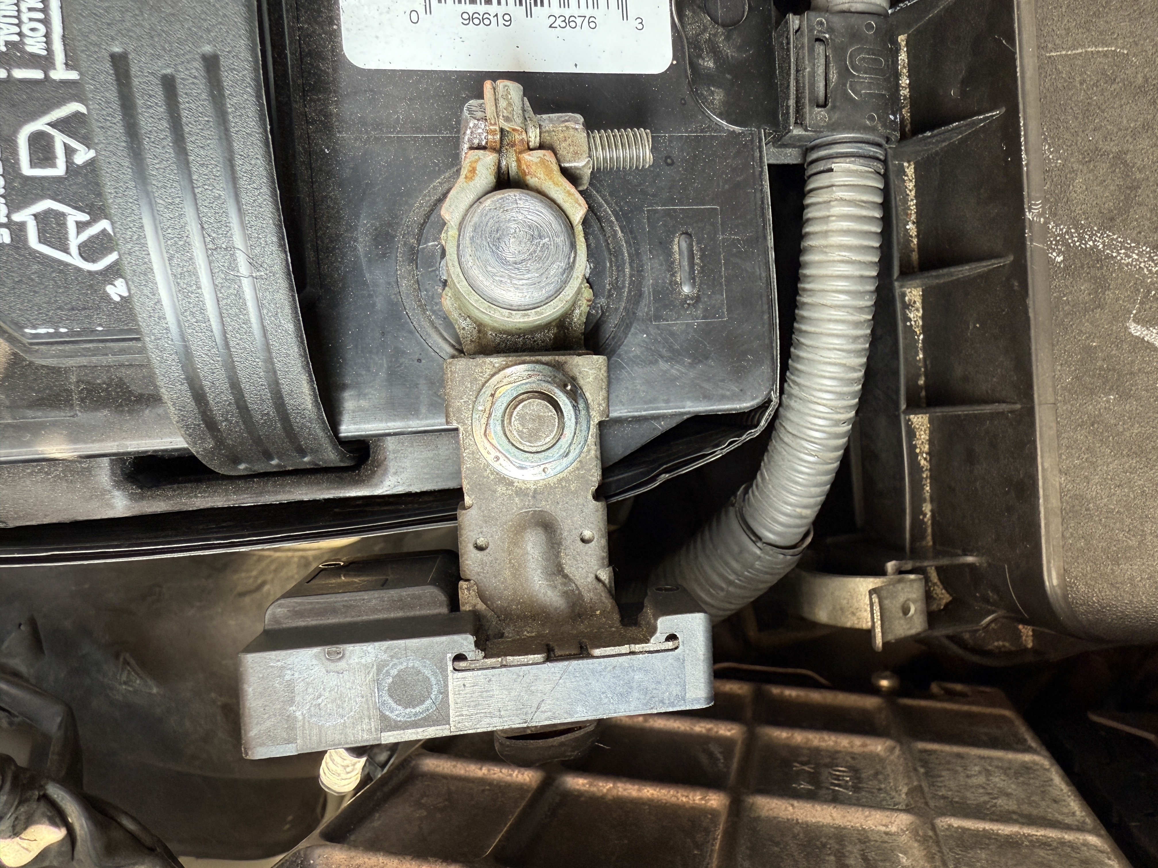

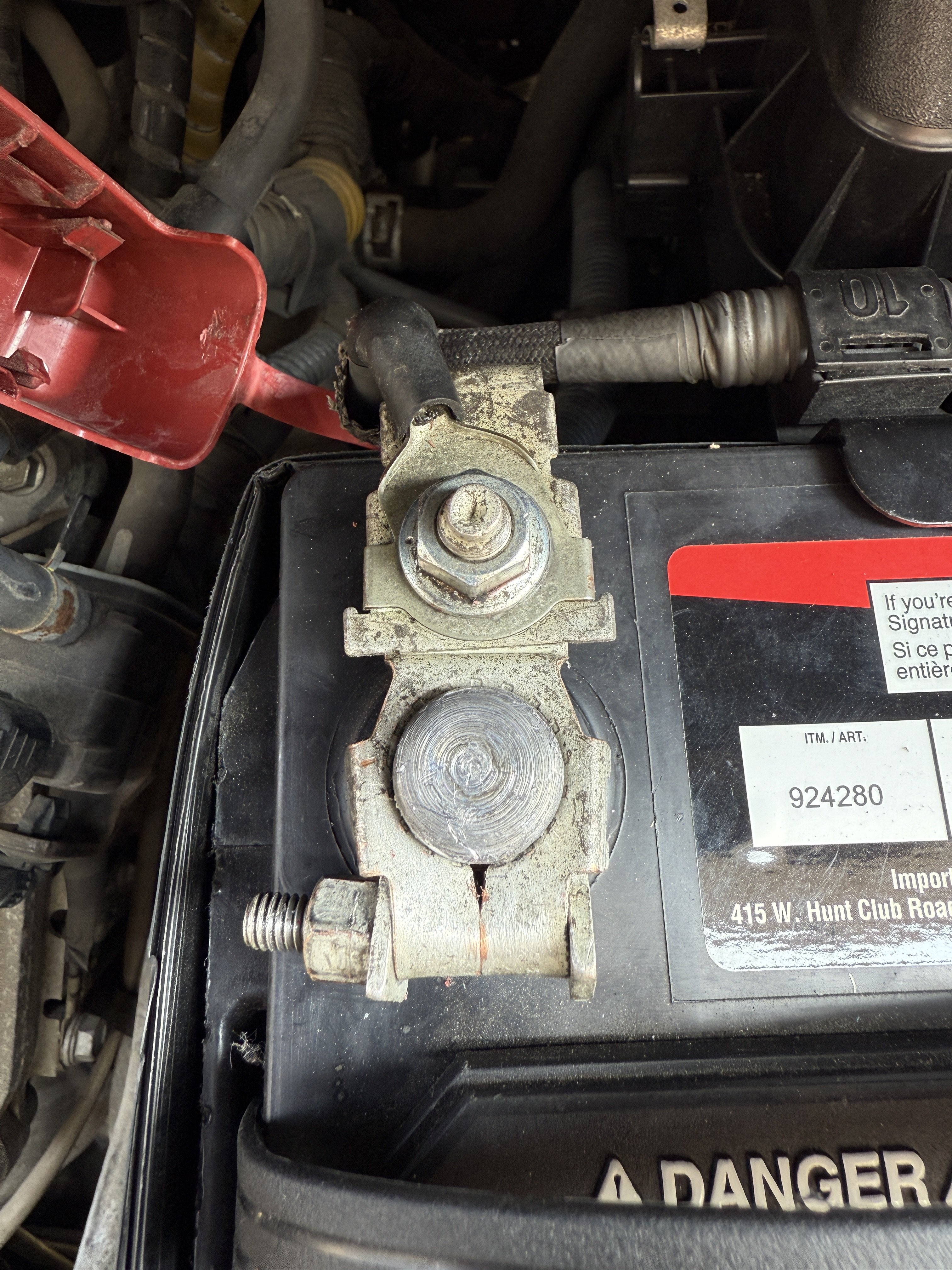

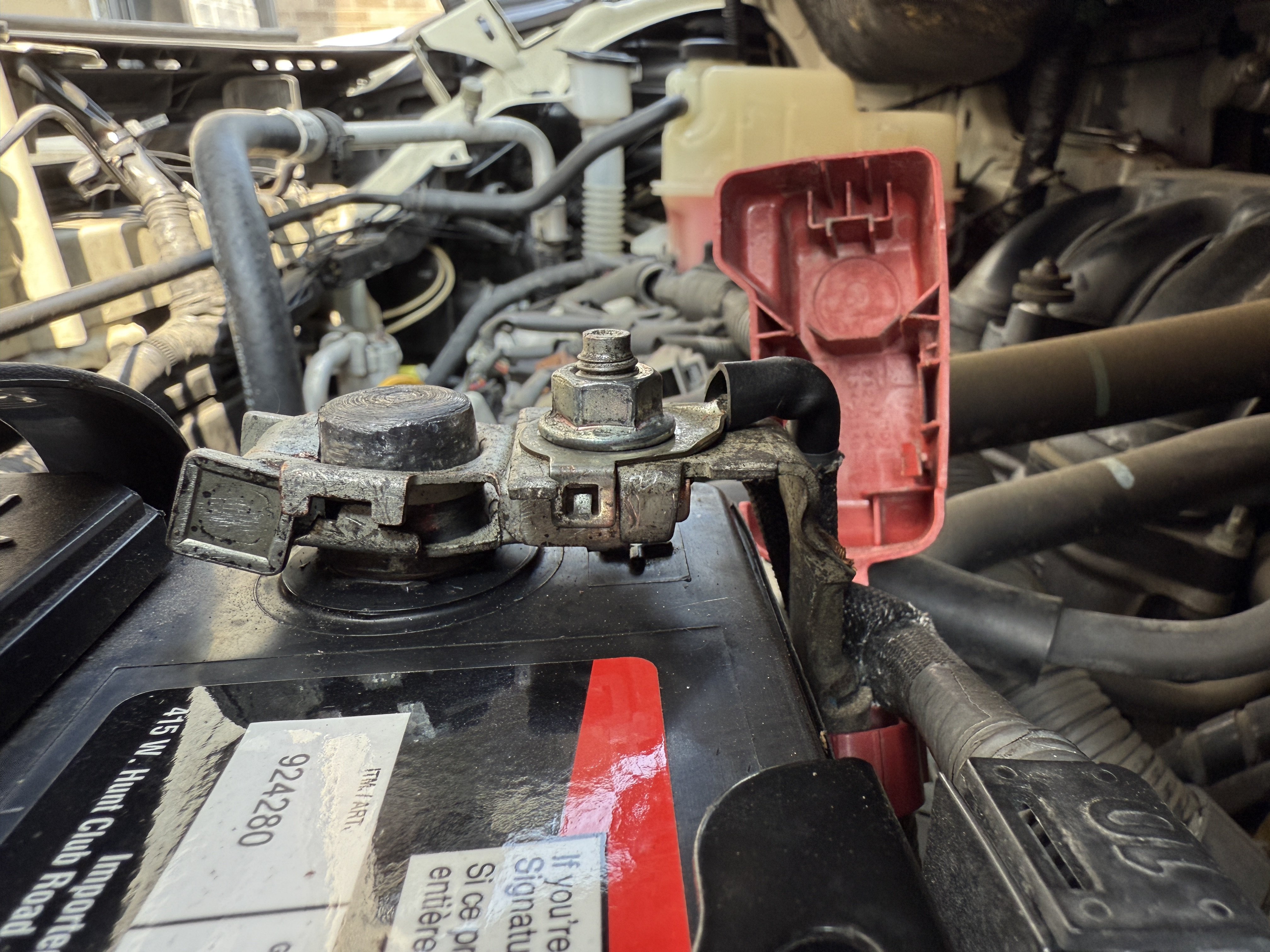

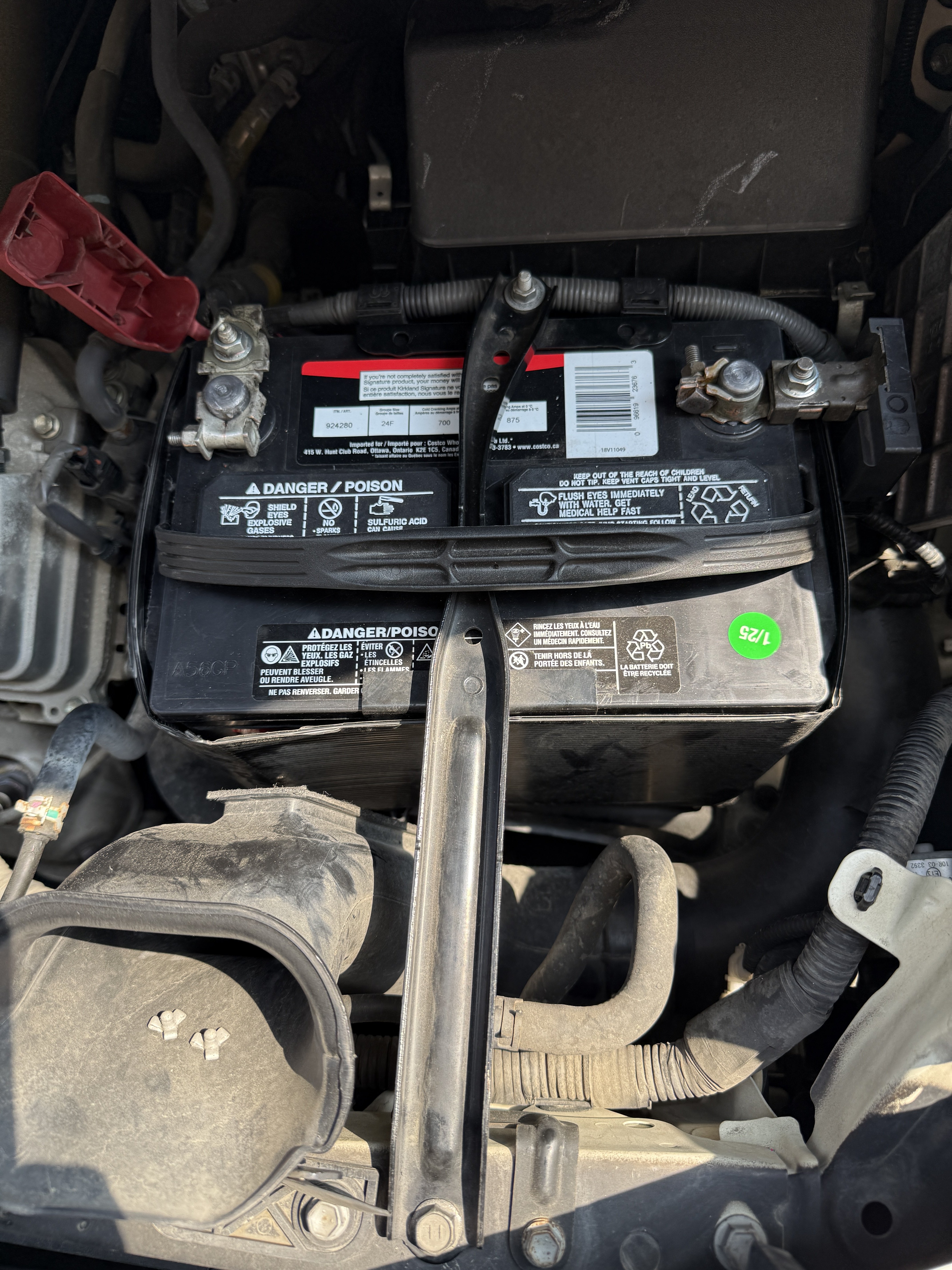

Hey Steve, Roger and Paul. Thanks for your guys' replies. I used sandpaper and WD-40 to clean the electric contacts connecting the car to the battery, but the problem seems to still exist. Here is the photo:
7d22f8dfe3a3cae87a354f0e0158daf0.thumb.jpg.f123ec8dc49523ca4b6853b42a144052.jpgd180664b899e3c448b3930c688fe2467.thumb.jpg.304f79a57da71865993a880d6773498f.jpgbfbd9f078f791cb08132e4f95d04df7b.thumb.jpg.f2b98ae578a50e538b034eb87f8c2717.jpg5381d6775f8282c5ea275d59d919eaf0.thumb.jpg.38eb67d6abaed209f88313b55cd54323.jpg3dae34524c677a30797b883d65289a81.thumb.jpg.94284c02969e81a58d6d3a66de79e5c2.jpg75d18054d63de1727553130fa1be4bc1.thumb.jpg.f7491b33cc13ea0e36c1c6ac2756c712.jpg314b7492e041765acb0bee7295226f67.thumb.jpg.c7f2d936921d50f7e7e7677ef29c9983.jpg

Even new batteries benefit from a full charging.
I would not be buying batteries from Costco, but you already have.
A smart charger is well worth the investment, especially in winter, especially where you live.
I have a Ctek (Scandanavian brand) which also can test the alternator.
So check the leads to the alternator also.
Yours is a much younger model than mine; but I did find the mood lights where very easy to leave on a low setting without even noticing. Check.
Parasitic current drain is difficult to find, so exploring other options is worthwhile.
There are battery isolator switches available but they are obviously only of temporary help.

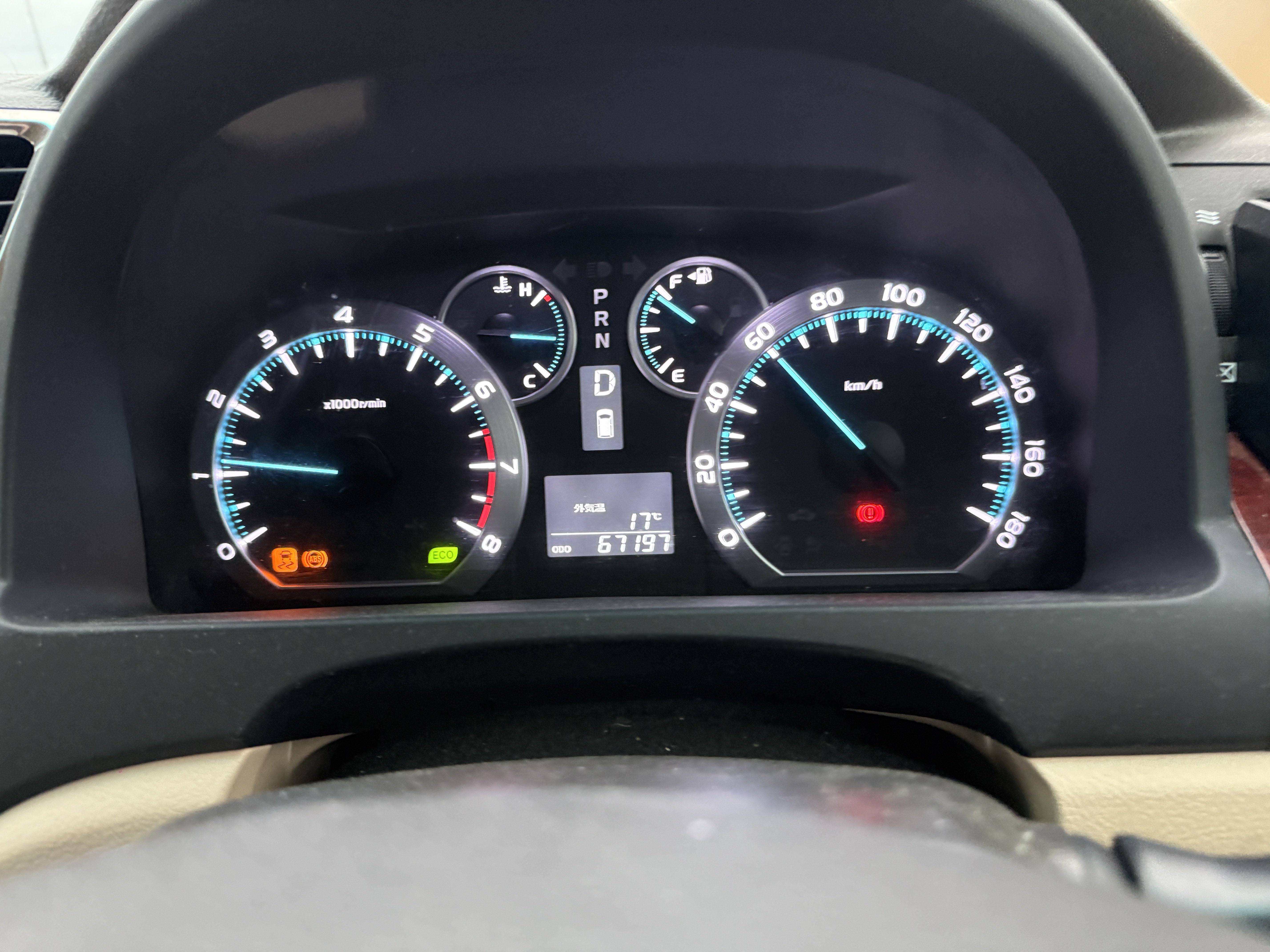

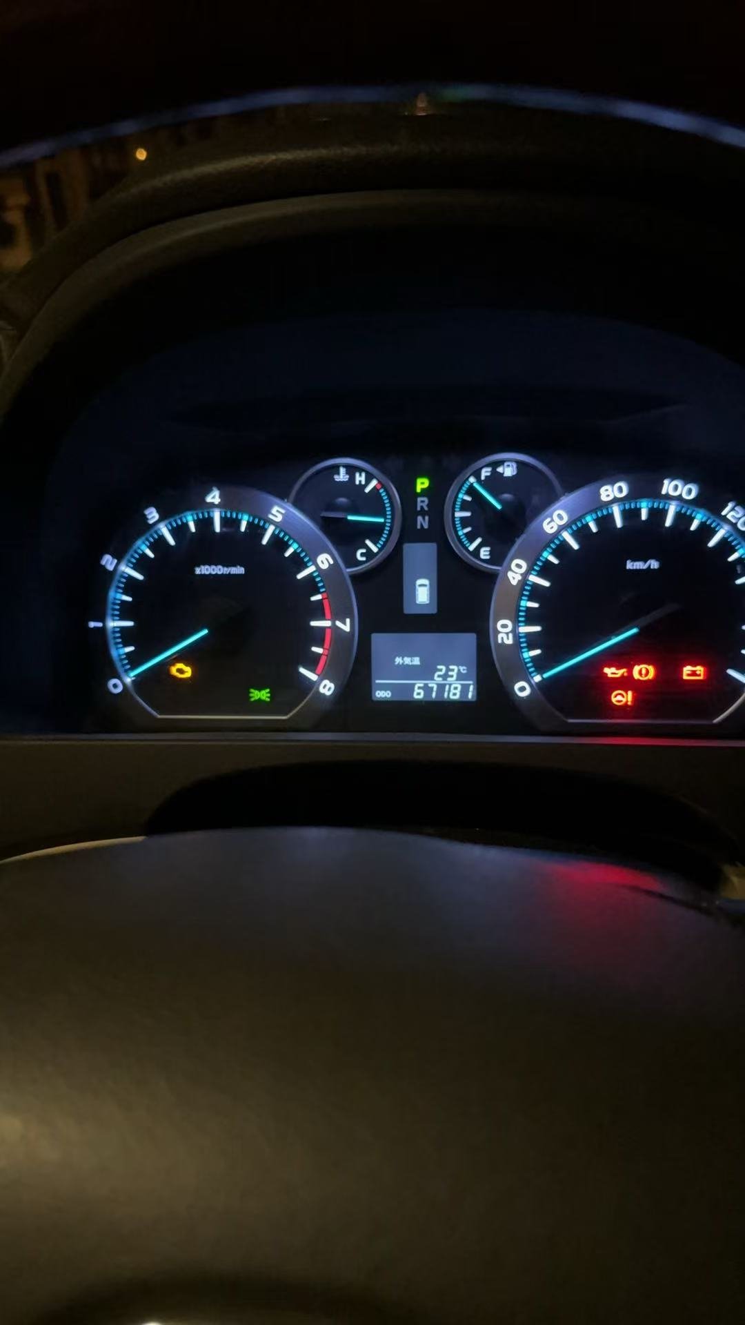

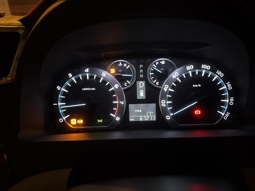

Hey everyone. Now, there is only one issue left. The car can run normally after starting, and there is no fault code. However, once it stops and is turned off, the engine will not be able to reignite immediately and it will take about 2 minutes to resume ignition. There is no longer engine off during driving and the status shows:
