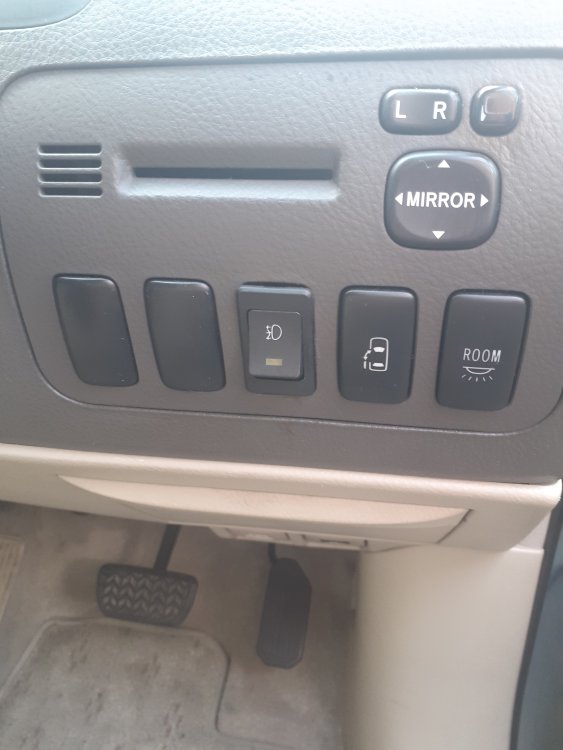

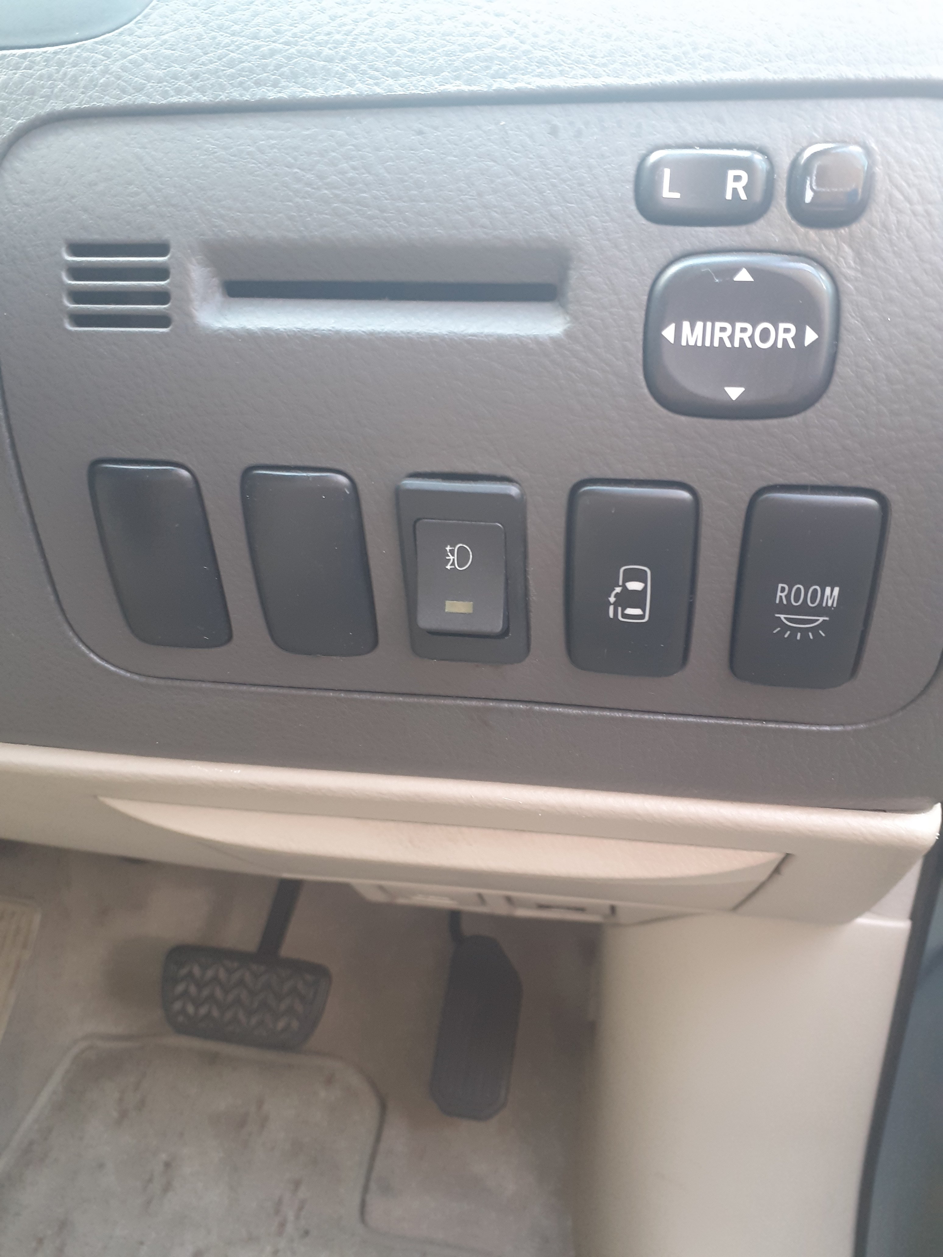

In amongst other jobs, I wanted to sort out why the fog light warning light on the dash is displayed permanently. The switch in picture 1 is for the aftermarket rear fog light and the in-switch warning light for that works fine. So, first question is am I missing the front fog light switch completely?

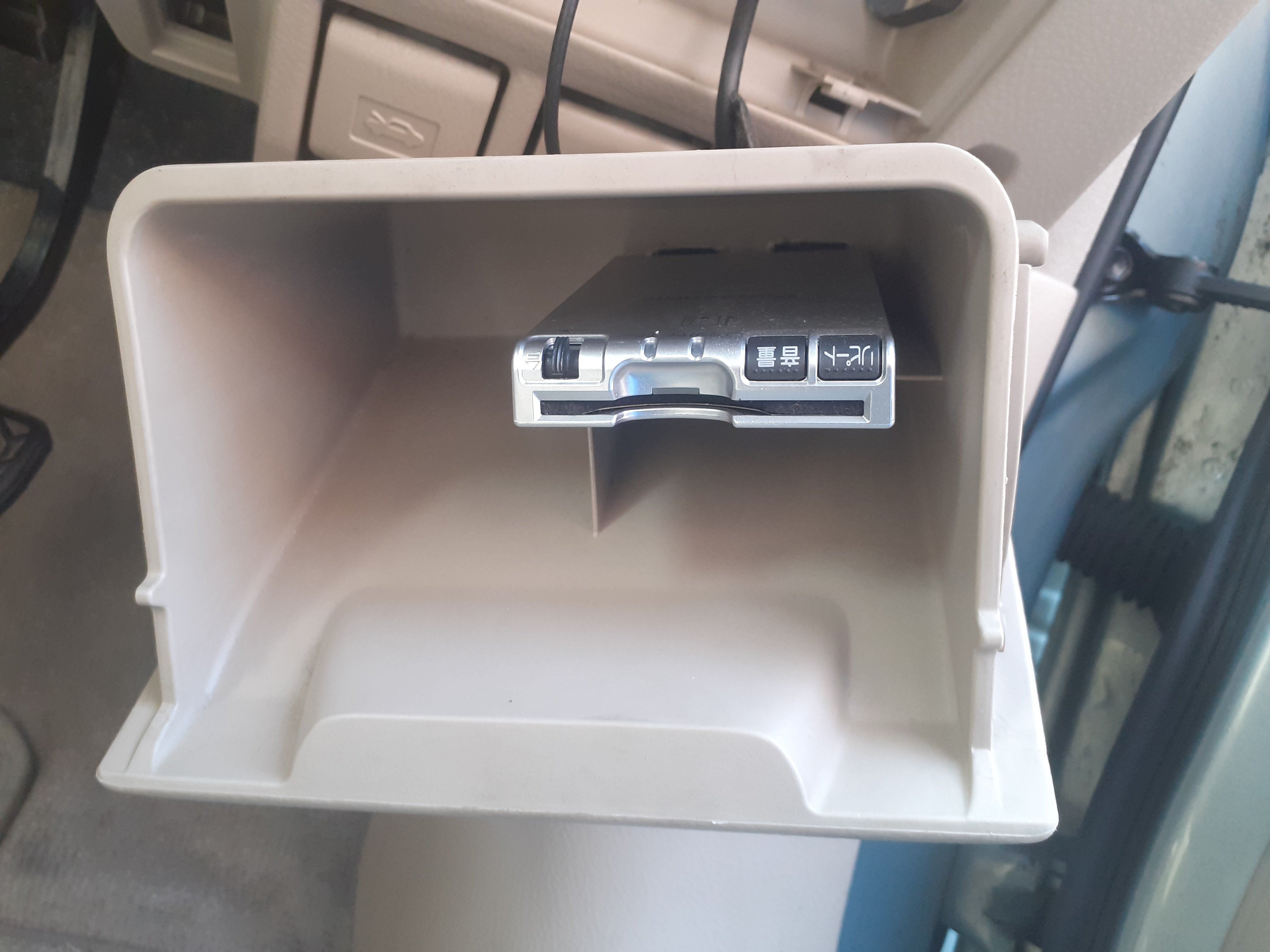

Second, in removing the drop-down coin tray thingy, below the steering column I found this extra device, in picture 2. It looks like it might be a mini-disc player, but I'm not sure. Has anyone else come across anything similar?

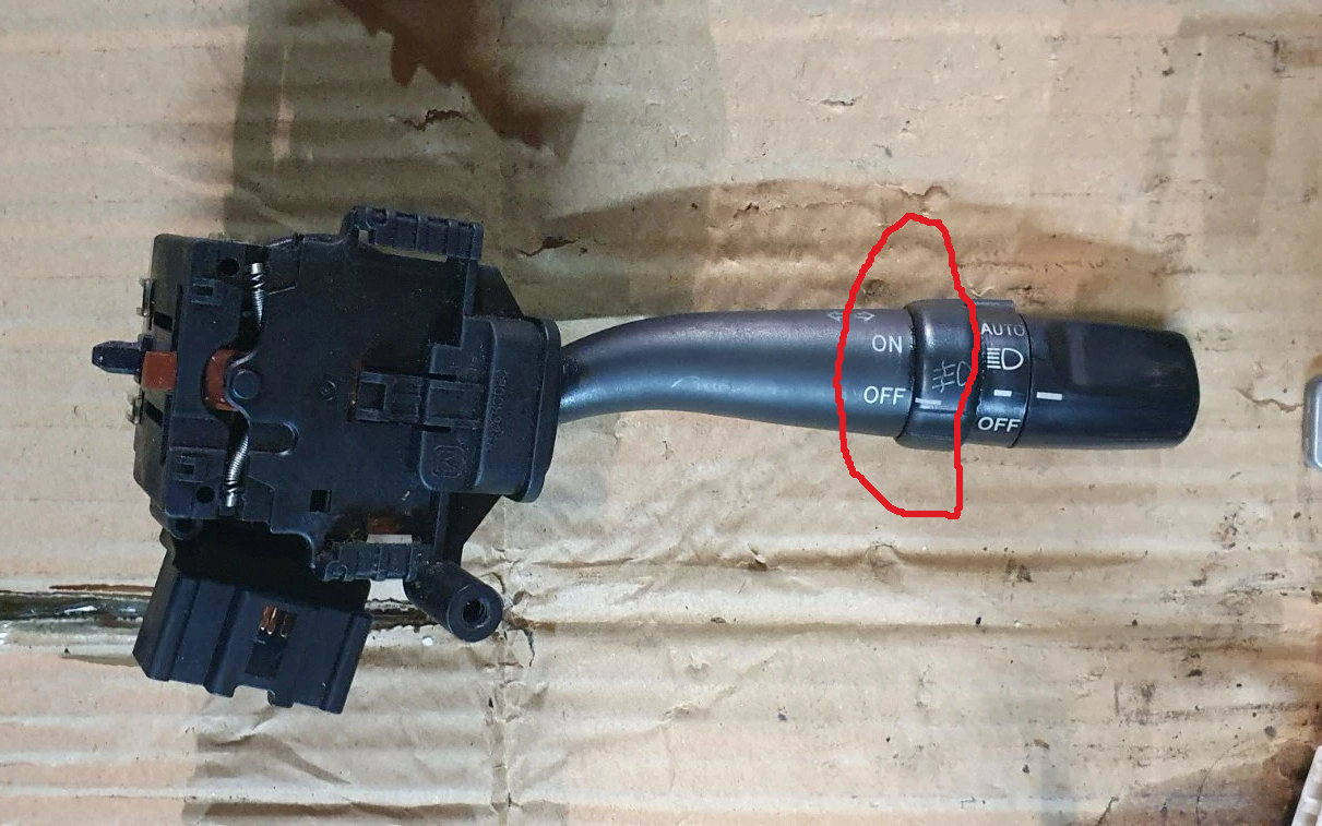

I believe the 'mini-disk player' is actually for a toll card that they use in Japan a lot. As for the front fog lights there should be a fog light symbol on the light control stalk that controls them - when selected there should be a fog light symbol on the dashboard.
I can confirm what Gamith has said, the toll card reader can be unplugged and removed, the power to it can be used for usb points if required, front fogs (and warning light)  are controlled by the rotary switch on the lighting stalk

Thanks to both you and Gamith for the replies. As the front fogs are using built in wiring, I'm wondering why the amber warning light for the front fogs is permanently on, no matter what position the switch is in. The fog lights themselves are working correctly.

By the look of it, that retro fitted switch is not quite the right one for a series 10, see link for correct one plus it shows what wire does what https://www.ebay.co.uk/itm/165029893993
Yet again, thanks for your pointer. For that money (and my peace of mind!) I will replace the current switch with this one. Then just got to pull the display out so I can see what wires have been messed with.
Having purchased the switch recommended by Dezufo, i was assuming (quite wrongly) that the change from old to new would be straightforward. The current switch has four wires. Two red - one feed in; the other out to the single after market fog lamp - and two black. One black I assume is to earth the in switch warning light, but what would the other black be for? The new switch also has four wires, black for earth, red as feed in, green to lamp and a yellow marked as positive. What is the pupose of the yellow wire and what should it connect to? I thought I understood car electrics, but this has me really stumped!
