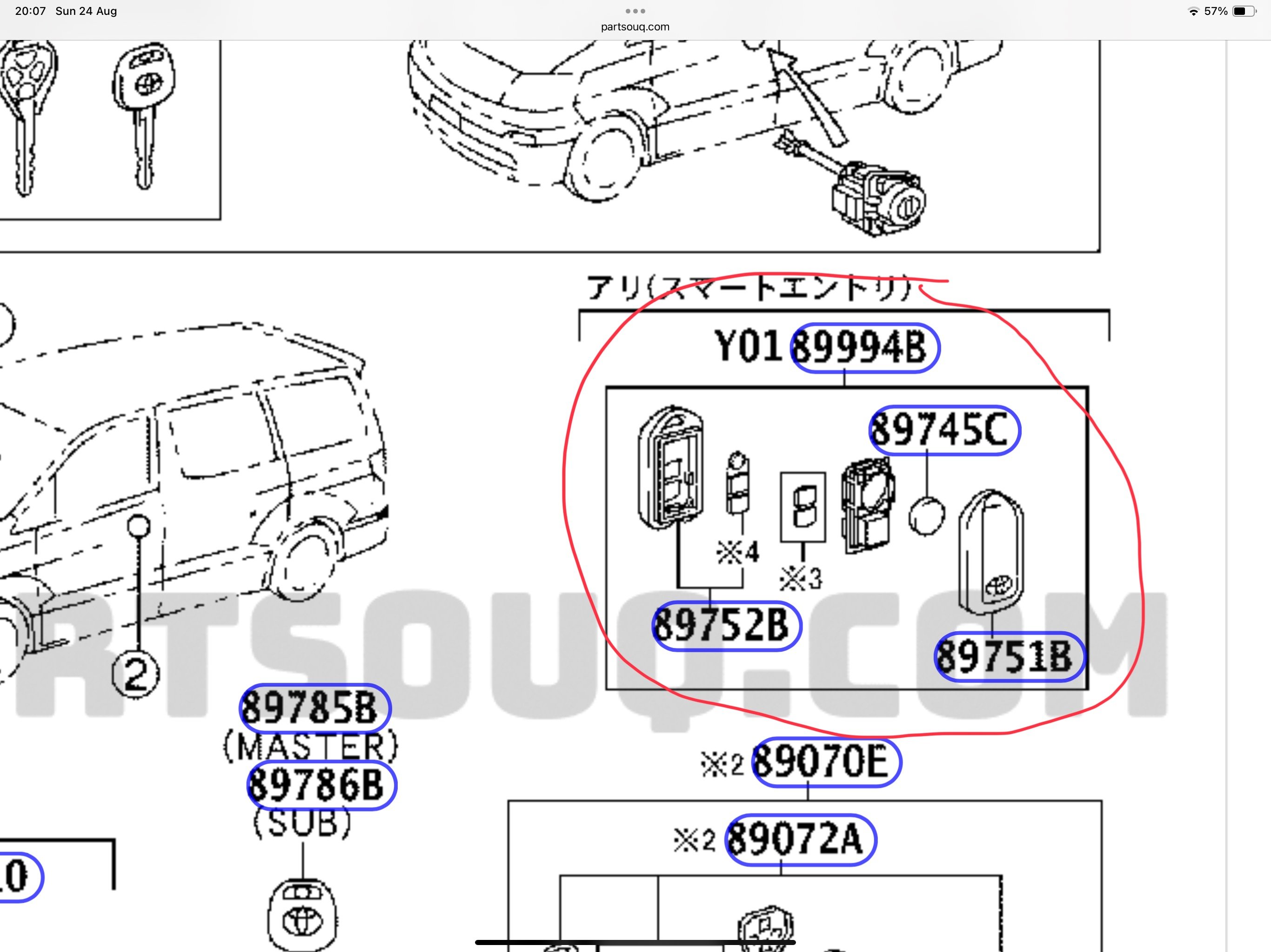

Hi many thanks for the info can can I ask can I buy a fob from alliexpress like this one in the picture or is this completely wrong
I cannot comment on whether this will work.
It looks nothing like the OEM unit, which has the Toyota trade mark moulded in.
I doubt any, other than a genuine Toyota unit will work straight from the box.
Maybe the Toyota one will need specialist programming, I don't know.
Many thanks for letting me know it looks like I might have to bite the bullet
and buy the proper one and hopefully it works and I haven’t got another problem with the keyless control unit which I’ve seen on eBay going for about £150 and then get it all reprogrammed
Hi Guys have just bought it on eBay will let you know how it goes and many thanks for all your help
