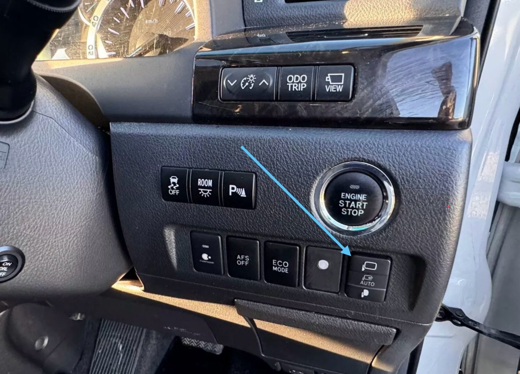

But anyway - your question - below the START button is a rectangular switch with AUTO on it and 2 pictures of the mirrors, top one out, bottom one in. On mine in the middle position it will fold / unfold on locking / unlocking. If you press it in at the top, they will stay out, at least they do on mine!

Thank you very much to everyone for taking the time to respond. There is no button on my car that I can find that stops the mirrors folding in - I bought the car from an importer who has quite a few of these vehicles in stock and they did identify this button on other models in different dashboard locations, including one exactly where Neville said it would be, but on my car there is no such button or at least I can't find it and neither can the importer.

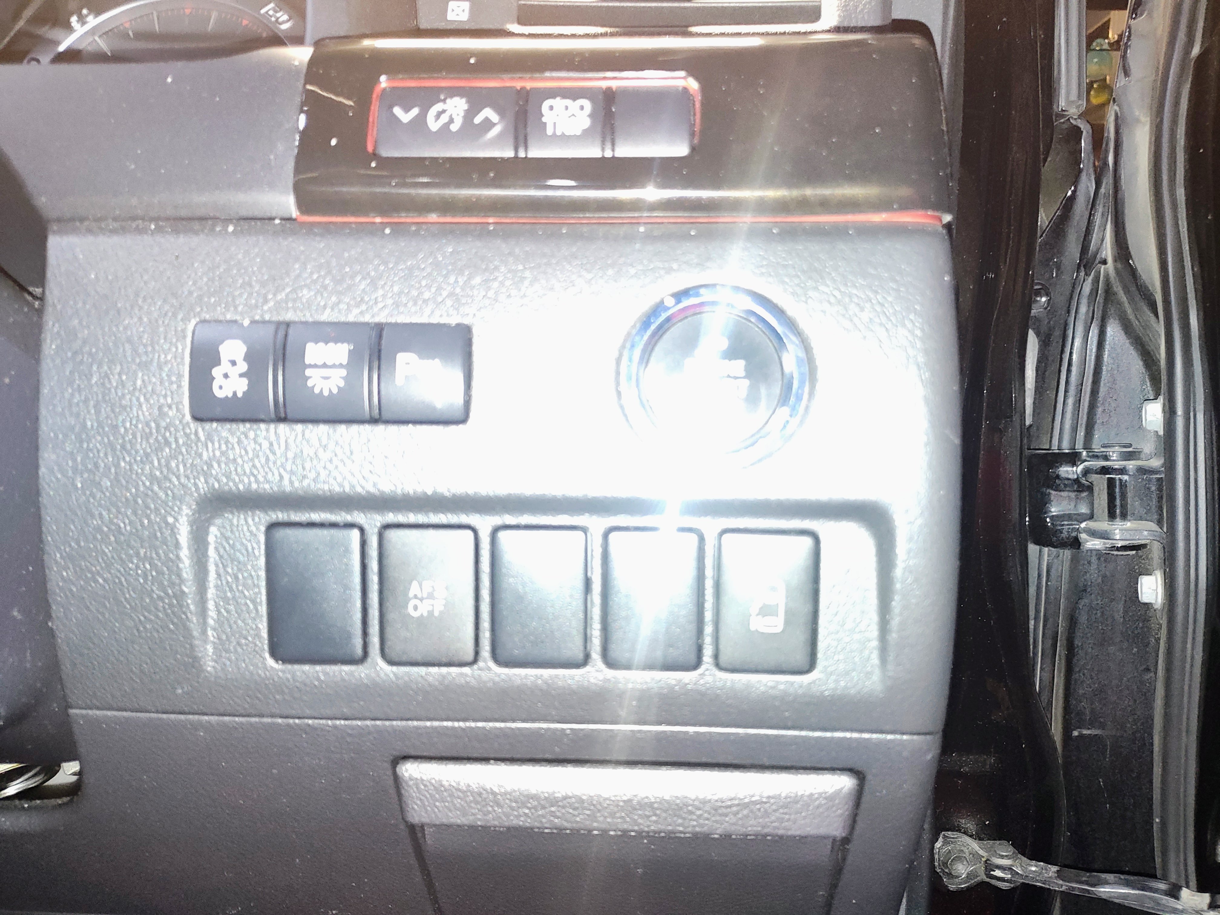

What switch is fitted in the position where the folding mirror switch should be?
Please post photo of the switches either side of the steering wheel.
It's possible, a previous owner in Japan moved the physical switch behind the dash panel in order to free up the slot for something else.
The fact your mirrors appear to have motors means there should be the wiring and therefore the switch in place.

Hello again
As requested, the pictures are attached below, the toggle switch below the start button is the rear fog light installed by the importer.

Ah, chuffing heck.
My mistake, should have asked for a picture first, as one paints a thousand words!

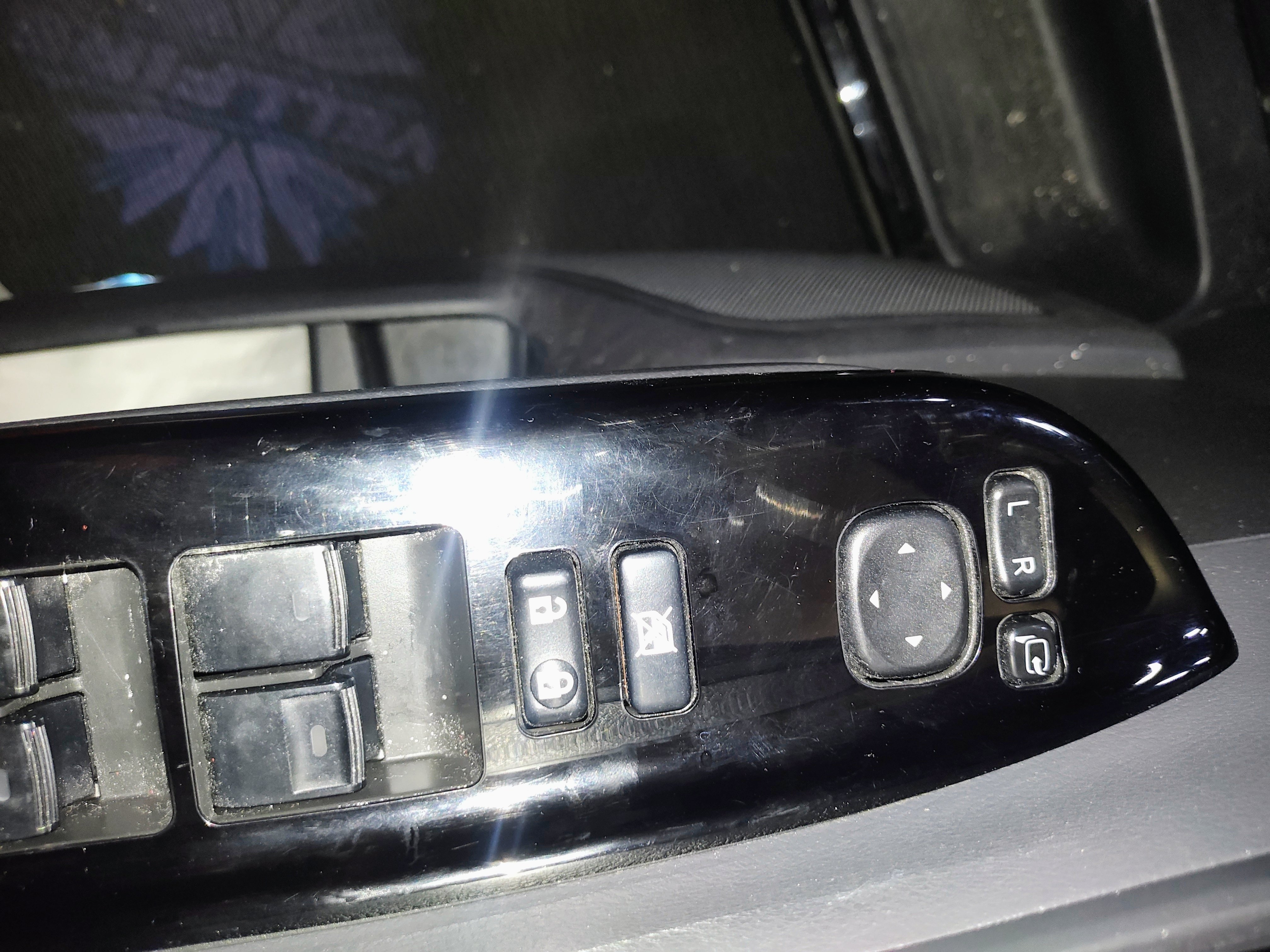

Exact same setup as Malcolm with no mirror switches under the start engine button and just a folding mirror button on the drivers armrest.
But I have the opposite problem, the only way to fold the mirrors is to press the button.
I would love to know how to get the mirrors to automatically fold when i lock the doors.
Also neither of my mirrors angle down when in reverse, doesn't matter if switch is set to left, right or centre.

Here's some pics of my buttons

I believe the folding when locking is an aftermarket module they may have installed (previous owner).
You can buy these modules on AliExpress.
The auto tilt mirrors are not installed on every model, you appear to have a base level vehicle.
The auto tilt requires the mirror that has the additional motor wiring and hall effect sensors, often combined with the electrically adjustable drivers seat and seat memory ecu.
If your driver's seat is manually adjustable rather than using buttons, you will not have auto tilt mirrors or auto folding.

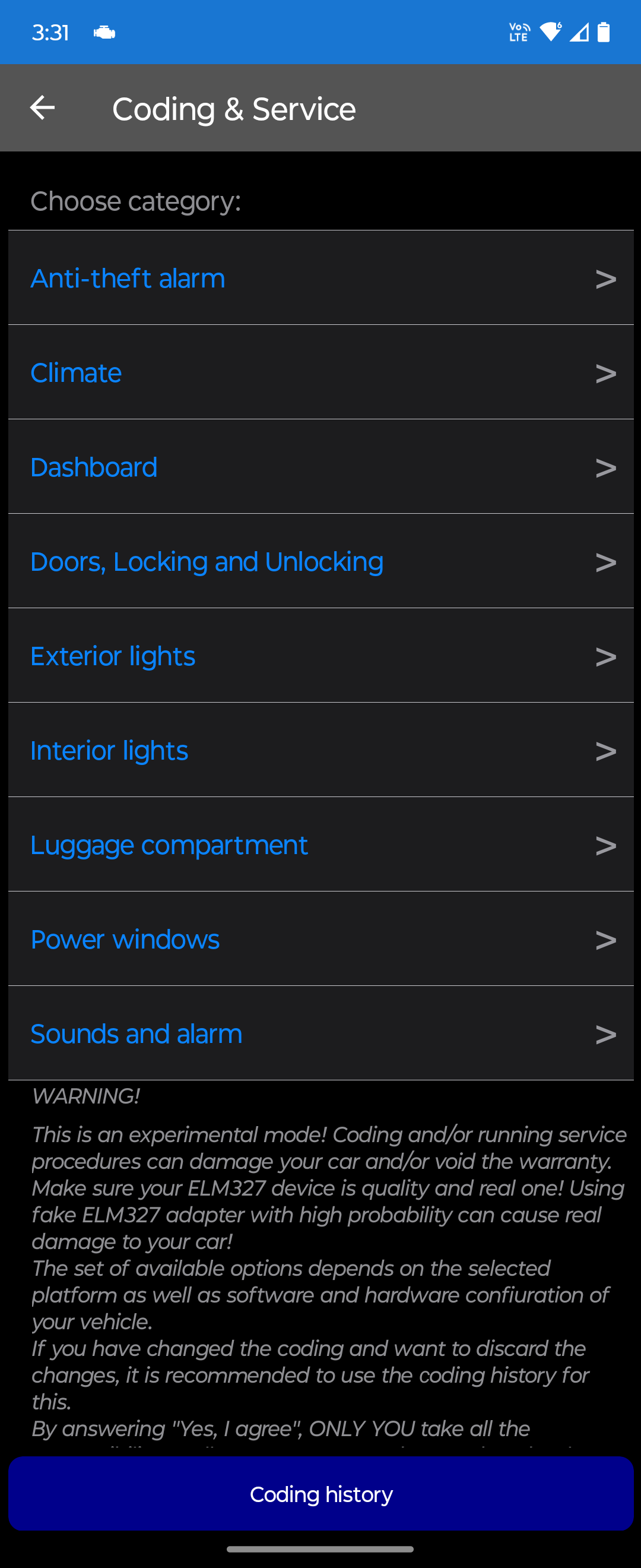

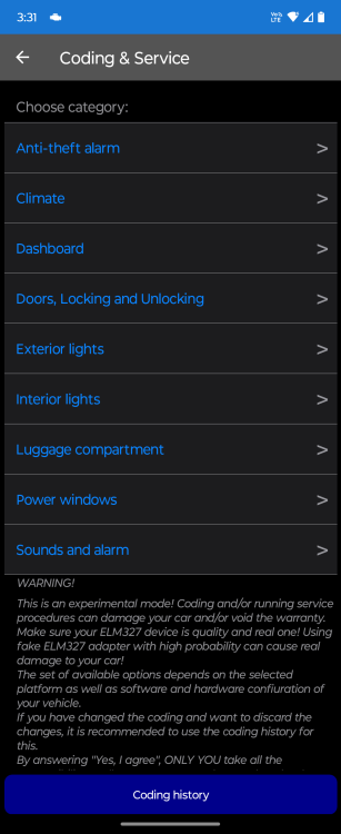

Just received today, there is an option to allow windows to open and close by the key fob which I tested and works perfectly.

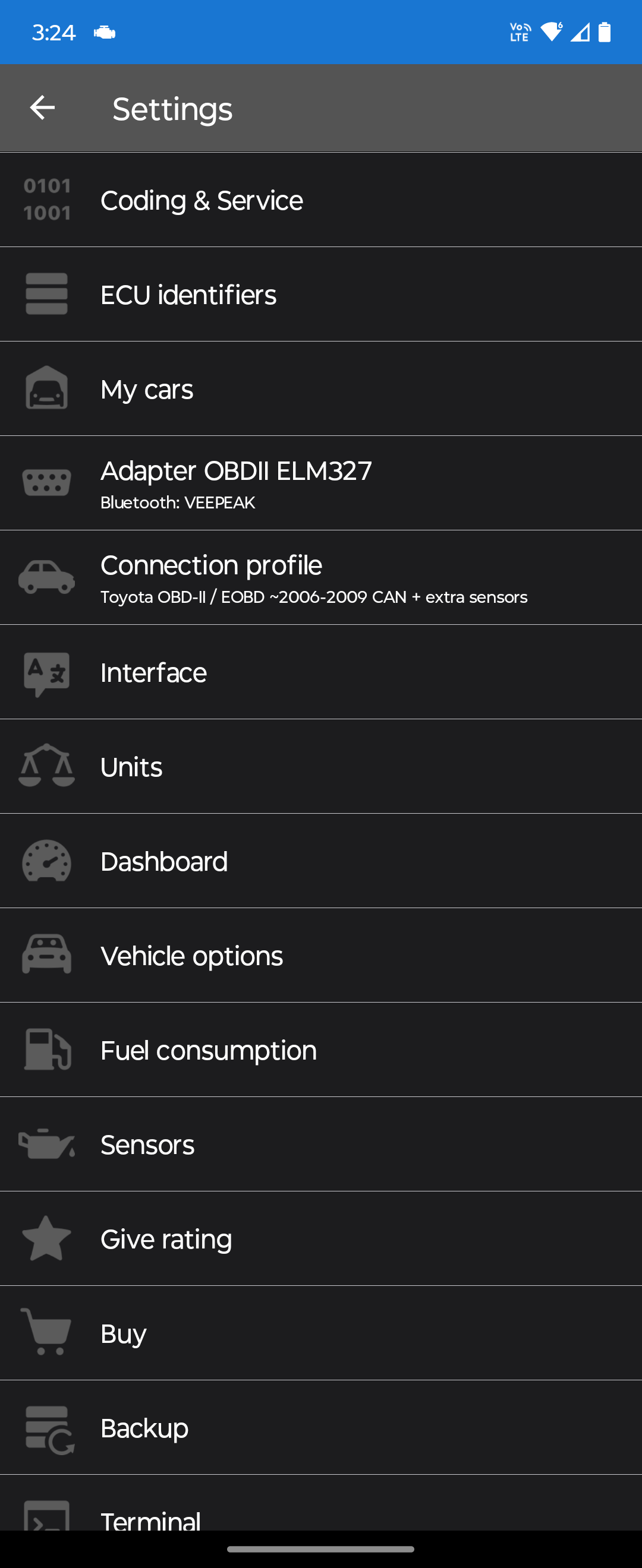

But still no option to auto fold mirrors or to stop the car from unlocking doors when put into park, the JPNZ manual does list this as an option though but maybe I'm using the wrong connection profile (I'll post a pic below this post).

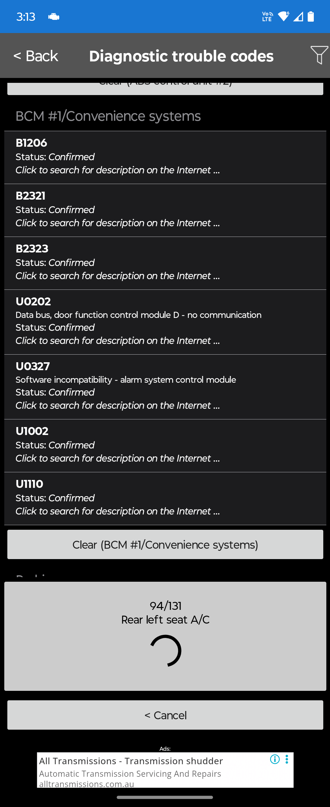

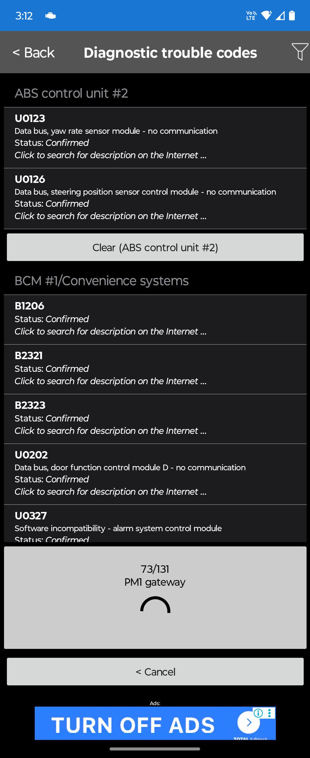

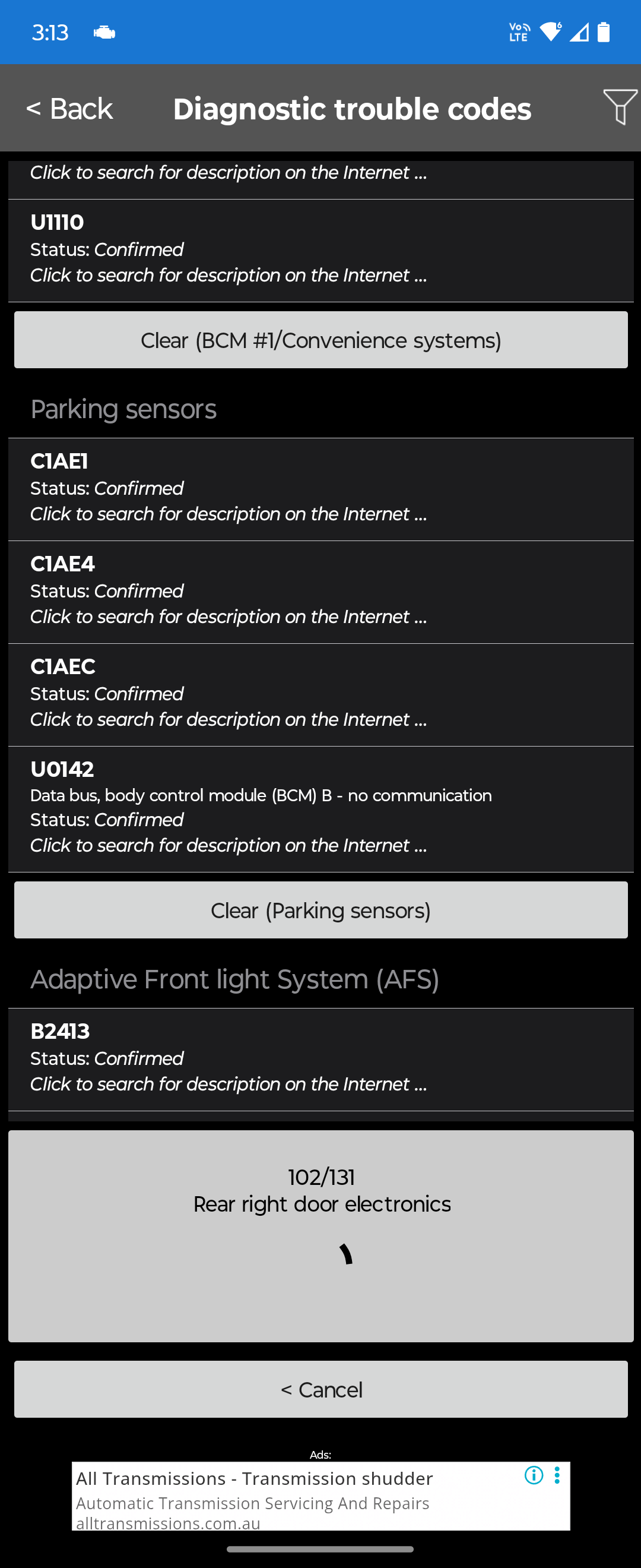

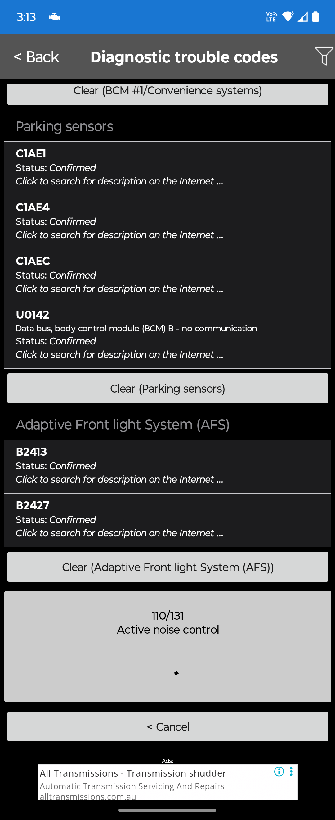

Ran the fault code test to find out the source of the beeping caused by the AliExpress module and got heaps of codes (pics below).

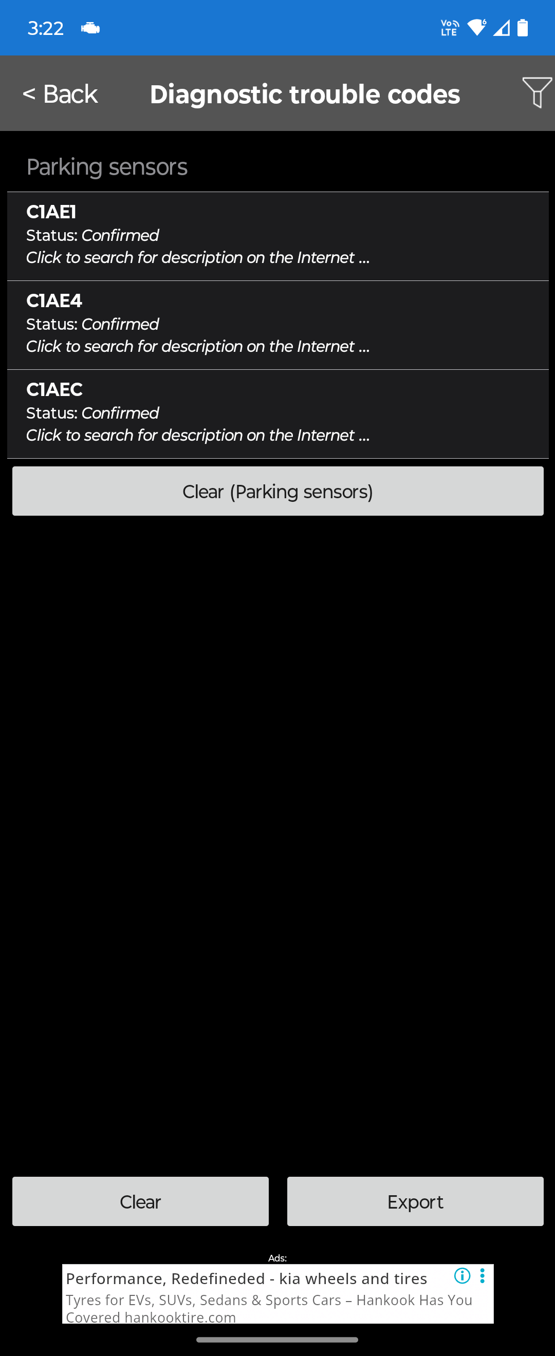

Cleared the codes and reran the test, this time only 3 codes came up relating to the parking sensors, beeping still continues on start up. I'm still yet to take her for a drive yet to see if any other fault codes come back.
