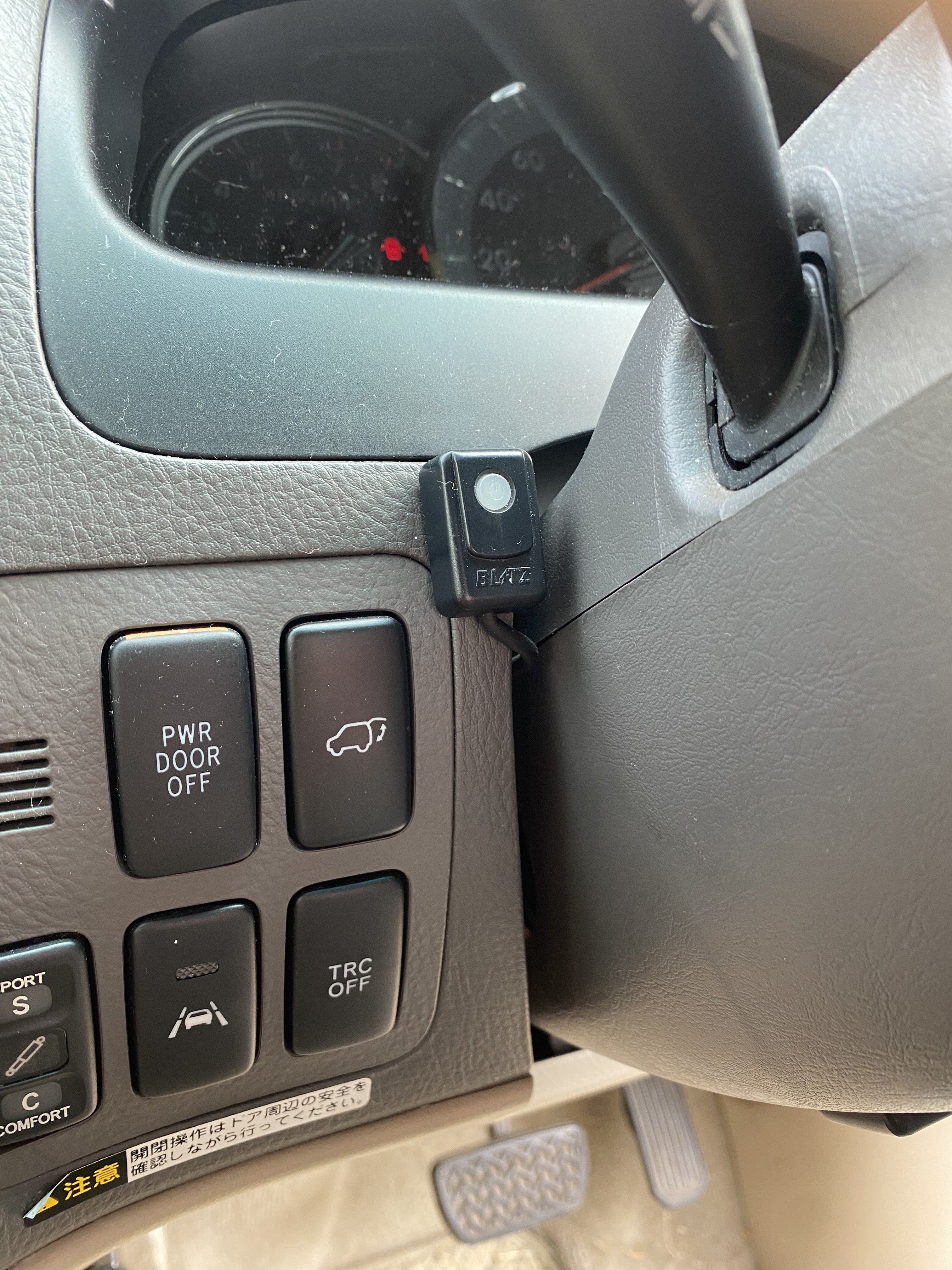

Hi folks, I’ve had this Alphard a while now, 2006 3ltr import, but just noticed this button on the dash, any ideas anyone? I don’t have a clue, thanks!

Hello Michael,
No, could be anything.
Many Japanese owners add all sorts of gizmos (which are normally removed before export).
Do you have driving lights fitted at the front ?
I hope it isn't your rear fog light warning switch, as I doubt it complies with the MOT requirements.
Does the word on the button ('Blatz'?) return anything on an internet search?
I thought I would take a look - this might be helpful it's from a company called Blitz.
Quote from That's the control button for a Blitz throttle controller. It basically works like the eco/pwr buttons in a gen 3. If it is hooked up and working, you can probably press it a few times to cycle through the behaviors of the throttle pedal. https://www.reddit.com/r/prius/comments/dmana8/what_is_this_bl_tz_button_on_the_left_side_of_the/ (https://www.blitz.co.jp/products/throcon/smathro.html) and looks to be a throttle controller.
Looks like you need to be driving for you to see what it does (if anything - the rest may have been removed on export / import) but I would guess it swaps between Sports / Eco / Normal throttle response curves.
good find.. Blitz do quite a few bits for Toyota
