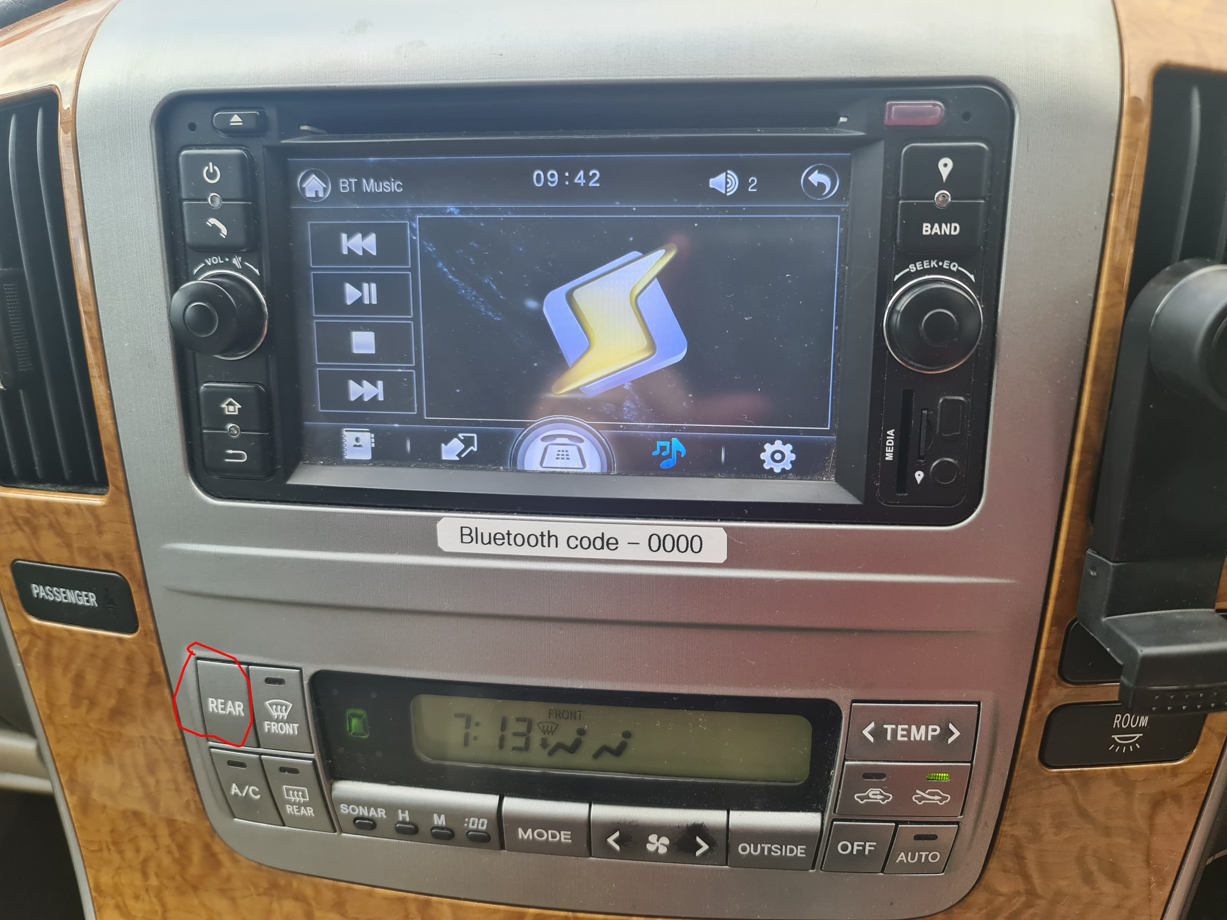

Just a thought - the rear has it's own air con system. You can set it by pressing the 'Rear' button on the dashboard heat controls - circled on my 10 series.
i know it's basic but I thought I would check.
Press the button and then set temp and fan speed etc. for the rear.
