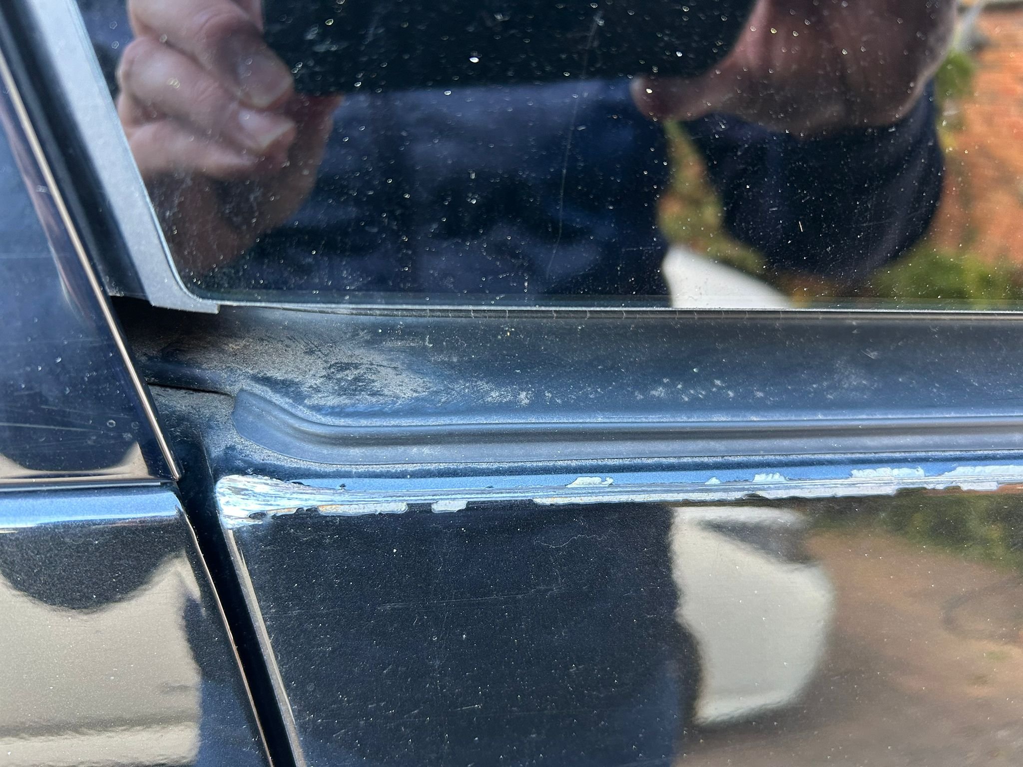

Has anyone had an issue with this? My passenger side door bracket is rubbing against the bodywork and has rubbed off some paint and scratched a gouge in the metal. Any ideas how to get this sorted?

Not seen this on mine, but it could suggest that it's loose on its runner?

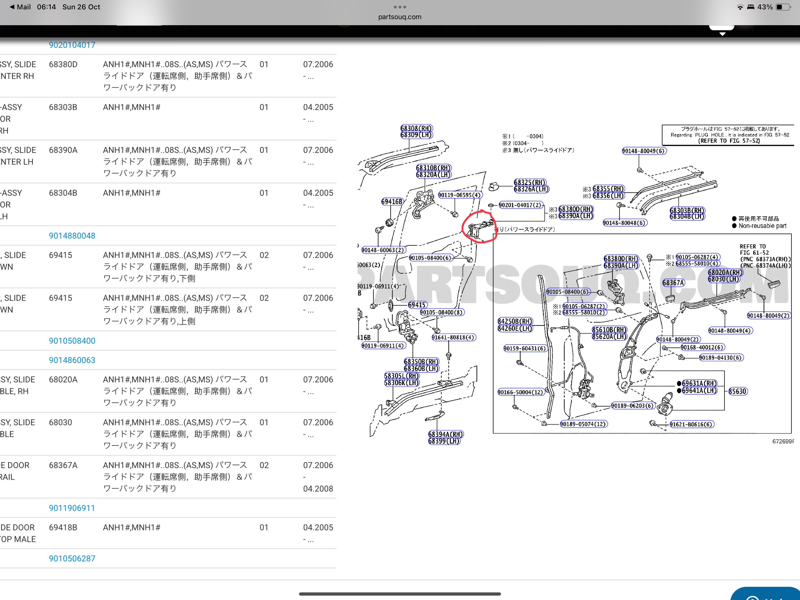

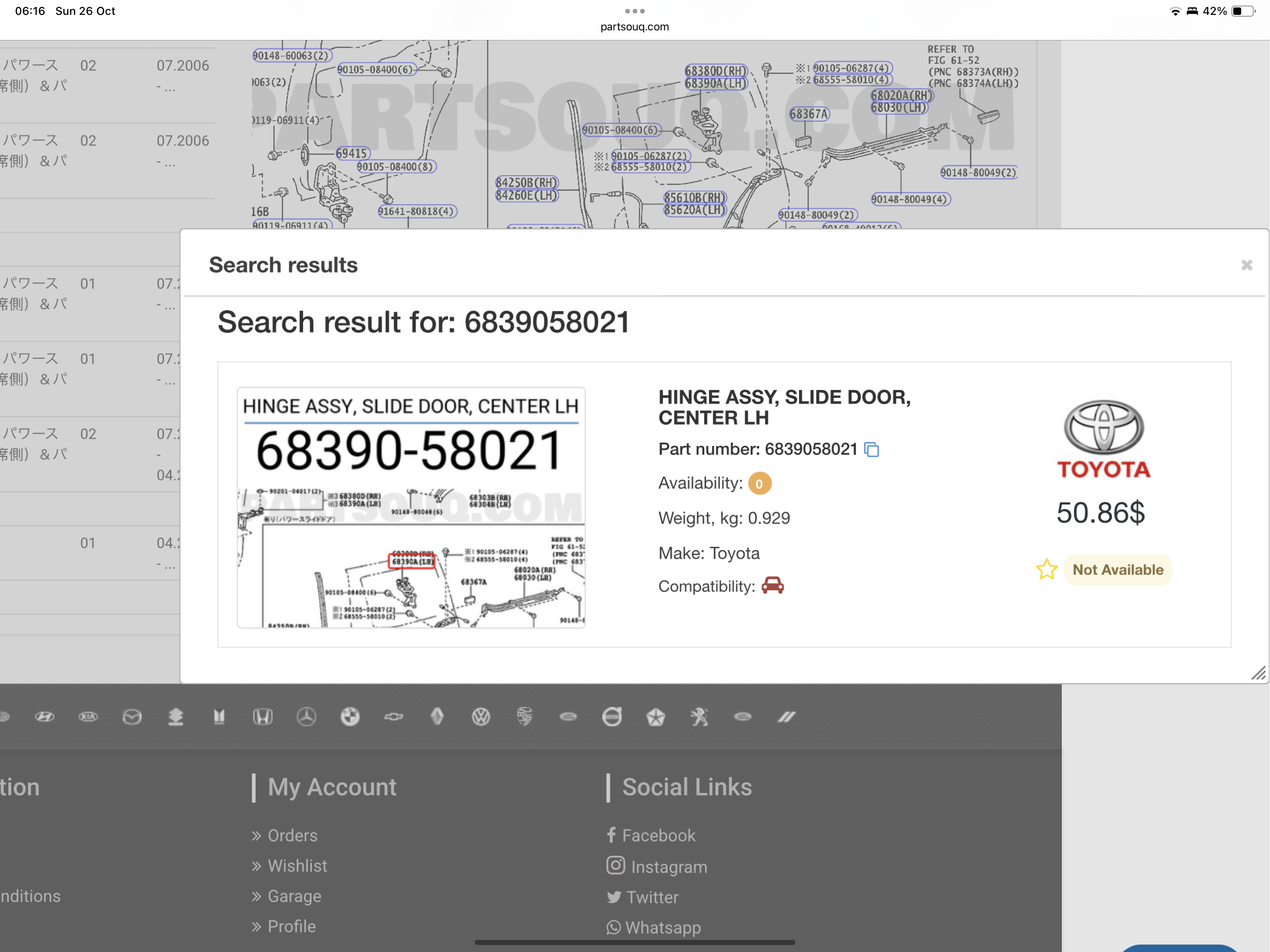

I had similar the bolts were loose and the bearing wheels were off. I got a replacement bracket from Japan and is all good.
Would you happen to know the part number Alex? In case Tim needs them?
Thanks guys, super helpful!
