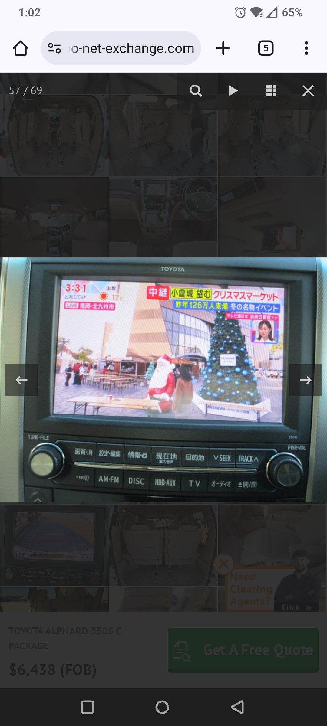

can you see if tweeters are fitted on the sliding doors? They are located near on the front trim of the windows.
In any case, your headunit model suggests an external amplifier.
You can buy an adapter that converts an analogue output signal from an aftermarket headunit into a digital signal the amplifier understands., and therefore retain the amplifier and existing speaker wiring.
I can share the block diagrams and wiring schematic for the ipa and headunit

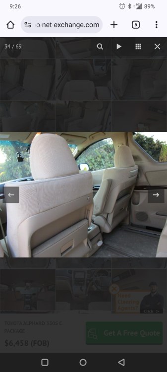

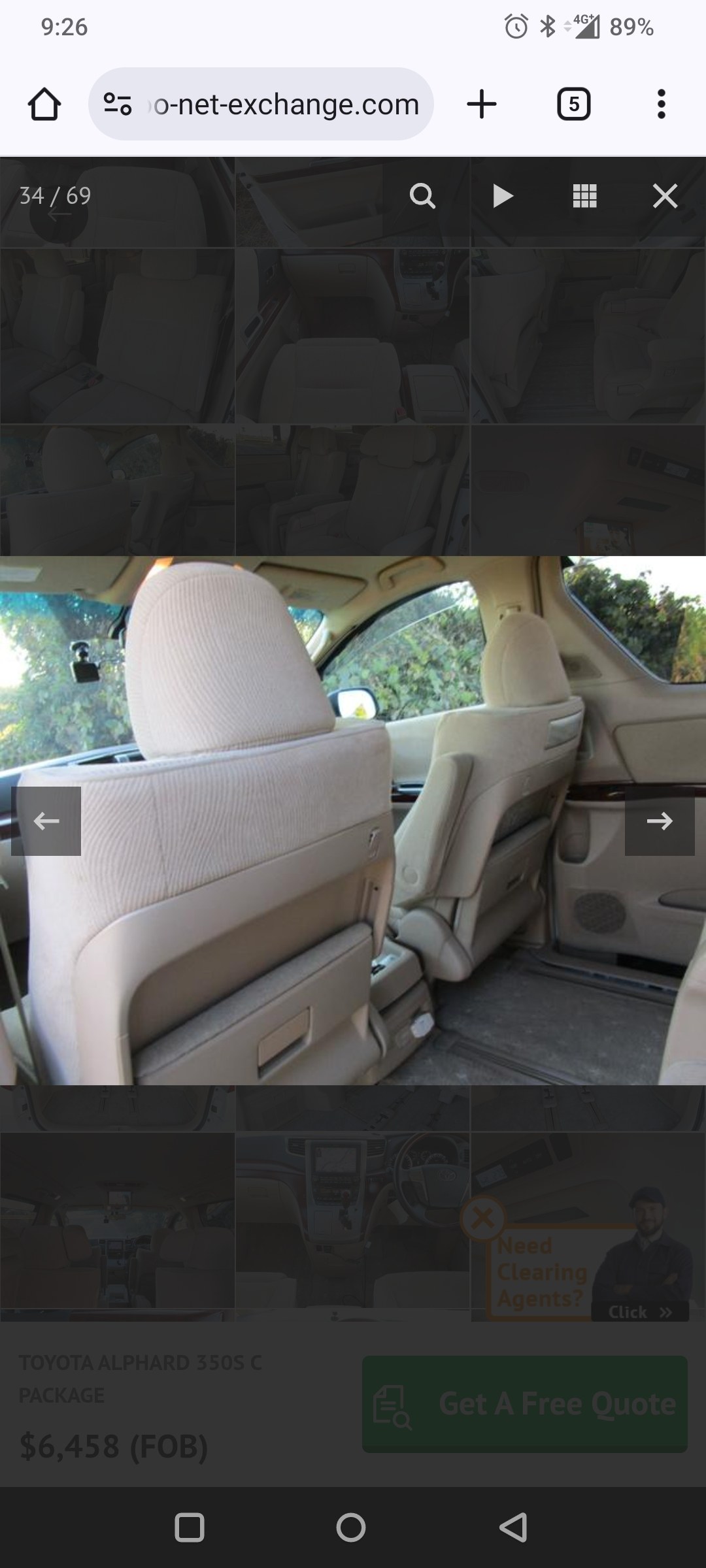

Pretty sure there's only 4 speakers in the roof. No sunroof on this vehicle. Vehicle is currently in Yokohama Japan. There looks to be tweeters in the sliding door. So this is the super live system I assume.
Hard to see as I only have pictures from the selling website.
Yes. Some of the non sunroof utilise a different design speaker in the roof.
This must be an 18 speaker system.
The amplifier is a 16 channel 640watt (16x40 watt) system, and a separate active powered subwoofer.

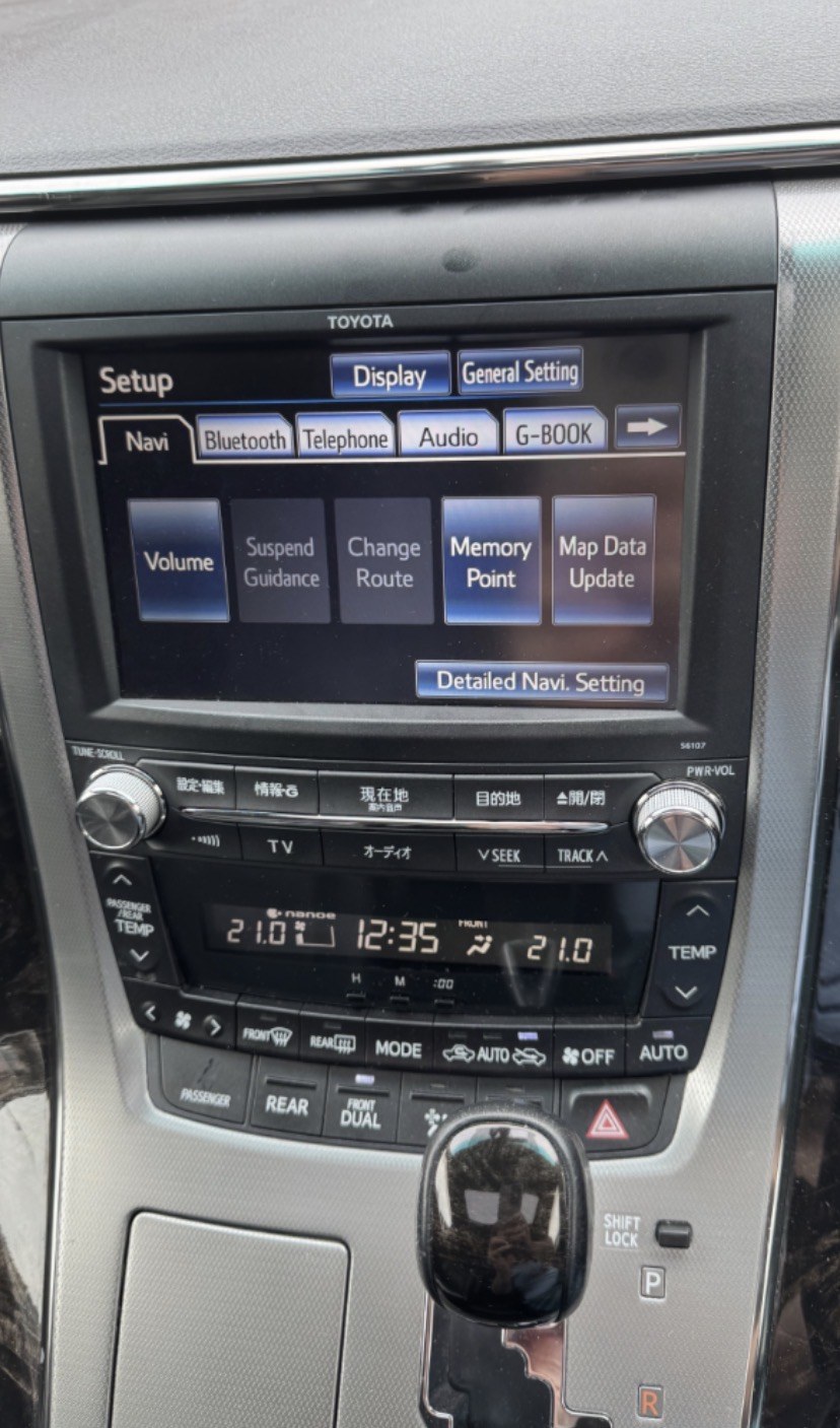

On mine, i chose the touchscreen integration, which did mean having to remove the screen section, opening it, and plugging in a small cable.
If you don't feel confident to do that, they can supply a 'jogwheel' controller that allows you to control the system.
Thank you for the link.
I would go with touchscreen integration also, doesn’t look complicated. Does all the original features work when the car play is enabled? Did you have any issues or something you dislike?
The whole system works by utilising the aux video input, so you won't get a pin sharp display, but it is perfectly usable for navigation etc.
The way the existing headunit works, when you use reverse gear or slow down under 14kmph, the cameras will take over the display, so you see the parking sensors etc, auto parking will work as it should.
The audio works as it should.
The only irritation, is you have to click a button to swap the touchscreen input between the Android box and the original headunit functions, but you get used to that.

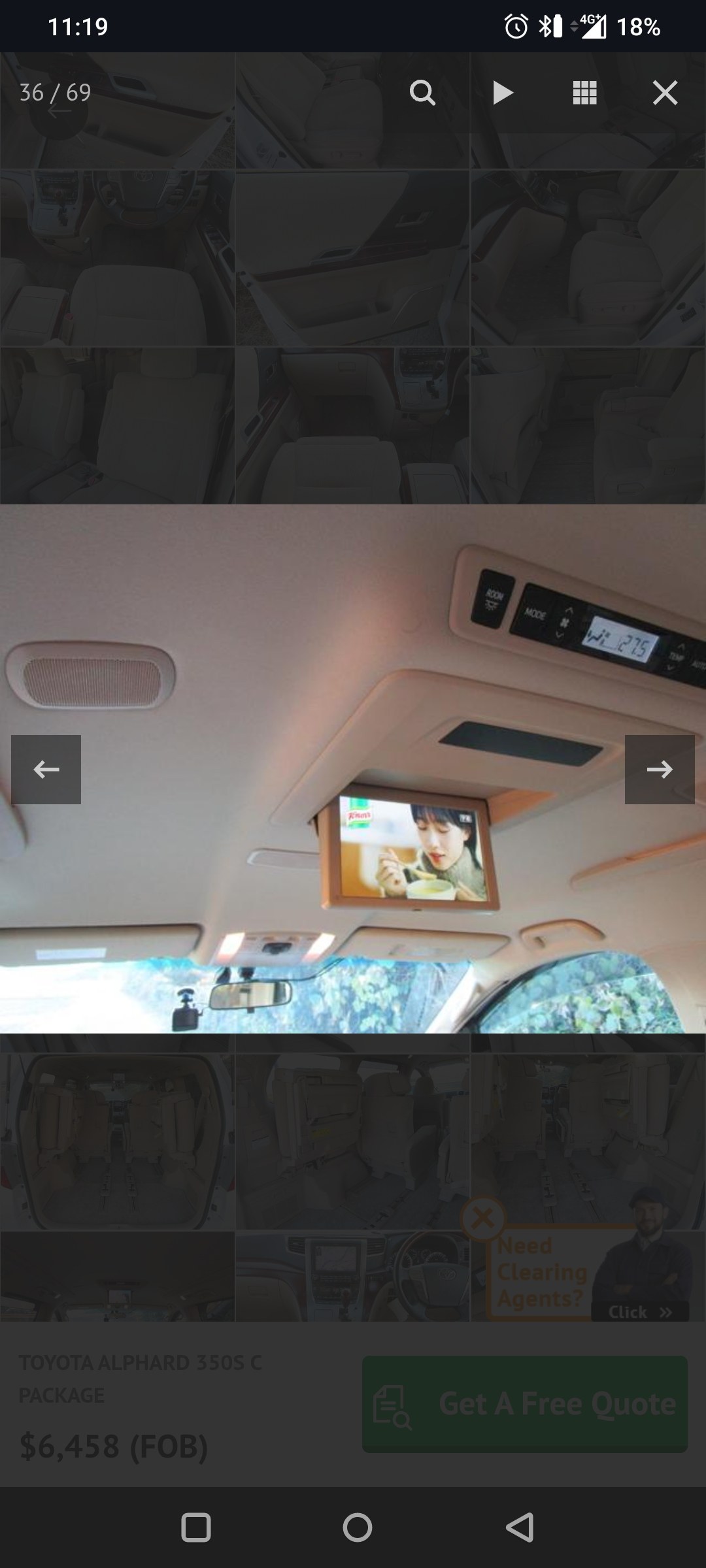

If you have a rear screen, it will mirror the Android box.
I've not tried to see if a dvd still works separately on the rear. I might do that later.

This look slightly more complicated than the one Chris used. I kinda like the original headunit that I have currently, not sure if I want to get rid of it. Will try to wait for the supplier to reply and will go from there. Here is what I have at the moment:
