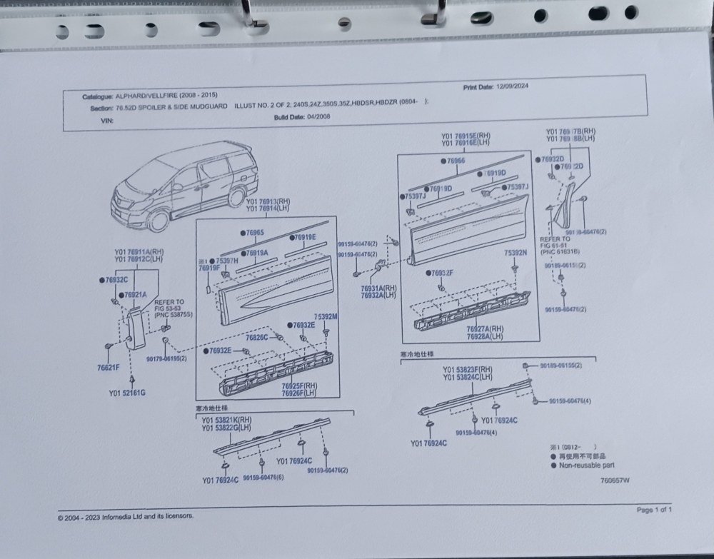

Just found the skirt panel diagram. It shows all the details including the panel clip code numbers!!!
These are the same for the Vellfire and Alphard.
Good luck!!!
John Harrison. Wallasey

John K.
Here is a copy of the sheet that was given to me by my local Toyota parts dept. It's for my Vellfire buy he said the Alphard too.
Hope it is usfull to you???
John Harrison. Wallasey.

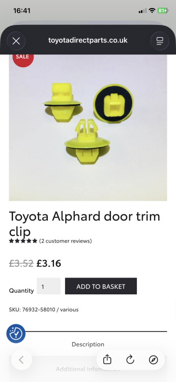

These seem to be available from Toyota parts supplier but are genuine Toyota and cost £3.16 individually! Part no. is 76932-58010 for side skirt lower fixing on my 2004 Alphard ANH10. Google the number and Toyota Parts will come up. Was £6 postage on top so may be better to visit Toyota dealer!
I’ve bought 3 generic cheap types from eBay all are wrong size/fitting so beware.
